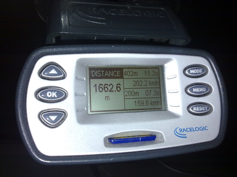

Official time 11.690s 120mph but i had problems with ignition at that day((
I had 8 starts and all were with ET <12s.
Here u can see more Drag Racing "Race For Life 2013"
Also i have many runs on Racelogic (roll out 1 ft) 11.3-11.5s

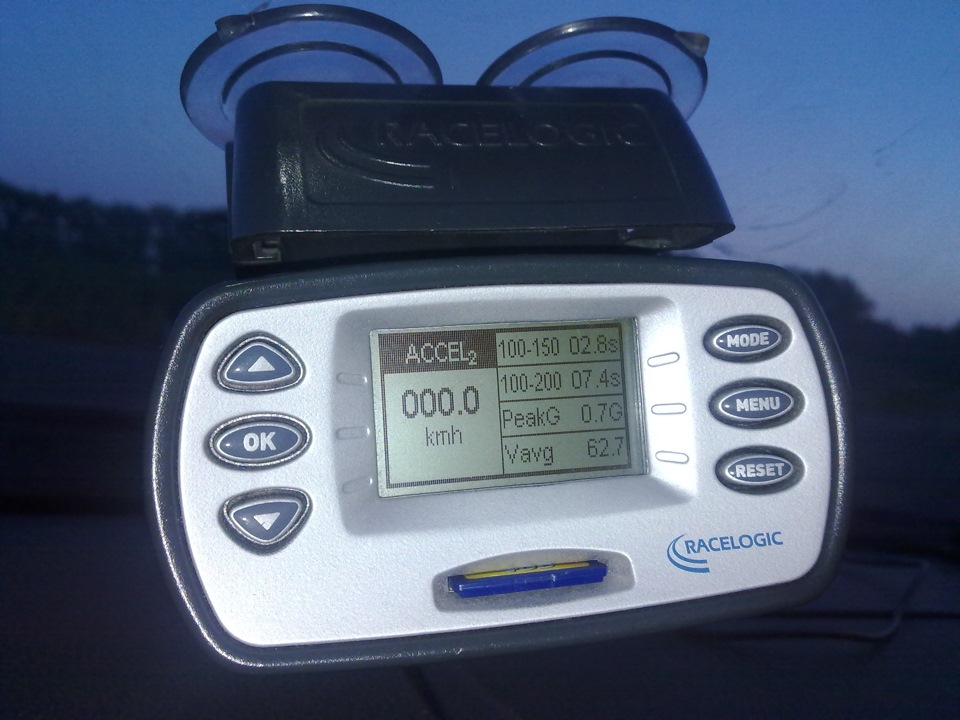

11.3s inside cam
and how it looks in daylight
100-200kmph 7.4s 3-4gears (62.5-125mph)
100-150kmph 2.8s 3gear (62.5-93.75mph)

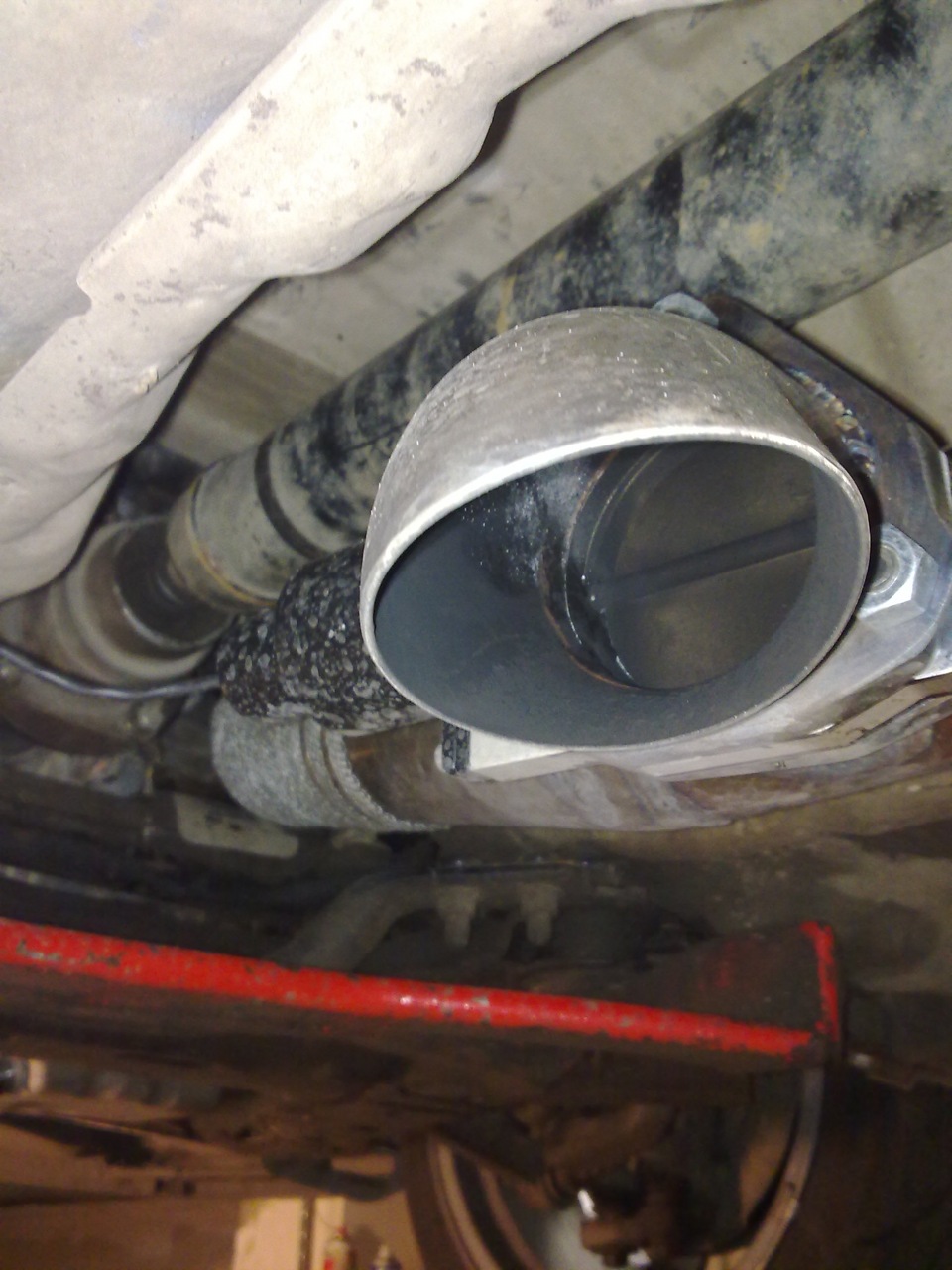

I have OTP 3" Electric Cutout [BORLA]
???????? ?? ?????? OTP 3" Electric Cutout [BORLA]
???????? ?? ?????? OTP 3" Electric Cutout [BORLA] ????? 2
so in everyday life it's very quiet car)))

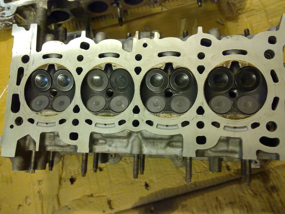

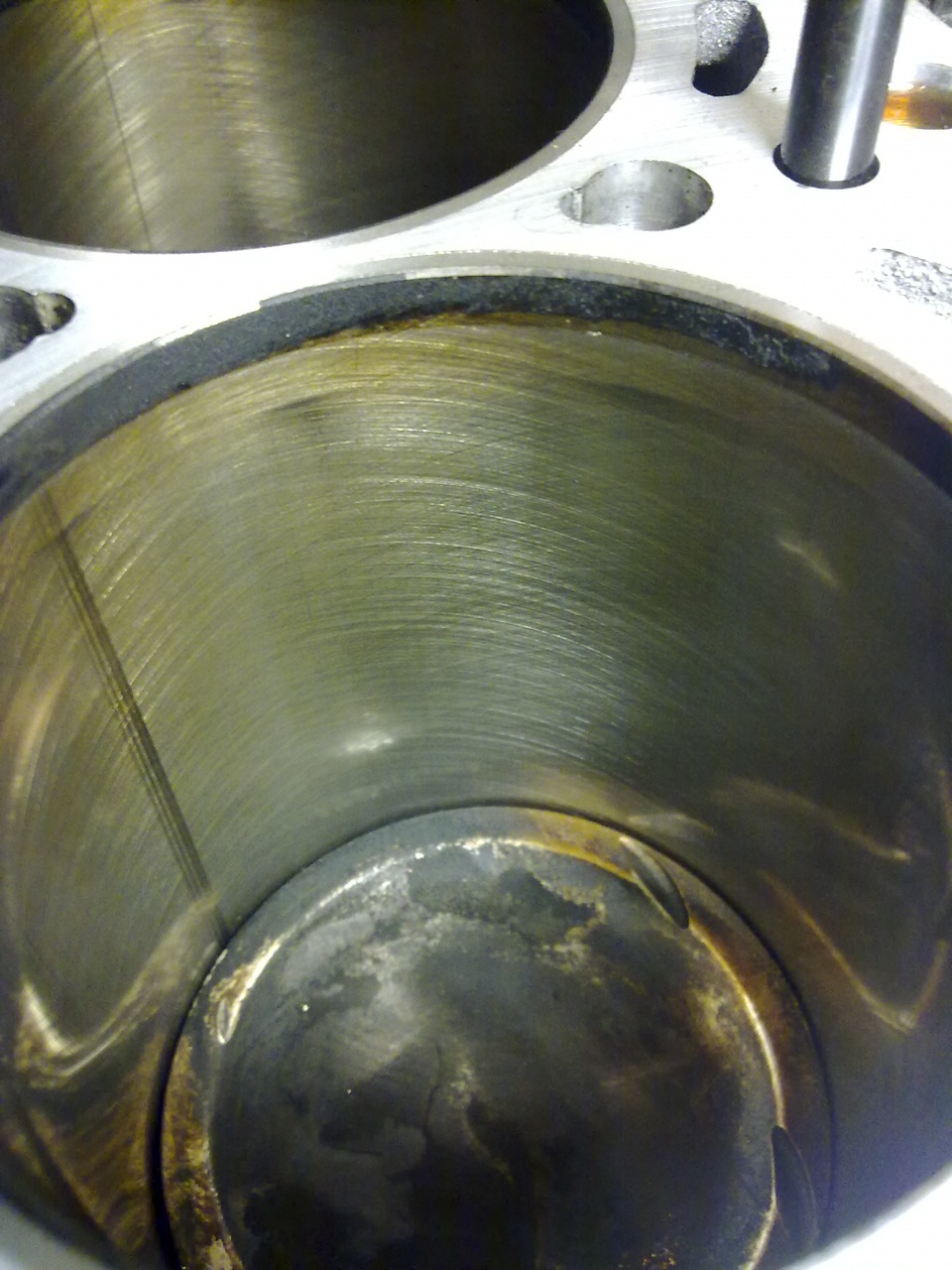

Originally Posted by biggman026 View Post
What RPM are you revving to in order to hit 125mph in 4th gear? I'm at red line around 105-106mph

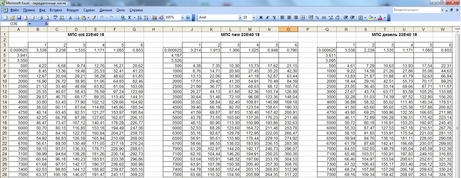

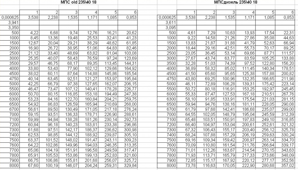

We upgraded transmission. The the main pair is from diesel, so all gears are on 9% longer!
So 125mph in 4th gear is 7200rpm)))

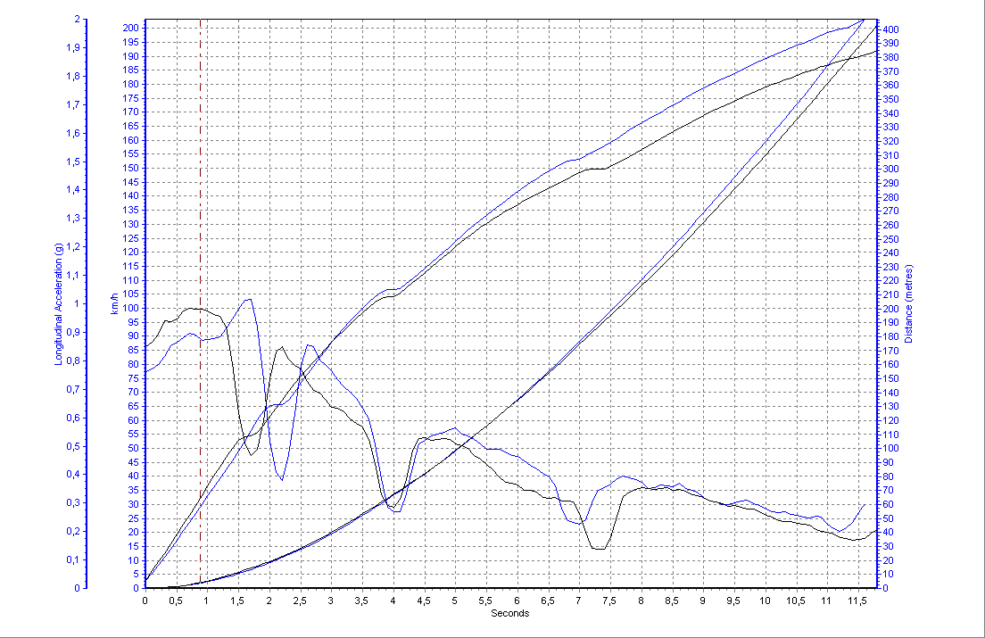

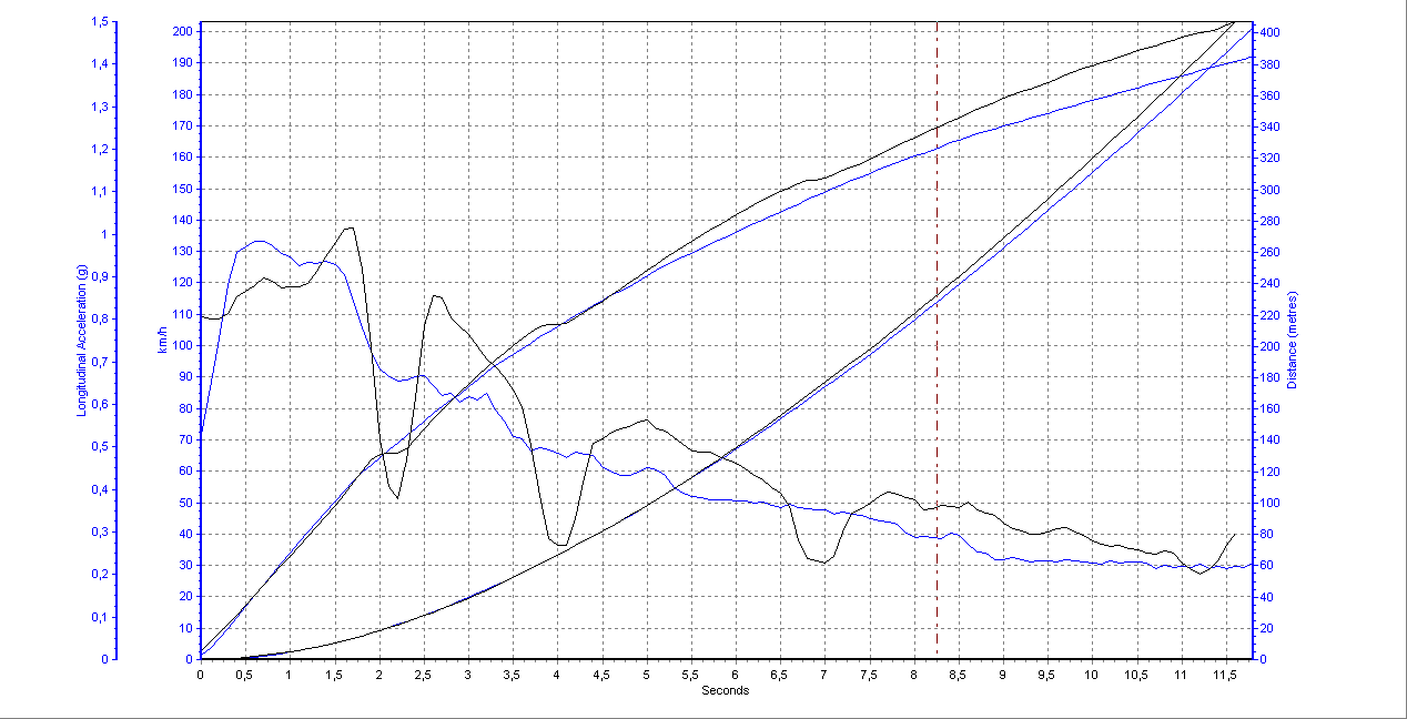

The comparison of stock, ms3 2 gen and my diesel variant on tires 235\40 R18
comparison on 1\4 mile by Racelogic rollout 0 my Mazda (black lines) and Golf R HGP 365whp (blue lines)

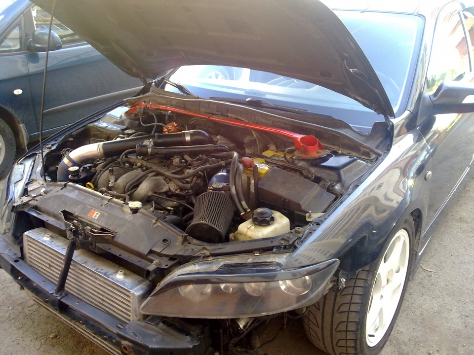

stock and my variant, but i have cutoff 7500rpm
bonus
my and Pat's Mazdas in Kiev))) He has the same transmission)))

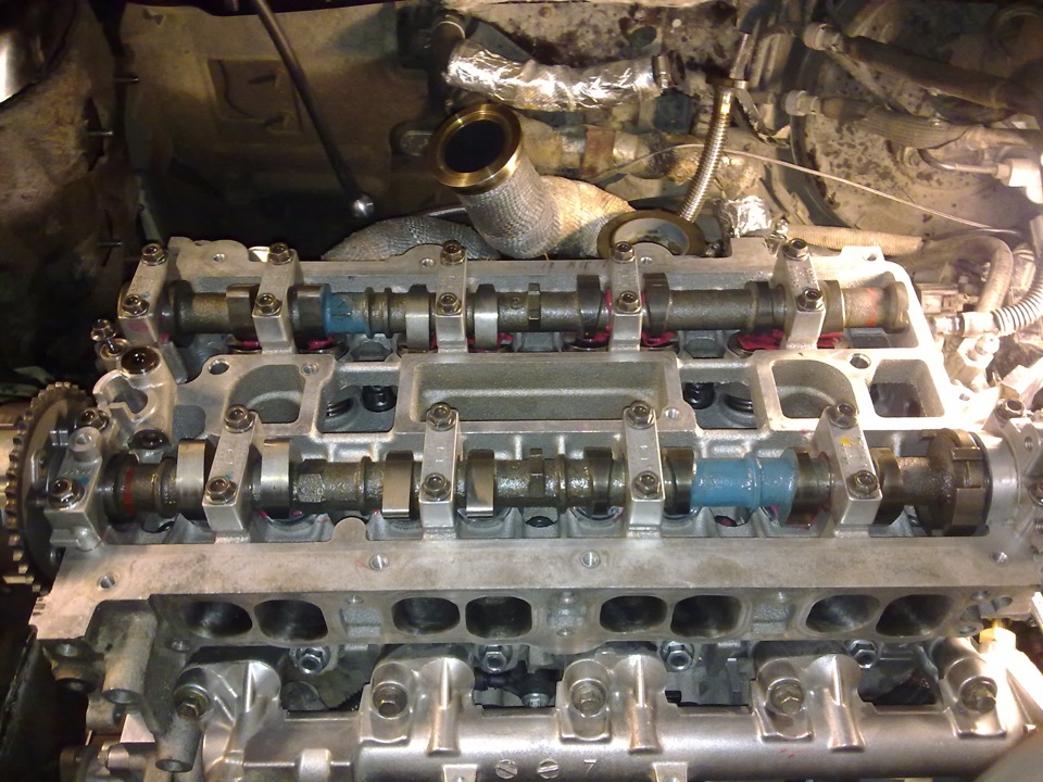

Am I reading correctly that you have the ptp camshafts?

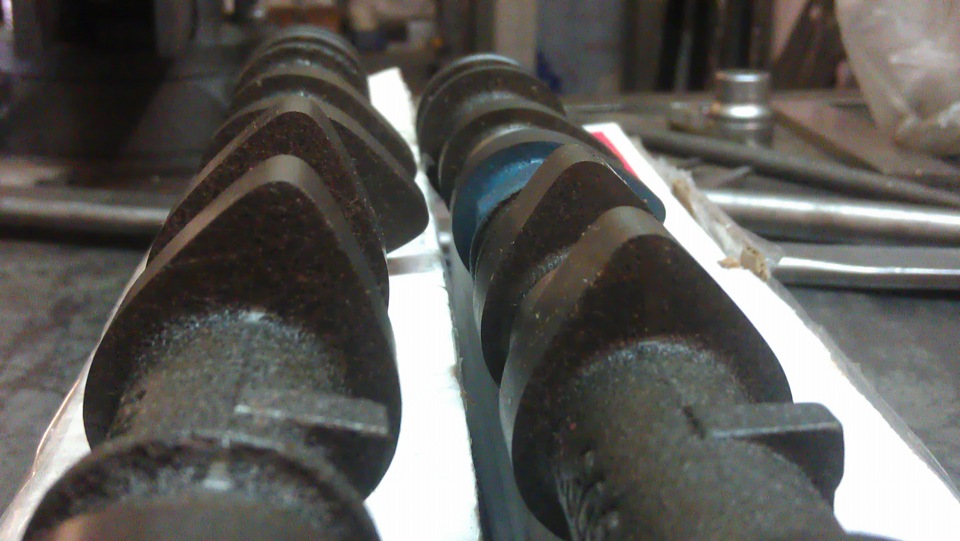

yes, u are right
Intake Cam : Advertised 272
Duration .050 215
Lift
.384 (9,75)
Lobe Center
111
Exhaust Cam: Advertised 272
Duration .050 205
Lift
.333 (8,46)
Lobe Center
90

I can't wait to see what the diesel internals will do! One of the most exciting part of my build.
What are the other gears like?
all gears are longer on 9%. I like this in everyday use too. It's very useful 60mph and about 2200rpm on highway on cruise in 6 gear!

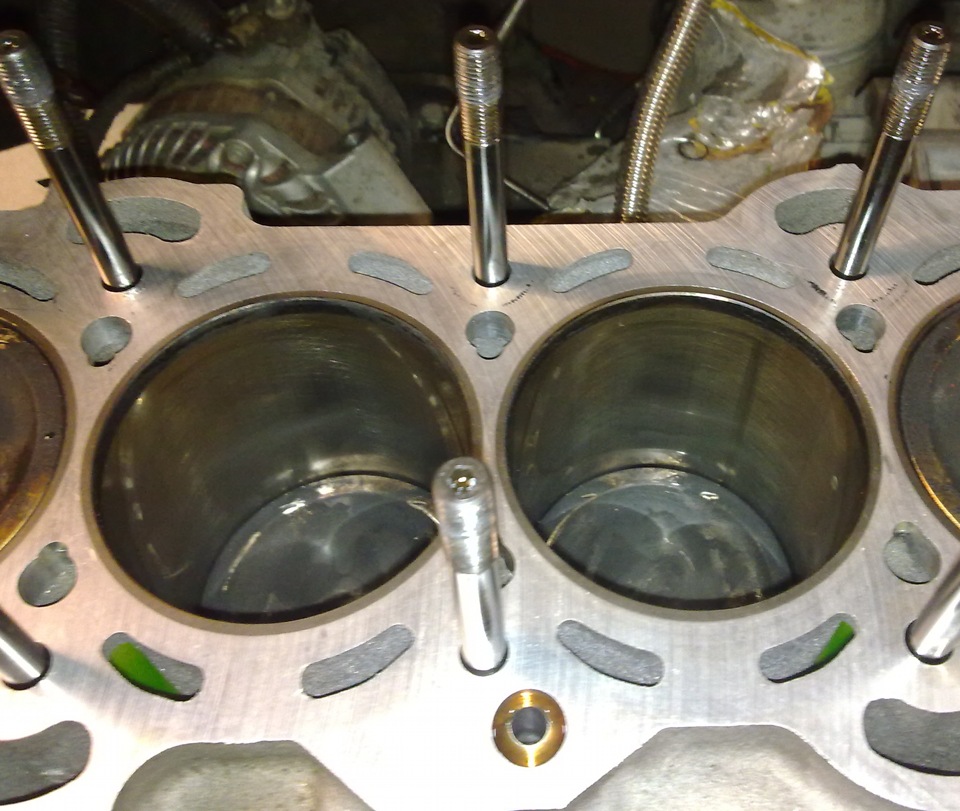

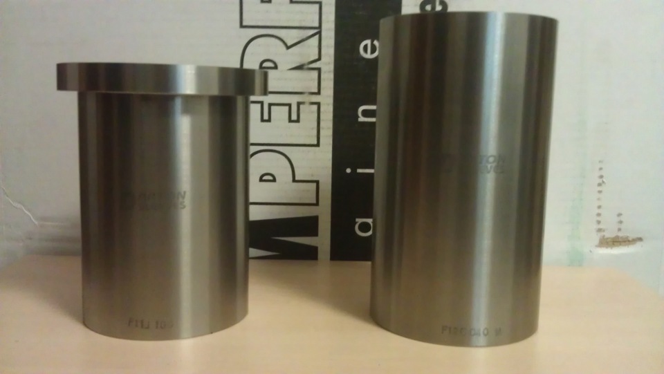

Why did you decide to sleeve the block?
stock sleeves don't like about 750+n*m. They are blowing out.
we use darton dry sleeves, tried to use wet, but our block is very "sandy".

Do you have any heat issues with them being dry sleeves?
And do you have a part number for dry sleeves? I have the Darton catalogue and the only sleeves for the MZR are wet sleeves.
haven't part number

Originally Posted by Vadim aka ScooteR View Post
haven't part number
Do you think you could get the part number from Pat or whoever built the engine? I'm very interested in this.
Also, do you have any pictures of your PTP head studs? I'm sure there are plenty of people who would love to see them.

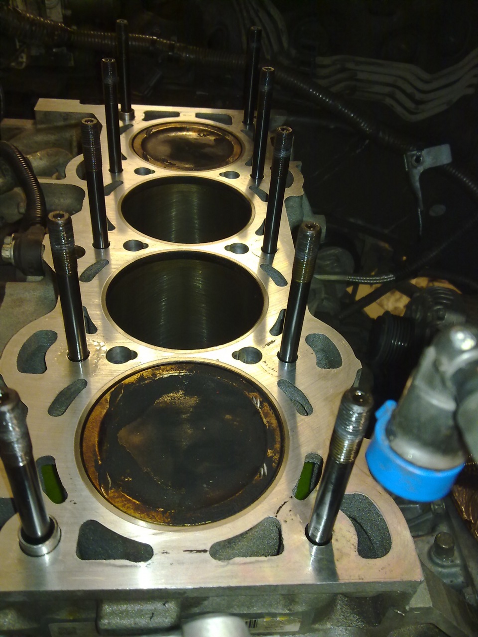

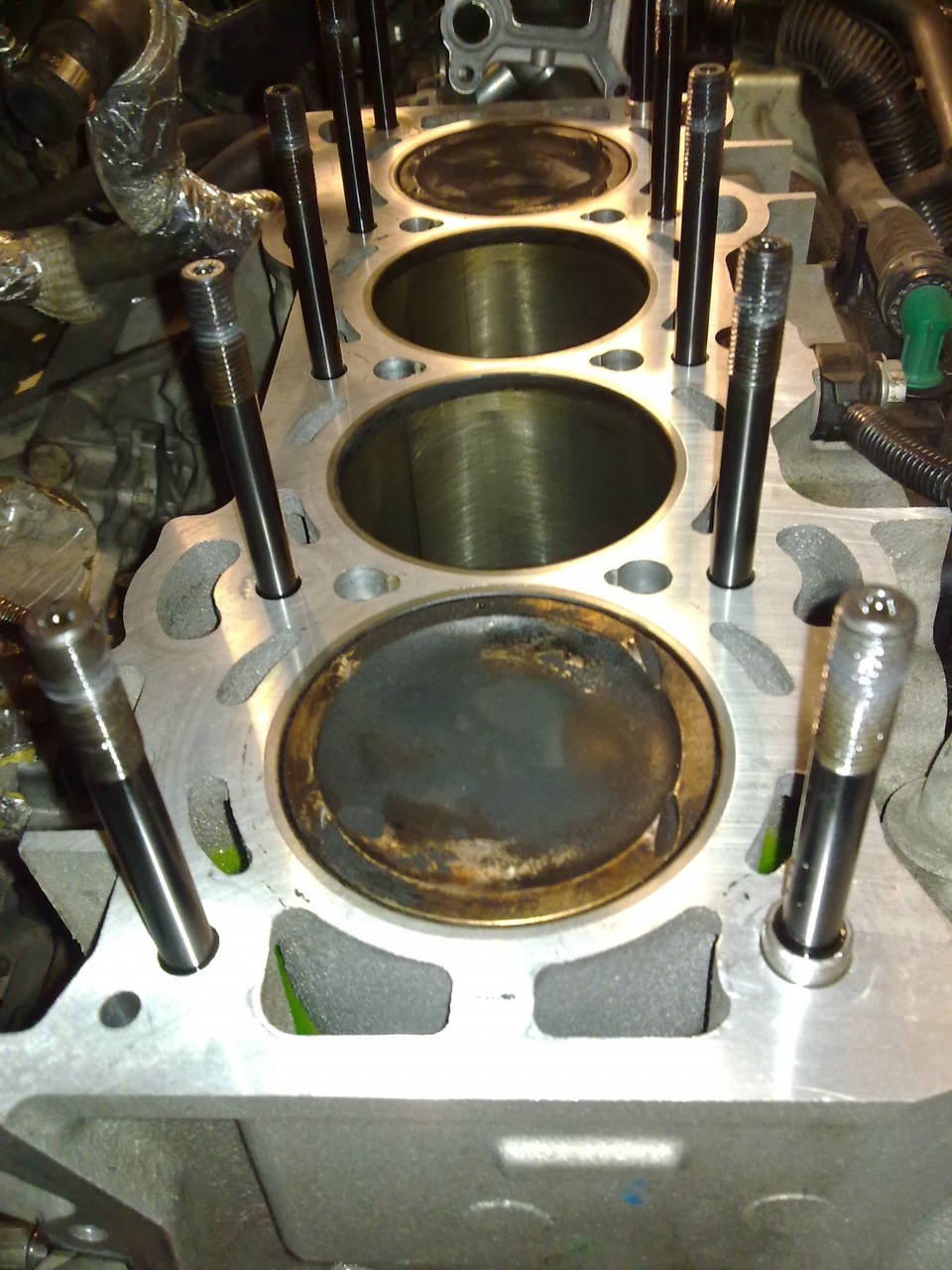

these are dry sleeves.
After 1500km

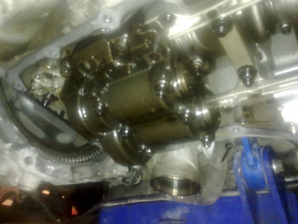

why did you leave the balance shaft in?
You call up darton for those sleeve it a custom one off order
Do you happen to know a price range?
street car for everyday use, and Pat' Madza also has balance shaft. it seems to us that life of engine will be longer)

Here u can see the comparison of my 11.3s(at night) and 11.69s(day official result) 1\4mile. Second race was good at start, but then i had big problems with ignition((( Potential of this config is in <11sec. Next year i'll try to do this!)))
PS No glue, guys, and street tires 235\45 17)

rather ditry)
Vadim aka ScooteR is offline   Reply With Quote
The Following 2 Users Say Thank You to Vadim aka ScooteR For This Useful Post:
atvfreek (10-19-2013), cocoanton (10-21-2013)
 Old 10-19-2013, 06:58 AM   #40
SpeedRebirth's Avatar
Location: Stockholm Sweden
Posts: 685   (View Stats)
Thanks: 1,687
Groans: 33
You could pick up a decent amount of flow by upgrading to a bigger MAF and cleaning that filter =)
