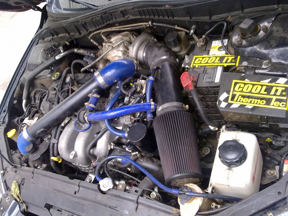

You could pick up a decent amount of flow by upgrading to a bigger MAF and cleaning that filter =)
Vadim, you sir need to be mounted by JBR
yes, i'll clean it tomorrow.
I can use maf-emulator and another long 4'' filter with no MAF sensor and podium)
But i'd like MAF, aspeсially in winter.
my real mass flow now is 445g\s
What is JBR?
That may be one of the dirtiest engine bays I've seen. Lol. What are your maf bolts on that little maf housing?
What size meth nozzle are you using and are you using 100% meth?
i don't use front bumper whole season, so it's so dirty(((
usual bolts, nothing special.
i use 50 on 50 or 70 on 30 or 66 on 34 met to water.
nozzle is like 550cc, the biggest in kit,

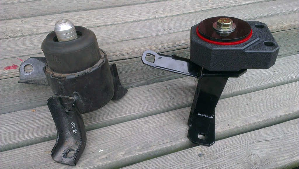

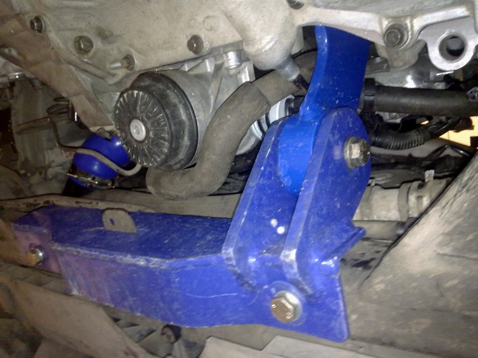

Originally Posted by Vadim aka ScooteR View Post

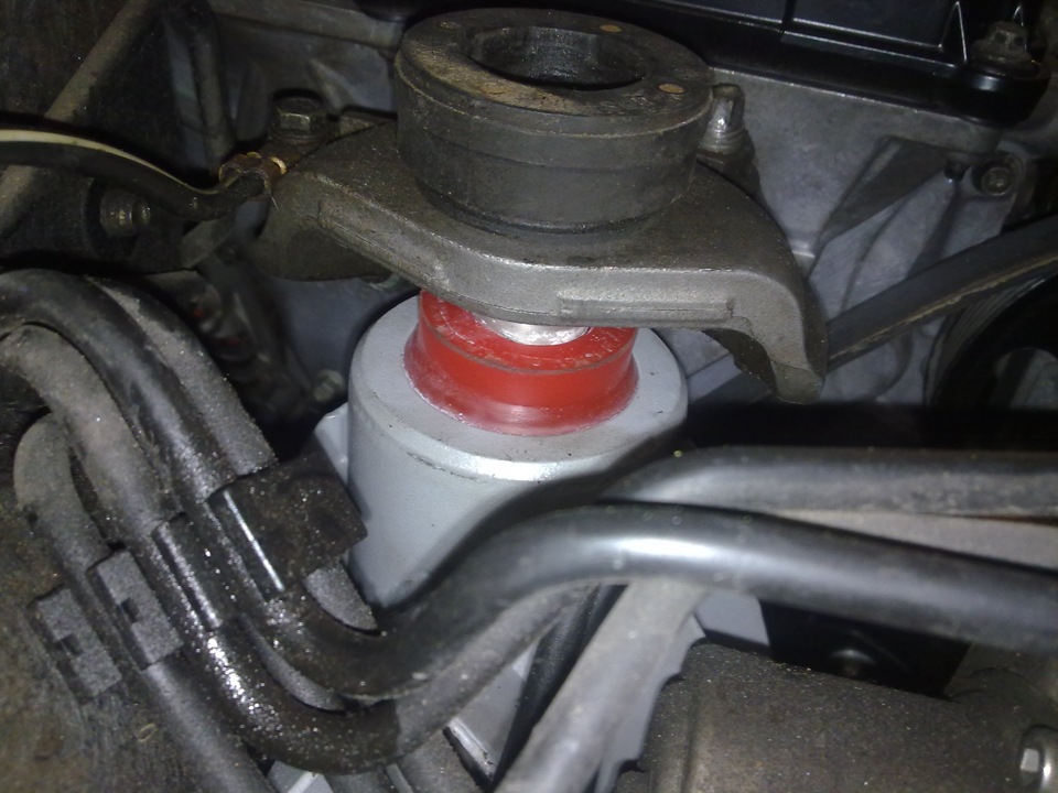

What is JBR?
JBR = James Barone Racing (www.jamesbaroneracing.com)
They have all three engine mounts for the MS6. I have all of them installed
Passenger side, stock vs JBR:
Rear Mount:

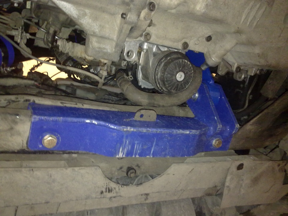

I have tune mounts. MG = Mazdagarge. Pat's own development.
I have 4 mounts, becouse of one extra)))
Extra
AWR
And my second variant of intake is like this with no MAF

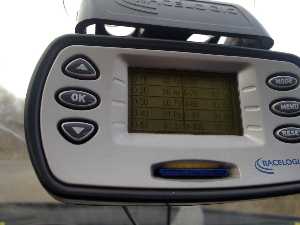

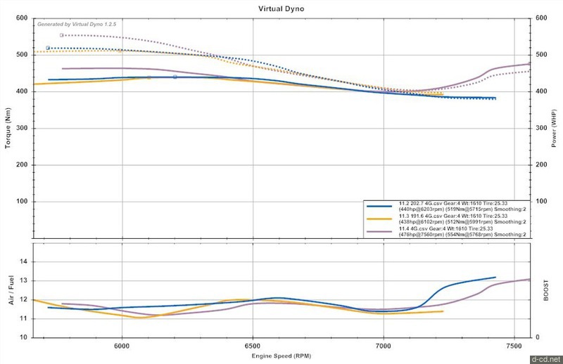

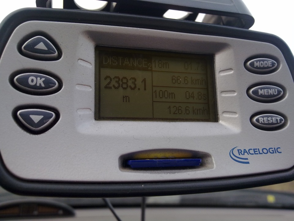

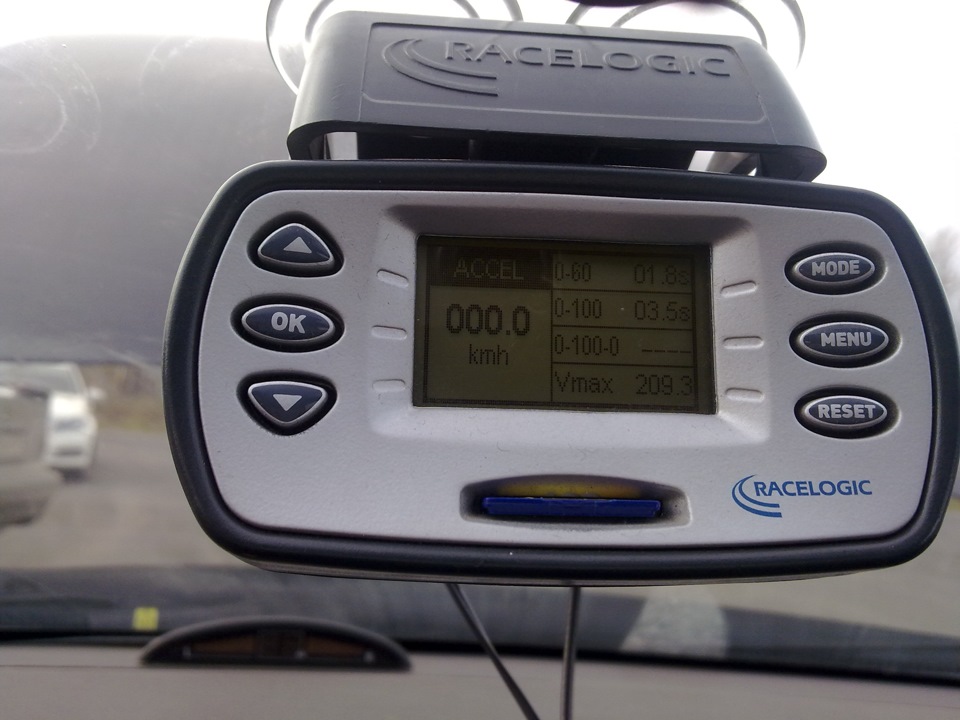

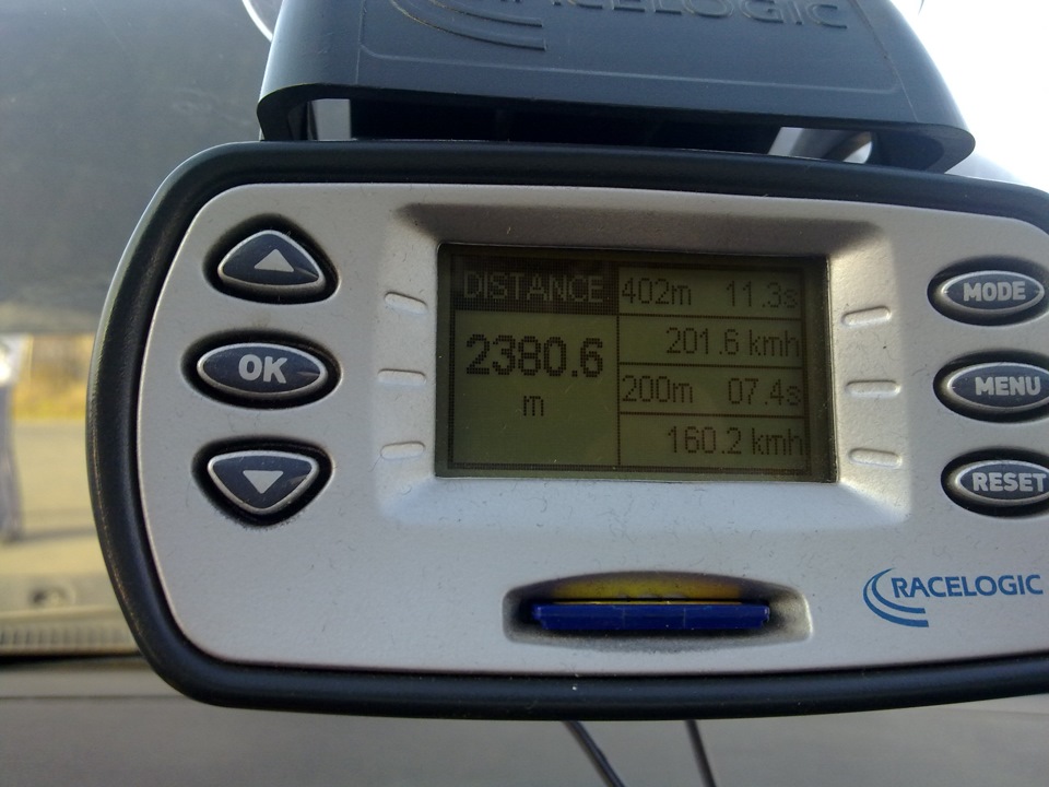

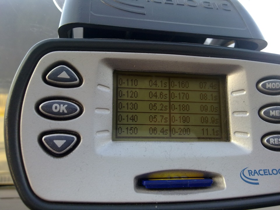

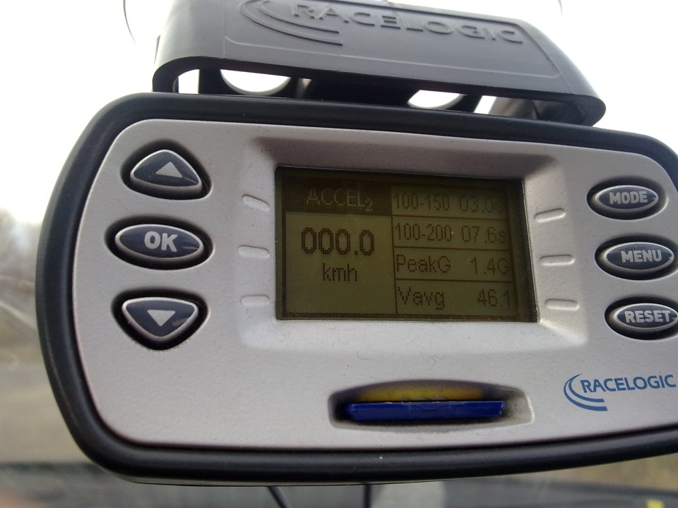

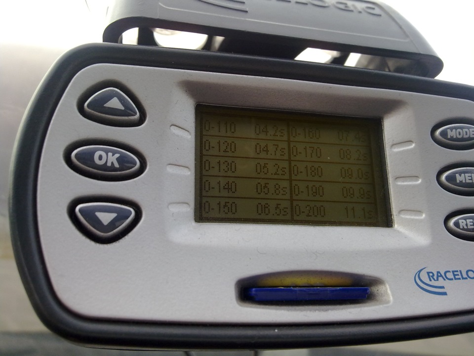

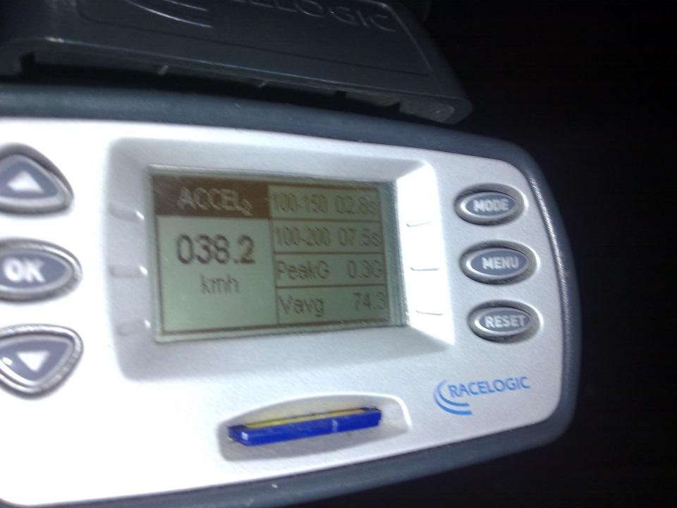

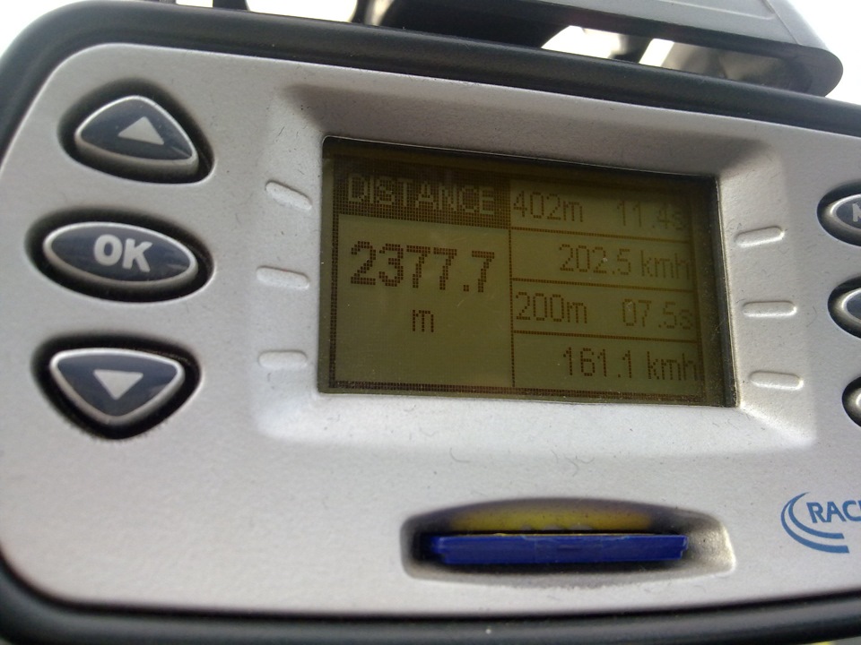

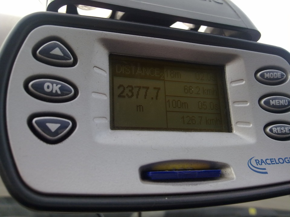

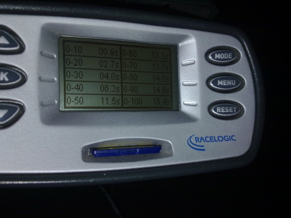

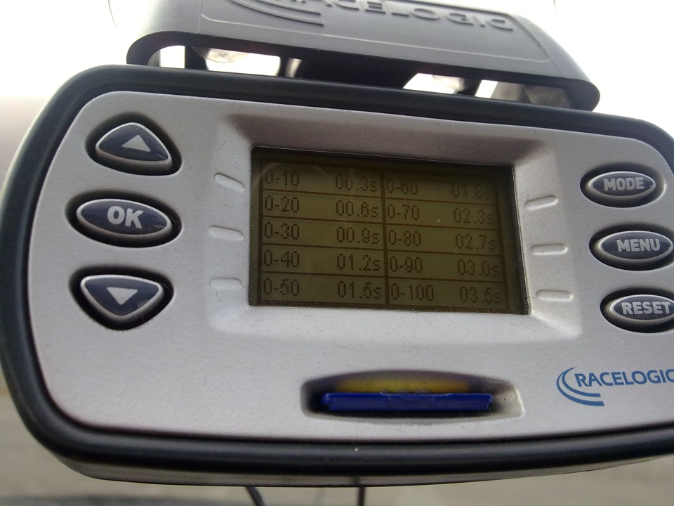

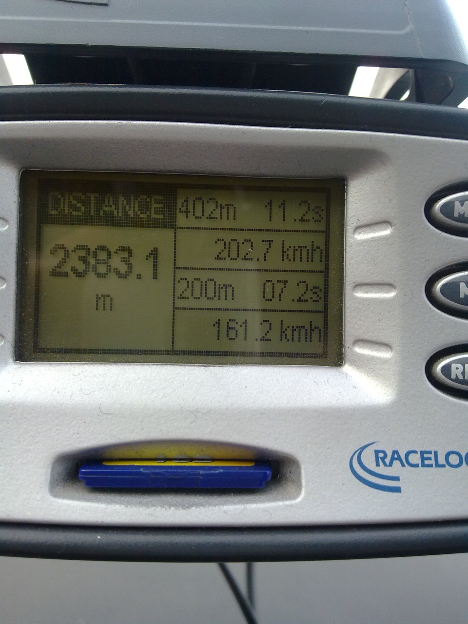

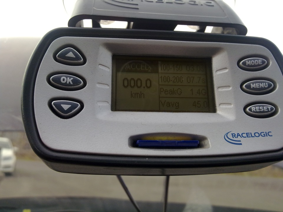

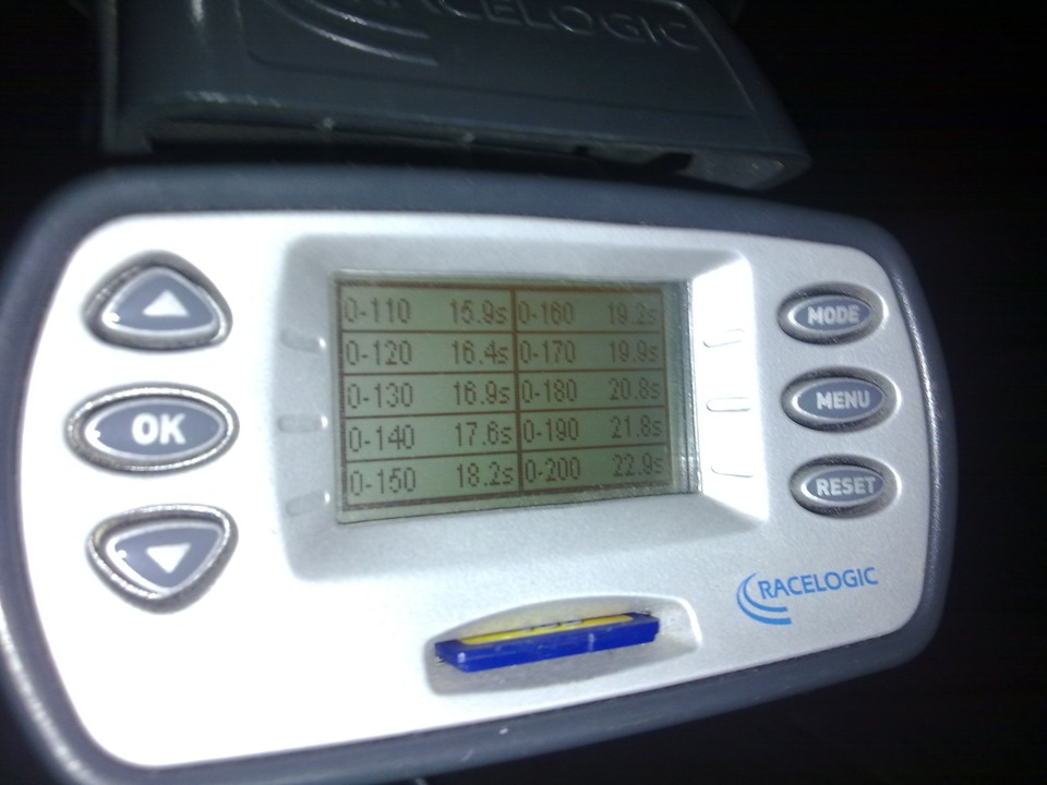

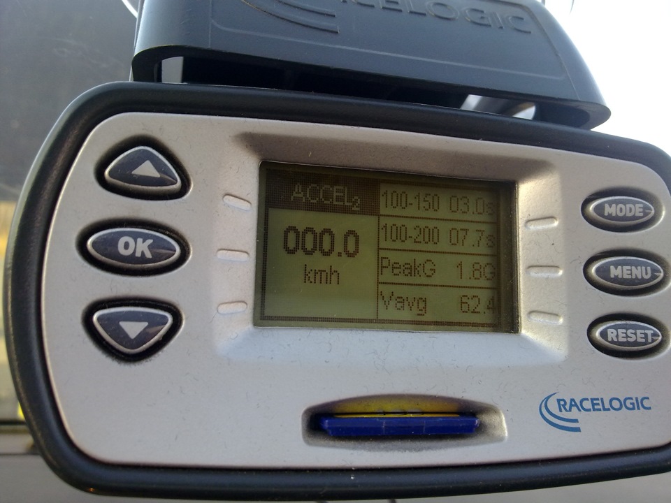

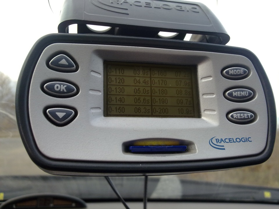

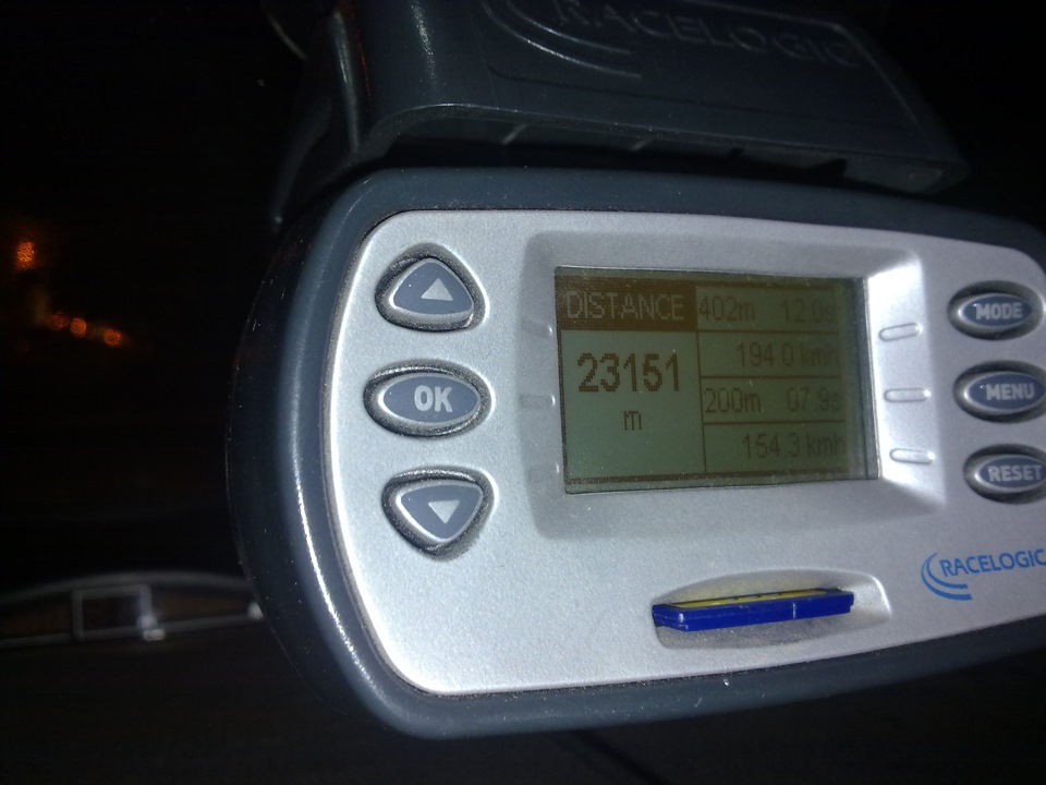

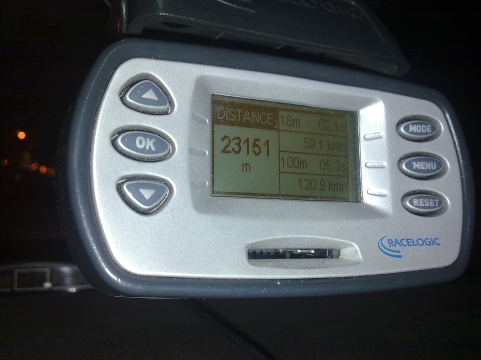

End of a season. 10C degree, sunny. boost 1.9bars, ignition 23degree.
inside

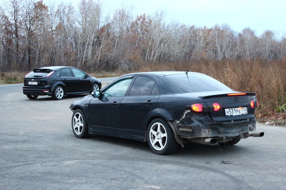

Evo 5 with engine and turbo from Evo 8. 300+hp., today he ran 13.2s 1\4mile.
Mitsubishi Lancer Evolution V GSR
My 11.4s with 0ft rollout 127mph.
GoPro
outside
inside

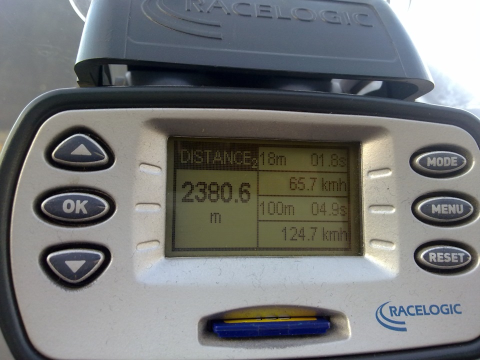

My 11.2s with 1ft rollout
GoPro
outside
inside
SRT 8 stock

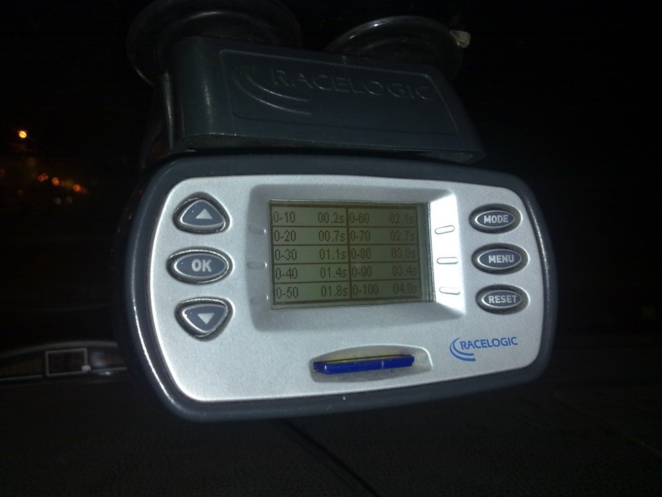

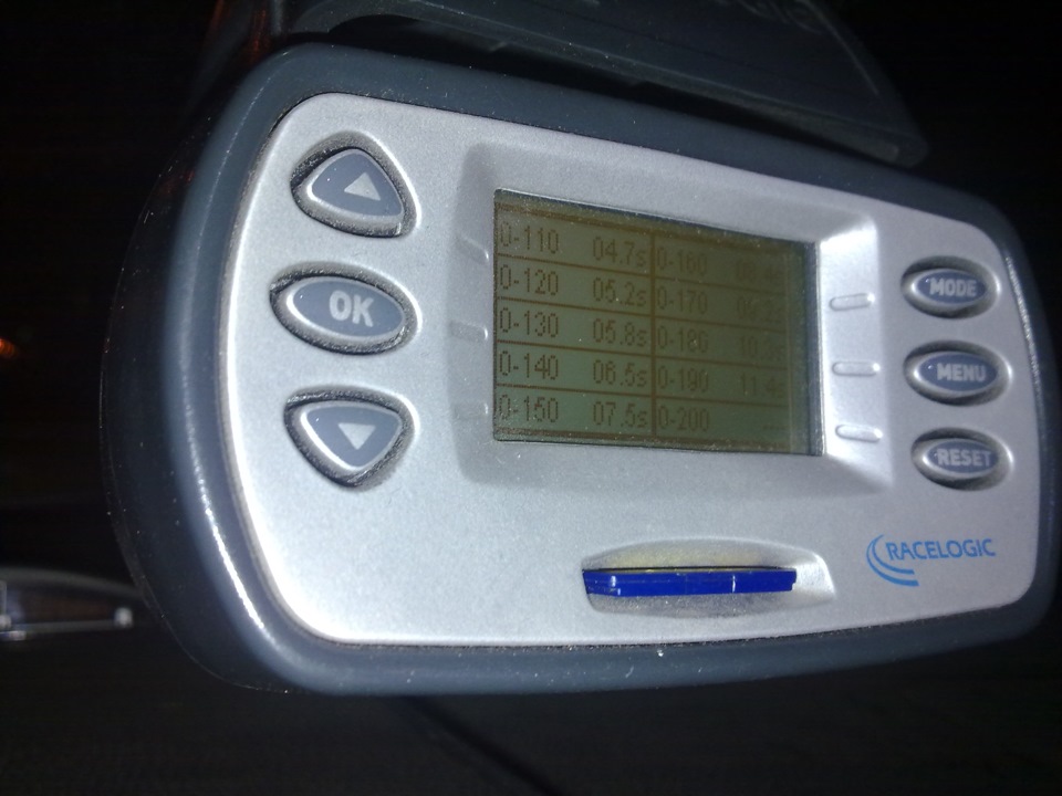

My not best 100-200 7.5s and 2.8s 100-150kmph.

How are you running "no maf"? It doesn't look like it's on your hot piping, so it's not blow through.... Where is it?
And if you're truly not using a maf.... How?
TRADED : 07 MS3 GT Silver... fully bolted w/K04
CURRENT : 06 MS6 GT Silver....
KMD V2.something ~ Cobb AP ~ SURE SRI ~ Cobb TIH ~ Forge V1 BPV ~ SLS TP ~ SURE Torq R6
Fatguy729 is offline   Reply With Quote
 Old 10-20-2013, 09:11 PM   #52
Vadim aka ScooteR's Avatar
Posts: 206   (View Stats)
Vadim aka ScooteR is the leader of the worldVadim aka ScooteR is the leader of the worldVadim aka ScooteR is the leader of the worldVadim aka ScooteR is the leader of the worldVadim aka ScooteR is the leader of the worldVadim aka ScooteR is the leader of the worldVadim aka ScooteR is the leader of the worldVadim aka ScooteR is the leader of the worldVadim aka ScooteR is the leader of the worldVadim aka ScooteR is the leader of the worldVadim aka ScooteR is the leader of the world
Thanks: 66
Thanked 289 Times in 107 Posts
I have MAF-emulator. And outer bar-sensor on 3.5bars.
But i'm using MAF, cause in everyday life it is more comfortable.
