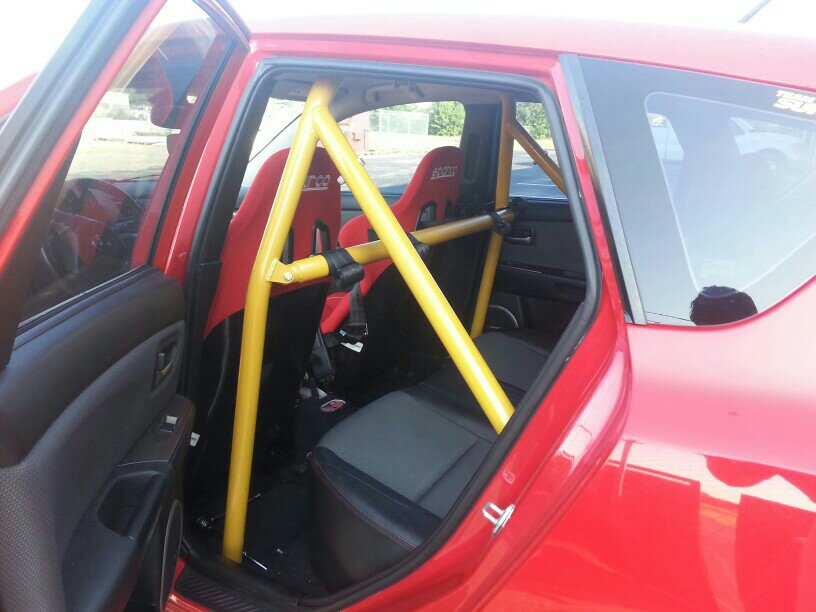

@S-hendrix; is running a bolt-in half-cage from Autopower, you can get one with a harness bar.

The autopower is rock solid and it will stiffen up your chasis alot. The harness bar matches up at a perfect height for the harnesses. I have the 4 point DOT scroths and they are really nice but 6 point is def a better option.

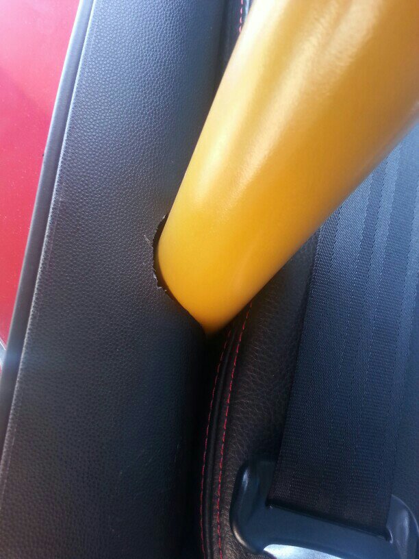

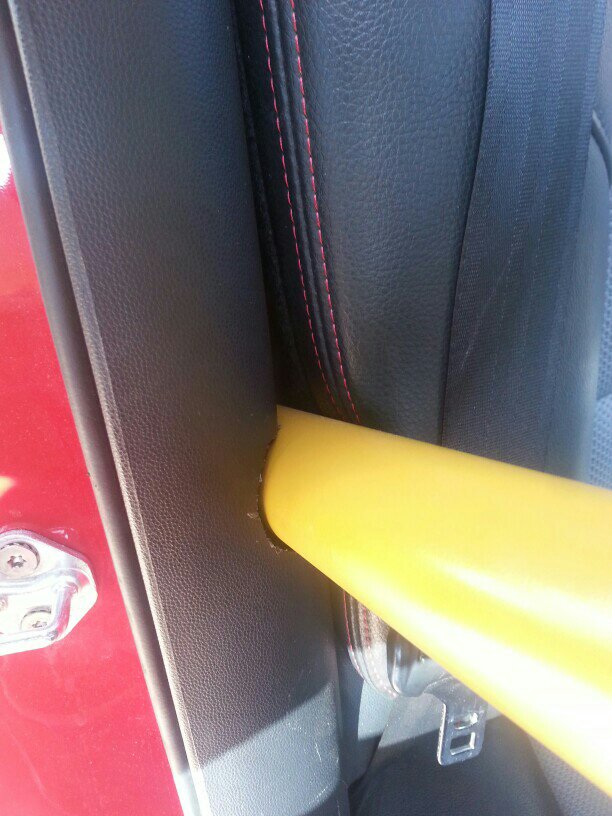

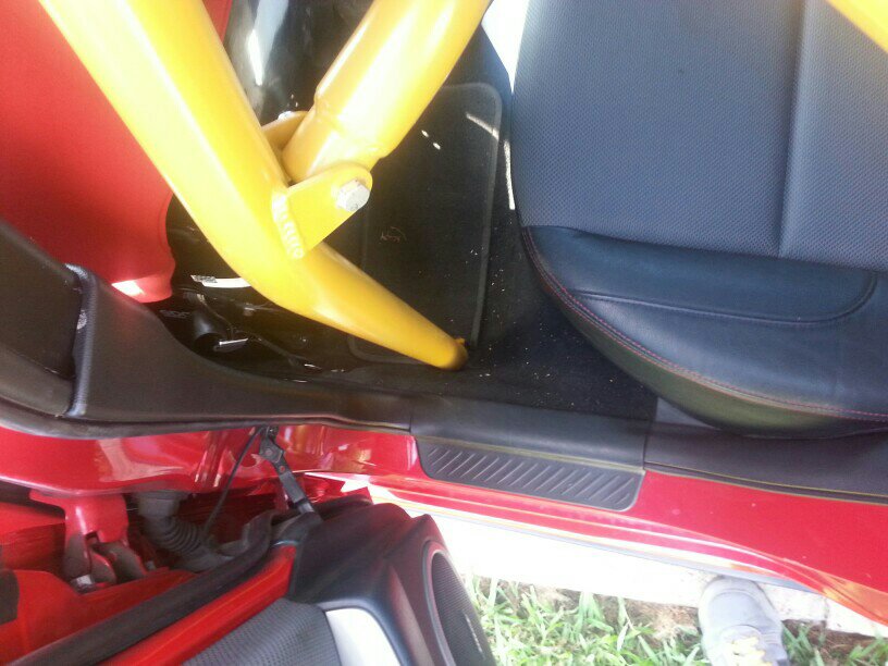

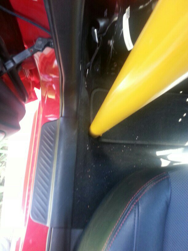

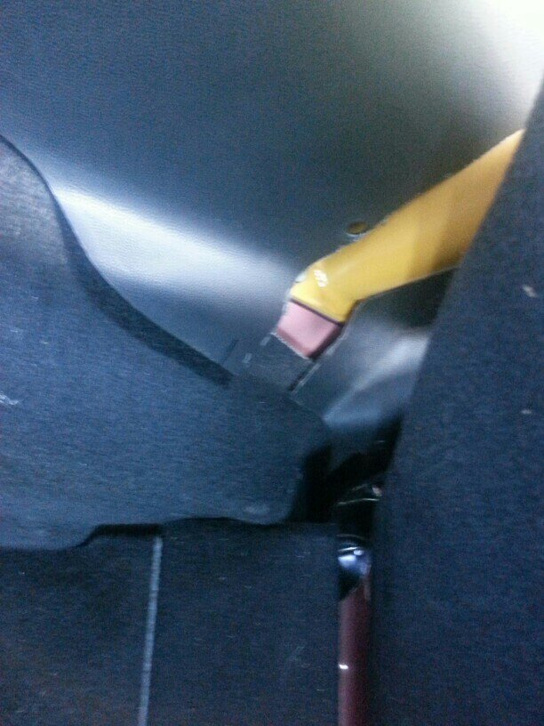

Jh8909 likes this.
The Following 7 Users Say Thank You to Code Monkey For This Useful Post:

 Old 07-31-2014, 06:26 PM   #17
Jh8909's Avatar
Location: Rockville, MD
Posts: 1,457   (View Stats)
iTrader: (15)
Thanks: 3,554
Groans: 130
Groaned at 8 Times in 7 Posts
Yep, not even trying to fuck with that.
The Following User Says Thank You to Jh8909 For This Useful Post:
Code Monkey (07-31-2014)

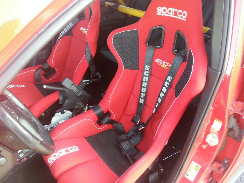

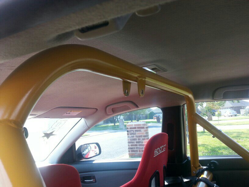

Here's a couple pics with the 4pt harnesses. And no I dont let anyone ride in the back. Its just for appearances and noise dampening.

4 points are probably fine for the occasional autocrosser or road racer, but not having that 5th/6th harness sucks (edit: or for someone who is cheap and/or cares about not adding weight...like me). A 4 point can't be tightened like a 5/6 point, because the shoulder belts will pull the lap belts upward off of your hips. The sub belt prevents that from happening.
I put a 4 point in the 6 for this past weekend and that was my first thought. I'm strapped in WAY tighter in the formula car with a 6 point harness. Not to mention the wider straps are a little more comfortable (to me).

Nice harness bar BTW @S-hendrix. Could you share more pics of the harness bar where it's attached to the chassis?
1) - Where did you get it from?
2) - who is the manifacturer?
3) - How does it attach to the chassis where the rear passenger put their feeds and in the trunc?
Looking good and clean.....

Its the Autopower roll race bar. It's a bolt in half cage. It has another cross bar that goes diagonal across the hoop. I need to paint it since I recieved it seperately. The company is pretty awesome because the cross bar I recieved was smashed by a forklift (somehow.. this metal is heavy as hell) during shipping. I signed for it without inspecting like a moron. I called Autopower and he said mail back the damaged bar and he would make me a new one. The only reason I had to mail it back was so he could lineup the holes from the other bar. I recieved it a week and a half later and fitment was perfect.
Install was kinda tough. Def a 2 man job. To attach it you drill holes in the floorboard and use the provided sandwich plate to snug up the bolts. You have to cut the plastics a little. The floorboard in the backseat is the same way. It was pretty straightforward because once you get it in everything lines right up. It mounts pretty much only one way and there is very little room for error.
I bought this setup off of vivid racing and they took like $75 off the price if you call them and ask them to do better on the price. Freight was like $150 if I remember correctly.
