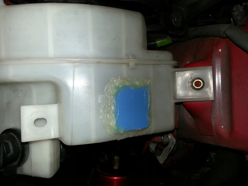

Since I had a float sensor in my washer fluid reservoir I had to remove it and patch the tank. I used plastic welder and cut a piece of plastic from an old laundry detergent bottle. Took me about 5 minutes to complete this and 15 minutes to seal it completely.

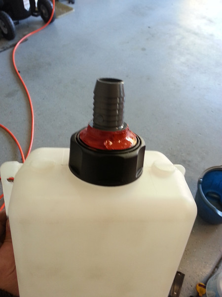

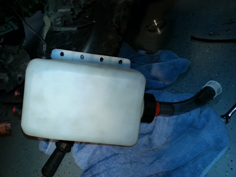

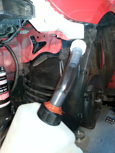

Once the washer fluid reservoir was patched I moved onto the new tank. I needed a way to easily fill it because there is no way to fill it when it's mounted to the wheel well area.
I went to ACE hardware and went to the pvc pipe fitting section and purchased a 1" coupler which has 1" female threading and 1" barbed area for a 1" ID hose. I bought 2 of these couplers and a 1" pvc cap. I simply drilled a hole in the cap of the meth tank then threaded the fitting in place and sealed it with RTV. I connected my 1" ID hose and routed it up into the engine bay then put the other barbed fitting in place and capped it with the cap. I also drilled a few tiny holes in the cap so the tank can breathe.
Here is the final outcome.
Here is the fill hole with cap in the engine bay

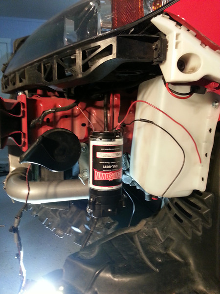

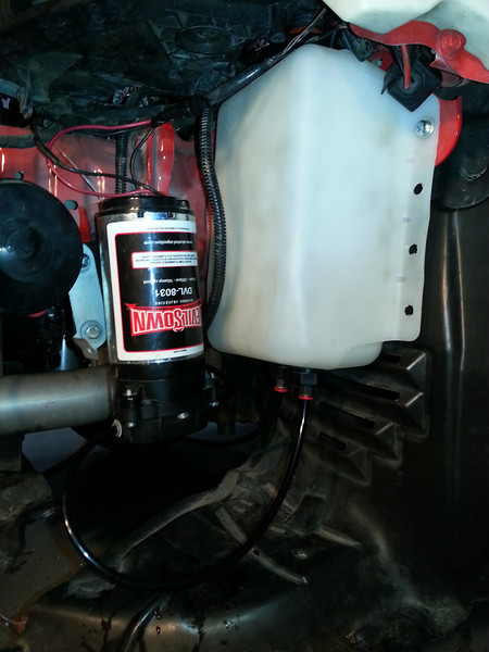

Next I wired everything back up and connected the float sensor. As you can see I have two lines coming out of the bottom of my primary tank. One line goes to the input of the pump and the other line goes stock washer fluid reservoir. Now I have roughly 2 gallons of meth under my hood.
As you can see the pump is located just under the primary tank it pulls from. Make sure to prime the pump before using it if this is the initial install.
