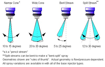

After talking to them for almost 45mins we decided that these were the best injectors to run. Home » Shop » Fuel » Injectors » Siemens DEKA IV ( DEKA 4 ) Mototron 60lb/hour High Impedance Injectors ( Short Style ) These are 60 lb 4 orifice 30° spray pattern high impedance injectors. 43mm in length, with an installed length of just under 24mm, this is a plus when installing in the tight confines of my engine bay.

We used a 1/2" end mill first just in case something was not right with his set up. He was able to hit it the very first time, sigh of relief!!
Next up was an undersized 3/4" end mill. The injector bungs actual measured .743".
Now I have a pocket in the runner to help orient the bungs for welding. Fits like a glove!!

I like the setup it's very nice the only thing that might be a problem is the straight runner meeting the head. The head runner is so steep it may cause atomization problem. I hope the don't because its a sick setup.

I'm curious, why are you so worried about heat? I know that warping can be a problem when welding, but you really shouldn't have much to worry about with such a large piece. The whole manifold is going to be acting as a giant heat sink, so as long as the welding is done slowly, there shouldn't be a problem. @SilverDemon;
This is awesome though, I can't wait to see the final product

Curious as to why you didn't put the bungs closer to the flange. I would want them as close to the ports in the head as possible to avoid wall wetting and pooling. If the injectors could literally poke out of the manifold towards the head it would be very nice.
Was it a spacing issue?
I'd imagine the AUX fueling is only going to be running under high load at WOT, so I don't think either of those will be a problem with all of the air passing through the runners. I believe those are mostly problems at low engine speeds/low air velocity like when you're just driving around town in vacuum. Also, I believe that pooling is really only a problem in wet manifolds(carbureted) and this is a dry manifold design.
On top of that, it will probably mix the fuel more evenly between each port(which may not really matter) where it currently sits.

Posts: 3,843   (View Stats)
Rep Power: 5339
Thanks: 27,149
Did you consider the split cone design injectors? They are advertised to be specifically for running on heads with 2 intake valves/cylinder?
Lex to your question, unless you cut the head, an injector in the middle, extending past the manifold flange, will hit the divider between the ports in the head.

Did you consider the split cone design injectors? The are advertised to be specifically for running on heads with 2 intake valves/cylinder?
Learn something new everyday.....No, I did not know there was something like that out there.
I can believe that this is leaps and bounds better than running 4 meth nozzles pointed directly at the opposite side of the runner.

Thanks: 6,334
we (pablo and i) considered this greatly when we were choosing injectors for the JMF manifold. after taking to the guys at bosch motorsports and a few other places we decided against it. each split cone only has a ~5 deg angle of spray which makes it very hard for the fuel to atomize because its coming out of the injector like a faucet. Also, because we are only using this at WOT, theres no real benefit to the split cone vs the single because the air is moving so quickly and the injector is basically wide open the whole time anyway.
the biggest split cone injector from bosch is only ~650cc's which was also a great limiting factor. we could get them made larger but a custom set made them $500 each lol
attached is the datasheet on the 040 injector were going to be using and the 469-01 split cone we considered.

personally i think that the injector should be spraying in the same direction as the airflow for the BEST atomization. But i think because we are only using this at WOT that it wont make a difference if its implemented like scott has done it.
This is the spray pattern of the 040 Bosch injector we chose for Jims manifold. As you can see it comes out as a fine mist and all the fuel is essentially atomized right out of the tip.

For all the fuel to be atomized, you wouldn't see anything more than slight wave of distortion of the back of the test bed. Much like hot air rising from ashfault.
The fuel leaving out DI injectors is essentially fully atomized at the pressures we run, and is all but invisible to the naked eye.
