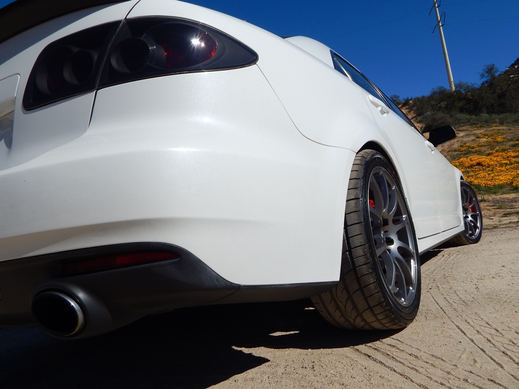

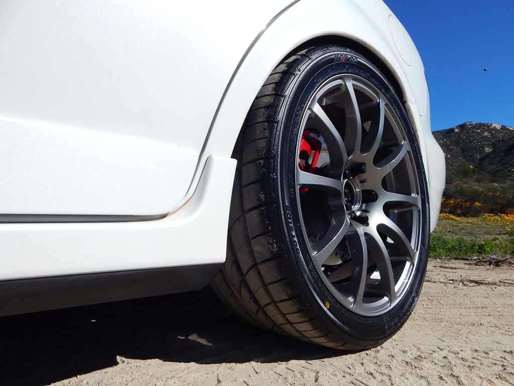

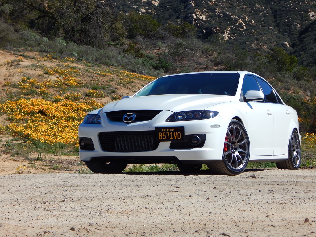

Couple notes before pics here.
You pretty much have to have the right combo of tire/wheel/offset/roll/pull/camber. Not just any 265 would have cleared, I had to do a spreadsheet of section widths/heights and find a smaller running 265 (Sumitomo HTR Z III). A large running 265 would 100% cause rubbing issues on inside front knuckles and rear fenders.
This setup clears a few mm on the inside knuckle (~3mm) up front and maybe 1-2mm on the back fender with a roll/light pull/-1.5 camber.
Minimum specified wheel width of 265/35 is 9". I did a ton of research on this. A lot of EVO/STi guys that track their setups run 265s on their OEM wheels. They seemed to like it.
This wasn't something I had to do. I was up for tires and wanted to try something different. I got some UHP Sumitomo HTR z III.
Steering feedback is awesome. I instantly noticed a little more wandering on the highway, the setup kind of hunts down the road. I guess the tires must be a little wider than the worn grooves on the highway. I can't wait for a canyon run.

Yes please. I love how it looks, what is your ride height at? (Center of wheel to fender)

I'm on H&Rs and Bilsteins. I can take a measurement later.

Stuffing a wide tire on a narrow wheel doesn't gain you anything but sloppy sidewalls and decreased response. The higher pressure it requires to keep the sidewalls from rolling over decreases grip.
A 245 wide sticky tire on that wheel would gain you more response and grip than a wider/less grippy tire.

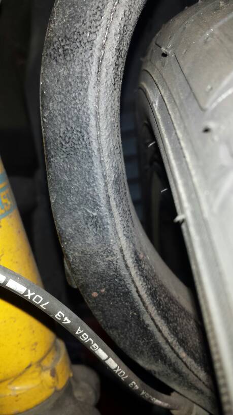

That knuckle clearance is good news, I thought we had to go with 5mm closer max, but your setup is 15mm closer.
Please stop going to Evo/STi guys for advice or "research." It's the blind leading the blind as evident by running 265's on OEM wheels, and no one is sharp enough to question it.
We are certainly guilty of the same over here @ MSF, so I am not casting any stones I wouldn't otherwise cast this direction.
For DD & such, the setup certainly works, but you have not increased response or lateral grip so don't be disillusioned into thinking you have made improvements in those areas.
For DD & such, the setup certainly works, but you have not increased response or lateral grip so don't be disillusioned into thinking you have made any improvements in those areas.
Fair statement on EVO/STi guys.
Definitely not disillusioned in the least. It was a do it to see if I could since no one else has kind of exercise which is also why I got a cheaper low treadwear UHP setup. Just doing all of the measurements for fitment was fun and seeing it work how I planned.
The setup will be fine for my DD and occasional canyon runs. I'll burn through them in a year and move on, if the car doesn't implode first.
Here's clearance off the knuckle.

Inside clearance is fine. Fender clears by 1-2mm or so at full compression. This is with a full rear roll, shaved down rear bumper mounts and a slight pull. As Goldmember would say it's toight, yes, yes, very toight.
I understand where the race guys are coming from. It's isn't necessarily an optimum setup for performance and they wanted to be clear of that. Again, to quote Goldmember-
