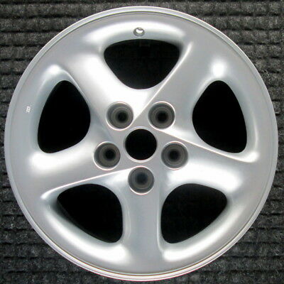

If you have a speed3, 16inch open mag wasn't a problem for me, i never get brakes overheated, but i had HP+ pads and may not drive has hard as peoples do in Russia :-)
i think i used 215 55 16 to have them to last more than few months...
It doesn't fit at all on a speed6 unless you swap front brakes from a normal6
Minimum is 17inch despite ms3 and ms6 have the same rotor size, the caliper takes more space...i learned it few months ago.
i use these 16inch wheels, the offset was a bit agressive and the rear was rubbing a bit on stock coils. i rolled the fender a bit to fit 245 on RX8 wheels for summer and it solved this too at the same time.
https://www.picclickimg.com/d/l400/p...-OEM-Wheel.jpg
