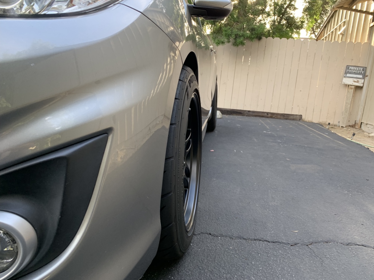

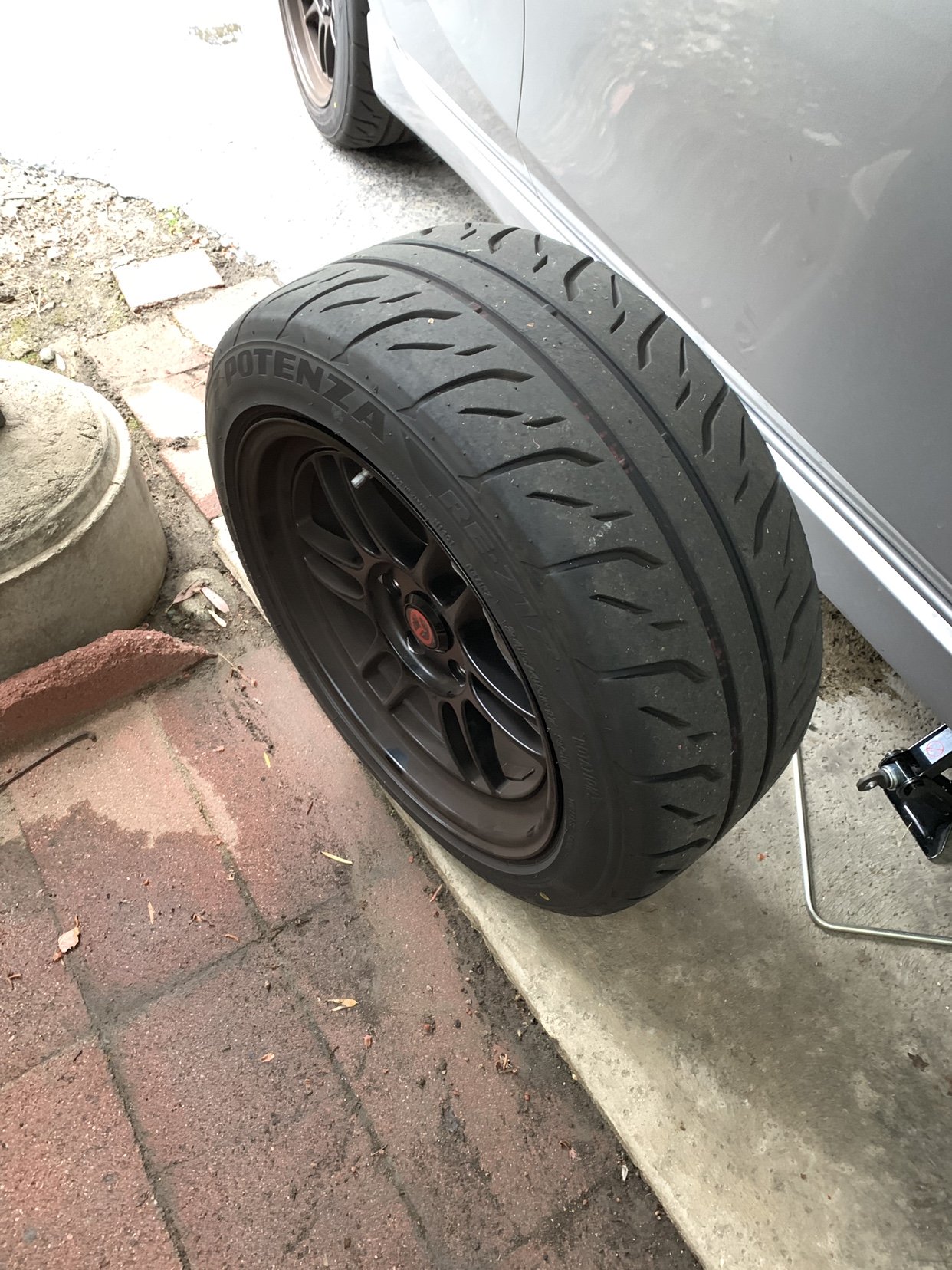

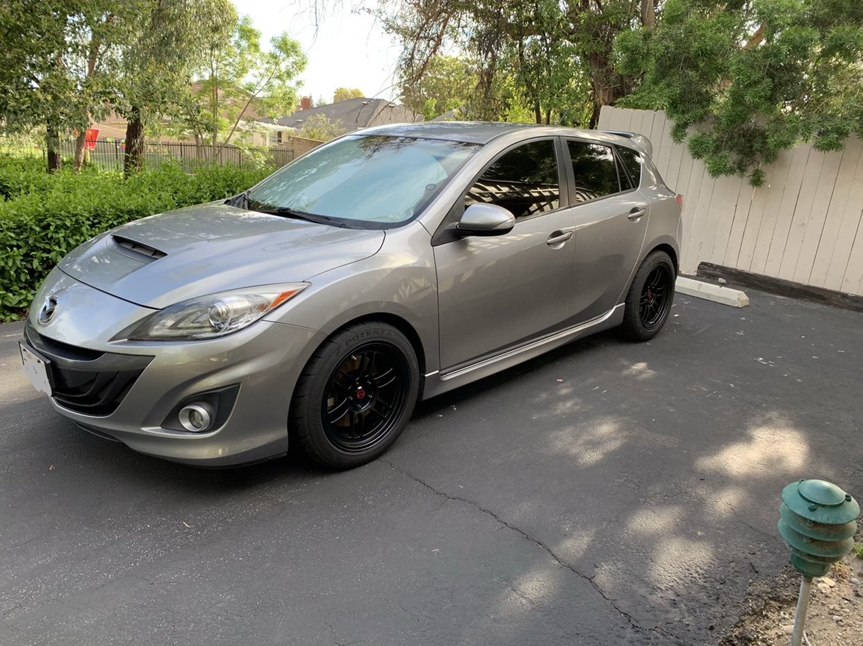

I just put this exact setup on my Pu a few weeks ago, still stock suspension. I had to add 5mm spacers to give more strut clearance, but otherwise no issues. No roll required, no rubbing. That being said, it痴 a tight fit.
Setup is 17x9 +45 RPF1s with 245/45R17 RE-71Rs.
I知 thinking of going with 255/40R17 once I wear these out. Kind of expecting to need a roll at that point.

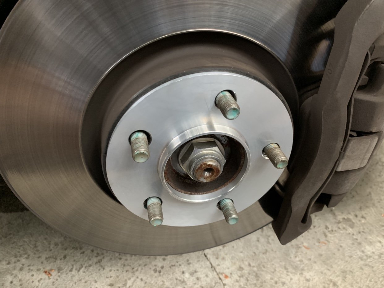

They池e custom spacers from Motorsport Technology.
I tried the JBR 5mm spacers, but the hub doesn稚 protrude enough for the wheels to center when using them, and I couldn稚 get rid of vibrations at >70 mph. Also the lug nuts kept loosening up on me. Was a little too sketchy for me to do 4th gear pulls.
Spacer specs:
Thickness: 5mm
Hub center bore diameter: 67.1 mm
Bolt Pattern: 5x114.3 mm
Wheel center bore diameter: 73 mm (RPF1 bore diameter)
Pricey maybe, but the wheels center properly now.

I tried the JBR 5mm spacers, but the hub doesn窶冲 protrude enough for the wheels to center when using them, and I couldn窶冲 get rid of vibrations at >70 mph. Also the lug nuts kept loosening up on me. Was a little too sketchy for me to do 4th gear pulls.
Spacer specs:
Thickness: 5mm
If you're using a tapered seat lug (like the stock ones), you don't need a hub centering ring. The wheels are lug-centric.
I run ~20mm of stacked spacer without a centering ring and have no issues. It sounds like you had other issues if your lugs were coming loose.
