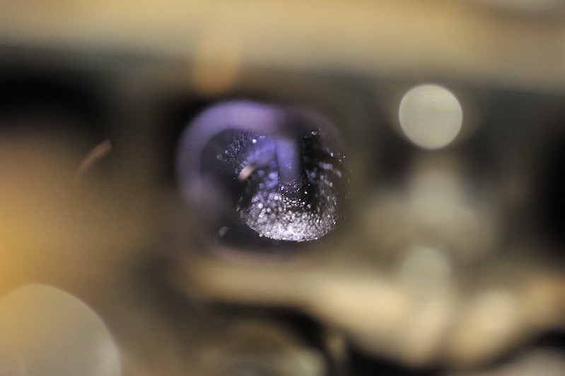

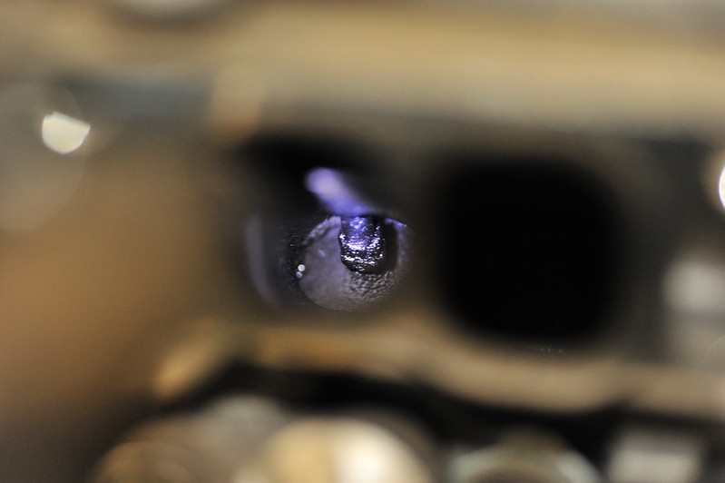

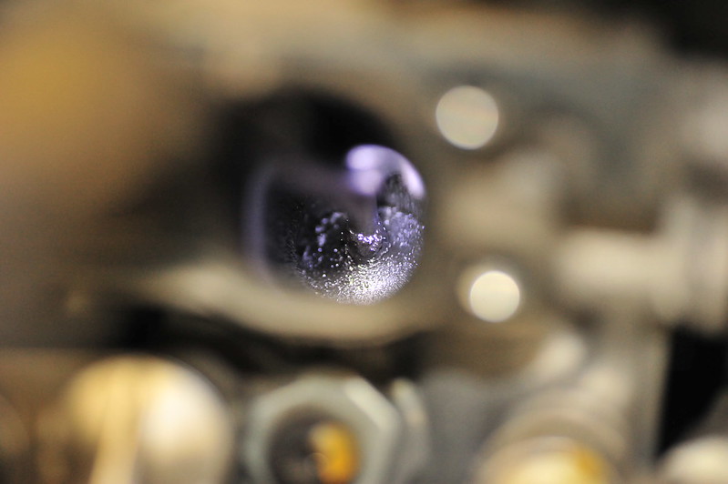

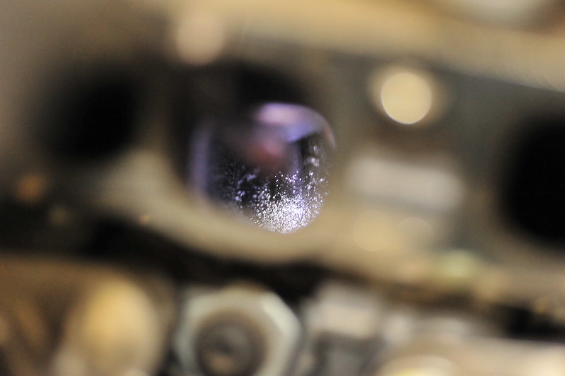

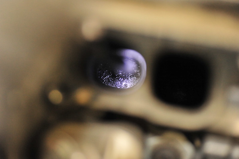

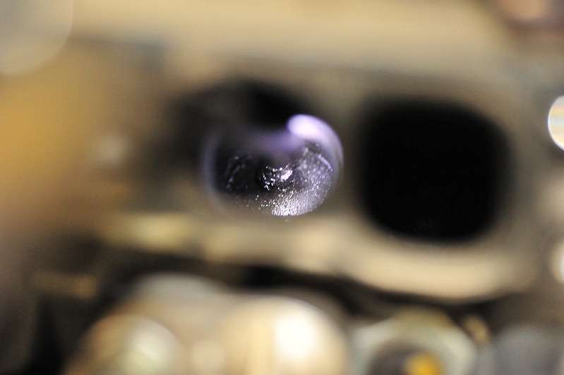

Posting if anyone is curious to see what the valves look like for a speed3 with methanol injection, EGR blocked off and OCC.
Car Details:
Mileage: ~92k kms
EGR blocked off since ~30k kms
OCC since ~30k kms
Methanol injection since ~60k kms
Seafoamed 4x, as recentlly as ~8k kms ago
Oil: Mostly Rotella T6 5w40 but have since switched to Redline 5w40 to reduce deposits.
Driving style: 100% city driving
Diagnosis:
TB, Intake manifold and VTCS flaps were pretty clean. VTCS flaps had minimal carbon deposits. This is where methanol injection helps keep things clean. The carbon around the valves was moist, sticky and paste like.
#1
#2
#3
#4

92,000 km aint much.
I recommend you drive more.

Did you end up cleaning valves? If so what did you use? I ask because I just started my cleaning with similar setup
