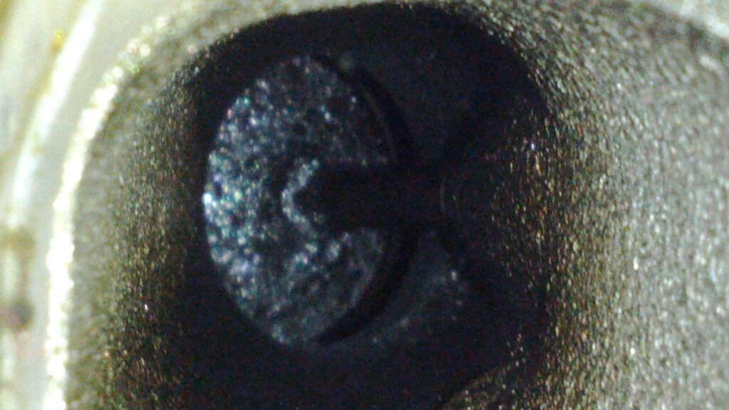

My nasty valves. This was the direst one closest to driver side. If counting from passenger to driver side my #3 was damn near just coated but not oily gunk on it

Home Depot also sells a fitting for the Shop Vac if you have a larger diamater hose from the vaccum which will fit perfectly to the end of the clear tube.

Originally Posted by jacek3743 View Post
I regret not doing this earlier.... At 120k, i had to have two beers to keep me from losing my shit. At the beginning I had problems with the gun, as previous post suggest, take the gun apart and drill/file the hole of the hopper and gun to be bigger, otherwise you'll have the walnut stuff jamming up constantly.
wow that is a huge difference, how did it run after?
