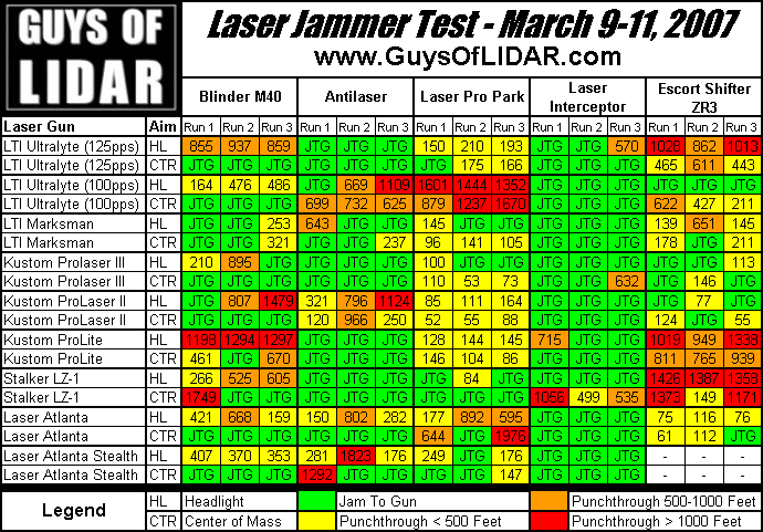

Radar Detector Tests and Reviews by Guys of LIDAR
Guys of LIDAR - Laser Jammer Test - March 2007
