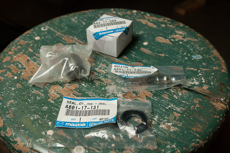

First I ordered the part #s specified by “leo766” which are:
Bearing - A60217204
Breather - A60117530
Seal - A60117131
I’d like to thank Avondale Mazda @ Avondale Mazda Parts for the parts. Great prices and much lower shipping compared to some competitors.
Did this on my 2007 with 126,000 miles. It just started gushing one day after I had to slam on the brakes. If I knew it was a problem I would have done it before hand, guess I should frequent the forums more. Thanks to “jtaylor” for pointing me in the right direction.
ColdasFuk
Note: A lot of these steps could be skipped depending on what you’re replacing and how you like to work. I’m not in a rush when I work on my car so I was thorough and clean.
Here’s the parts:
ms3_pivot_shaft_seal_replacment-001

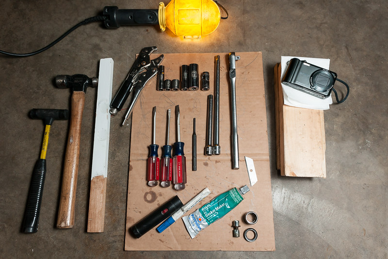

Here’s the tools I used in case you want to have them ready:
(You don’t need them all but I like to make things easy)
ms3_pivot_shaft_seal_replacment-063

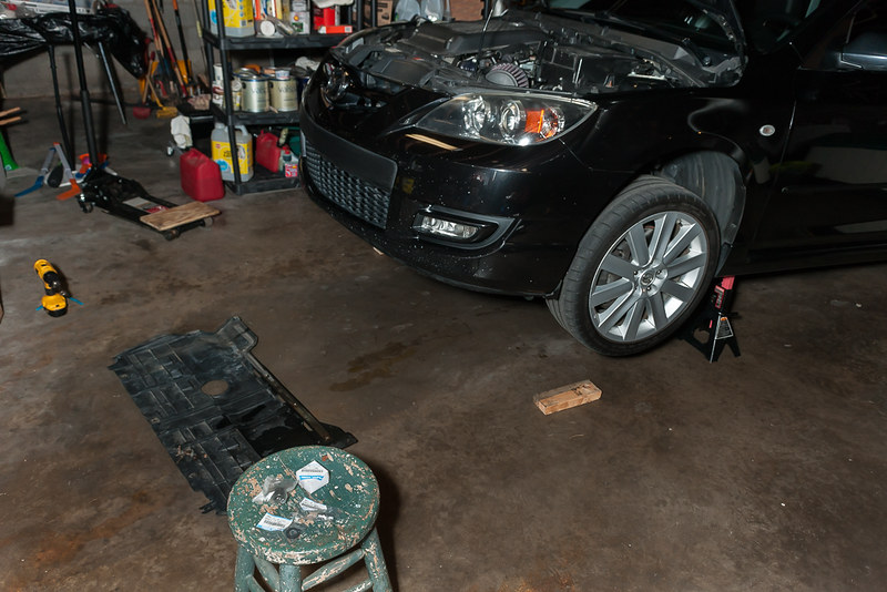

I jacked the car up, I’m tall:
ms3_pivot_shaft_seal_replacment-002

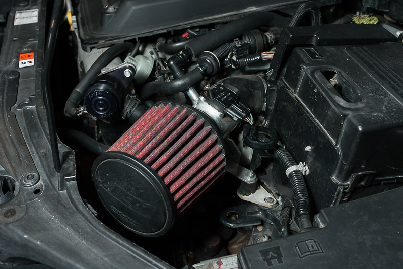

Remove whatever intake you have:

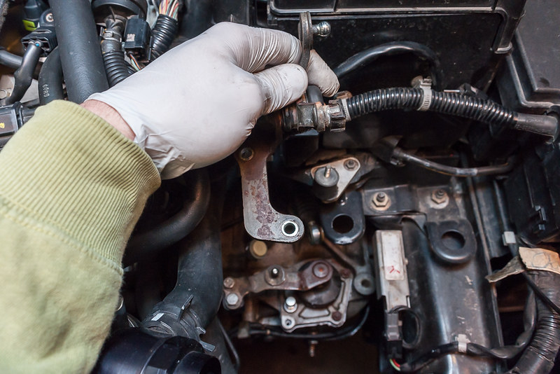

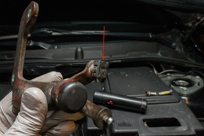

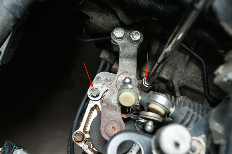

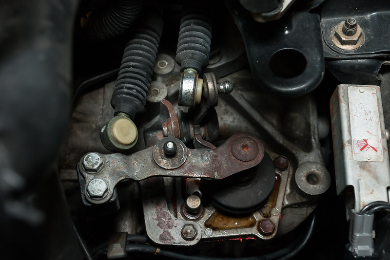

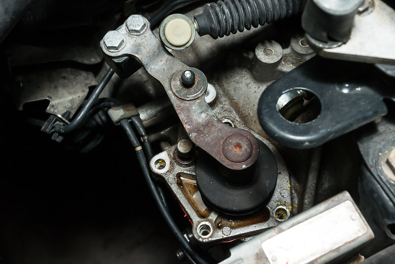

Pop off the shift linkage. I used two small flat heads on either side.
ms3_pivot_shaft_seal_replacment-004

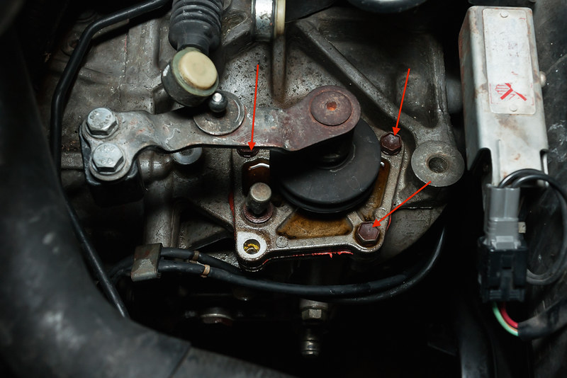

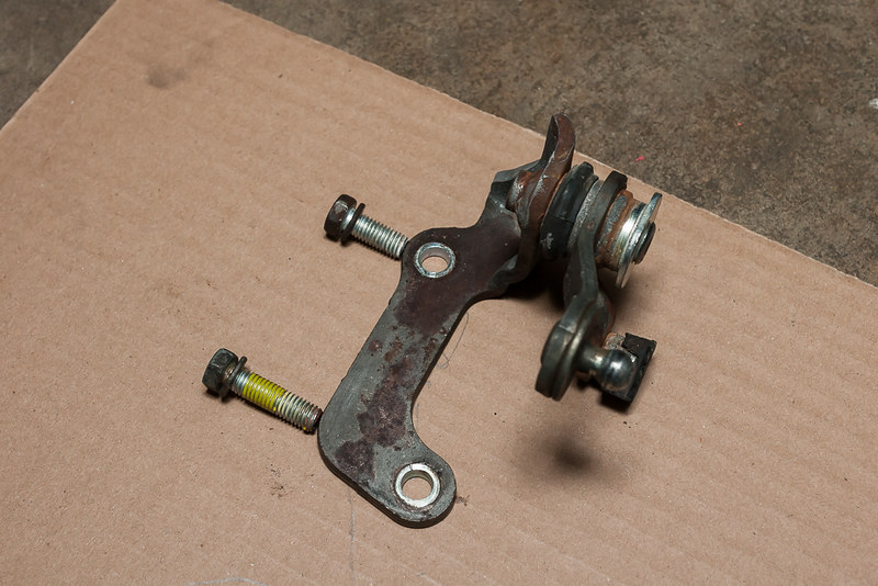

Take out the two 12mm bolts holding the shift mechanism on:
ms3_pivot_shaft_seal_replacment-005
The shorter bolt goes in the back:
ms3_pivot_shaft_seal_replacment-006
I think this is the clip some people were referencing that could slide off into the trans. Since you take this part off before you take the pivot shaft out, just make sure it’s accounted for:

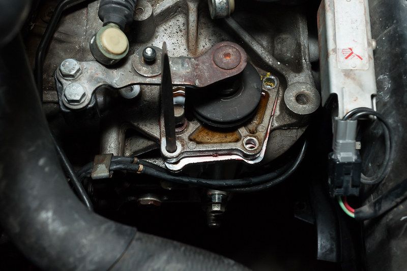

Next take out the other three 12mm bolts that hold the shaft in:
ms3_pivot_shaft_seal_replacment-007
ms3_pivot_shaft_seal_replacment-008

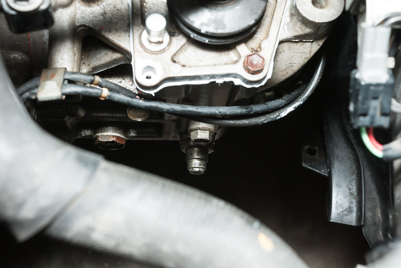

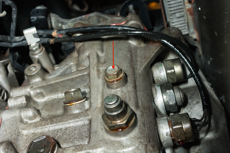

This 14mm bolt is has the guide pin for the shaft so it needs to come out to pull the assembly out:
ms3_pivot_shaft_seal_replacment-009

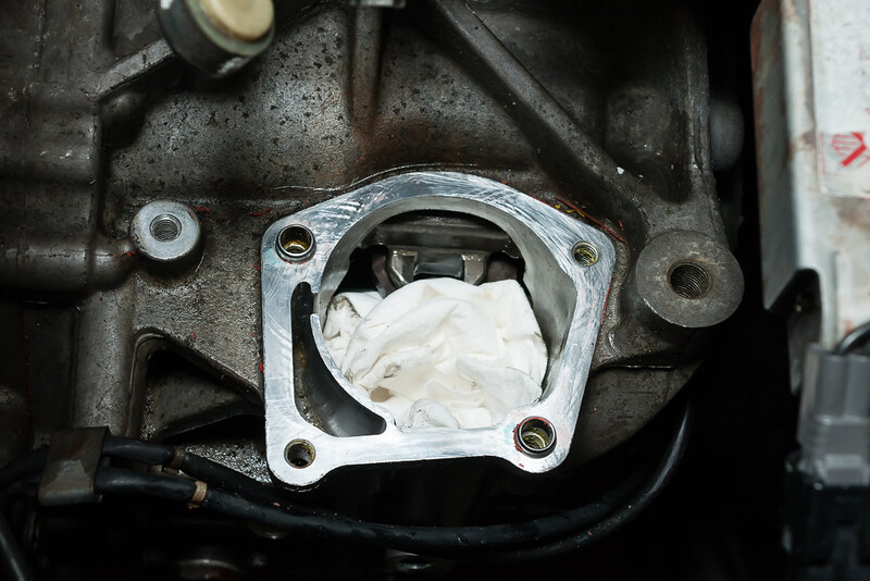

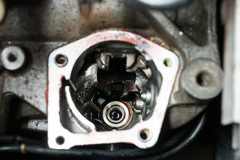

The inside, keep in mind you’ll need to fit the pivot shaft into that bearing in the bottom. It’s easy to get back in if you realize what you’re doing:
ms3_pivot_shaft_seal_replacment-011
Don’t get anything in there, you’ll need to clean that surface sometime before the final assembly. I use a razor and drag it away from the blade. Also put a rag in there to catch any accidental drops:
ms3_pivot_shaft_seal_replacment-012
ms3_pivot_shaft_seal_replacment-039

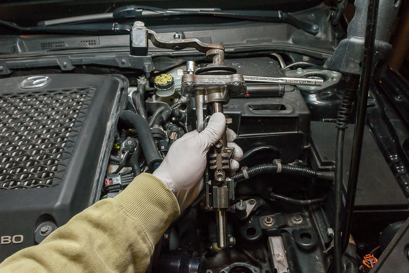

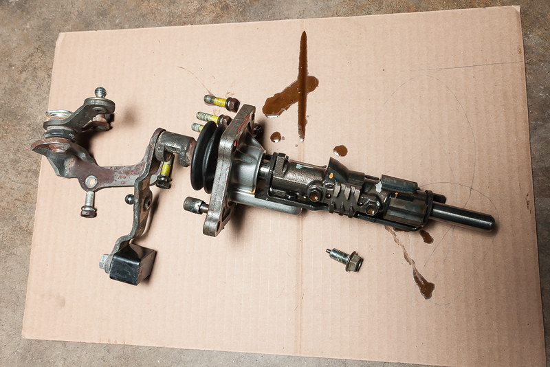

Pull the assembly up and out, you’ll need to tip it forward a bit to get past the intake mount. Lay it down on something clean:
ms3_pivot_shaft_seal_replacment-013

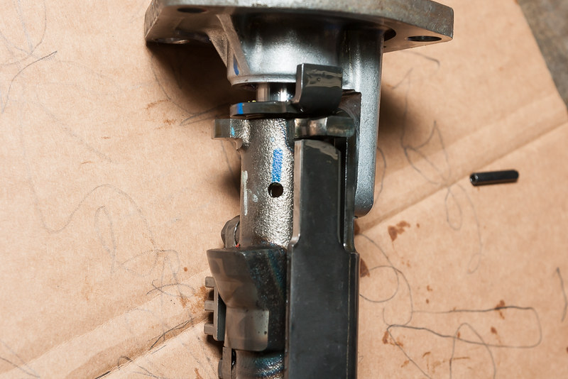

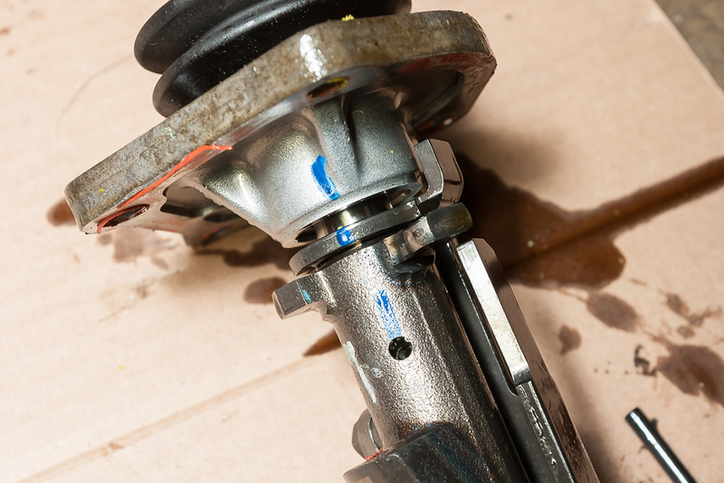

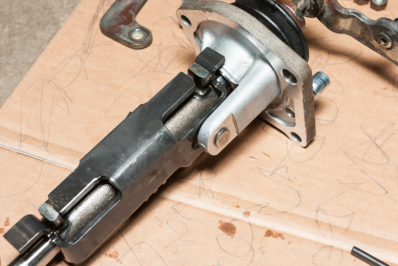

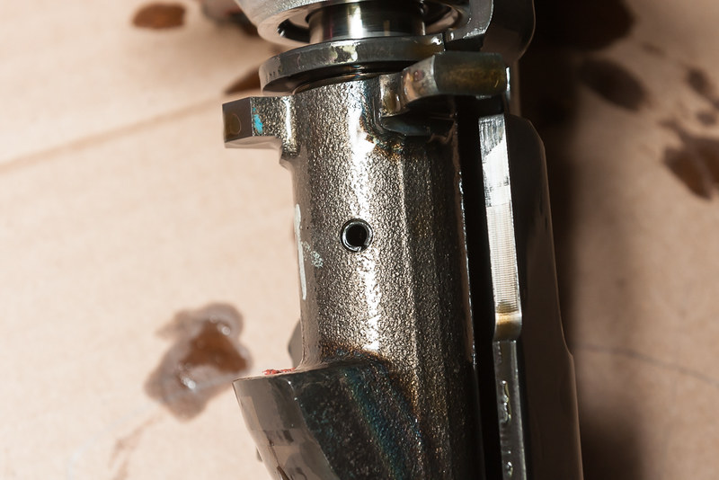

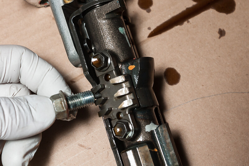

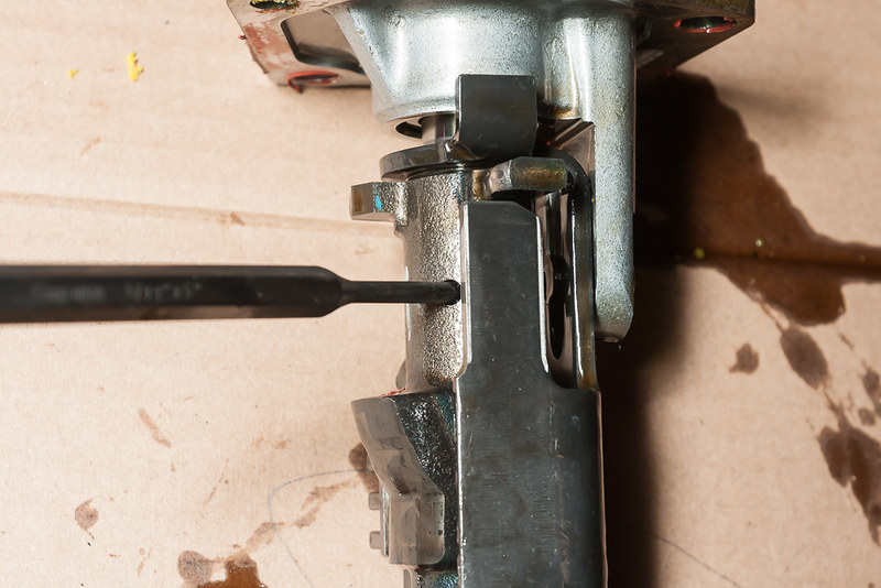

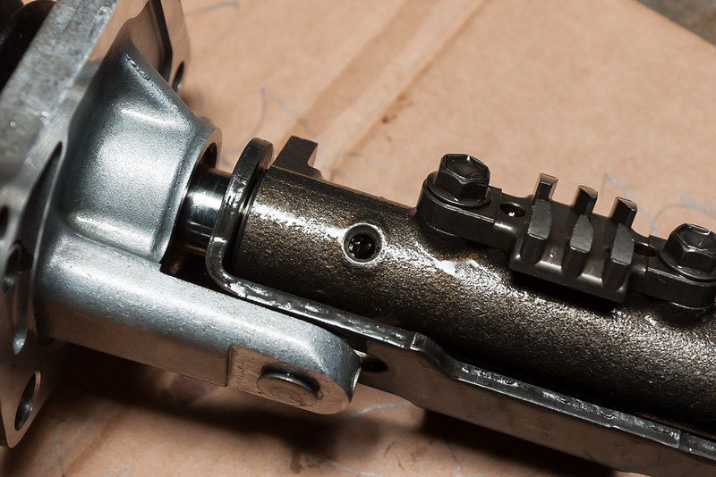

This pin has to come out. There’s two sides; one’s beveled, the other isn’t. This is the side it will go back in:
ms3_pivot_shaft_seal_replacment-016
This is the side you’ll tap it out from. I used a 5/32 punch:
ms3_pivot_shaft_seal_replacment-017
ms3_pivot_shaft_seal_replacment-018

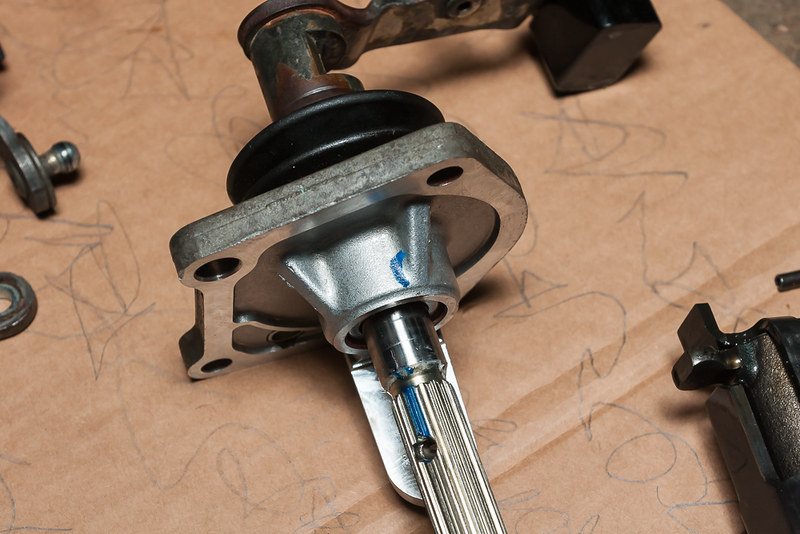

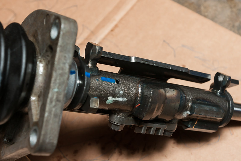

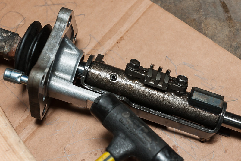

Whenever I take things apart I mark them with a paint marker, good habit. Although this only goes one way, so you don't need to, but it’s still handy:
ms3_pivot_shaft_seal_replacment-019

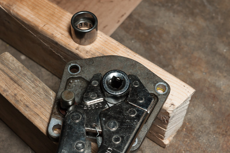

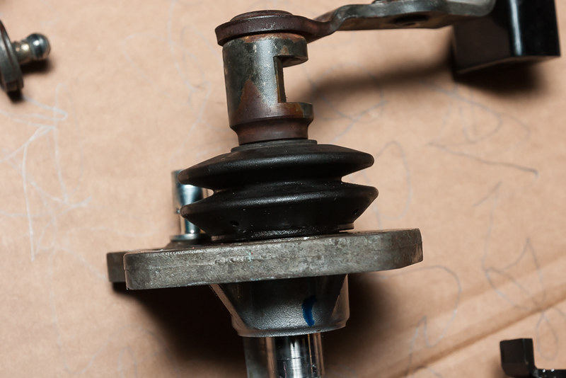

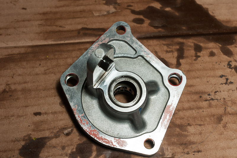

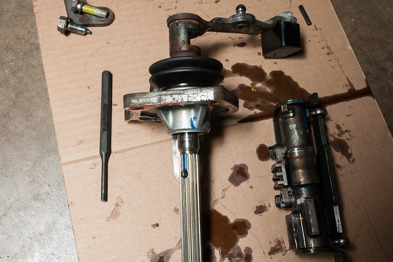

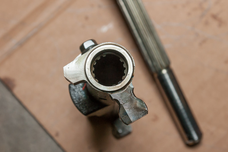

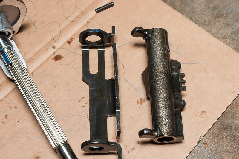

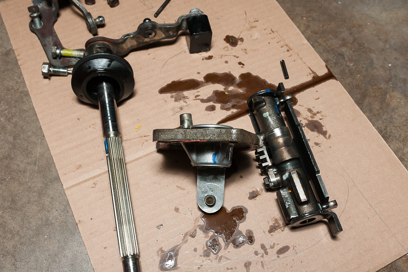

Slide the piece off the shaft and then remove the boot from the plate:
ms3_pivot_shaft_seal_replacment-020
ms3_pivot_shaft_seal_replacment-021

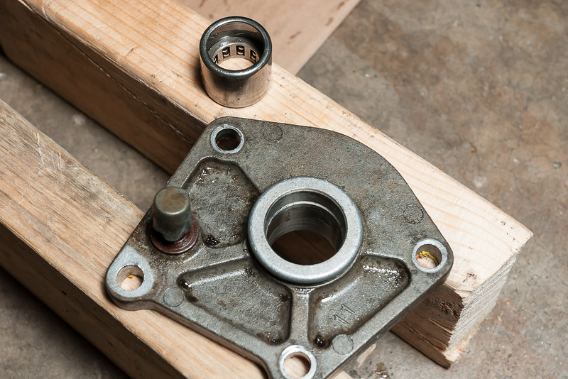

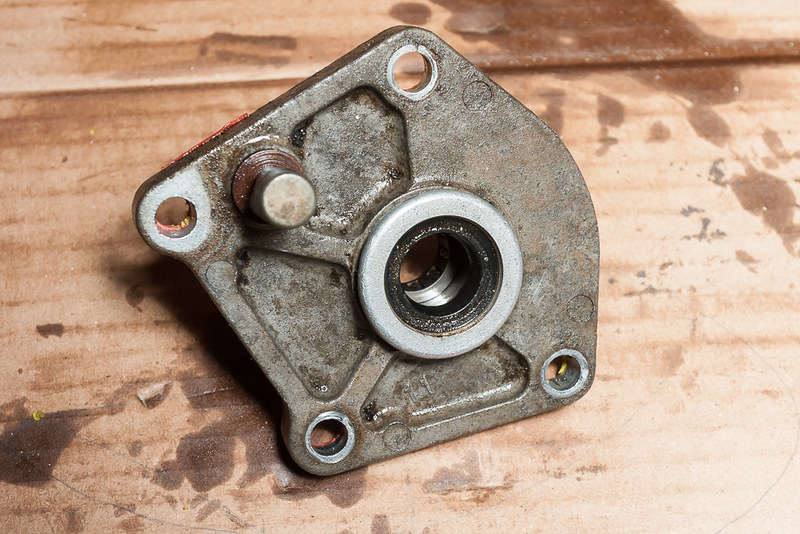

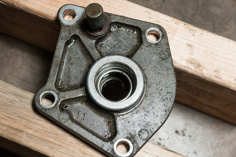

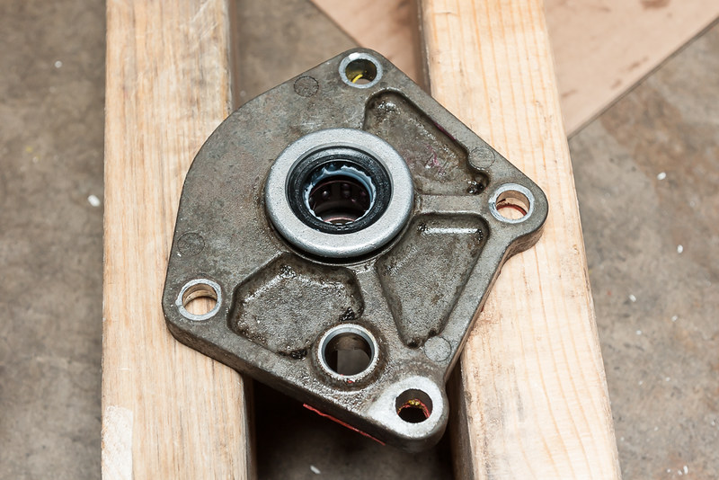

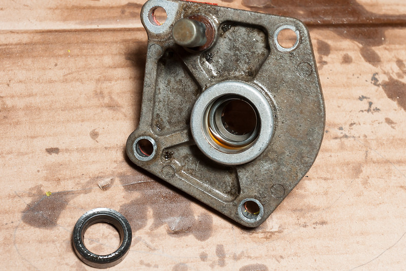

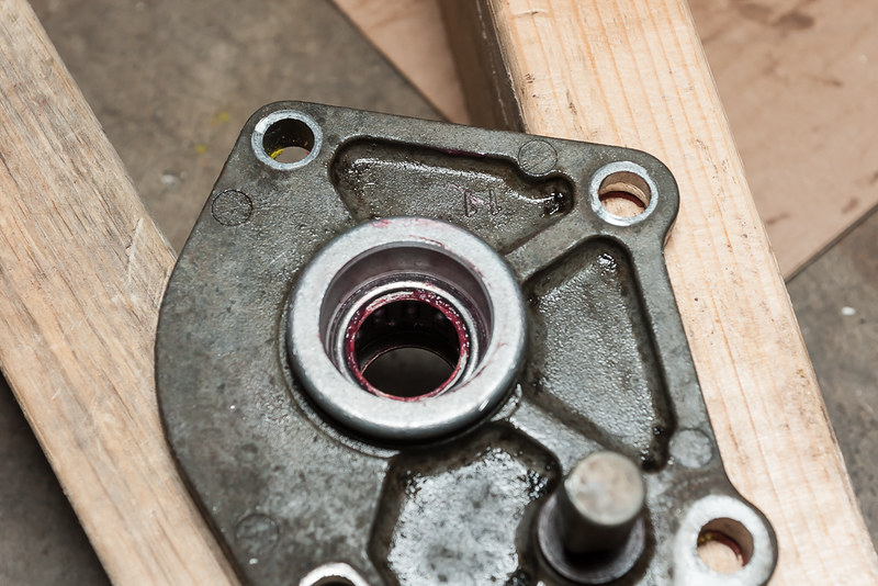

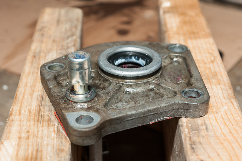

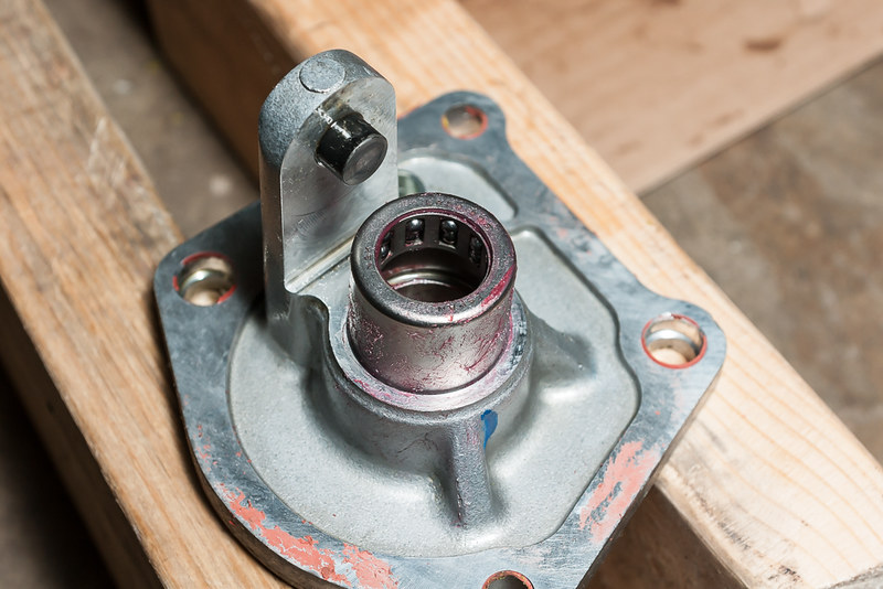

This is the piece that has all the parts you’ll replace. Here is the seal:
ms3_pivot_shaft_seal_replacment-022

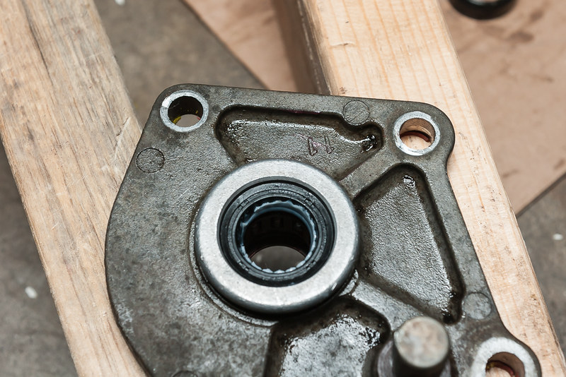

The bearing:
ms3_pivot_shaft_seal_replacment-023

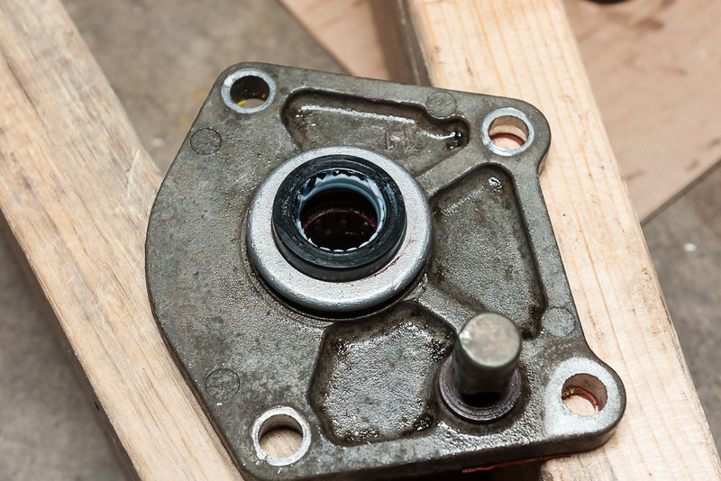

The seal came out really easy, I used my finger. If you need to get a screwdriver, just don’t maul the wall inside:
ms3_pivot_shaft_seal_replacment-024

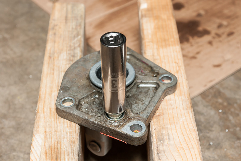

I put it on two 2x4s and used a 19mm deep socket with a hammer to tap the bearing out. Also used a pair of vice grips to hold the socket, I don’t have the best aim with a hammer and it’s easier to hold. Always use safety glasses when hammering:
ms3_pivot_shaft_seal_replacment-025
ms3_pivot_shaft_seal_replacment-026
ms3_pivot_shaft_seal_replacment-027
Make sure everything is very clean when you put the new bearing in. I applied some synthetic grease (mobil1) to the bearing to help it slide in. If you have a bearing press, great use it. If not a clean cloth, wooden board, and hammer will work just as good. Just take it slow, tap it in a little and make sure it’s straight. Once it’s in as far as you can get it with the wooden board, use the 19mm to go the rest of the way:
ms3_pivot_shaft_seal_replacment-028
ms3_pivot_shaft_seal_replacment-029
Turn it over and make sure you’re in all the way to the lip. Don’t beat it in too hard or you’ll damage it:
ms3_pivot_shaft_seal_replacment-030
The seal goes in this way. I didn’t need to hit it in, just pushed it in evenly with my fingers. Again don’t push it in too far, just past the edge:
ms3_pivot_shaft_seal_replacment-031
ms3_pivot_shaft_seal_replacment-032

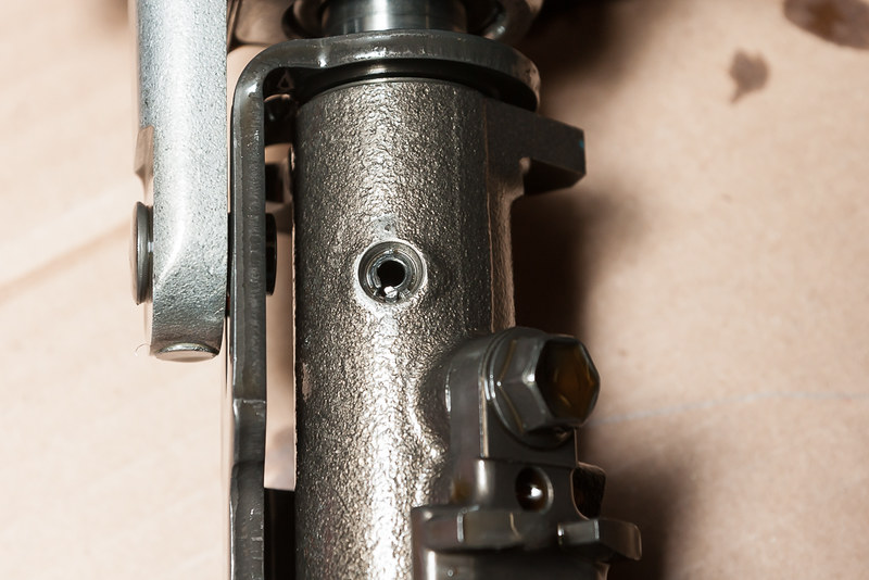

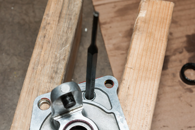

I used that same 5/32 punch turned around to get the breather out:
ms3_pivot_shaft_seal_replacment-033
ms3_pivot_shaft_seal_replacment-034

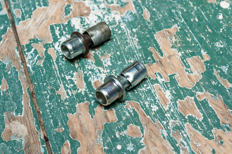

A 13mm deep will go over the vent but catch the lip to hammer it back in:
ms3_pivot_shaft_seal_replacment-036
ms3_pivot_shaft_seal_replacment-037
ms3_pivot_shaft_seal_replacment-038
Slide the cover back onto the shaft and attach the boot:
ms3_pivot_shaft_seal_replacment-040
ms3_pivot_shaft_seal_replacment-041

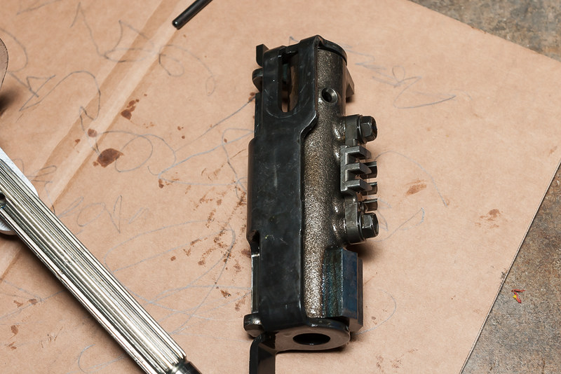

If this piece came apart, it’s no big deal, it just slides over it:
ms3_pivot_shaft_seal_replacment-042
ms3_pivot_shaft_seal_replacment-043
You can see how this only goes two ways, but if you do it the wrong way the pin hole won’t line up:
ms3_pivot_shaft_seal_replacment-044

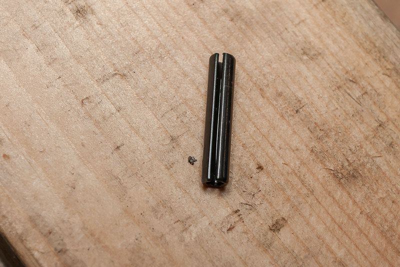

When you put the pin back, hammer it in from the beveled side. Also the pin should have a slight taper. Put the smaller end in first. It should be just flush with the back side:

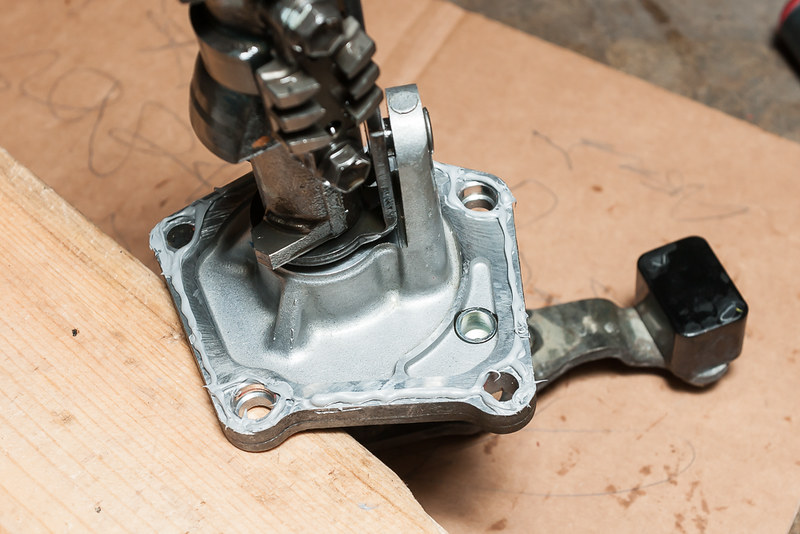

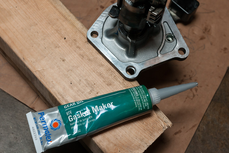

I used Permatex gasket maker. It’s made to resist gear oil, specifically the additives for LSDs. Whether this is bullshit, idk. Be aware that this stuff takes 24hr to cure, you may want to opt for a different kind if you can’t be down that long:
ms3_pivot_shaft_seal_replacment-053
ms3_pivot_shaft_seal_replacment-062

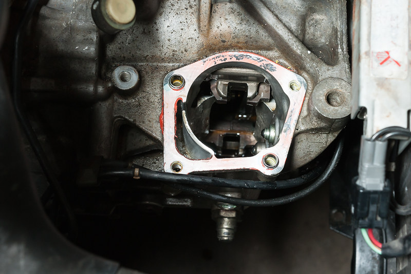

Make a small bead around. I go around the bolt holes as well. Keep the stuff to the outside edge since it’ll squish in:
ms3_pivot_shaft_seal_replacment-054

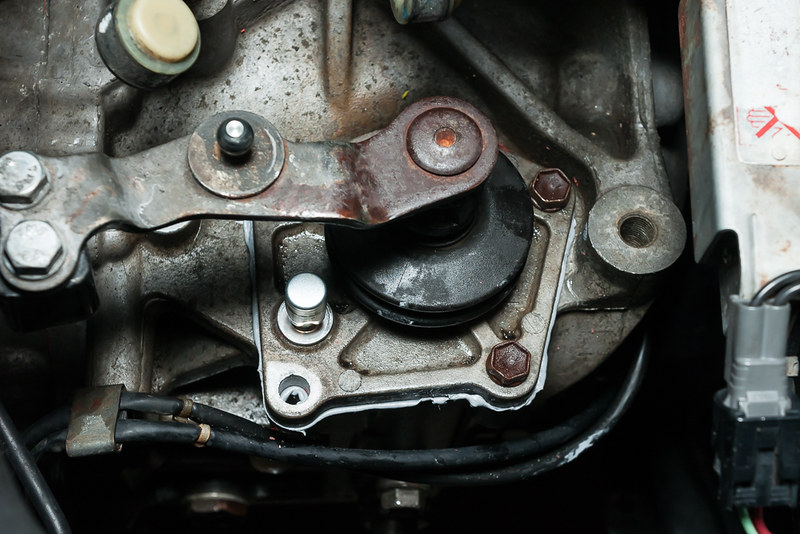

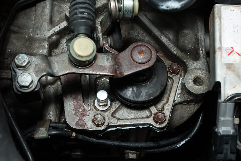

Here’s the big deal, put this mother fucker back in. This is how it should look when you’re ready. Make sure there’s NOTHING down in the hole. Be careful, don’t hit the sealant on anything. Remember you’ll need to have a slight angle to get it past that intake mount. There’s also that hole that you’ll need to line the shaft up in; it’s directly centered. If it gets to the bottom and won’t go the last inch, turn the shift mechanism a little back and forth and it will go. Be patient, be cool, you’ll get it in:
ms3_pivot_shaft_seal_replacment-055
Once it’s in put those three 12mm bolts back, but don’t tighten them down yet:
ms3_pivot_shaft_seal_replacment-057
Put the 14mm bolt in:
ms3_pivot_shaft_seal_replacment-058
Put the other piece of the shift mechanism in. See how it goes:
ms3_pivot_shaft_seal_replacment-059
Put the other two 12mm bolts in and tighten the four main ones in a criss cross pattern. I don’t have the torque specs but I did them around 15-20 ft/lbs:
ms3_pivot_shaft_seal_replacment-060

I just did the swap this past weekend. Big thanks to @DynoBunny; for the how to. This repair is not in the factory manual, so if you go to the dealer they will tell you the whole transaxle needs to be replaced.
Couple of notes:
You can order the whole plate (#A60117470) which comes with a new boot, seal and bearing already installed. The only thing you have to buy is the breather. Its a lot more money, but its the only way to get the boot if yours is fugged up. Plus you dont have to worry about switching out the bearing.
I did the install without removing the guide pin. As long as the shift mechanism is in the neutral position it will come out. That being said, it would be a lot easier to just remove the pin. My OCC hoses were in the way so I chose the lazy but harder way.
I got hung up that last half inch or so. Took me 4 tries to finally line it all up. I kept letting the shift mechanism turn too much and it would line into the last notch. Patience is definitely key here. I may have messed up the RTV while doing this, so I will monitor it closely.
Overall it probably took maybe an hour or so with someone helping me. I will drive it a bit and do a fluid swap when the weather is a bit nicer, just in case any crap got in there.
Good to know you can get the whole plate with everything installed, I never even thought about that. I'm sure the RTV will be fine, there's no pressure on it so it just needs to prevent the fluid thats sloshing up from spilling out.

I just did this. And without taking the whole intake out.

Thank you very much for posting this guide! Unfortunately we did not have a press so we just left the original bearing in place. The local mechanic shop here quoted me $400 for the repair (without the parts) and said the car will need to be left in the shop for a day. We did the fix ourselves and the only hassle we came across was getting the assembly to come off the casing (the chisel trick wasn't working). Had to wedge a tire rod and slowly ease it off.

You don't need a press to remove or install this bearing. The how to explain how to do without one. Replacing that bearing made shifting a number night and day difference.

Yeah we tried tapping it out with a 19mm deep well but we just couldn't budge it. I didn't want to risk damaging the bearing and then having it stuck inside.
