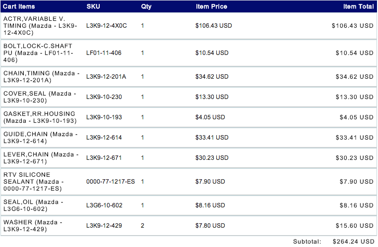

Question on the parts....
I went into mazda today and this is the list they gave me:
1. LF01-11-406 : Crankshaft Bolt : 17.91
2. L3G6-10-602 : Seal, Oil : 13.87
3. L3H5-11-407 : Washer(3) : 66.12
4. L3K9-12-201A : Timing Chain : 58.80
5. 0000-77-1217-ES : RTV Silicone : 13.42
6. LFBL-10-237 : Washer, Sealing-head Cover(14) : 190.54
7. L3K9-12-193 : Gasket, RR. Housing : 6.88
8. L3K9-10-230 : Cover, Seal : 22.60
9. L3K9-12-4X0C : ACTR, VVT : 163.96
10. L3K9-12-429 : Washer(2) : 13.24
11. 9XG0-99-667L : PlugBlind : 4.06
The total comes out to be 584 bucks. I've seen all over people saying between 3-400 for parts, so is mazda just throwing things in here that I dont need? Also the mechanic I'm having do this said sometimes you need to replace the timing chain guides as well, anyone do this on theirs?

I just bought parts off partsvp.com for a fraction of the normal cost. They are being sent from Rosenthal Arlington Mazda Parts Store, I looked all over to get a good idea of what parts are really necessary and which aren't. Obviously depends on the car... here is the list I came up with and the prices.
EDIT: I bought the timing chain guides, for some they don't need them but I am at 80k and figured it was worth it. And if you end up not needing some of the parts you can return them for a full refund.
