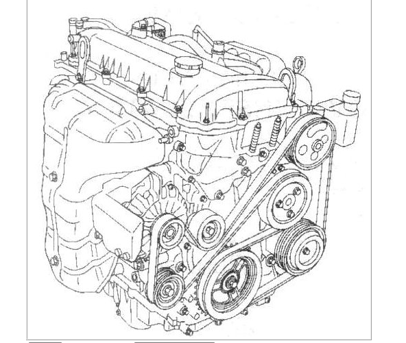

Before we get started I want to suggest taking off the hood. I never used to remove it before with small stuff. But something this in depth, I HIGHLY recommend removing the hood for ease of work about to be done.
DISCLOSURE
So let’s get started!
Jack up the car, support on jack stands.
DRAIN OIL!!!!
Then:
Remove all the following:
Passenger wheel and any fender liners that are blocking the Crank pulley.
Skid Plate (but who has one of those?)
TMIC or FMIC Piping covering the VC
Coil packs and spark Plugs (removing plugs will make the next step easier, as there will not be any pressure building up in the cylinders when you spin the crank)
From there, I have always broken the crank bolt free as the motor is probably still warm. (Go ahead and remove your serpentine belt since you’re in the area).
Locate your tensioner pulley (14mm wrench)then pull clock wise to break tension, The pulley located is the lower left pulley in photo,(also save this picture for belt routing when reinstalling later)
Remove stock TDC bolt (10mm) from block and replace with TDCP found here:
Next, grab a 1/2" Ratchet with a 21mm Socket and slowly spin the crank till the crank stops on the TDCP. Your Crank Pulley Will line up with a threaded hole on the Timing Cover (this is where you will place the M6x1 bolt (10mm)) Notice bolt on pulley in picture below:
Now grab your marker. On the Crank Pulley there is a spot that should now be at the top where there is a tooth missing. You should be able to count 20 teeth towards the crankshaft position sensor (CKPS) or counter clockwise. (I believe its 20 teeth someone correct me if I’m wrong) make sure that 20th tooth is lined up with the center mark on your CKPS. Then use your handy dandy marker, and mark that tooth on the face of the crank pulley (this will help with aligning everything up later when re-timing the motor)
To remove the Crank Bolt, do this by using a 500+ft lb capable impact gun with 21mm socket or use the Crank Pulley Bolt (M6x1) or have someone sit in the car hold the brake and put the car in 6th gear (this will be needed in some cases later on so remember that. Once the bolt is broken free, remove crank bolt, pull the crank pulley off, then lightly hand thread the crank bolt back on till it stops (DO NOT TIGHTEN!you should be able to spin it back off by hand, this is so you can turn the crank back to TDC if it somehow spins out, Just a precaution I tend to take). Go ahead and grab your marker again and draw circles around the bolts holding the CKPS in place, then remove your CKPS (2 8mm bolts) and set that aside!

From here we are going to remove the Timing Cover (TC).
There are three Primary bolts on the TC that are a 13mm they are all located on the bulk near the PMM mounting point, these will be the last to be removed and the first to go on during reinstallation. (Keep this is mind)
These Two that I am pointing at DO NOT need to be removed:
There are twenty four (24) bolts total that hold the timing cover on, this includes 3 13mm (located at the PMM mounting point) and the 10mm bolt for the idler pulley. there is also one (1) (located on the far bottom right of the picture directly above) that is a 13mm I believe (don’t let the ripple in the TC fool you, there is no pulley that goes there!) and the other 19 bolts are all 8mm, some are longer than others so keep them in order of where they came from.
Once all the 21 bolts are removed you may then remove the 3 13mm bolts from the PMM area. Go ahead and remove your crank bolt (that is finger threaded on remember)
Now grab your flat head screw driver and place it in between the TC and the intake cam bolt and pry while holding the top of the TC and pull it up from the top (You probably could go through the bottom but it’s just easier to go through the top)
