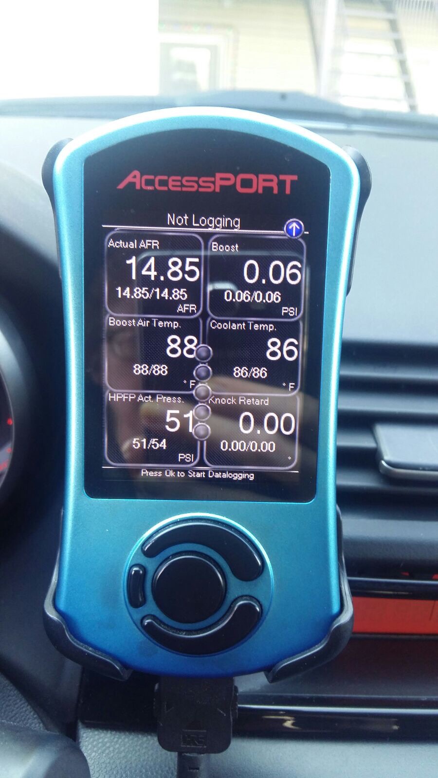

Hi guys,
I'm currently having some fueling issue and saw alot of replies in threads that says to do the KOEO test ... anyone can tell how to do it exactly?
Are those instruction ok ?
Warm the car up.
Then shut the car off while monitoring HPFP pressure.
Turn the key to the on position(car is still off) since the AP doesn't get data when key is in ACC position.
If fuel pressure builds slowly rail/relief valve is good.
If all you see is ~60psi (in tank pump pressure) rail valve is bad.
You will not see 60 psi immediately -- the fuel pressure will not build up but instead it will fall steadily to ~60 psi
Thanks !

Does the car need to be warmed up?
When I checked the fuel pressure this morning it was stuck arround 48-51 psi

yes, i think it should be warmed up. and it should go up and keep rising. could be the pressure relief valve if it doesnt
