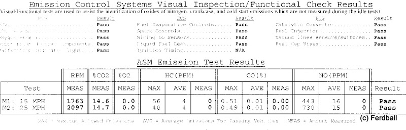

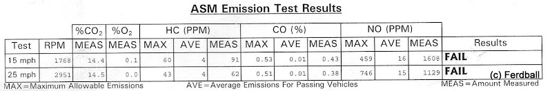

I tried to get smogged today. If you're in CA, then you'd better take off your downpipe before even trying. Yes, they'll notice.
Besides that, I didn't pass the emissions part of the test. It looks like my cat went bad. I've had this on for about 4 years now. Is this normal?

Okay, maybe. But I'm 100x above average in NO (PPM). I think there is a hole where my cat used to be. Going to have to stock out. I'll see if I can get a good picture.

The CPE cat and aftermarket 2way cats don't do much for NOx. You need a 3 way cat for that which the OEM is.
Also high combustion temperatures lead to high NOx emissions.

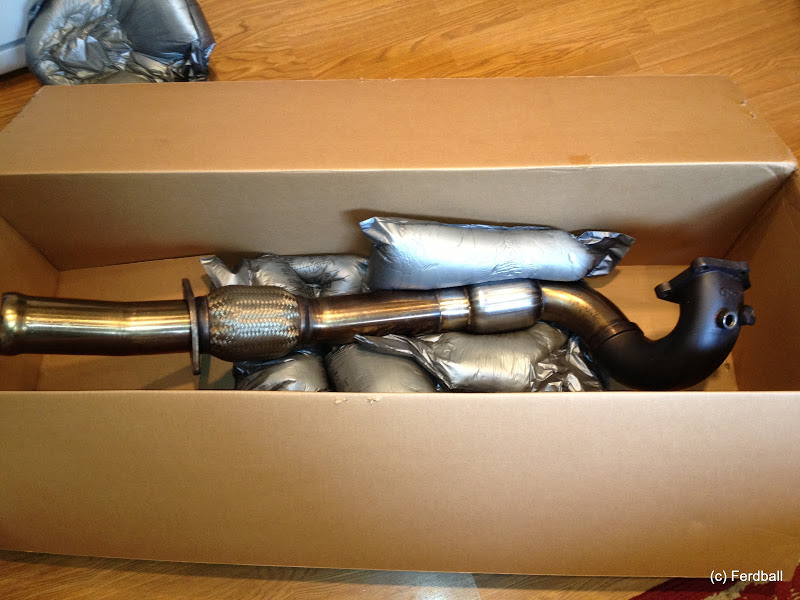

I asked you a question on Saturday. Would a picture of it new be of any value?
If you need proof that I got this new, I wonder if this would suffice?

You can ask for CP-E's help all day long, a brand new high flow cat will not pass CA emissions. They are the most stringent of all 50 states, that's why 99% of aftermarket parts are 49 state legal.
The only thing a high flow cat does is heat up to burn off un-burnt fuel, not as much science as those fancy spensive OEM cats.

So, you're saying this is normal? Here is a pre-test that I had to get done, about a year and a half after it was installed.
https://docs.google.com/spreadsheet/...nZ0U1E4WW1ETmc

The high flow cats do catalyze Co into co2 but they lose efficiency over time and contain a lot less catalyst than an oem cat so they will not pass emissions after a few years and need to be replaced.
The oems build the calibration of the vehicle around maintaining cat life and this is one of the reasons the disi falls on its face after 5500rpm on the stock tune.
I guess I just remember seeing a metal high flow with huge spaces that was put on some MUSCLE car that basically poor fuel out the headers. I just look at a magnaflow high flow I have and it is covered in some yellowish stuff on the fins
*EDIT*
If CP-E decides to help you out, you'll have to send it in, then you might end up being in the same boat in another year or two. If it isn't affecting performance, I'd switch it out and put the stock one back on.
I know when I was rolling in a Honda(I know ), the shop I went to in CO was thinking about making an emissions kit that had the stock manifold and cat for rent and install, maybe you could buy an ebay cheapo setup and weld in the stock cats. Just because I hear the shape of the stock DP is a PITA (I have have yet to install one) to take off and welding in both stock cats where it would be easier to remove might make doing it every year easier.
And thanks for not mentioning you already had a test done, fucking operator. That's like taking something in to get troubleshot and you don't give all the info.

Man, these OEM cats are super clean!
Ferdball is offline   Reply With Quote
The Following 2 Users Say Thank You to Ferdball For This Useful Post:
Celestspeed3 (12-28-2012), sidekick (02-18-2013)
 Old 12-28-2012, 07:08 PM   #30
Celestspeed3's Avatar
Posts: 1,136   (View Stats)
Rep Power: 1135
Thanks: 977
You sure they even ran the car, LOL
That's a big improvement.

Okay, I went by the shop and asked them about it. They said that the numbers are correct. I thought that maybe if a car was passing, that they would just fill the fields with zeroes because it didn't matter. But they said that the numbers are provided by the machine, and there's nothing they can do to change it. So this myth is BUSTED. The smog check numbers are VERIFIED.
P.S.: I'm going to clean my tailpipe and see how long that lasts.
P.S.S.: I still haven't heard from CP-e. I wonder if they're still on vaca.

$ 85 - Replace Cat
$150- Cat Spun Stainless Steel, 200 Cell MET Core High Load USA
$ 50 - S&H
$285 - 100% Covered under warranty
Can't complain about CP-e. Thanks Chunie
