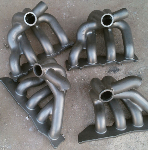

Just saw this on cp-e's blog.
cp-e
There's a picture of the cast tubular exhaust mani. Not quite what I was envisioning and don't see how it will flow so much better than any other mani on the market. Cast is nice though since you don't have to worry about welds cracking. Anyways, that is some good news and can't wait to see the turbo kits and standalone ECU's

i like the looks of it. curious to see how it performs

sickk!! Finally a high quality company building manis for us.

i have faith in cpe
jake said it will flow better than anything else and also be competitively priced

beautiful

Looks pretty awesome..
Slightly concerned about there not being a support bracket from the flange to the collector.. Hope these don't crack....

Come on Austin this is cp-e were talking about! I doubt there not going to have any support.

manis look good. will the cast still change color from high temps?

looks great, but i wonder if it is going to really out perform the steedspeed and the medievil design.

that's the best part about cast pieces: no welds to crack. so even if they didn't add a support bracket, the pipe would probably have to snap for there could be cracks.

From personal experience with my SRT-4, cast pieces are nice BUT you have to constantly check the studs and nuts that hold it to the head. With all the weight of a cast mani, turbo, wastegate/dumptube and the exhaust, the studs break REALLY easily.
A support bracket might not be needed to save a weld from cracking, but it would be great to save the studs from shearing off.

I agree that is a lot of weigh to be hanging from those little studs in a aluminum head,but I really think that applies to all the manifolds out there . I also don't think it will really flow better that a full tube equal length manifold with a merge collector imo anyhow.

correct me if i'm wrong. is'nt there a support bracket that mounts from the block to the turbo?
either way i agree there needs to be a support bracket for the weight hanging from the studs.

There is a bracket on the factory turbo,but as for big turbos something would defiantly need to be made .I think that applies to all big turbo and manifold setups.

Is it just me or do those look like more plastic mock ups to sit in their waiting area along with the mock up of the intake mani....
I'd like to see finished product on a test vehicle...

The runners looks very very similar to my manifold.

other than to facilitate mass production i dont see the point of a cast header...
theaders been around for a loooooooooooooong time.... best ones have and always will be made from welded piping....if the dimensions inside are equal the non cast will always be lighter anyways....
not sure what is trying to be accomplished here

So are there noticeable gains on let's say a dyno. Or is it just for better flow, therefore just "better" for the car.. like a hpfp.. albeit no (paper) power gains, it's safe and good to have...
Yes there are usually measurable gains switching to an aftermarket manifold....
As for seeing a measurable gain switching to an aftermarket fuel pump, most people say that there IS a measurable performance improvement...
Inexpensive, mass produced, cast manifold, based on a tubular welded design.
They basically took a welded tubular mani, and made a mold so that they can be mass produced by casting.
Advantages: Less expensive part, less prone to cracking, flow as well as welded mani of the same design.
Disadvantages: Heavier.
Im sure you know all that already lenny, I am just posting it up for those who may not.

Exhaust manifolds,etc,etc, etc, why not do the same for an Intake mani.

Guys this is CP-E we're talking about. So you think they'd mass produce a product that wasn't severely tested and proven? These are also just a small step toward releasing their full Turbo kits! I can't wait!
