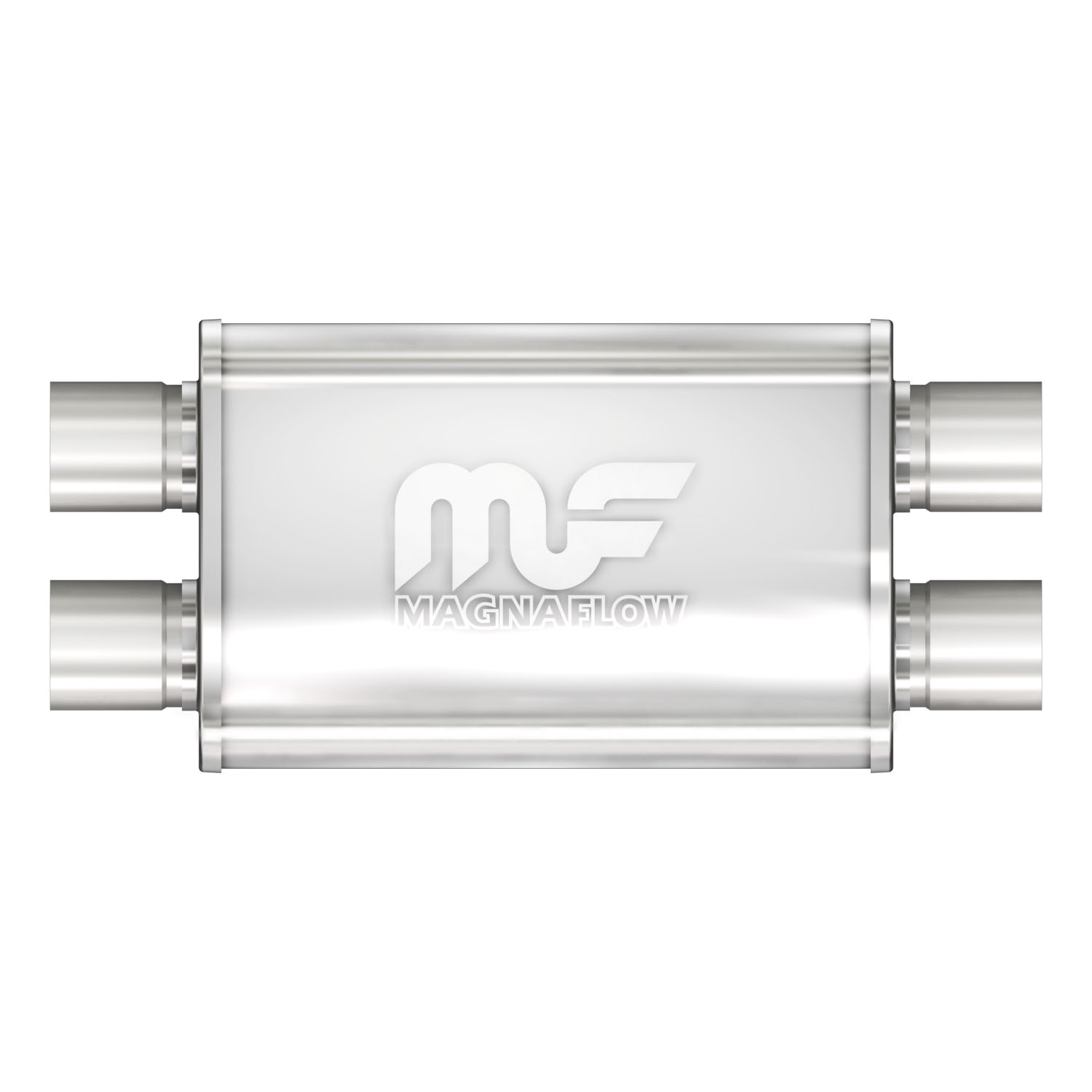

I'm wondering if this would fit... I measured the resonators (i think that's what they are) They are about 12 inches long. So i'm thinking if one were to cut the pipes off of this magna flow muffler so that you only have a half inch of pipe on either end total length would be 12 inches. I should be able the have the resonators cut out and slip this muffler in and have it clamped or welded. Actually now that i think about it they could probably just flare the pipe and slip it over instead of cutting it .. That way they could just use clamps cause on one side it looks almost too tight to weld.
http://images.magnaflow.com/02product/parts/11378.jpg
I think this would be best solution and it should fit... I think... Comments?

I think they weld in a 12" muffler into the midpipe section (the pipe that connects to the downpipe)

forgive the blatant ripoff of corksport's images but i'd be willing to bet this is where they put that additional resonator.

O.k so forgive my ignorance here but the canister in that pic you just posted is a resonator right? Mufflers and resonators do different things. Right?
http://www.rallysportdirect.com/cata...cbem2_3_lg.jpg
These canisters on the cp-e triton that are on the back these are also resonators too right? If they are then i would assume that would mean cp-e probably adds the muffler in the same location corksport puts their resonator. cause it looks like corksport put the muffler on the back.

Yeah resonators and mufflers are different, I vaguely remember cpe saying that it was a straight through resonator but I'll see if I can find the source for that

MagnaFlow Exhaust Products - For Trucks, Suv's, American Muscle, Diesel, & Sport Compact Vehicles
Look for 5in. Round, Center/Center, 3in. in/out. This will 100% definitely fit because I managed to fit the Vibrant 1119 right above the mid chassis brace (the black steel plate with an oval cutout). My exhaust guy (AR Padua Motorsports - Toronto) was a beast and knew exactly what to do to in order to reposition the piping in such a way as to allow the Vibrant 1119 to fit. However, the 5" round Magnaflow would fit MUCH better in that space above the chassis brace, and cause way less hassle in terms of fitment.
How is it after the install? Cold startups used to be an absolute bitch - the noise of the unmuffled exhaust exploding all around the car, rising to a frenzied pitch then slowly settling down to something resembling normalcy, was very upsetting to most people (including myself sometimes). With the muffler in place, cold startups are still loud, but in such a way as to attract WAY less attention. The high pitched notes of the exhaust have been cut down, basically. With my muffler installed, I can still have a conversation with someone standing near my car as I do a cold startup. Before the muffler install? Not even shouting worked, even if the other person was just a few feet away. It's absolutely ridiculous how loud the CPE Triton is without the muffler, and I cannot imagine anybody ever wanting the Triton *without* the optional muffler - as far as I'm concerned, it is not optional.
Driving around is another pleasure regained with the muffler - you no longer have to feather the throttle in the first 2 gears so that it doesn't blast the sound out like a ricer kid. It's not super quiet by any means, but I'd say that about 60% of the crap has been cut out and you get the best of both worlds - an aggressive note, deep rumble, but definitely NOT obnoxiously so. I went to Mexico and did some WOT pulls after the install and you still get the aggressive sound that you want from the CPE Triton at full blast, but it's not glass shattering like before.

@Elusivellama Thanks for the info just ordered this: MagnaFlow Exhaust Products - For Trucks, Suv's, American Muscle, Diesel, & Sport Compact Vehicles
As far as the comments about the triton exhaust i agree 100% cold start ups make my house shake in the morning so i'm sure my neighbor loves it. It also does drone on the highway imo. I would recommend getting this with muffler as well if ordering from cp-e i bought mine used so i didn't have the luxury.

If you just want it softer, then go with the Magnaflow that I mentioned as it has a 5" body and thus less sound deadening material than my Vibrant. It will also fit very nicely. If you can find another muffler that is smaller, then obviously it'll still muffle the noise but to a lesser degree than the Vibrant. I would describe it as a significant taming of the exhaust noise and drone while retaining a decent amount of the Triton sound characteristics.
If the raw CPE Triton is a 10 in terms of noise pollution, then the Vibrant CPE Triton is a 6.5 ~ 7, probably closer to 6.5 IMO. Think of it as a somewhat louder version of stock with a deeper note and the CPE sound. It's definitely muffled-sounding and significantly more civilized as a result, but it depend on your individual taste whether you like it or not. I mean you can still hear it from the outside and it'll still sound like a CPE Triton, but it won't be at ricer sound levels
tl;dr The 5" Magnaflow will fit, and you'll be happy with the amount of work it takes to install it(less work), and it'll quiet the exhaust down to a level that is still aggressive and loud, but not obnoxiously so. You will get used to it after a while and won't think twice about having tamed the CPE down. For me, the significant drop in dirty looks is enough reason to have had the Vibrant 6" installed and would not swap it out for anything with less sound deadening.

Boom! Got it done... Woot! Much better now very happy guy. Cost me 50 bucks for the install. Thank you Koki Muffler Longueuil!
Basically everything @Elusivellama; says is spot on.
Best part for me is NO MORE TICKETS.
Thanks guys for all the help you guys rock!
