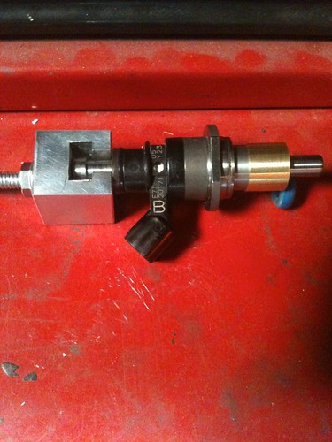

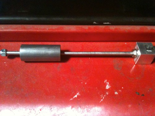

Scott, what exactly is this tool? Is this the tool you need when the injectors get stucked?
Do you have a pic I can see of it?

Yes, this is the tool to remove stuck injectors

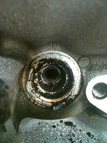

holy blasted injector seals batman!

Yup. Guy definitely needs new seals

I have an even better pic of the seals themselves... I just didn't upload them

here is a poster child pic for your marketing team. These are jimmers crows feet
Caption: Do your crows feet look like this? Well you need the new Mazda MZR injector seals from CP-e

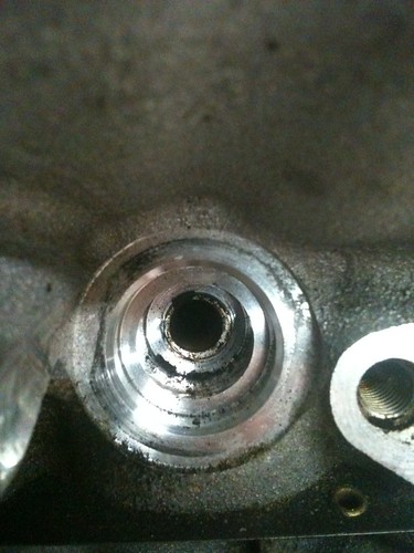

Pics of the Injectors & seals...

Jimmer... what cyl's were those out of?
Looks like motivation to play with the cylinder specific spark timing

The one with half left was cylinder 2... The other was cylinder 4...
I am AMAZED with how shitty these look... THat is 40k miles worth, imagine what someone who has 60k's looks like LOL

So anyway...
This car was running "fine" by the way...
Almost there, should be in the next few days.

Is that the removal tool in the last pic?

This may be a bit more clear.
It is a specifically designed slide hammer essentially. The cylinder at the end is steel with enough effective weight to make it useful. It worked great on the engine we have here for our new project.

you bet it is ....it is a completely different way of thinking on how to remove the injectors.
Hell yeah! Nice work Sander and CP-E!
(Raises hand slowly) I had just a little bit to do with the design of the tool as welll... hahaha

body shop dent puller FTW!
pls make the seals available without the removal tool and associated cost.

Beggars can't be choosers.
Oh and that's a pic of the tool AND seal. Nice work Scott & CPE.
