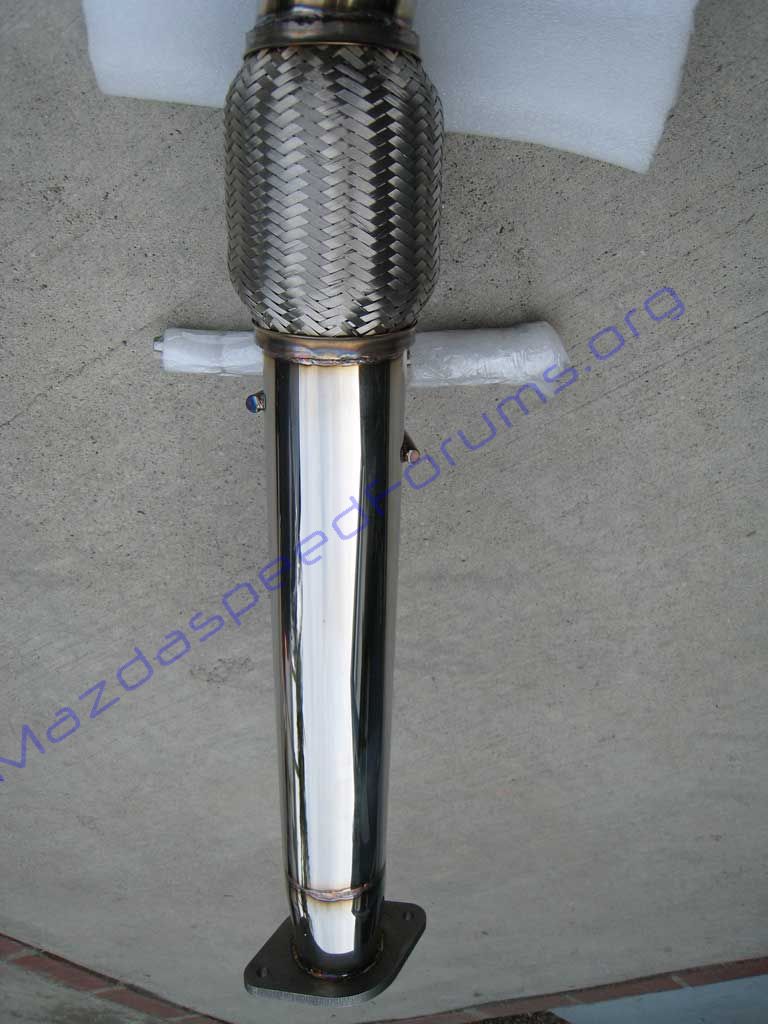

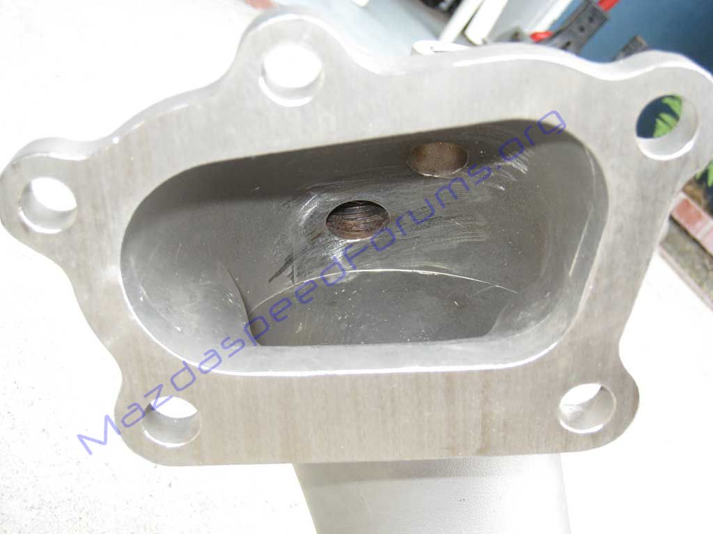

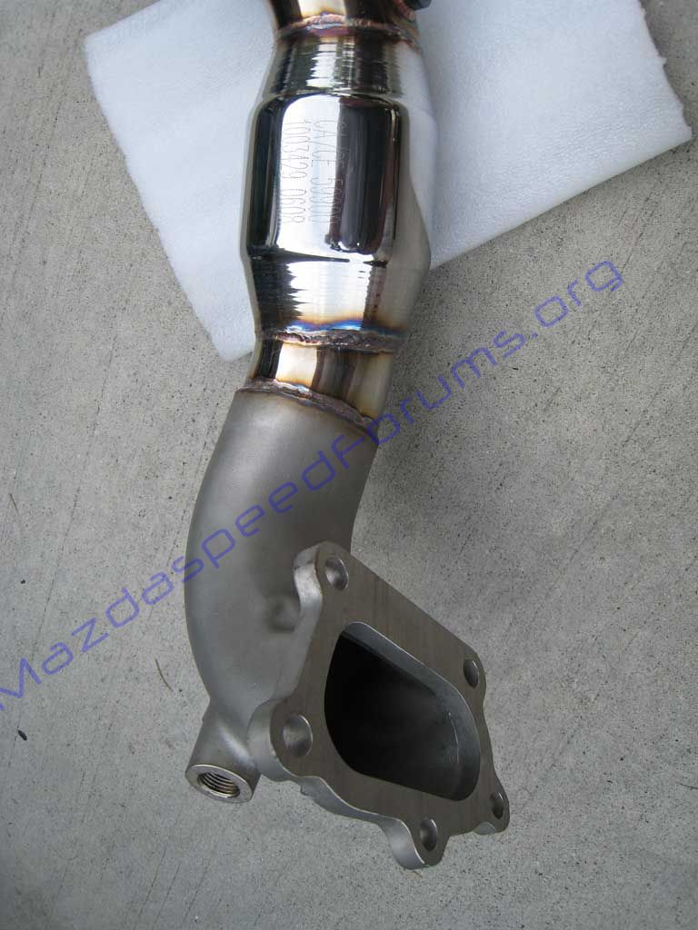

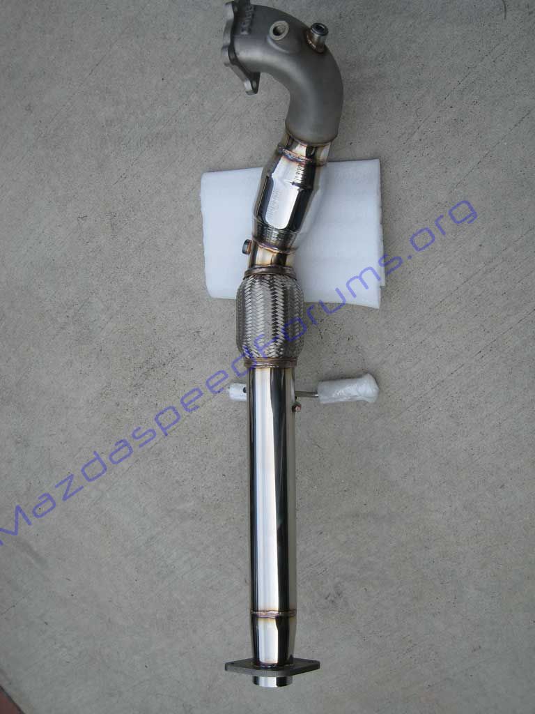

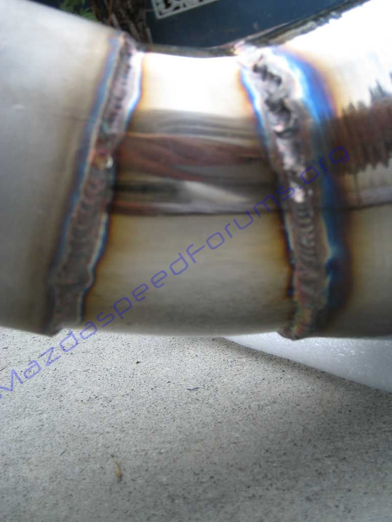

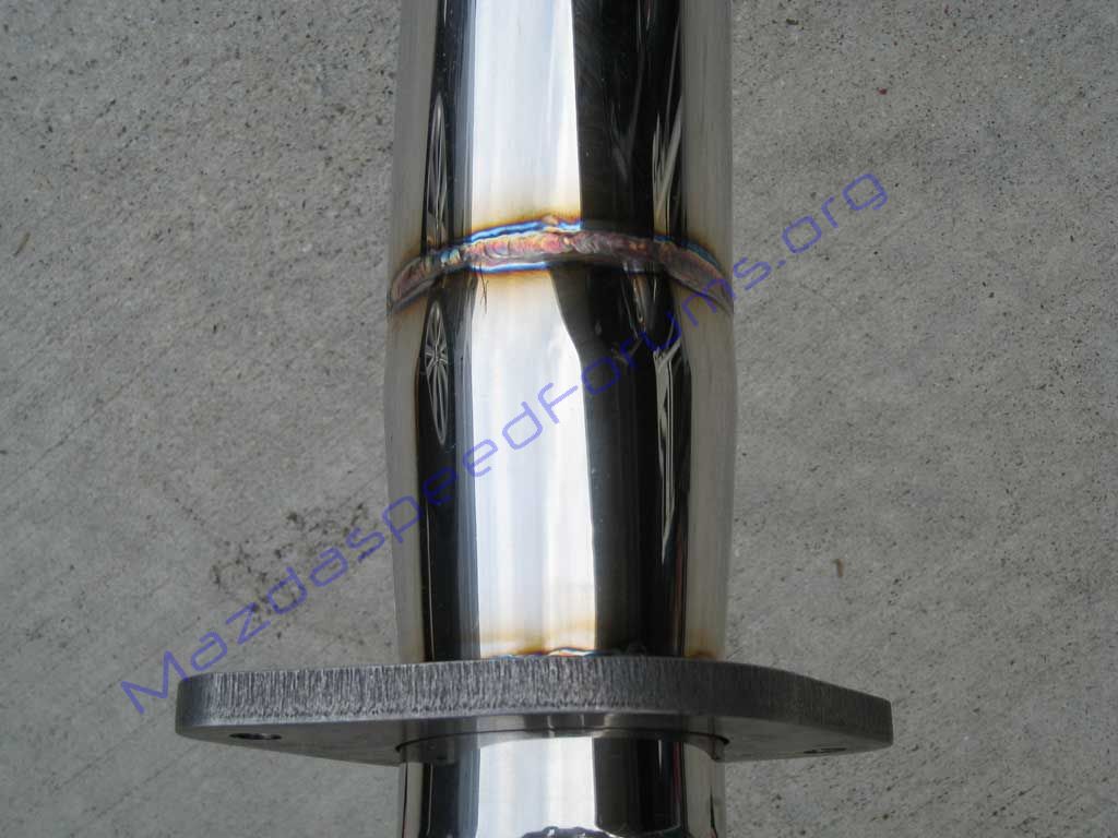

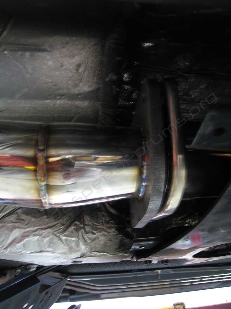

The Cobb downpipe is probably one of their most engineered pieces to date. The bellmouth flange is a CAD designed investment-cast turbine outlet, made of 304 stainless steel for enduring corrosion resistance and reduced heat transfer to the engine bay. The shape of the outlet flange makes optimal use of the tight confines of the MS3's engine bay, smoothly blending turbine outlet and wastegate gases. The outlet flange is configured with two O2 sensor bungs; one to accommodate the stock O2 sensor and another with a pre-installed plug that can be removed to allow an aftermarket wideband O2 sensor or datalogging device with easy engine bay access.
One of the most interesting aspects of this downpipe is the custom spun metal substrate high flow catalytic converter. This one piece 400 grade stainless steel cat has a much higher flow rate and longer lifespan compared to ceramic or “brick” style cats. It also reaches operating temperature faster than other style cats for cleaner cold-start emissions. A third O2 sensor bung is located immediately after the cat to be used by the second OEM O2 sensor. We tried getting a good shot of this converter but its nearly impossible without a bore scope or a converter all by itself. Its definitely a beautifully constructed piece and is quite small in size.

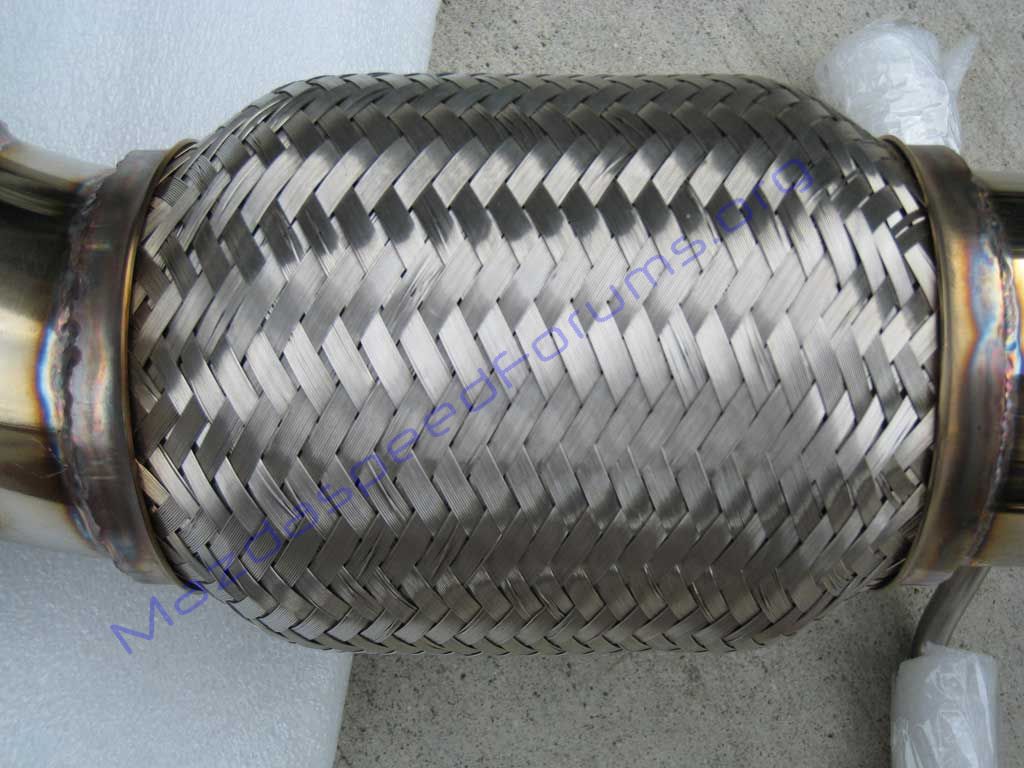

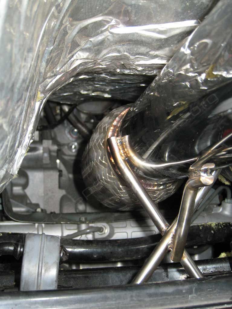

The stainless steel flex section used in the COBB 3“ Downpipe is internally lined (unlike most flex sections) and provides smoother exhaust flow and much longer lifespan for the steel braiding. The placement of this flex section in the factory location (before the first exhaust hangers) is critical in absorbing engine movement and eliminating damaging stresses that would otherwise be applied to the flange, cat, exhaust hangers and chassis. This increases the longevity of the downpipe as well as downstream exhaust components. This piece is what ultimately increased the end price of the downpipe when it went to market.
All tubing used in the fabrication of this downpipe is polished 304 stainless steel for increased corrosion resistance and a mirror-like finish. The 304 stainless steel hangers are cross-welded and well braced to eliminate a point of fatigue that is evident in other aftermarket downpipe designs.
The end flange uses the stock donut gasket and factory spring bolts to aid in flex, longevity and proper fitment. This provides an improved seal compared to other methods, as well as reduced noise. An additional benefit is that it makes the COBB 3” Downpipe compatible with any cat-back exhaust that mates to the factory cat section. Although you see the end portion of the downpipe neck down to 2.5" near the flange, it doesn't seem to affect the flow of the exhaust whatsoever from driving around with the pipe on for 400 miles.
Another thing i noticed while looking at other downpipes out there is, the Cobb has the least amount of bends in its design. This is one of those downpipes that looks good on a wall, rather then in the car, since much of it is hidden.

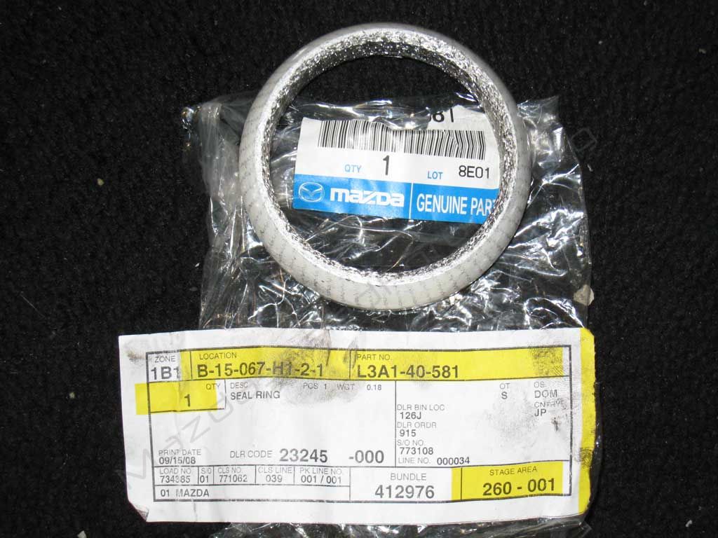

  • Mazda OEM Donut Exhaust Gasket

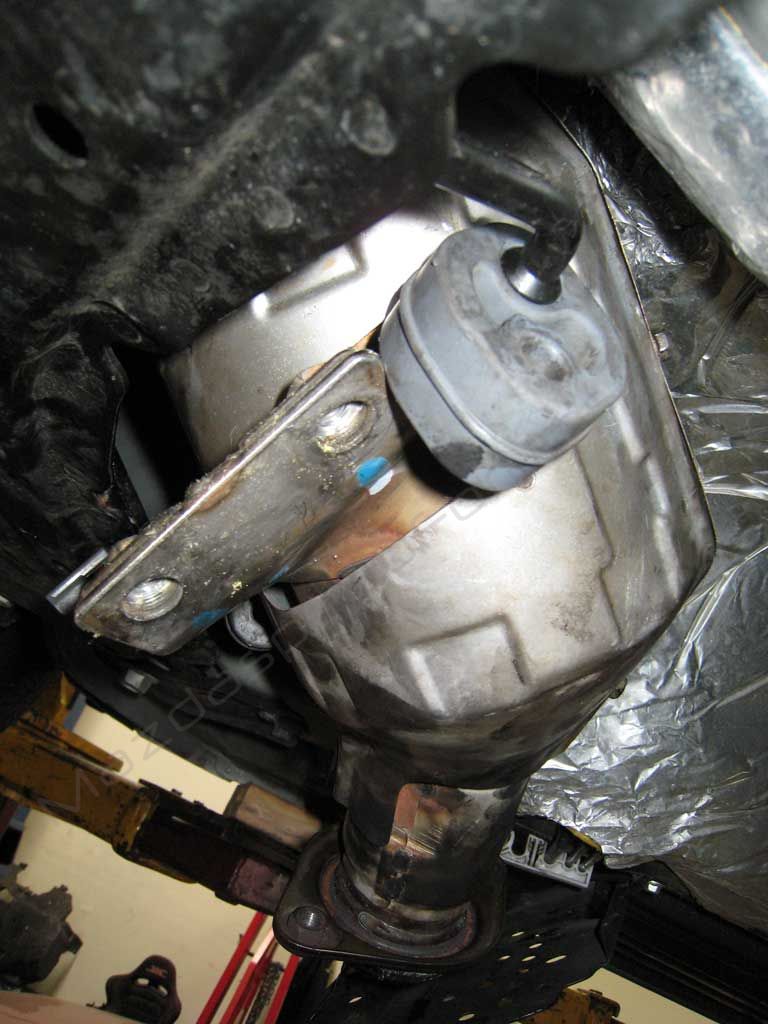

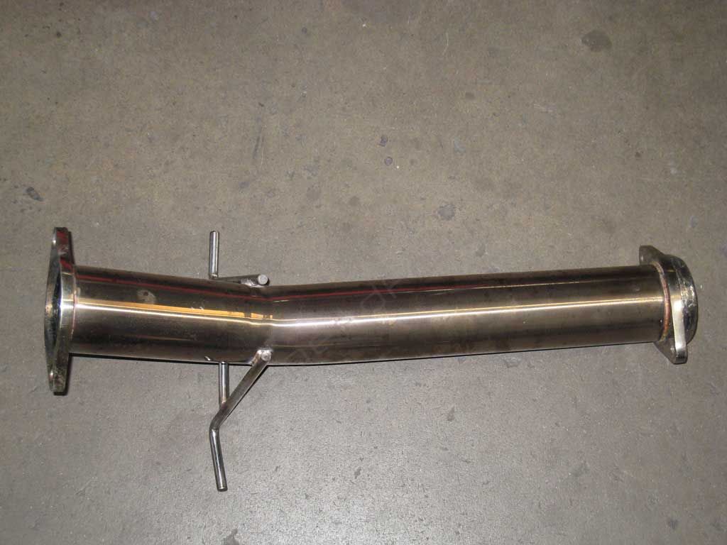

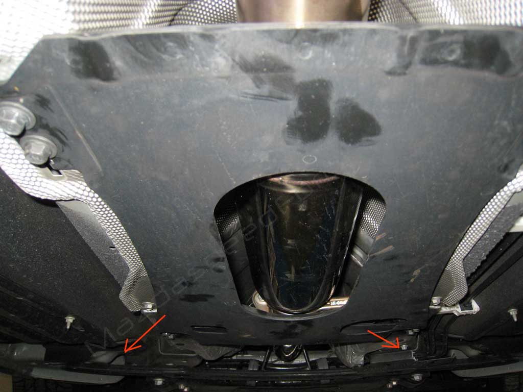

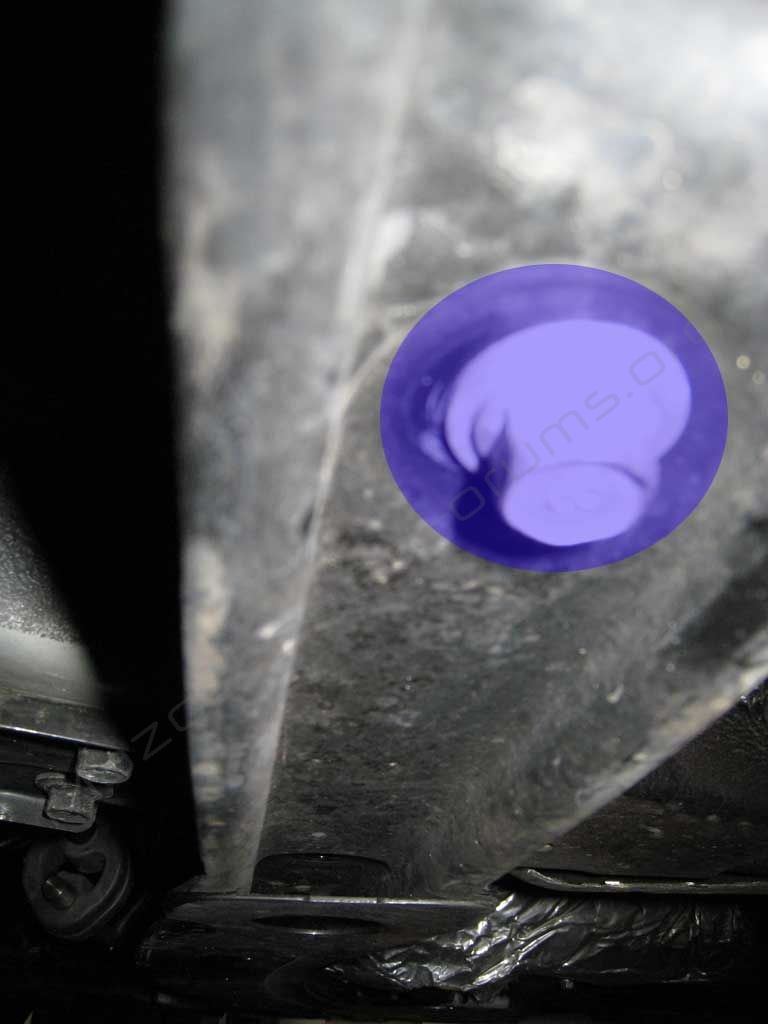

We started our install a bit differently then how the Cobb instructions are laid out. Since we had the car on a lift, we chose to attack the bottom portion first. First step, is unbolting the race pipe or stock mid pipe section, from both the catback section and stock downpipe locations. You will also want to remove the large metal skid plate and the horizontal cross member in order to make access to these areas easier. See below:
http://www.mazdaspeedforum.org/forum/pics.../cobb_dp/1.jpg
http://www.mazdaspeedforum.org/forum/pics.../cobb_dp/2.jpg
These two pieces should be removed to facilitate a faster installation.

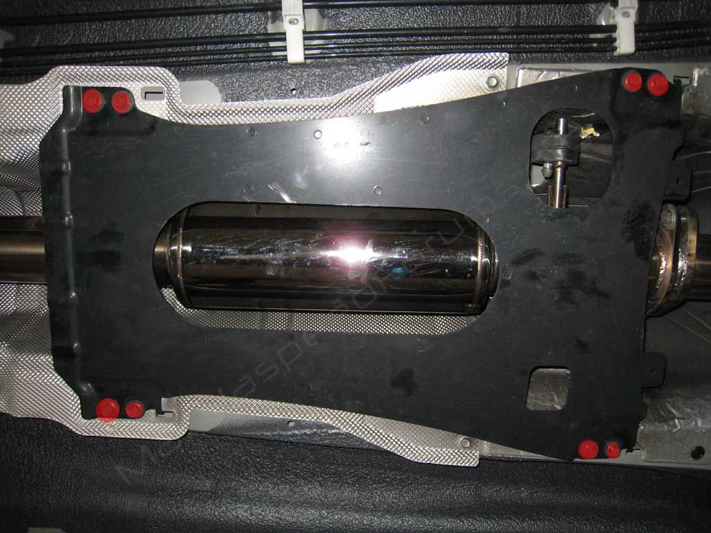

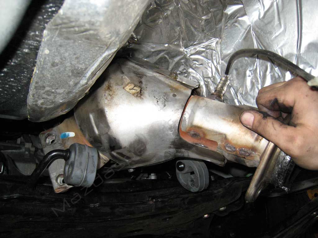

Here we have removed the race pipe out of our system
http://www.mazdaspeedforum.org/forum/pics.../cobb_dp/7.jpg

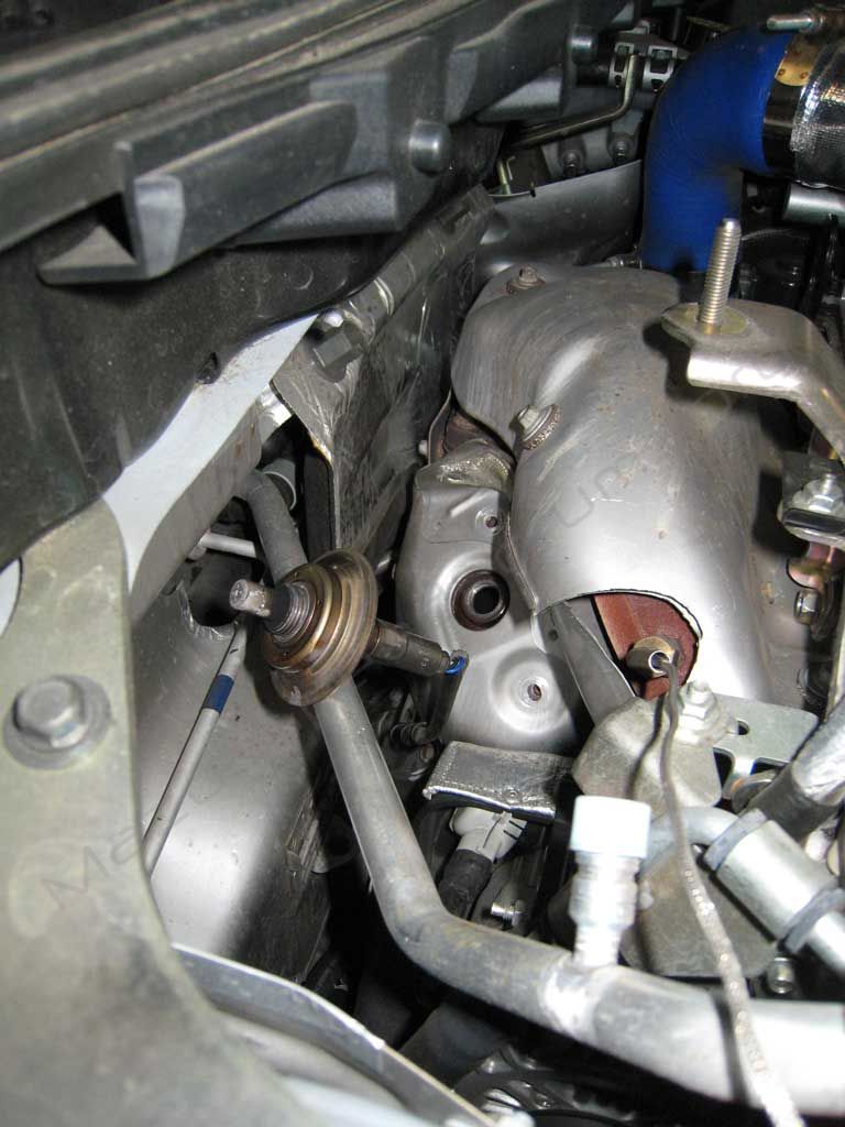

Now, take your O2 sensor tool and see if your sensor is able to come out with ease. Some cars have no problems with this sensor, some do. If you feel any bit of resistance, then stop and come back to this step after the stock downpipe is out of the car. In the meantime, hit this with plenty of PB Blaster and let it soak. Also, remove the O2 wire off the wire that holds the cable on. Unfortunately, there is no where to secure this wire holder on the Cobb Downpipe.
http://www.mazdaspeedforum.org/forum/pics.../cobb_dp/8.jpg

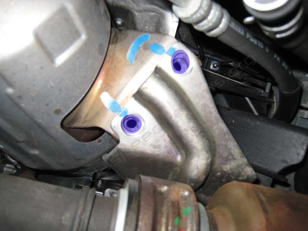

Remove the 10mm bolts/nuts holding on the heat shields on the lower side. Also, remove the downpipe bolts which are 12mm that hold it to the brace.
http://www.mazdaspeedforum.org/forum/pics.../cobb_dp/9.jpg

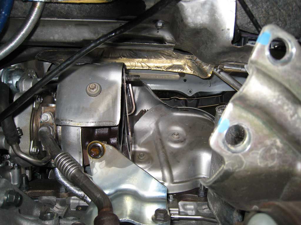

Now its time to go back top side of the car and start working out the O2 and Heat Shields. Grab your can of PB Blaster and squirt down the top side wideband O2 sensor. Ours had no issues coming out of the downpipe. You. may not be so lucky.

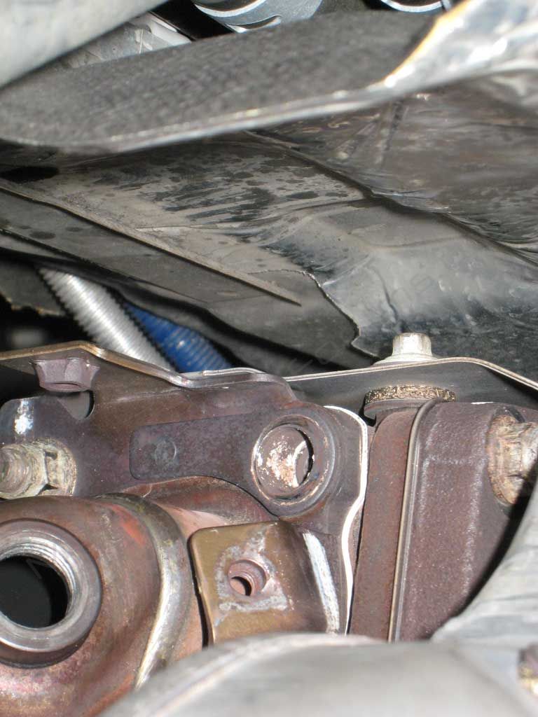

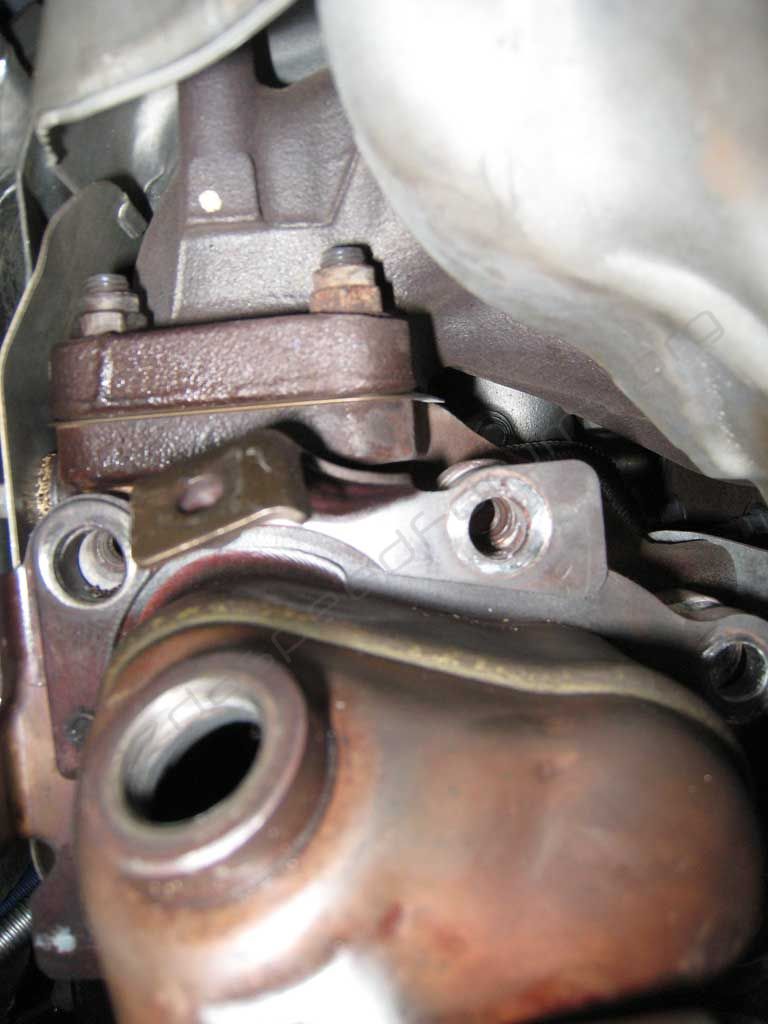

We have removed our last heat shield and now we are ready to spray the hell out of the 5 14MM bolts that hold the stock DP to the Manifold/Turbo housing.
http://www.mazdaspeedforum.org/forum/pics...cobb_dp/12.jpg
http://www.mazdaspeedforum.org/forum/pics...cobb_dp/13.jpg
As you can see, the studs usually come out with the nut here. Don't be all freaked out, thats just the way it is on most of the cars i've witnessed during a DP install.
http://www.mazdaspeedforum.org/forum/pics...cobb_dp/14.jpg
http://www.mazdaspeedforum.org/forum/pics...cobb_dp/15.jpg
http://www.mazdaspeedforum.org/forum/pics...cobb_dp/16.jpg
http://www.mazdaspeedforum.org/forum/pics...cobb_dp/17.jpg

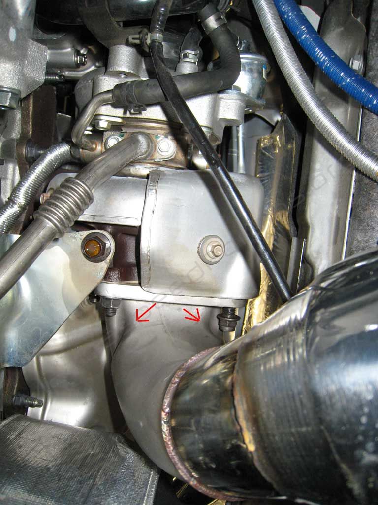

Finally, we have all 5 bolts/studs out of the DP connection and we used a large pry bar to pop the flange from the manifold. We are ready to remove the stock downpipe from its location.
http://www.mazdaspeedforum.org/forum/pics...cobb_dp/18.jpg
http://www.mazdaspeedforum.org/forum/pics...cobb_dp/19.jpg

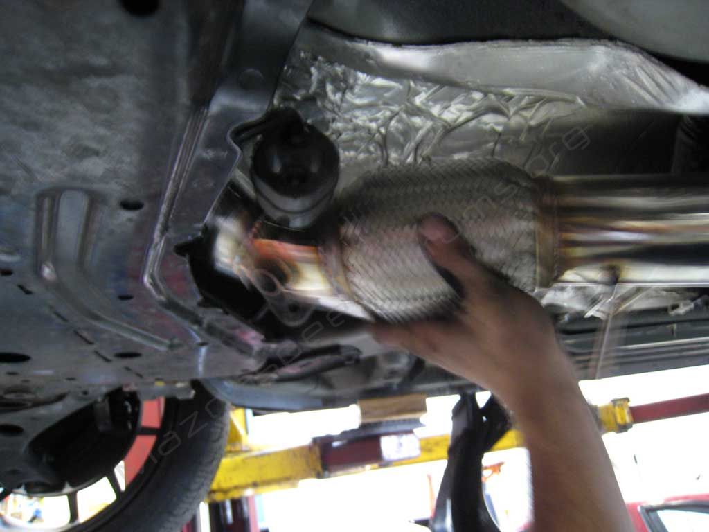

Here's the fun part.. We are now sliding the new Cobb DP into it's new home. This is actually an easy process. Just slide the unit up into the tunnel and twist it clockwise. The bellmouth will meet up with the stock manifold flange effortlessly.
http://www.mazdaspeedforum.org/forum/pics...cobb_dp/22.jpg
http://www.mazdaspeedforum.org/forum/pics...cobb_dp/23.jpg
http://www.mazdaspeedforum.org/forum/pics...cobb_dp/24.jpg
http://www.mazdaspeedforum.org/forum/pics...cobb_dp/25.jpg

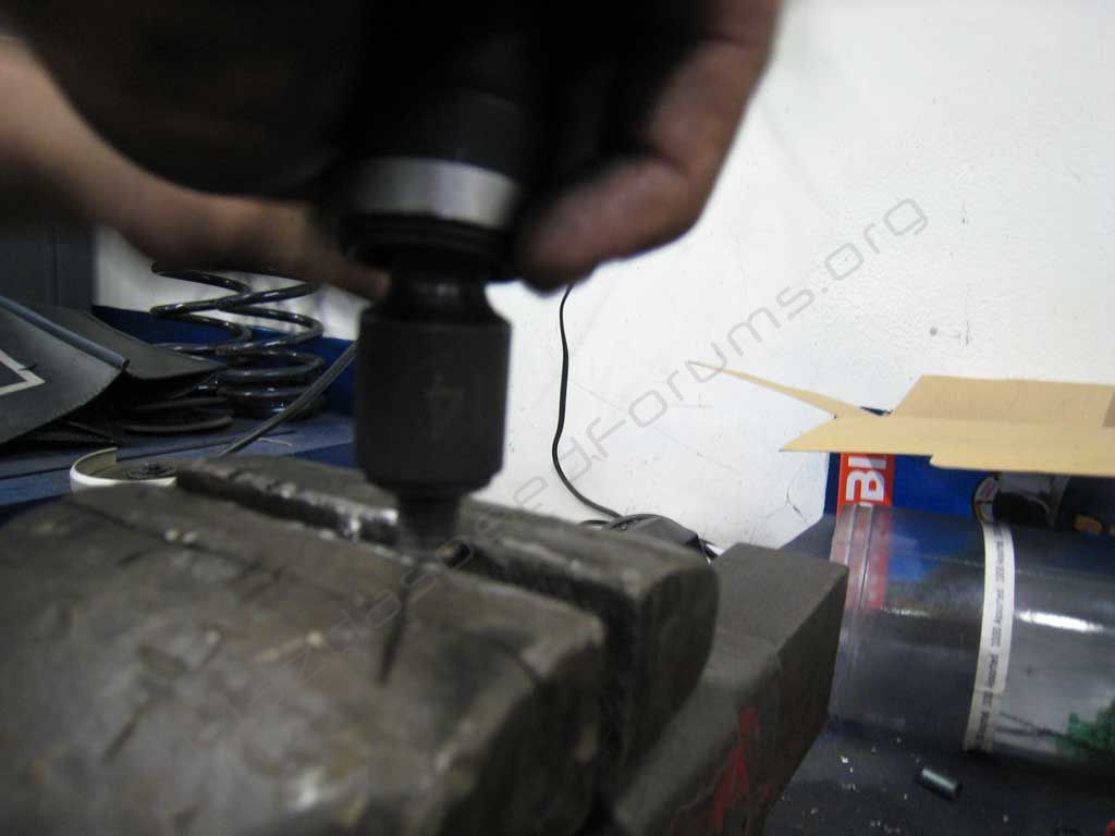

Here we tried to see if we could get the stock nuts off the studs, used to secure the bellmouth of the DP to the manifold. As you can see, it didn't work out like we had thought. So, scratch that idea.
http://www.mazdaspeedforum.org/forum/pics...cobb_dp/26.jpg
http://www.mazdaspeedforum.org/forum/pics...cobb_dp/27.jpg
http://www.mazdaspeedforum.org/forum/pics...cobb_dp/28.jpg

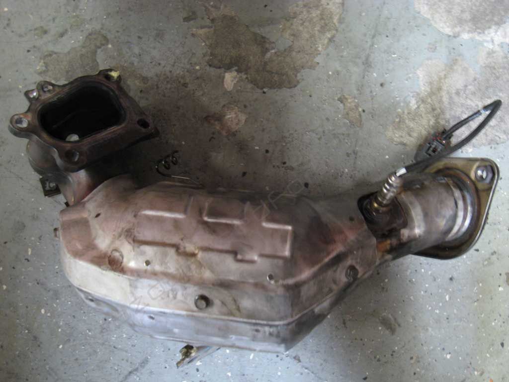

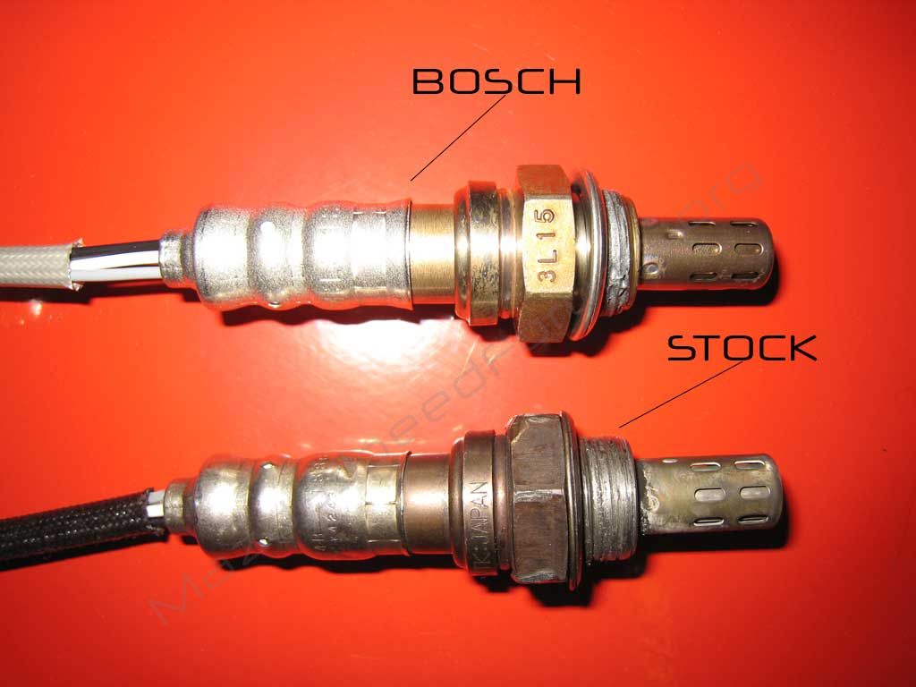

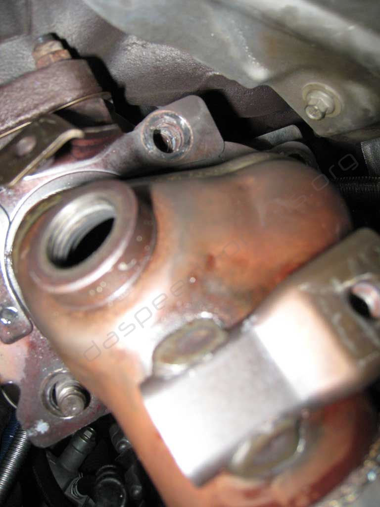

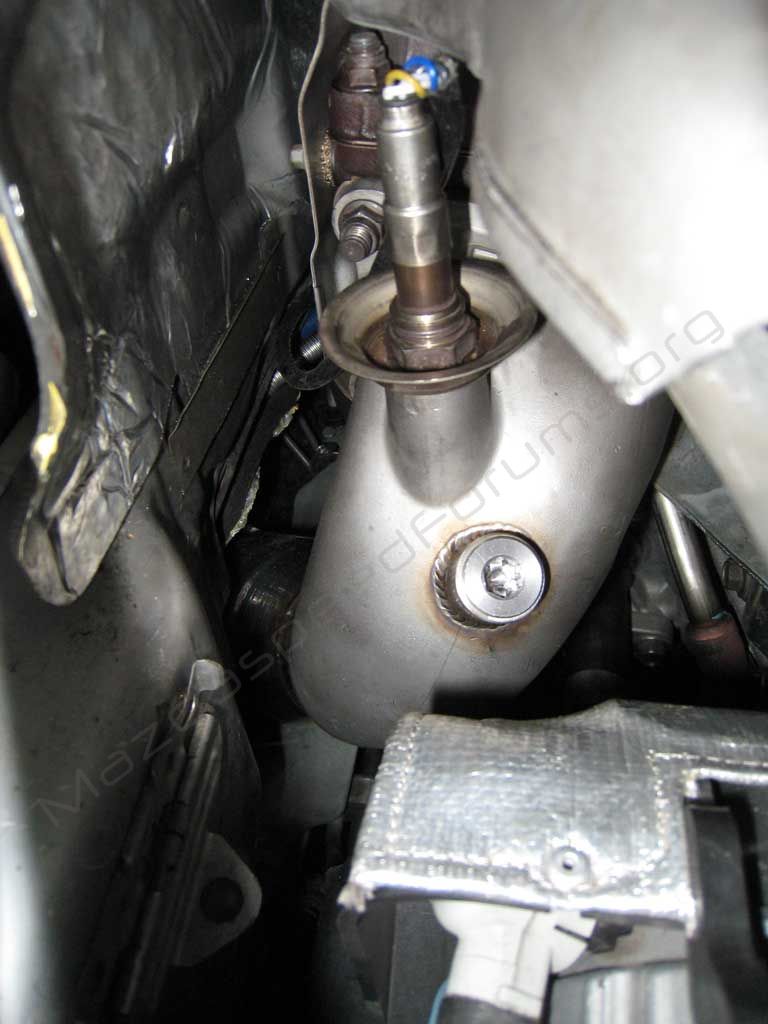

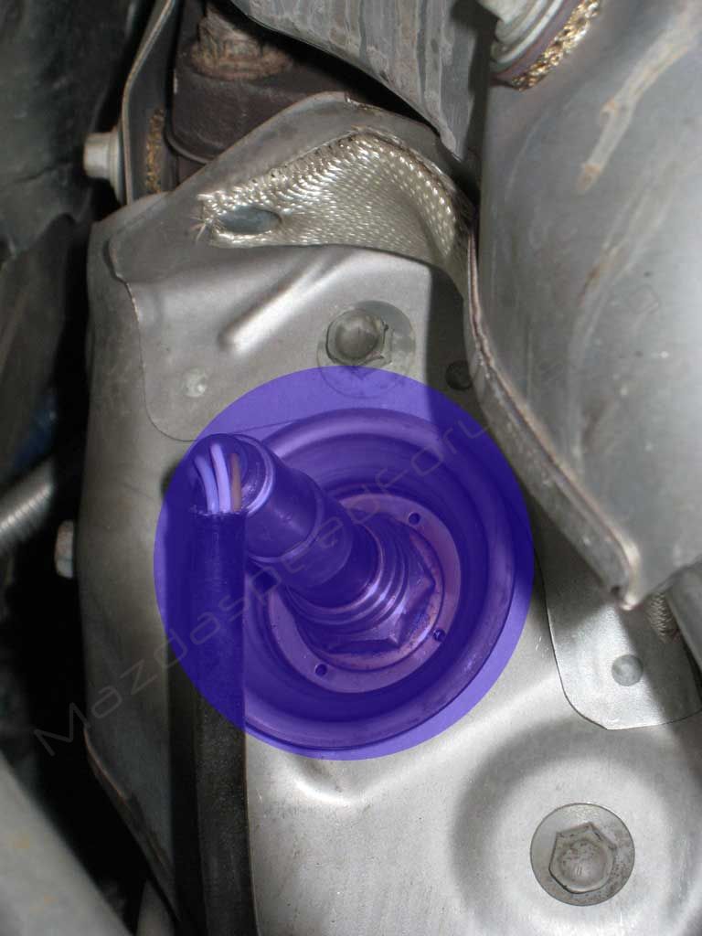

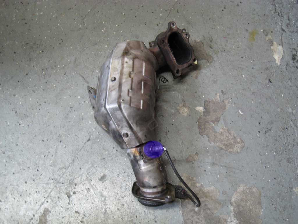

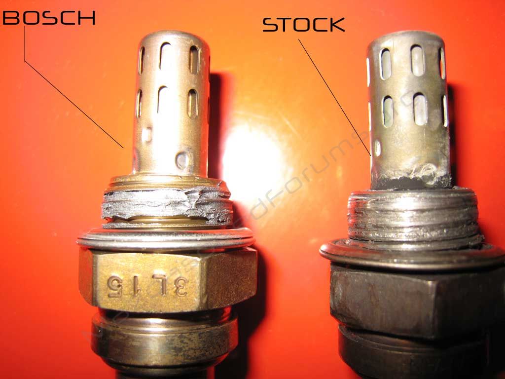

Here is a snap shot of the stock downpipe. For us, this was our monster issue. Our O2 sensor was not coming out of this sucker. 60 mins wasted tryng to work it out.
http://www.mazdaspeedforum.org/forum/pics...cobb_dp/29.jpg
http://www.mazdaspeedforum.org/forum/pics...cobb_dp/30.jpg
Here is our replacement sensor. Its a Bosch and its made a hell of a lot better than stock. The threads appear to be a hardened brass. The stocker looks brass as well, but it may not be hardened. The Bosch comes pre-installed with Anti Seize.
http://www.mazdaspeedforum.org/forum/pics...bb_dp/o2_1.jpg
http://www.mazdaspeedforum.org/forum/pics...bb_dp/o2_2.jpg

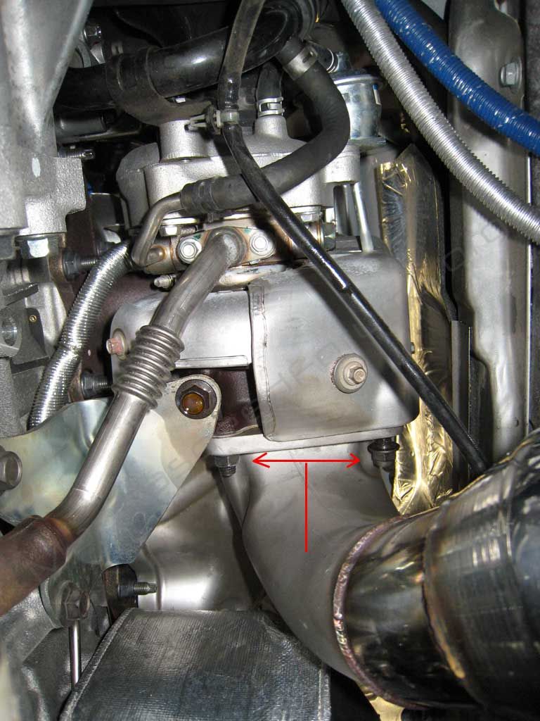

Now, its time to reinstall the 5 flange bolts/studs. We have two installed now, working on the third.
http://www.mazdaspeedforum.org/forum/pics...cobb_dp/32.jpg

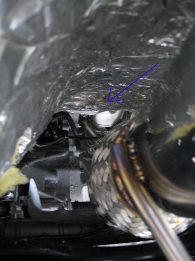

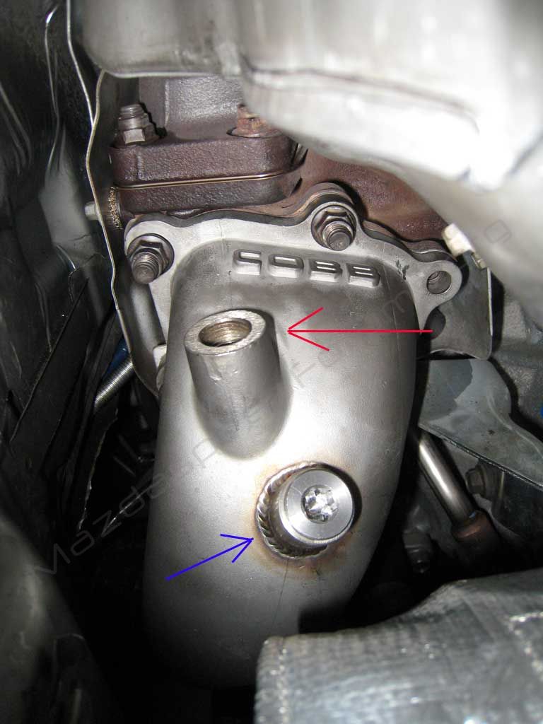

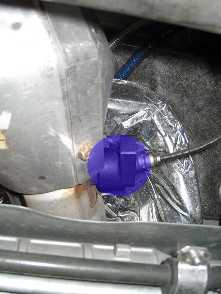

Red arrow = Stock Wideband O2 sensor location
Blue arrow = Aftermarket wideband and/or monitoring device location
http://www.mazdaspeedforum.org/forum/pics...cobb_dp/31.jpg

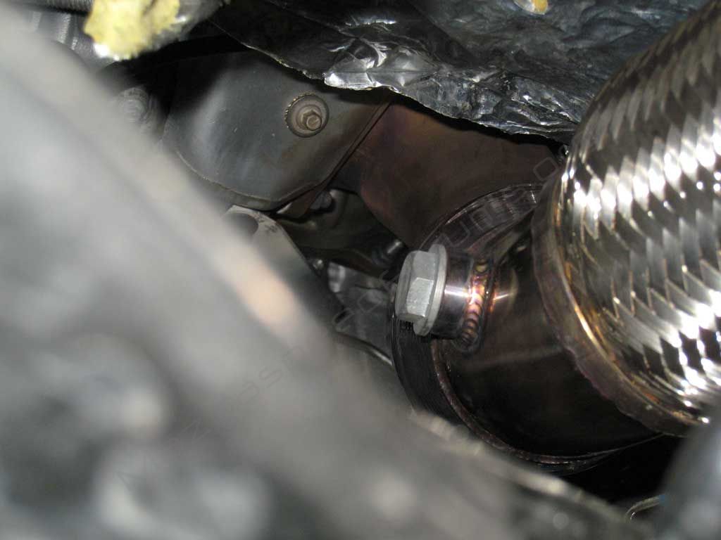

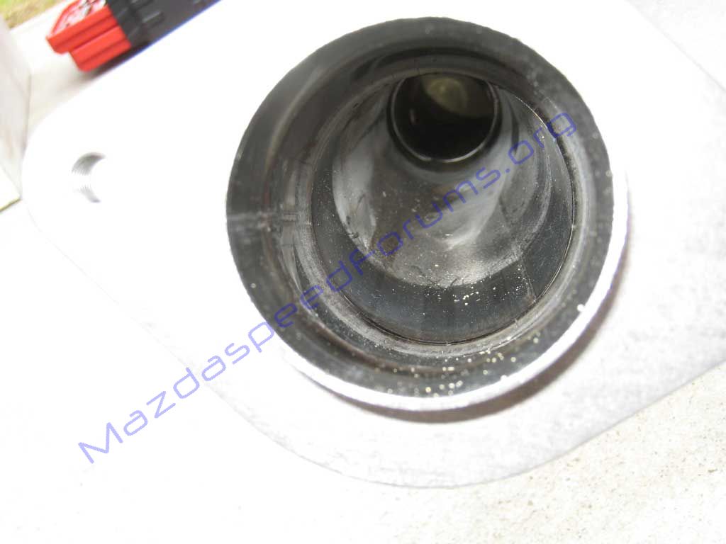

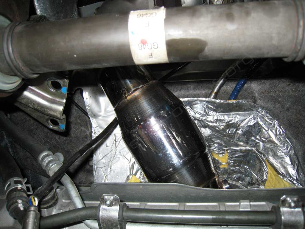

Here is a good picture of the new converter affixed on the Cobb DP. Note the amount of room left after placing the pipe up there.
http://www.mazdaspeedforum.org/forum/pics...cobb_dp/33.jpg
Off, 3 bolts on the top have been loosely installed. You do not want those torqued. The reason being, if you look here, the bottom two bolts are MUCH MUCH easier to get at from the bottom. If you try getting them at the top, you take the chance of cross threading them due to the bellmouth having a relief to make getting these bolts easier to access. I would torque these down all way to 28-37 ft pounds. Then go back up topside, and torque the other 3 down to 28-37 pounds as well. When you go back to the bottom side of the car to hook up the CBE section, just double check the 2 bellmouth bolts here again.

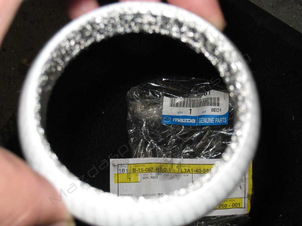

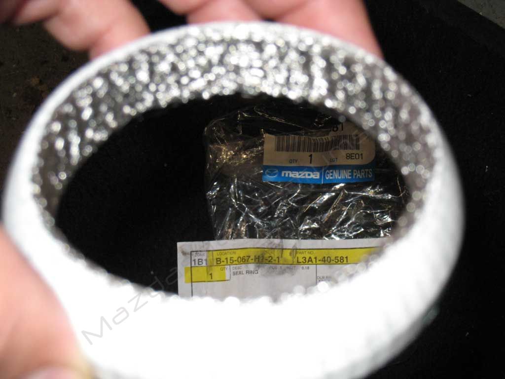

If you did not get a stock oem exhaust donut gasket, hopefully the one you are reusing will not leak on you. If you came from a 3" midpipe like a corksport, you will need the stock oem gasket as theirs is way to big to use.

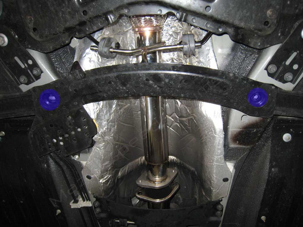

Next secure the horizontal crossmember back into its stock location.
http://www.mazdaspeedforum.org/forum/pics...cobb_dp/42.jpg
http://www.mazdaspeedforum.org/forum/pics...cobb_dp/43.jpg

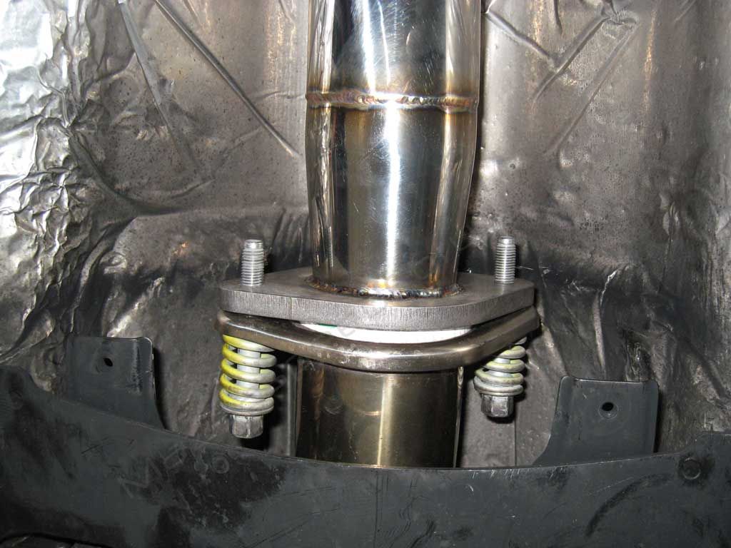

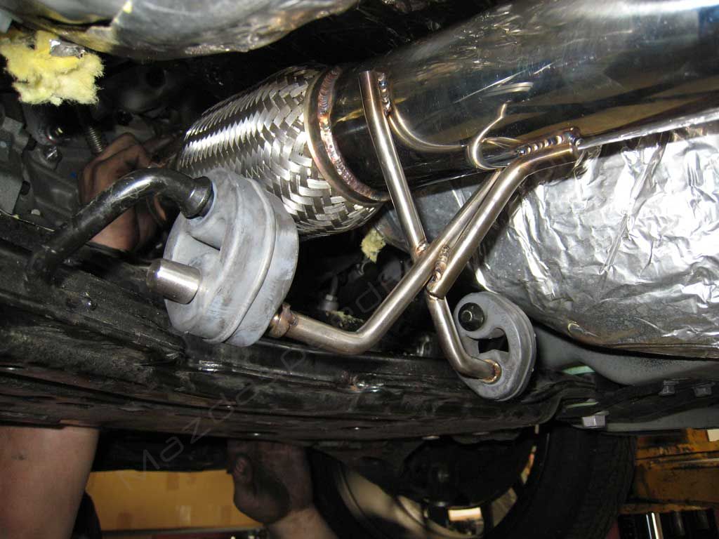

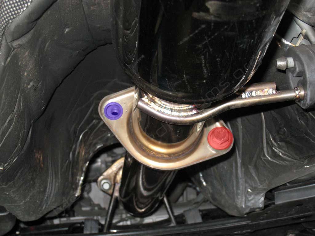

Next secure the Downpipe to Catback Section. Stock specifies to use the stock spring bolts used to connect the stock dp to the stock midpipe section on this step. This helps cure any unwanted bind depending on which catback you are using.
http://www.mazdaspeedforum.org/forum/pics...cobb_dp/44.jpg
http://www.mazdaspeedforum.org/forum/pics...cobb_dp/45.jpg
