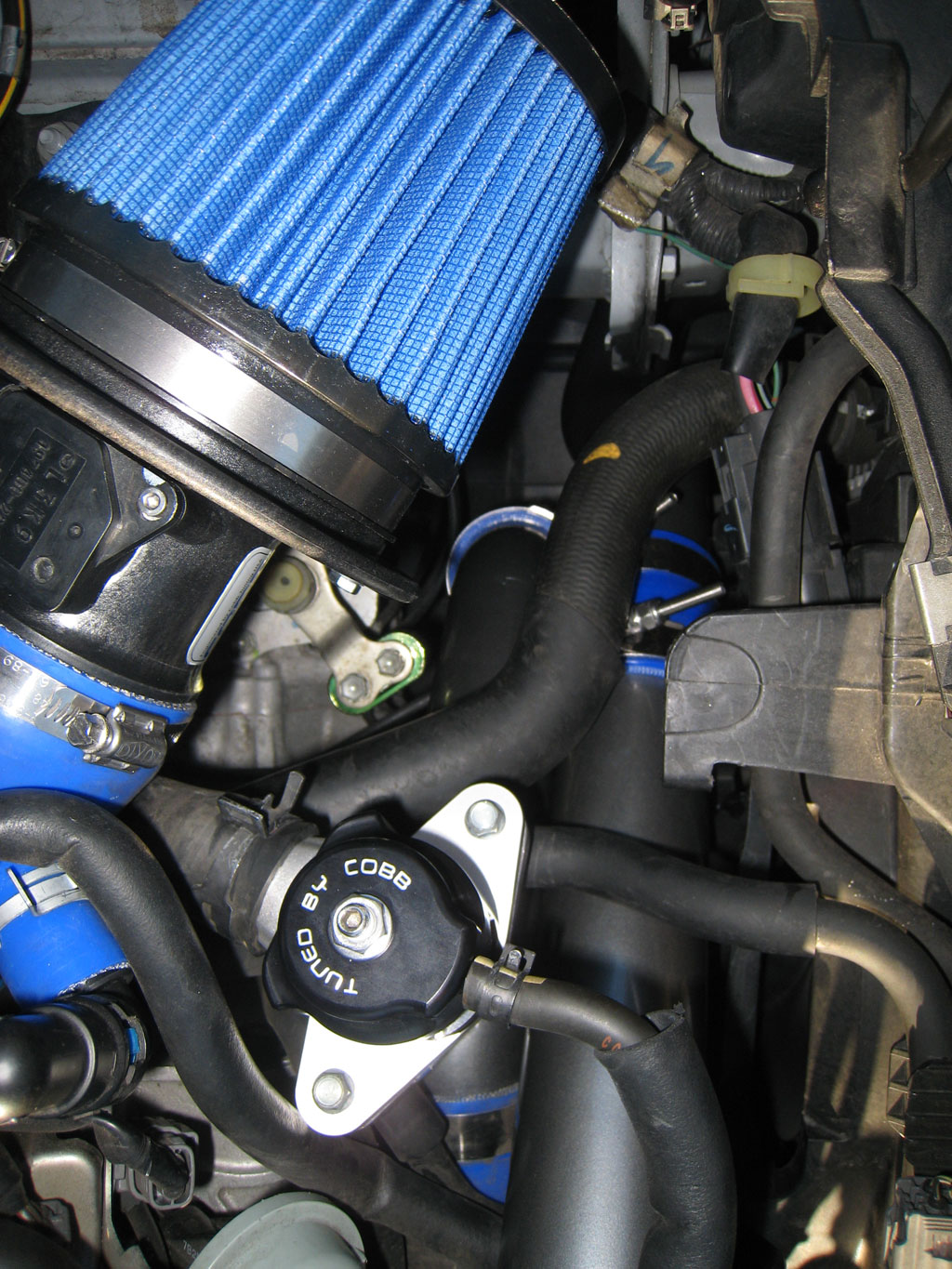

Cobb Tuning has an answer for those looking for that loud blow off sound but with a safety margin, the Cobb Tuning XLE BPV. It can be setup to run in 3 modes, one of them being a hybrid mode that allows a minute amount of VTA without placing the car in a lean condition. You get that loud WHOOSH but you also get that important counted air, recirculated back into the system.
Even though this valve comes in at a steep price of $299, its not any more expensive then the most over-rated BPV on the market, the HKS SSBOV... The Cobb XLE doesn't require any type of flange adapter. The HKS requires an adapter to be fitted to it before it can be mounted on a Mazdaspeed 3 or 6. Installing the adapter is a pain since it uses a snap ring... The most troubling part of the HKS is how much plastic is found inside the valve, but more daunting, its inability to be adjustable. $300? Really? There are numerous reports on our forum about the HKS falling apart... The plastic inside is breaking... This is definitely not the type of valve i want inside my car. Step aside, we have a new BPV on the market thats going out be worth the $299.
The Cobb Tuning XLE BPV is one unit that can be adapted to several cars. First off, if you plan to replace your Mazda with a scoobie, this can be done with a simple part change without having to buy a new valve. Below are the specs on the Cobb XLE:

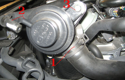

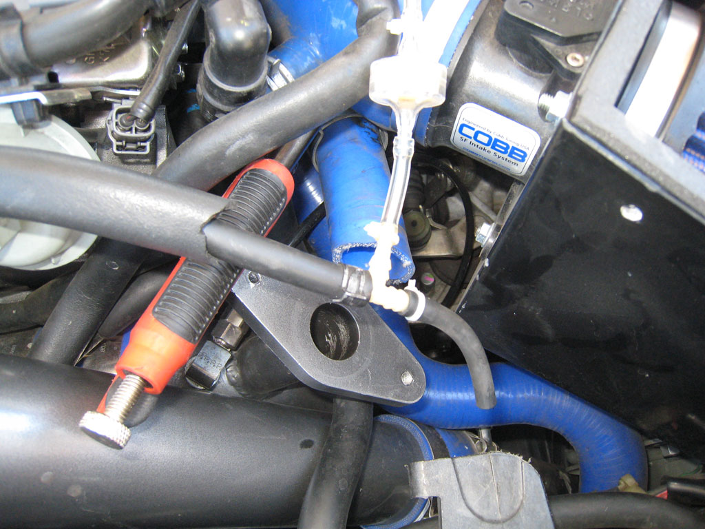

Installing this piece couldnt be easier. The stock bpv is black in color, made of plastic can can be found on a stock mazda right at the cold pipe on the stock TMIC
1) Take a pair of pliers and remove the recirc hose on the back of the valve (large 23mm hose). Guide the pliers to the butterfly clamp, compress pliers to release tension and slide back clamp 3 inches from the lip. tug on the hose to release it from the valve.
2) Take the pliers and remove the small vac line in the same manner as you did the above recirc hose.
3) Remove the (2) 10mm bolts holding on the BPV onto the pipe and put them off to the side, we will reuse these.

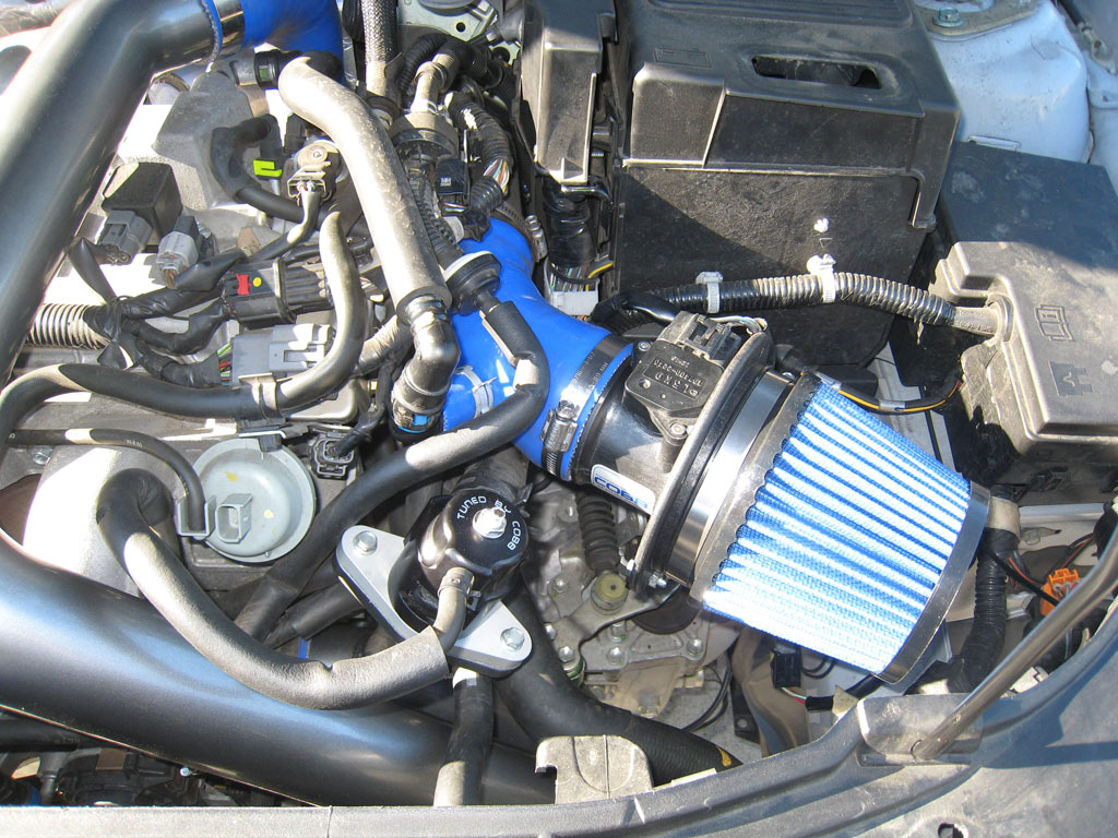

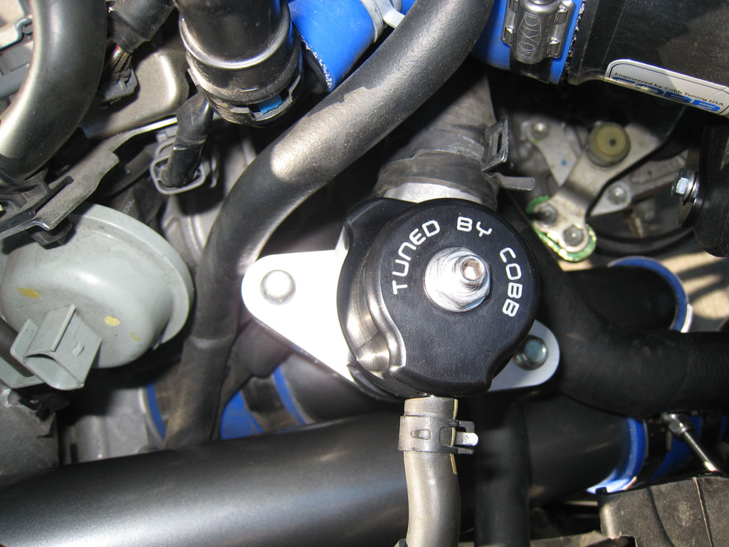

Now, you have to decide if you want to run full recirc or hybrid mode. If you choose to run the louder hybrid mode, you will need to remove the trap door on the valve with a 3mm allen key/bit. Theres only 4 of these holding it on, so its really simple.
Once you have decided which route you will take, remove the paper gasket from the box and place it on the valve, using both bolts to hold it in place. Simple place the valve back onto the BPV flange and retighten it. Now word of caution here.. If you ARE using an alumn TMIC, i strongly suggest using a ratchet extension with a 10mm deep well socket to hand tighten both bolts evenly. Once they are hand tight, give one good 1/4 inch crank on both bolts and that's it. They hardly require much torque and we keep hearing about Hercules breaking off his bolts in the cold pipe or stripping the threads.
Once you got it torqued back down, simply connect both hoses and take it out for a drive. I seriously doubt you will need to make any adjustments to the valve, but if you do, keep reading.

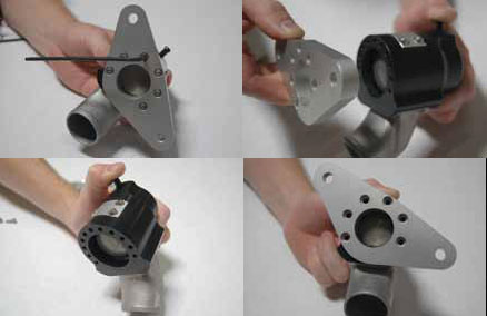

Disassemble the COBB Tuning BPV In order to remove the piston, unbolt the base flange from the body using a 3mm allen key. Depending on the BPV model you have, this may be 5-6 socket head cap screws. When removing the piston, be careful to not cut the o-ring. If
your o-ring is damaged, you can contact COBB Tuning for a replacement.
Reassemble the COBB Tuning BPV
To reassemble the BPV, push the piston back into the body, so that the piston
does not protrude from the body. You can hold the piston at that point by placing
your finger over the vacuum connection.
Place the base flange onto the body and re-clock the flange. Secure the flange
with the 5-6 socket head cap screws, depending on the model, using a 3mm
allen key.

I am so happy to see such an easy valve hit the market that not only looks and sounds cool , but is fully functional, adjustable and isn't finicky right out of the box. For years i was running a Forge Valve that had a blue spring and 2 shims. It gave me issues with no shims, it also gave me issues with a red shim. It was 75% on mark with 2 shims.
With the Cobb XLE, i hold all of my boost during shift and its loud, meaning people know you are on the boost. It also doesn't sound like a couple of ninjas having a sword fight under the hood like the Forge does.
Keep your eye on the valve needing grease, esp is you are running the hybrid mode or your car is in a lot of moisture like rain or snow. This will def breakdown the grease in the piston.
Also keep in mind that the paper gasket IS needed on both the scoobies and mazda's. I have seen some genius's attempt to go straight o-ring and unless your flange is 100% level, you are going to leak some boost without the gasket. So, use the gasket guys... it is re-usable and needed for our application to keep this valve from leaking.
