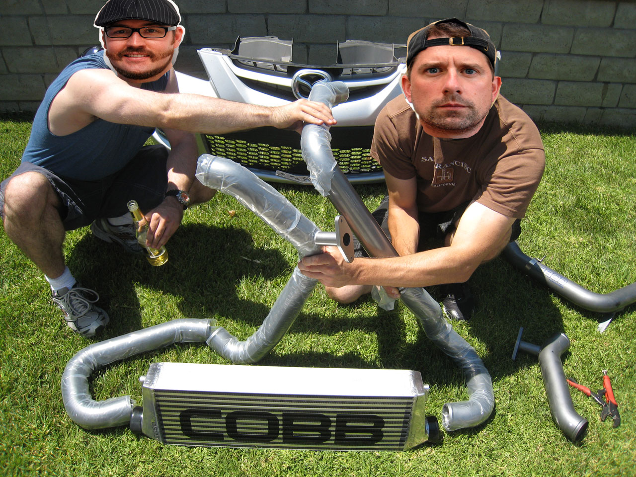

Like i had talked about earlier, we did a test fit outside the car to see how radical the changes were and to get familiar with how all of this would bolt up. So, since i needed a few extra hands, i had both Christian and Gary show up with some beer to help me out:
all kidding aside, this is how the kit will basically bolt up. If you had some brains, unlike us that day, it would be a smart idea to take some masking tape and just number the sections. Once you get under the car, some of the pipes can get a big confusing, so pre-labeling them will save you some frustration. I would also advise you to go ahead and slip on your t-bolt clamps here and check the orientation of where they will be and will you be able to get your ratchet in there. Taking that extra 10 mins now and doing this, will save you an hour or two of screaming profanities and having to remove pipes because you put the damn clamps on backwards.

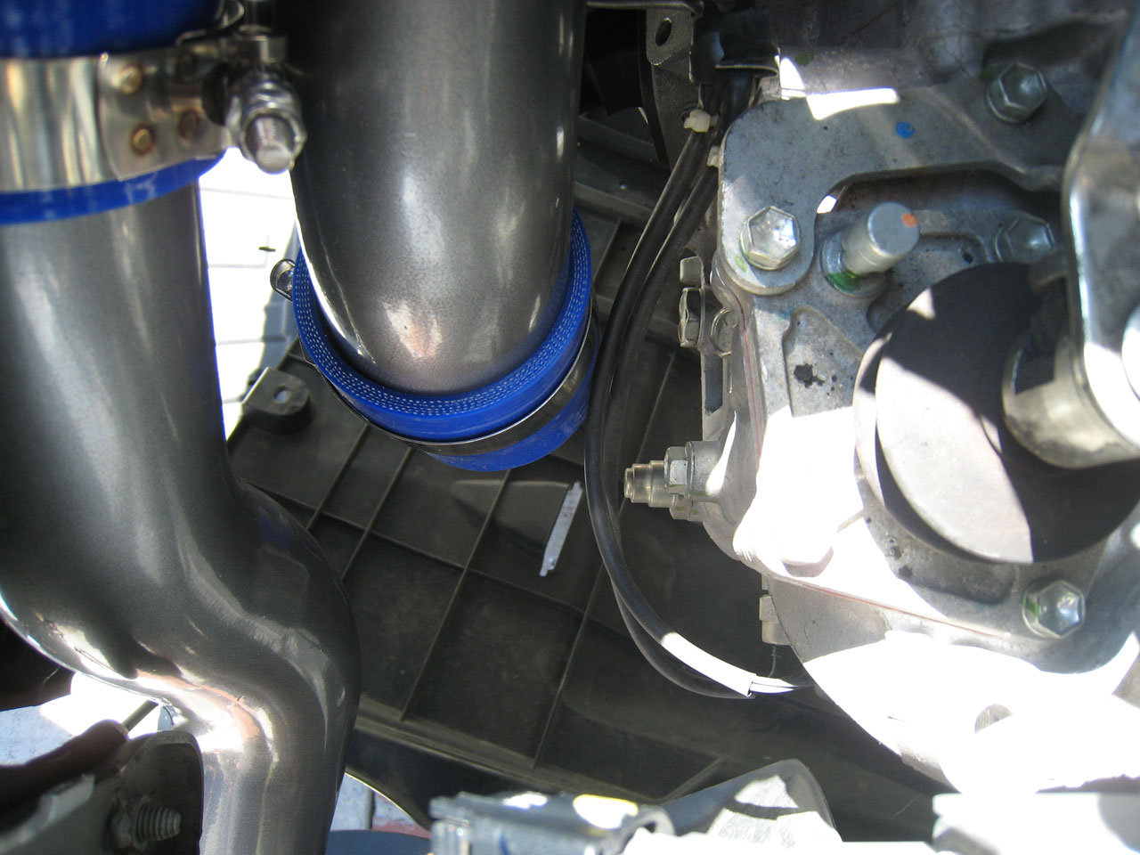

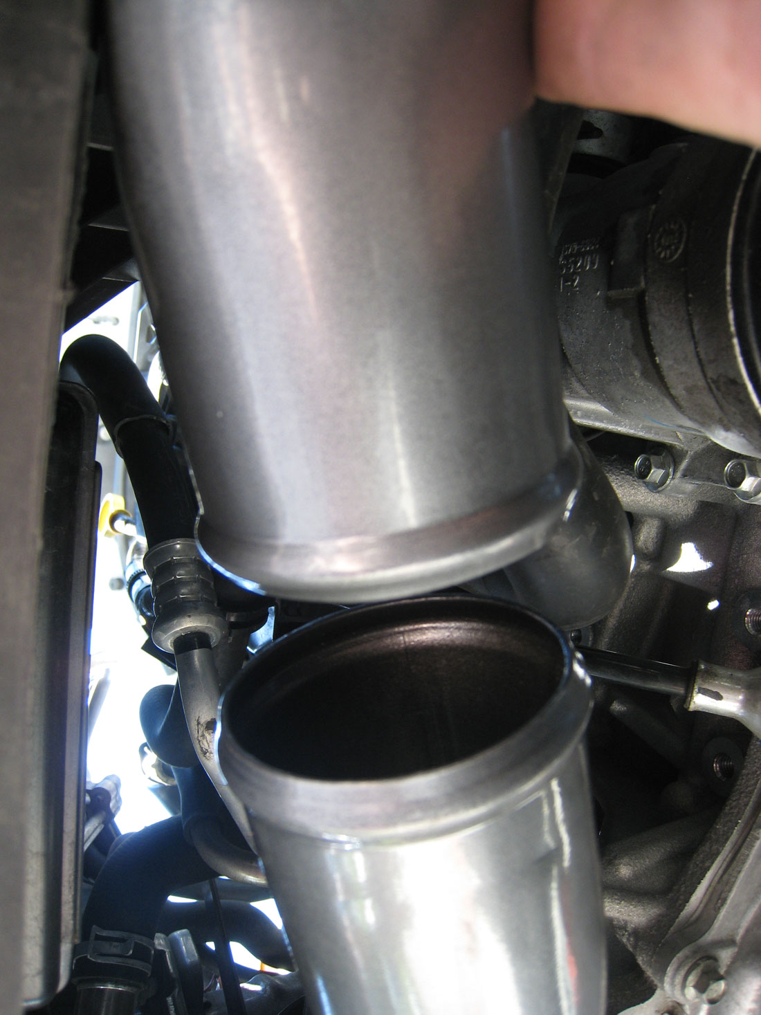

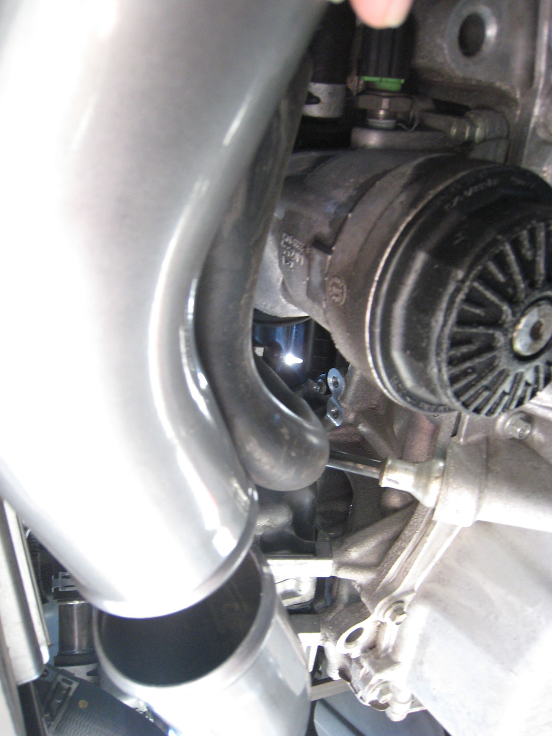

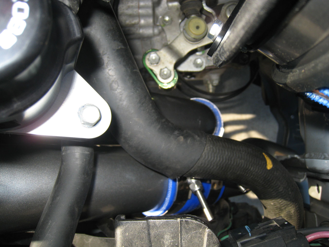

This next photo illustrates the bottom V connection working its way around the small heater hose below the radiator. I know on the V1.0 kit this was just a straight shot, so obviously more detail went into to how these pipe run. You will note that this pipe hugs the radiator and gives plenty of clearance for the belly pan.

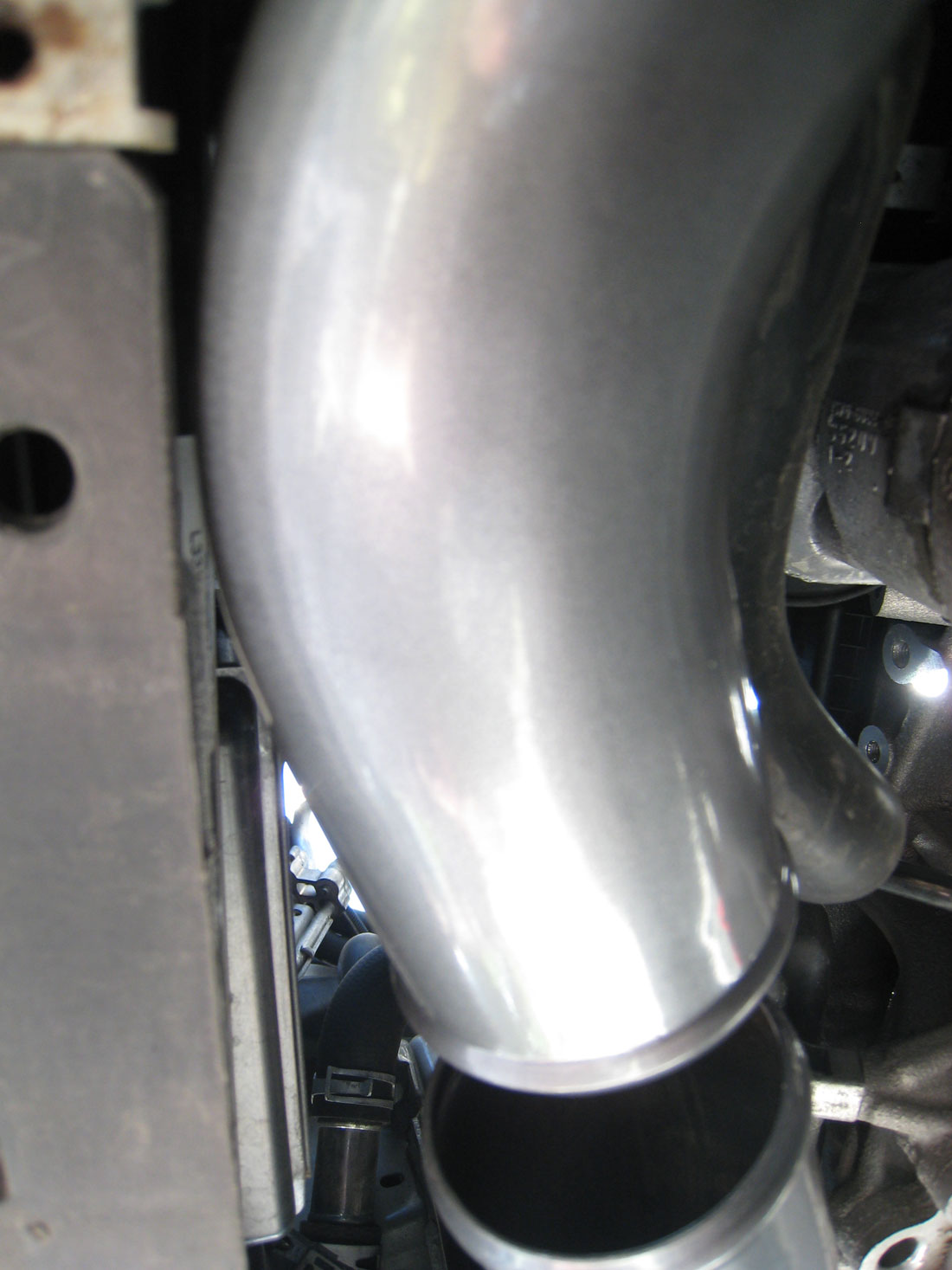

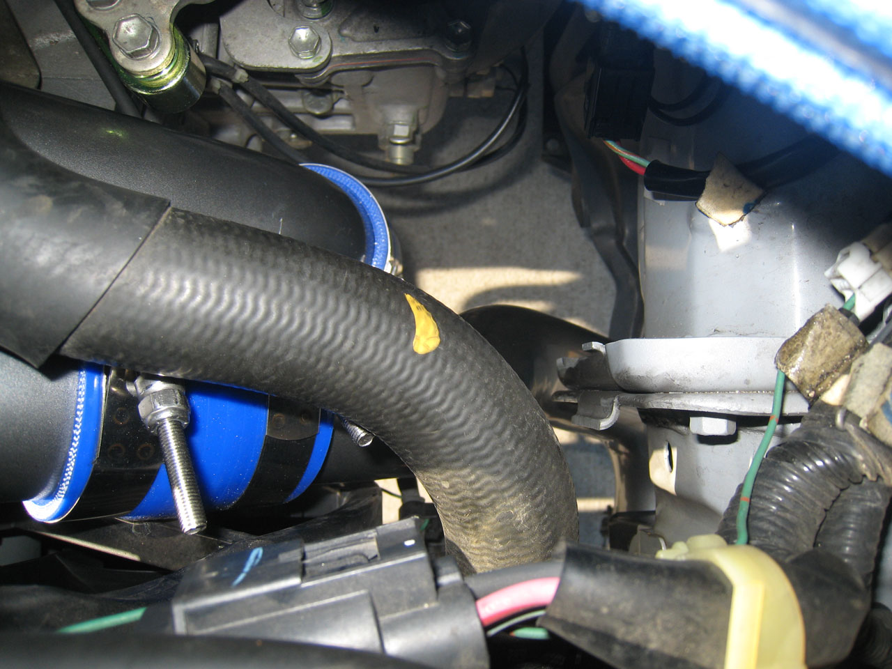

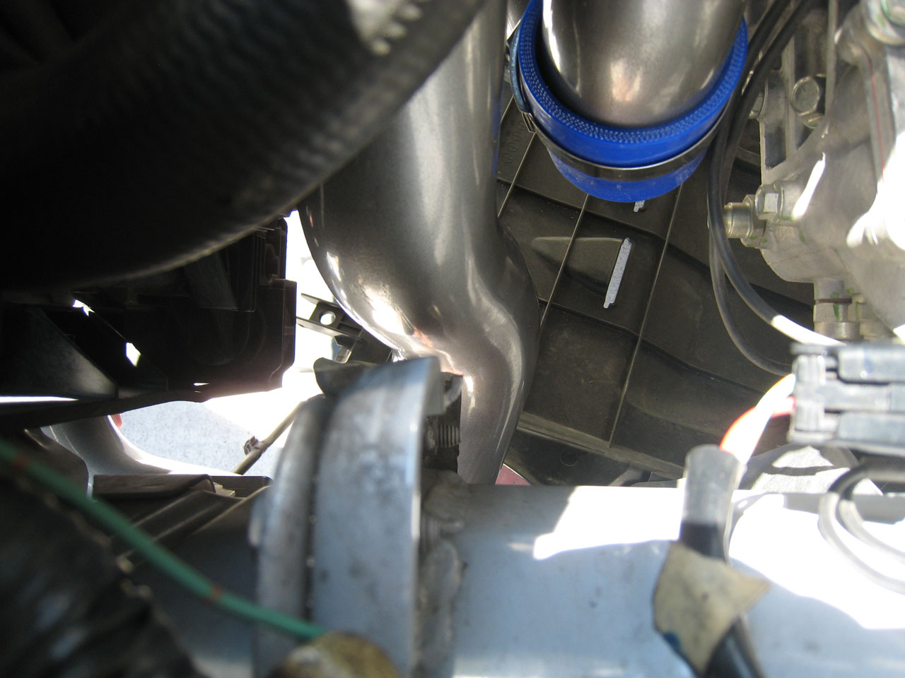

In the next set of pictures, you will see how well Billy designed the flow of the hot pipe leading past the notorious left bumper support. This area had punched a few holes in a number of pipes, mine included. I ran around for a year with alumn putty fill in mind, constantly replacing it, since i was to lazy to just have it welded with a thicker plate. I am happy to report this is not even a stress zone any longer!

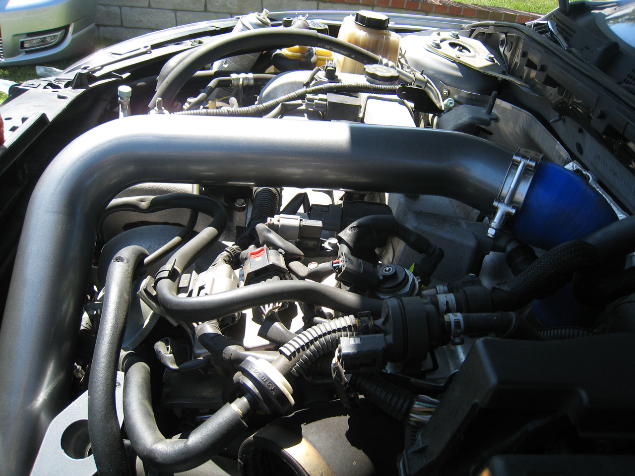

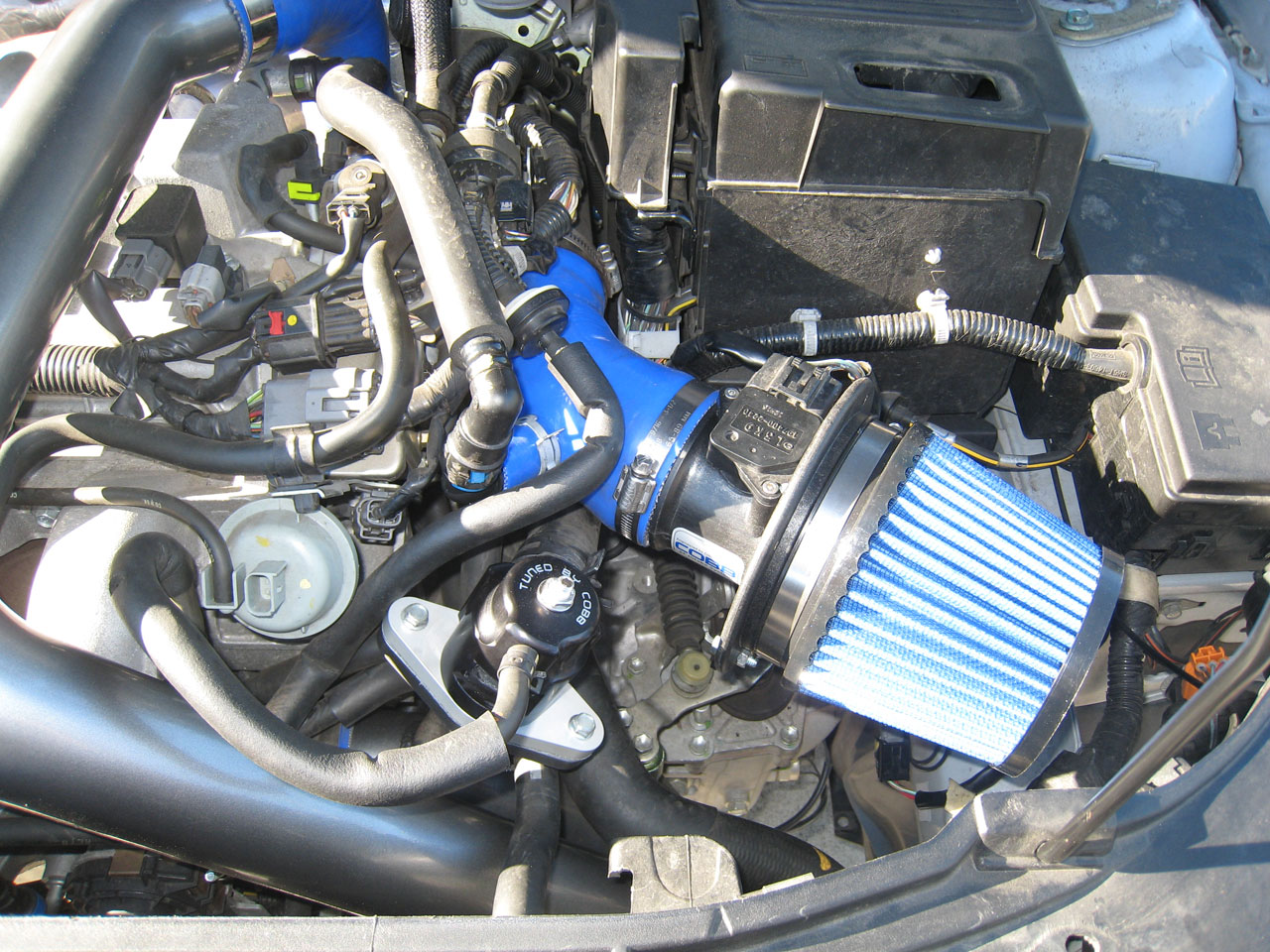

Theres plenty of clearance judging by the pictures if you are still stubborn enough to run a CAI. Its wise to ditch the system and go SRI, but some people still want to hold on to these nostalgic pieces for whatever reason.

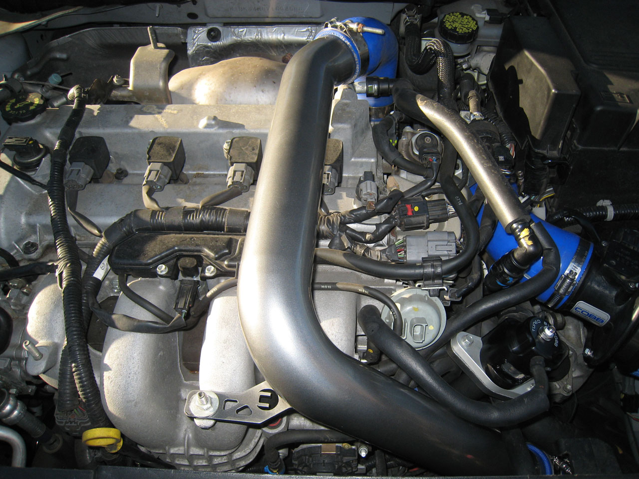

As you will see, the top piece hasnt changed to much. First off, the powder coating color is much lighter than the V1.0 system. They also chose to remove the Cobb decal off the top hot pipe this time around.

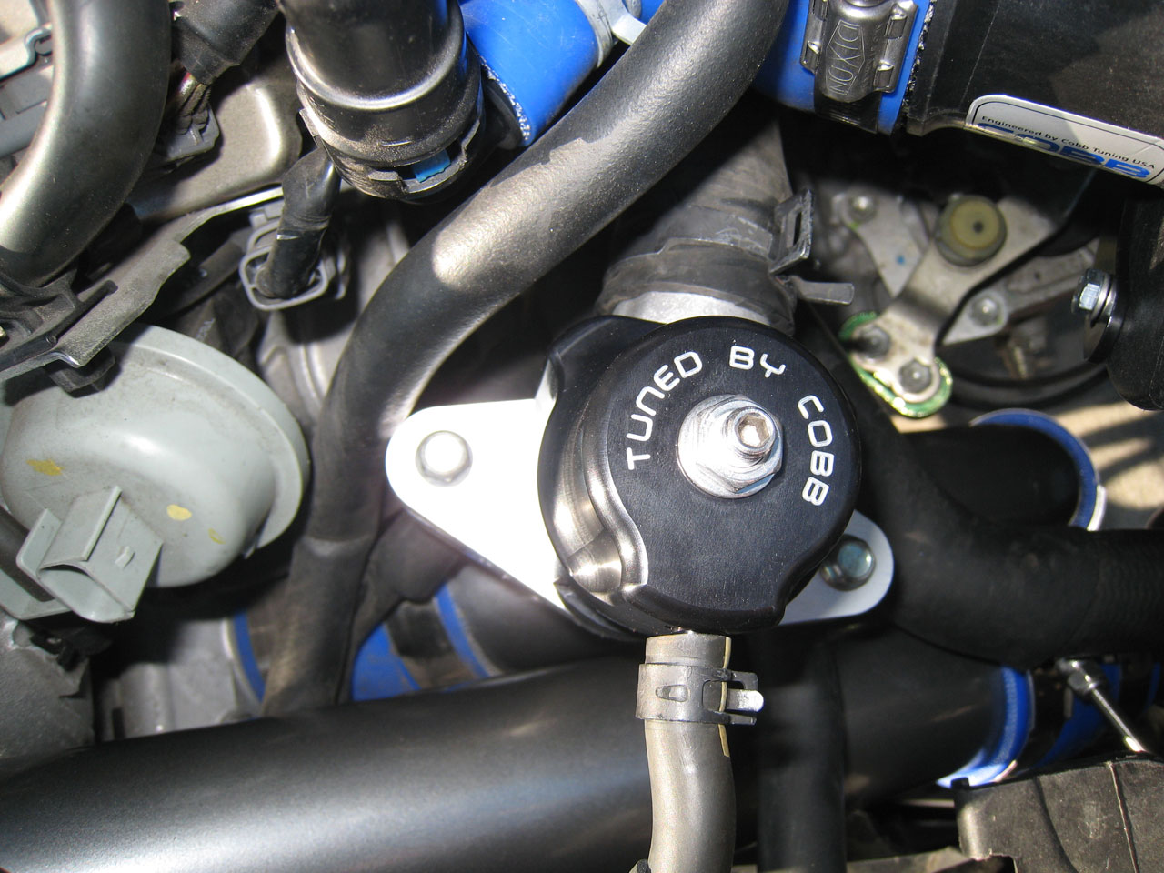

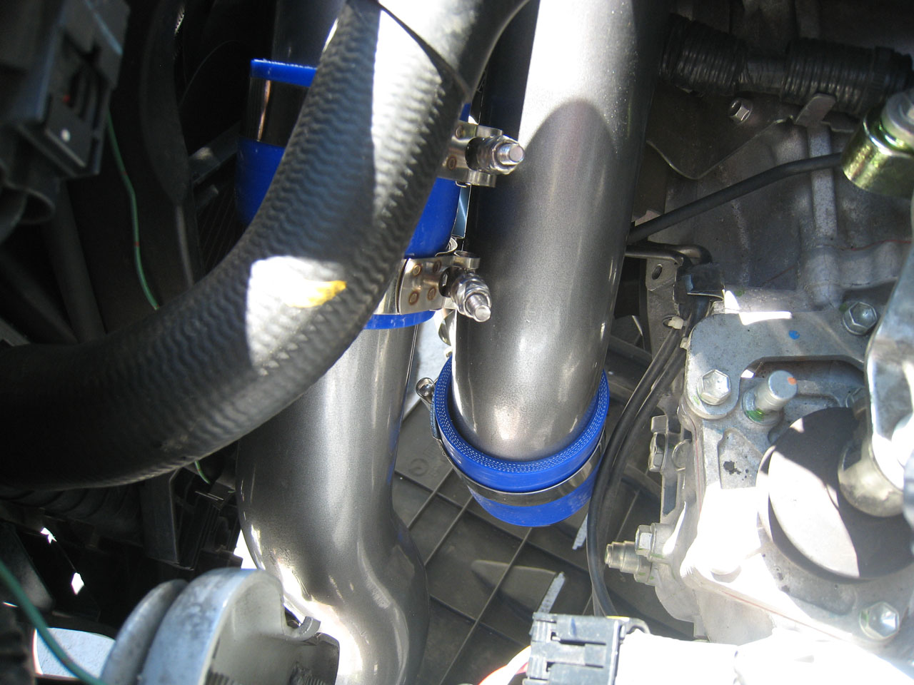

Here you will find the infamous shift weight that kept hitting my pipe by a small public hair. I spent damn near an hour scratching my head here until a light bulb appear.. FLIP THE FRICKEN THING OVER! Yeah, sounds easy, but unlike you, no install instructions on my end here people!
Here is a nice picture of that bottom pipe clamped together avoiding that heater hose.

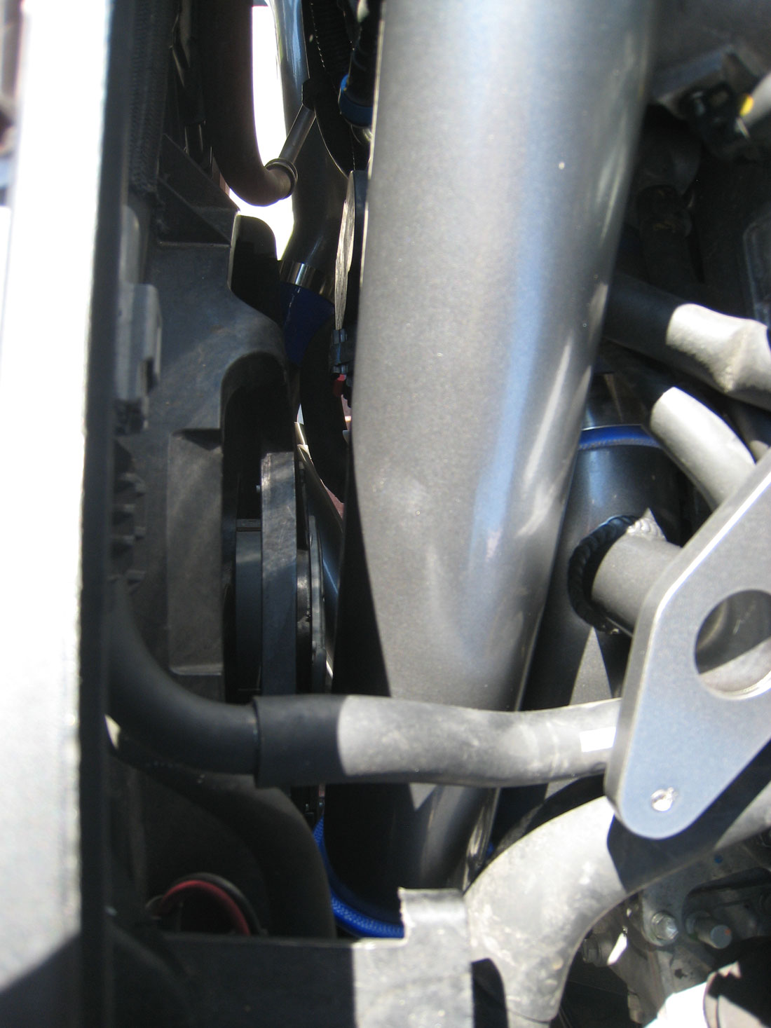

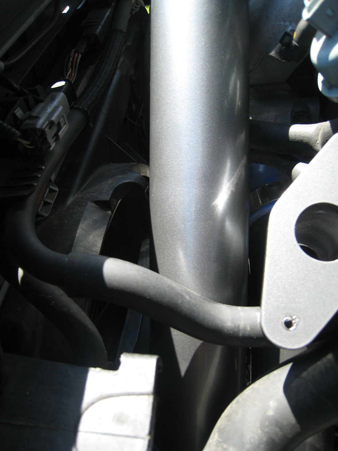

This picture shows you the swooping cold pipe exit and how it hugs the bottom radiator core while remaining tucked away to provide clearance for the belly pan.

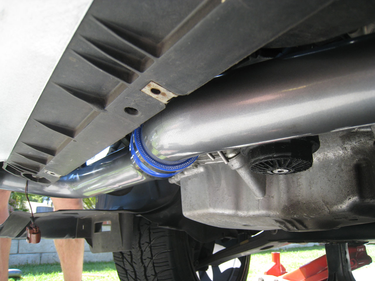

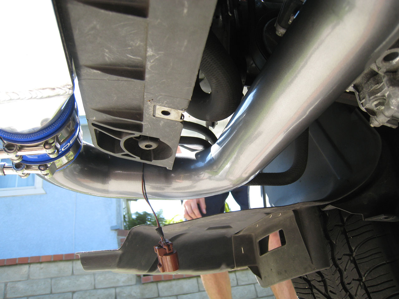

Below in an underside shot of the hotpipe connections in the damage zone where V1.0 would pop a hole in your pipe.

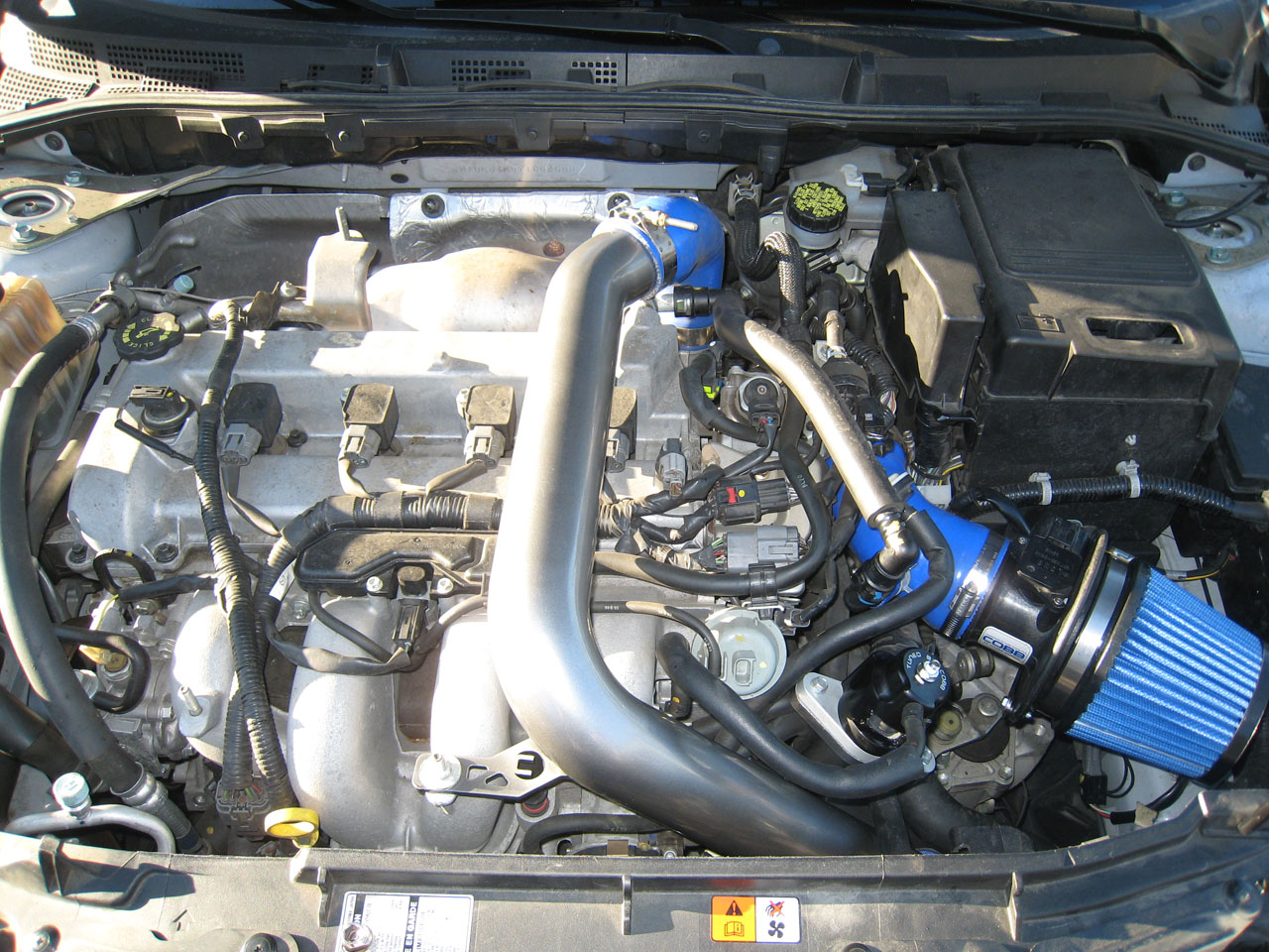

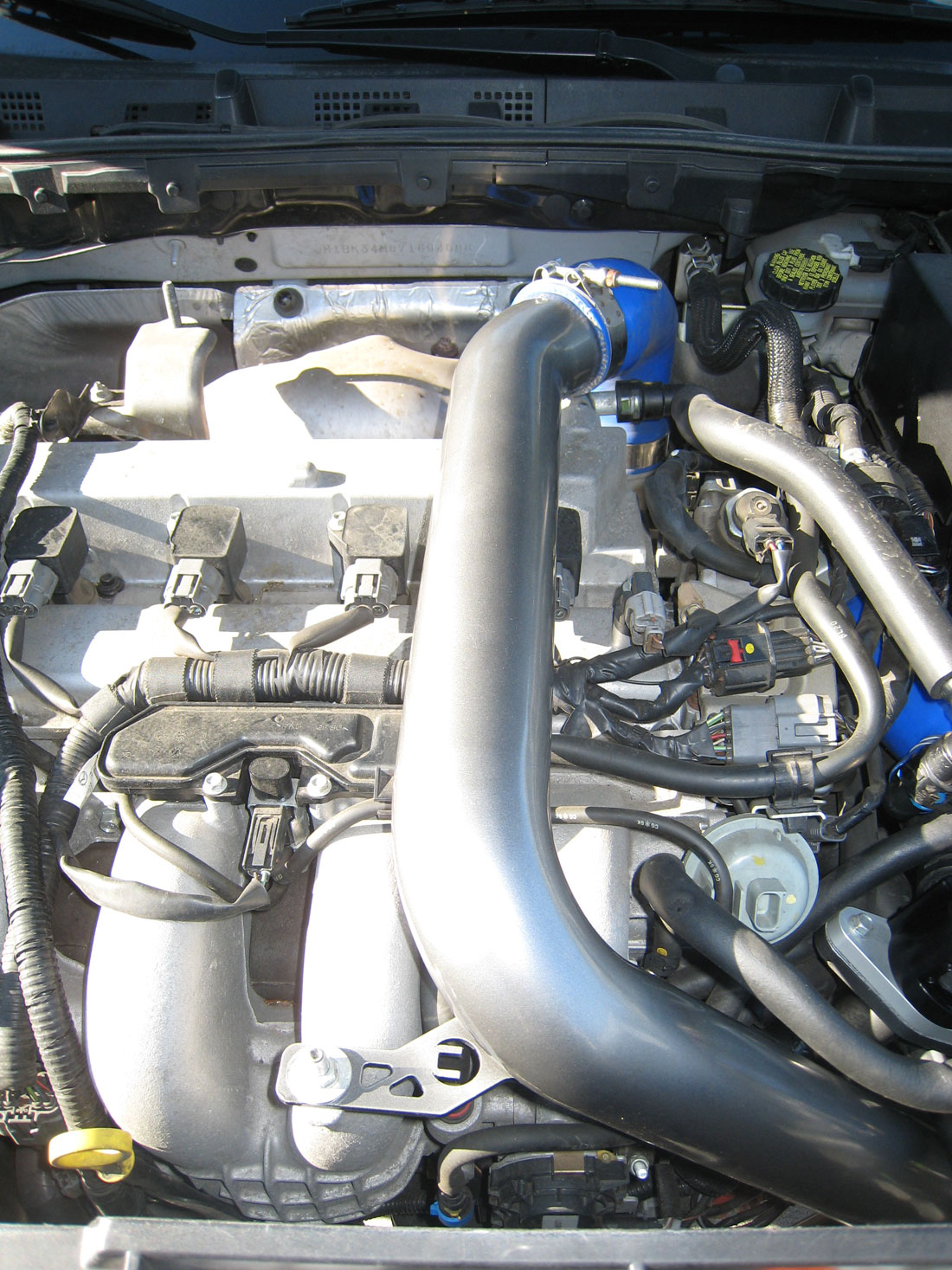

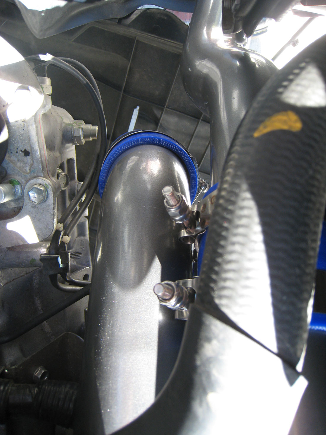

Here we have the top side intake section. This is problem alley and its fixed. Note all the room there for your CAI lovers... SRI makes it look as open as a desert in there. Be sure to get your clamps properly oriented in this area!
This picture shows how well the new lower hot pipe flows around that nasty bumper support.. Don't worry about speed bumps and dips any longer!
