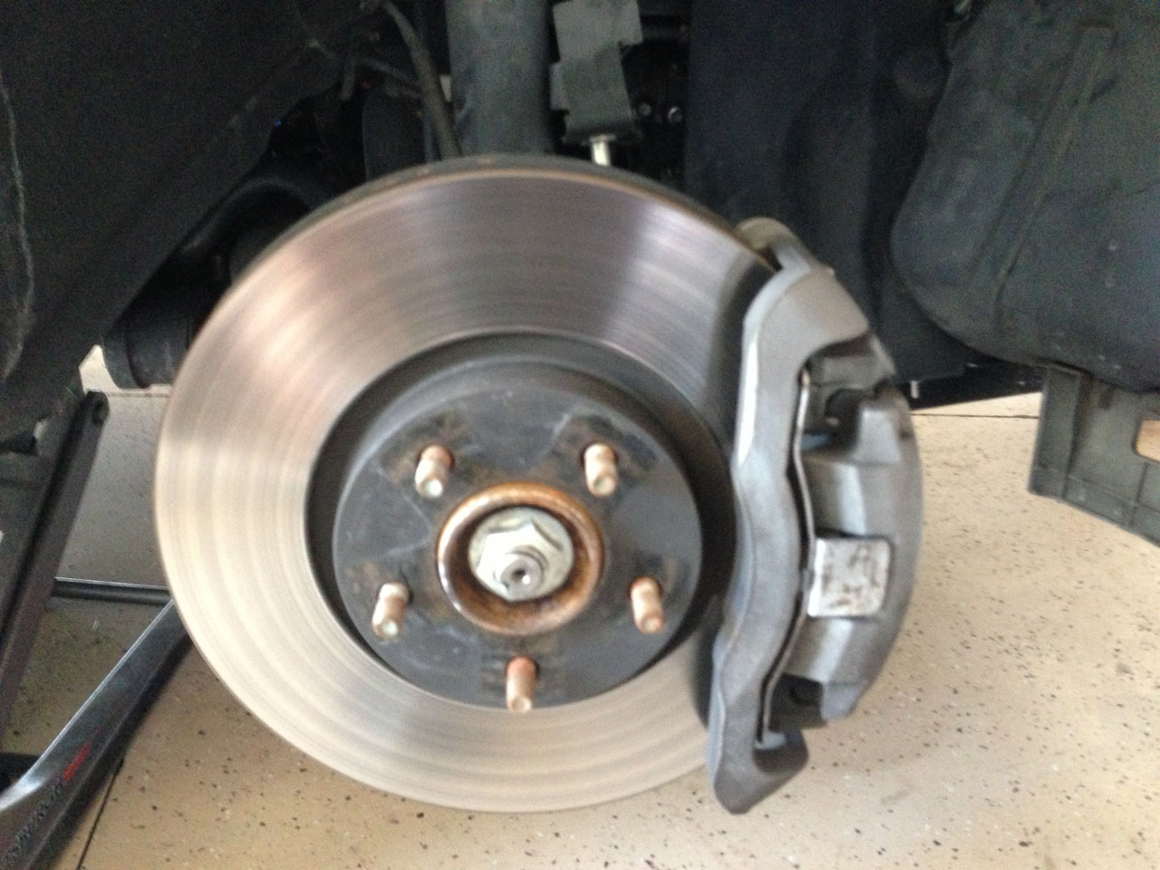

Please excuse the photograph quality.. i left my CF card in the computer and had to resort to an Apple product for images.

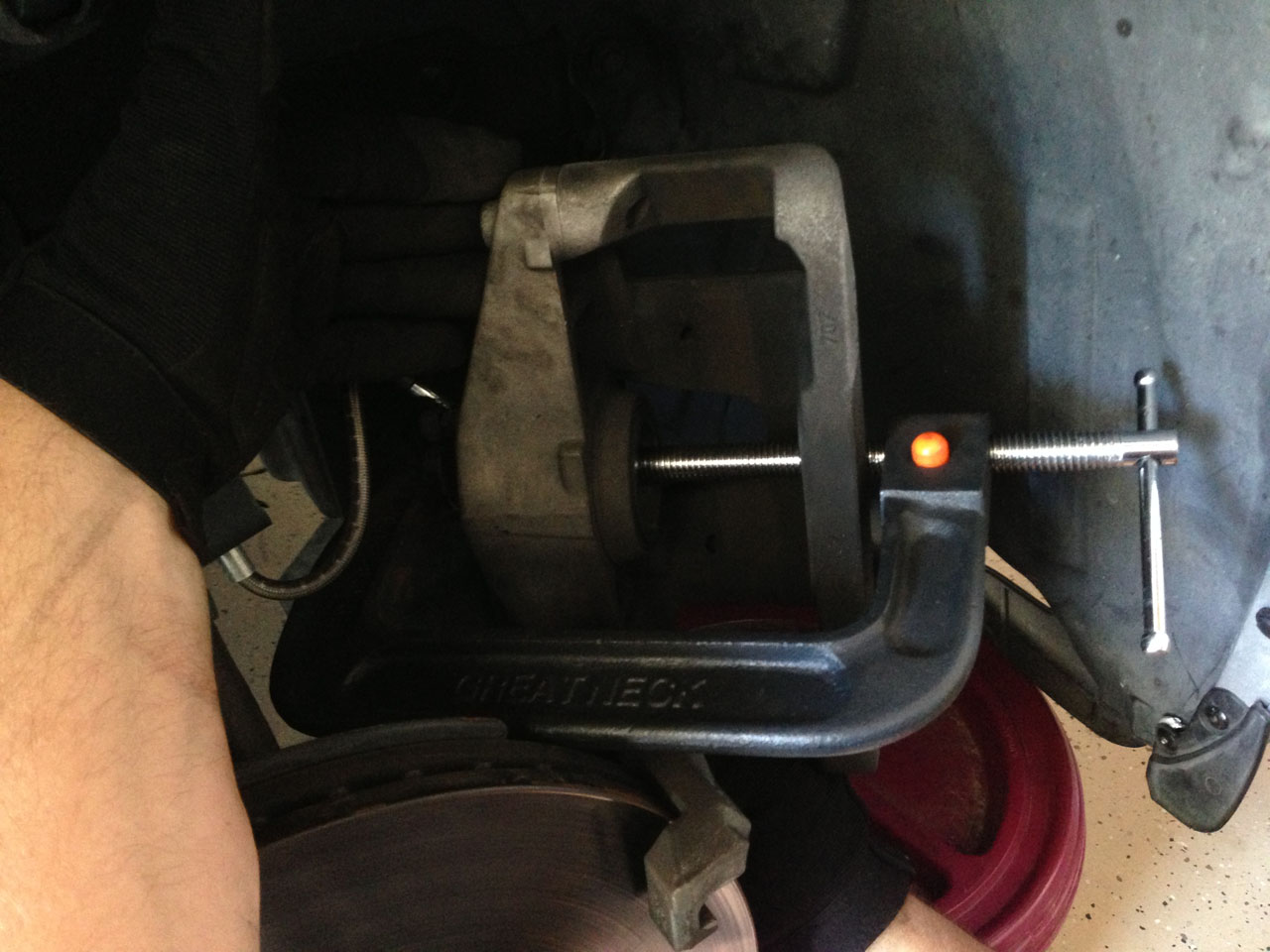

So, there's tons of threads on the forum showing you how to install brakes on these cars. I'm going to blow through the pre-school stuff and cut right to the chase. Its extremely important if you want to remain completely sane, to purchase the correct caliper reset tool for the rear brakes. It makes your life 20x times easier, trust me here. The first time i did brakes on my Gen1, it took me almost 3 hrs total to reset both rear calps with needle noses... The first reset tool didn't fit correctly and at 11:30pm, there are very few places open to buy tools.

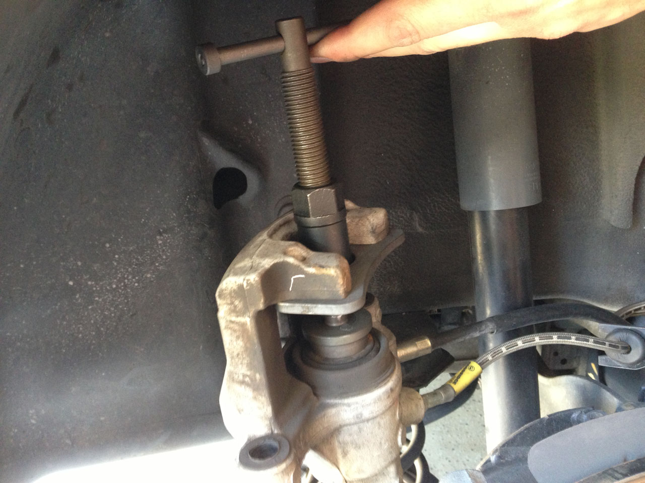

This time around... @UnknownSuperhero; provided a working calp reset tool for the rear and about 15 seconds later, the pistons were reset. I would suggest this investment be made for your local Nator chapter, it will pay for itself first time out..

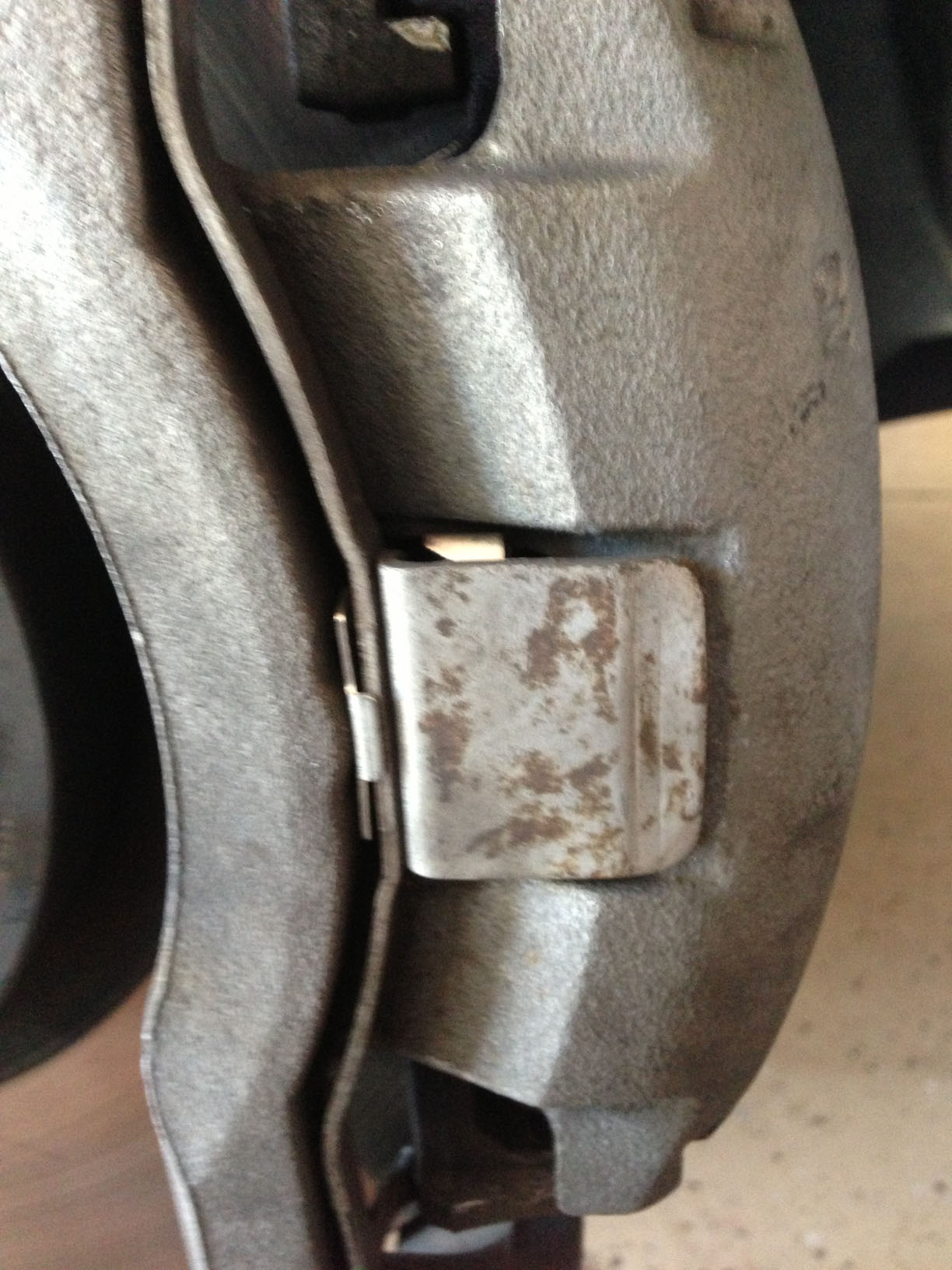

Corksport provides great installation instructions, unlike some vendors who provide none, but i didn't need them since I've already been down this road before. I do recommend picking up a 7mm Allen socket to remove the pistons pins from the rear calipers if you are not changing the rotors. This makes a huge night and day difference then just removing the 2 14mm bolts and pulling the entire assembly off the rotor. Again, my recommendation if you do not like to spend a long time working on stuff.

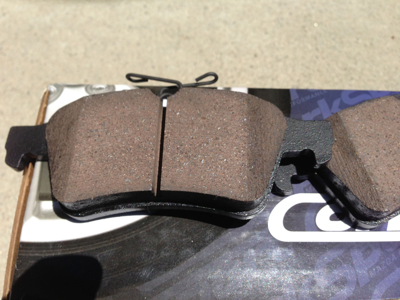

The rear pads fit without issue and have an anti squeal backing plate as well. Pads were out and back in within 10 mins of removing the wheels. I suggest lubing the pins up before screwing them back into the calipers.

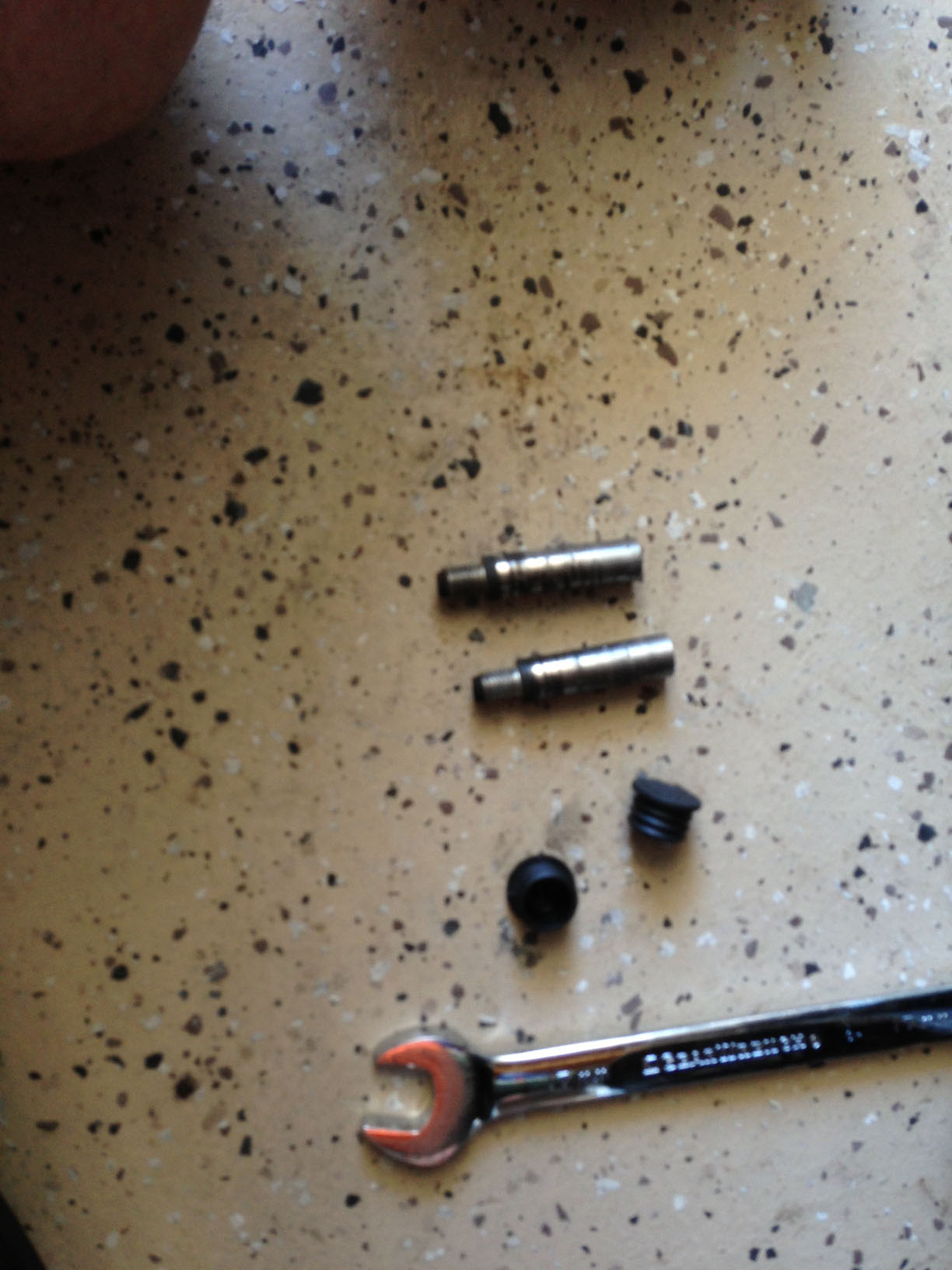

For the fronts, i recommend pulling the piston pins like you did for the rear. Again, its the quickest way to exchange just the pads if you aren't touching the rotors in my case.
So let's blow through this real quick and remove these NASTY Carbotech AX6 pads!
resetting the piston back into the calp. Love these large C-Clamps with the button to retract when finished.
