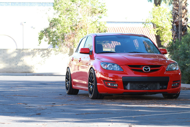

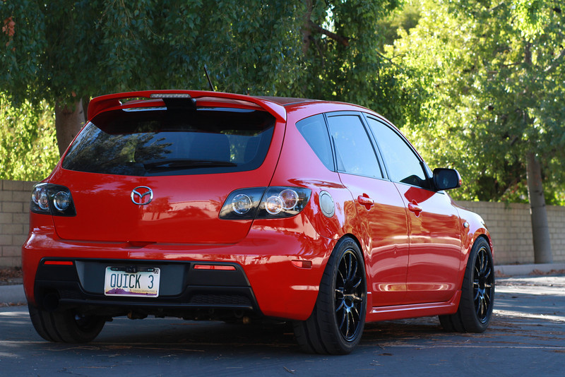

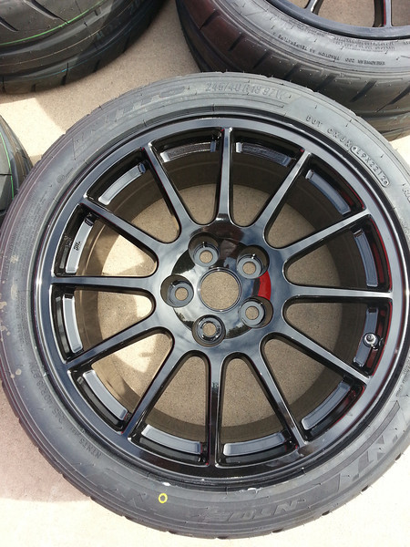

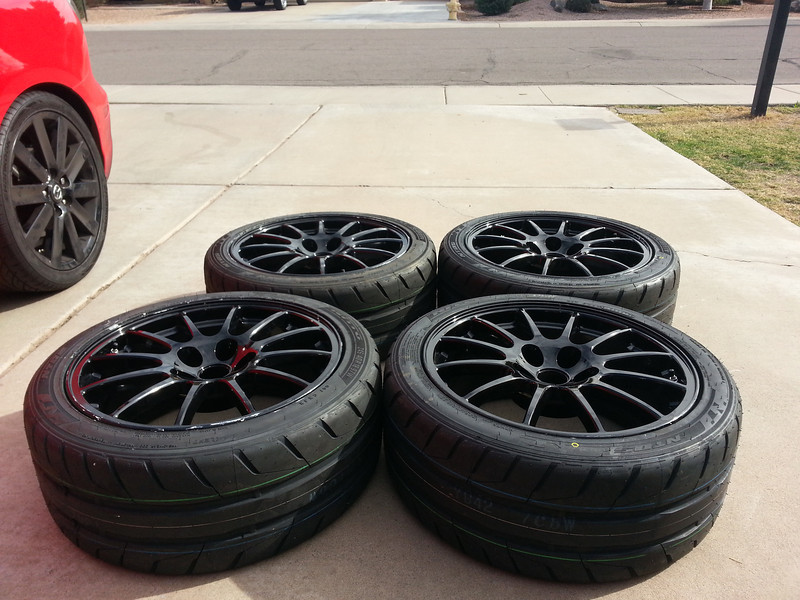

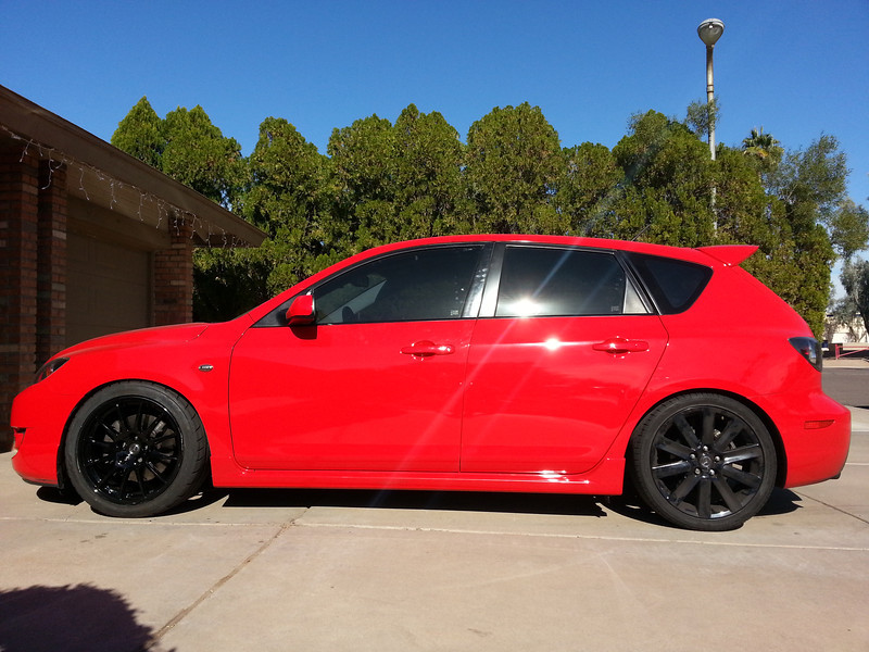

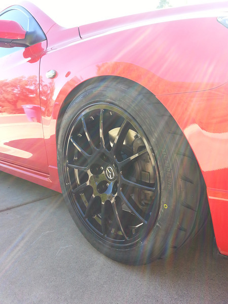

Default Evo X powdercoated black with 245/40-18 Nitto NT05's
I bought a perfect set of Evo X Wheels from a friend then immediately dropped them off to be powdercoated in black. Ordered a set of Nitto NT05 245/40/18 to wrap them up with and just got them finished today. I put the front ones on since they fit up there without rolling the fenders. I will be installing the rears this week after I roll the rear fenders on Thursday. Looks pretty good so far. I like the wider stance.

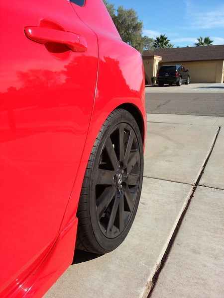

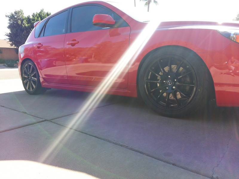

Front is the new Evo X wheels and rear is my old stock gen1 wheel powdercoated black.
Cant wait to get the rears put on, nice flush fit it will be.

That looks like its going to rub up front...

It does rub very light only at a full turn to left or right and over some hard bumps. Aside from that, regular driving and normal turning of the wheel and no rubbing occurs. I live in AZ and we probably have the best roads in the country here so i'm not worried about rubbing a lot. If it gets really bad then i'll roll the fronts but for now they fit pretty good.

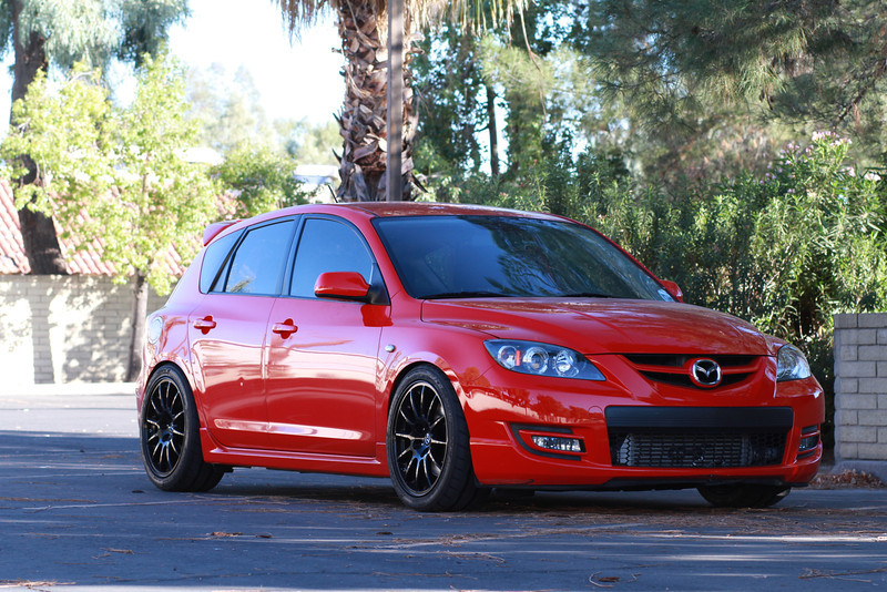

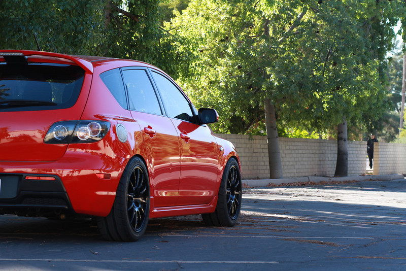

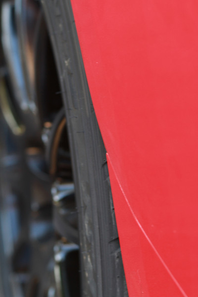

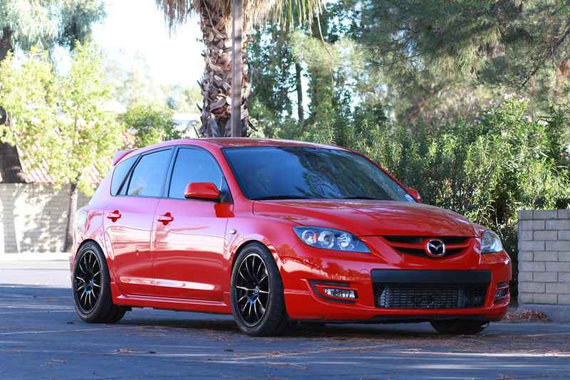

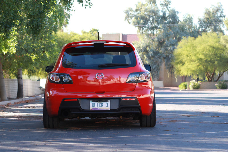

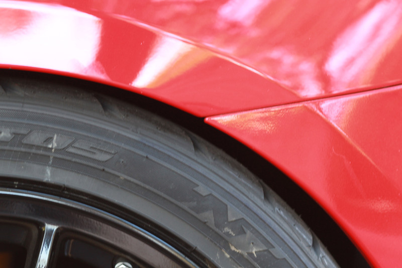

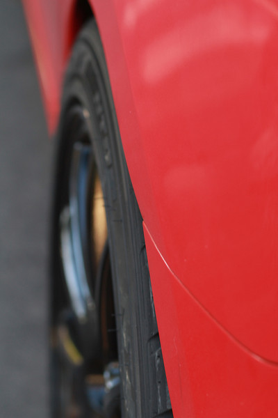

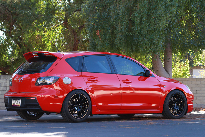

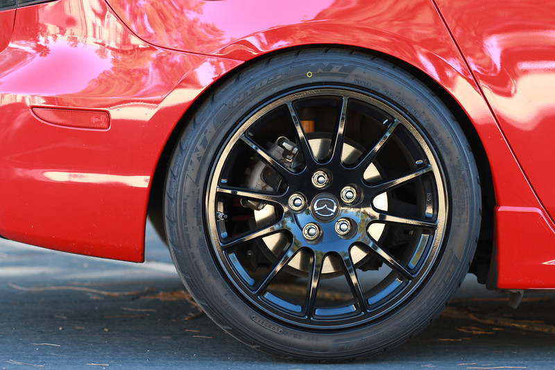

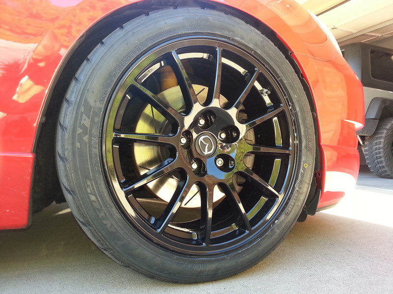

Here are some more photos I just snapped after I got my fenders rolled. I need to figure out how to adjust the bumper, the little seem where the bumper meets the quarter panel could not be pushed out or rolled so i rub there when i go over bumps or accelerate hard. If i'm driving normal and not hitting any bumps it doesn't rub. Aside from that I love the new aggressive look.
Here is the part i'm talking about that rubs. What have others done to fix this?

Bust out the Dremel.

I have a dremel, and do what? Cut the inner part of it or something up to the sheet metal?

Pretty much.
Carefully remove as much of that inside "lip" as you can where the fender and bumper abut.

Evo x rims look amazing on ms3, very clean!

Does the rear rub when you've got passengers in the back? Just curious because I've got a set of evo X's I'm going to get some tires for soon and I'd like to go a big as possible

Yes they do I have the same setup rolled the back and cut did errrrthang! Lol

+38. rubs just a little with 245s...just a little

+38 and no rubbing up front but a little in back especially with passengers. Thanks for the comments

$500 for just the wheels and $240 for powder coating

The aggressive fitment looks unreal. Very nice!
