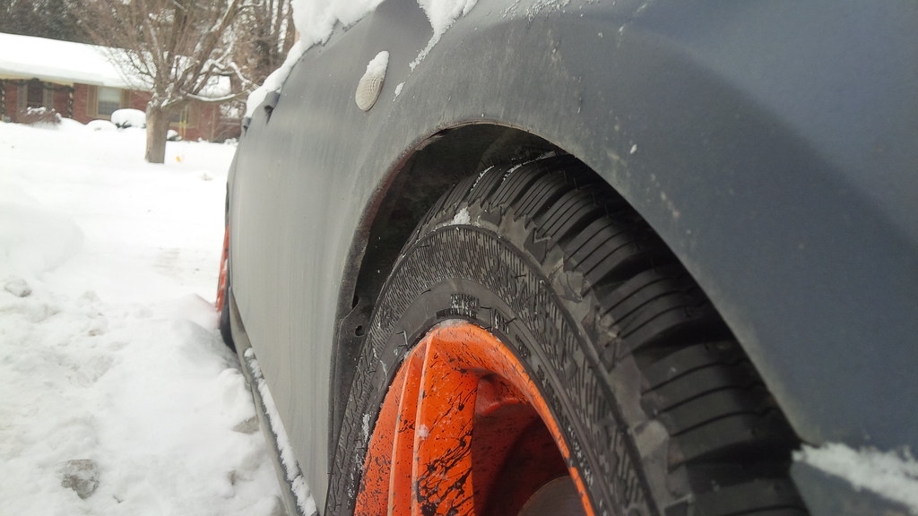

I ran Hercules Avalanche Xtremes last winter in 235/45-17"
Very very meaty snow tire, highly recommend them for the price. If my car wasn't so low I could go through anything.
At first I wasn't sure if they would fit without rubbing
