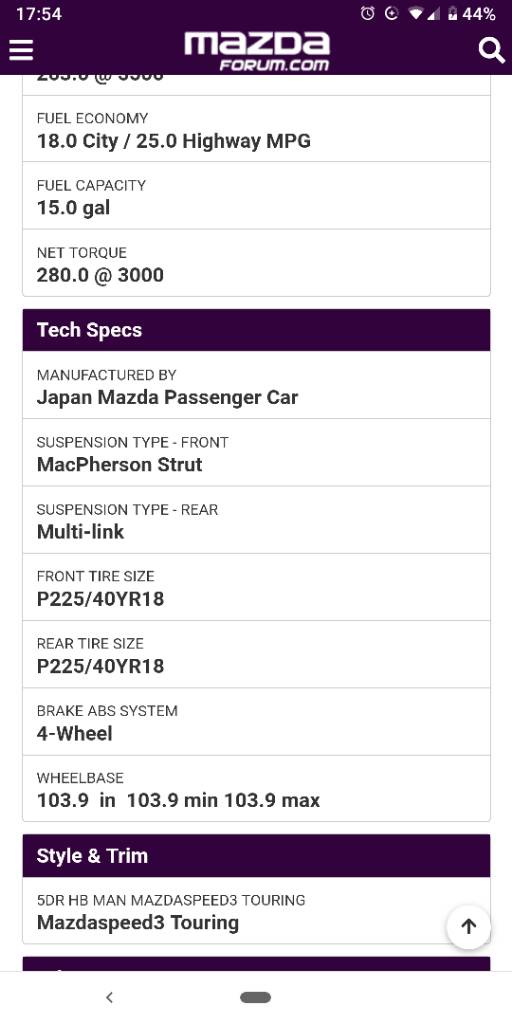

Old post revival. Have had 235/40-18 Conti's on my stock Gen1 with RX8 rims for years w/o a rub......
That's the stock size on my speed3. Many people commented on that size not rubbing, and I'm seeing that as stock tire size on Mazda's Vin decoder.
