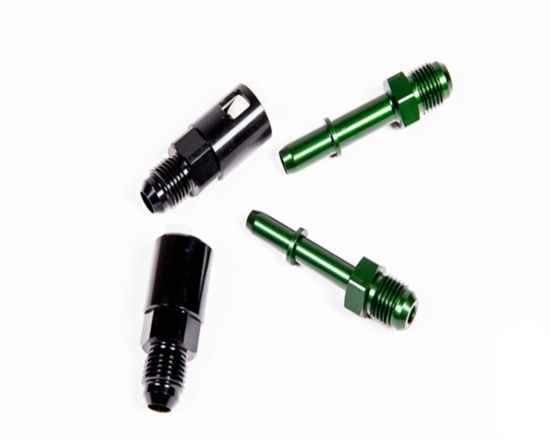

In the process of pulling my motor, but I did confirm that the "hard tube" is 5/16th. I think I am going to end up using the screw in type quick connect EFI fittings to 6AN SS line.
push lock vs. screw in type.
Ordered them today, should get them in a couple days...

The push on to -AN will work.
I have personally seen them used on a couple big builds, of people who are no longer on the forum.
And as a matter of fact, SP includes them in their Port injection kit.

I will be re-working my fuel system with these this weekend. As was mentioned, 5/16" is the correct size. I believe you could also remove the EFI fitting from the HPFP and likely replace it with a -AN union of some sort, but I elected to use push on EFi fittings on both ends.
Quick ordering tip, the Vibrant fittings drop ship when ordered from both Jegs and Summit. The Vibrant fittings I ordered from Jegs before the holidays still have not shipped, or at least tracking info has not been provided. Saturday I ordered Russel fittings via Amazon, and they arrived yesterday. So if you're in a hurry, avoid Vibrant fittings via Jegs or Summit.
