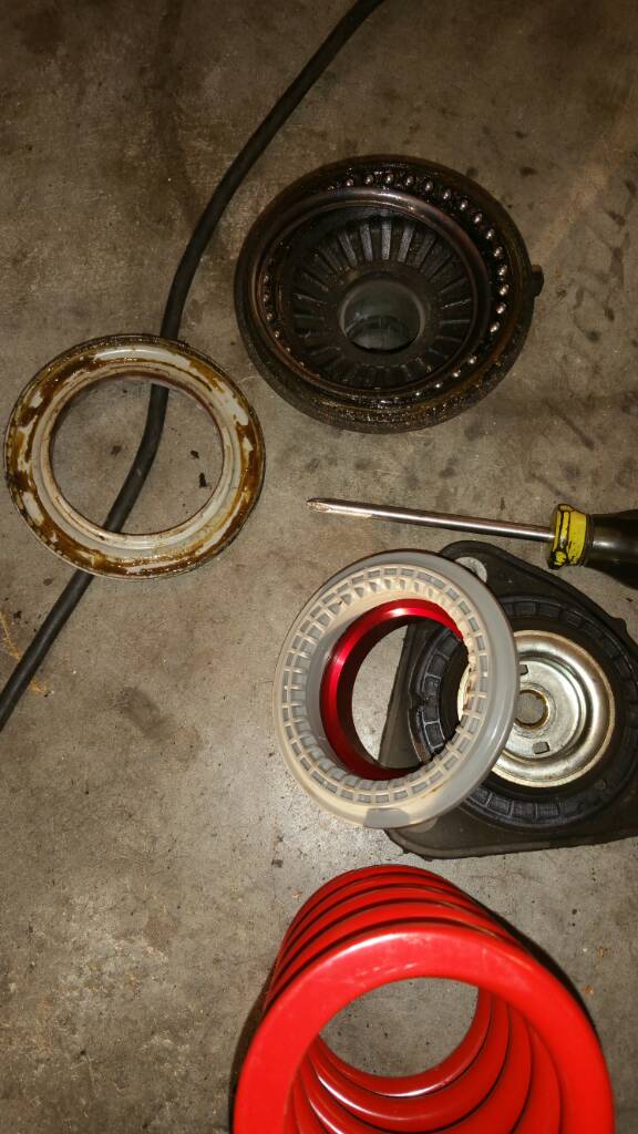

Anyone have pictures about how the front strut mounts and associated hardware fits together? I'm missing something.

IIRC, You mount the gc supplied grey bearing on the tophat. From your pic, You still need to pry off part of the bearing from your hat. The perch (red?, mine is gold) on after that.

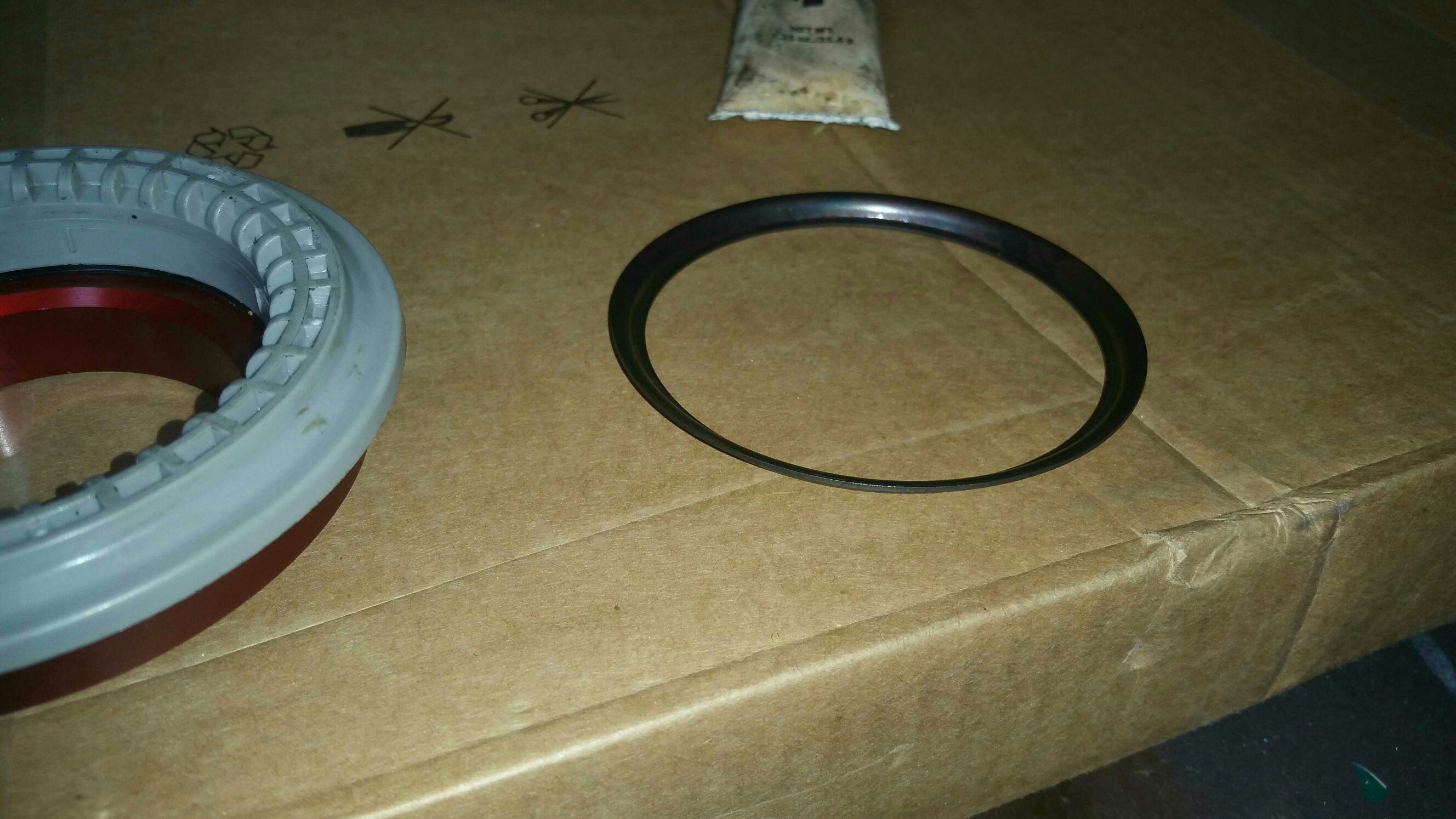

I thought the bearing was this thing...and that gray plastic thing is a bearing? It doesn't rotate or anything.
Sent from my SM-N915V using Tapatalk
SnailTune in progress
 Old 04-16-2017, 07:37 AM   #966
btstarcher's Avatar
Location: Russellville, AR
Posts: 4,852   (View Stats)
Rep Power: 1975
Thanks: 6,199

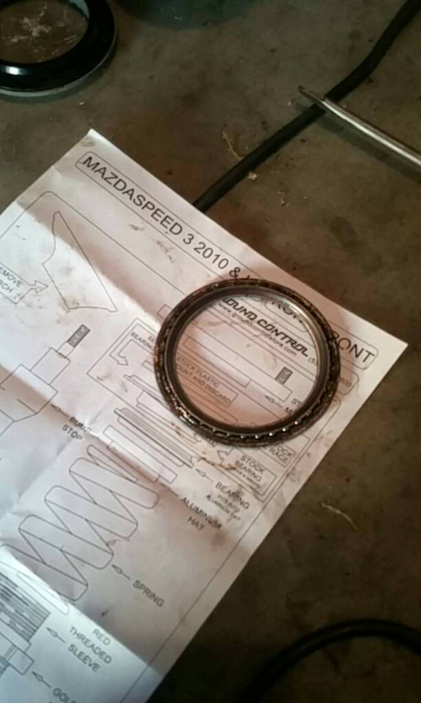

Originally Posted by Helrich View Post
Yeah, the only existing part you should be re-using for the front is the top hat (and the three bolts that go into it).
Sent from my VS988 using Tapatalk
The instructions also say to keep the stock metal race. The fuck does that mean? The only thing that kinda makes sense is this, but it doesn't fit anywhere.

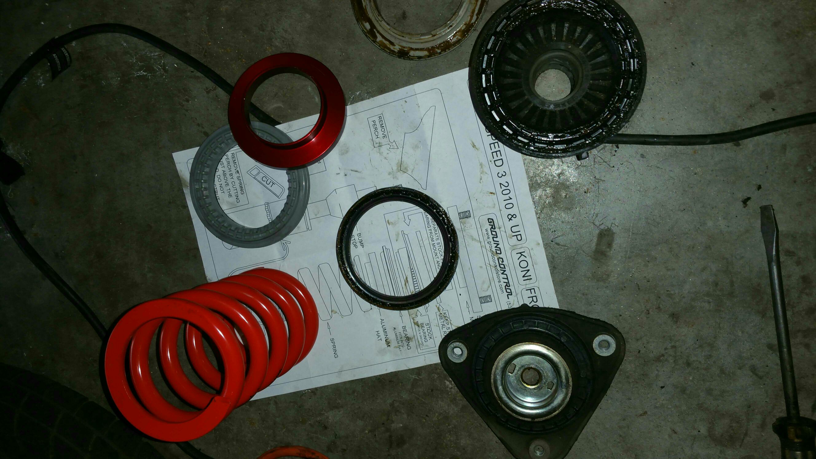

It's kind of hard to get a good sense of perspective in pictures, but like Mattyhawk said, you still have a plastic ring on the bottom of your tophat that needs to come off. There should be another race under that (I think, it would be slightly smaller diameter than the one you posted if I'm thinking correctly), which is what you keep. The light gray ring that GC sent mates to that. Honestly I don't remember doing this way back when I did mine, maybe they altered the assembly. I just recall ripping everything off the tophat and slapping it on top of all the shit in the kit.

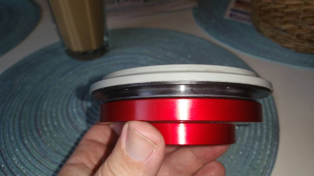

The only way I can see this metal race working is by placing it in the new aluminum top hat, with the gray bearing on top of it. The beveled edge of the bearing fits nicely.
The thing is, I don't see how I can pry this off and keep the metal piece that the shaft bolts to.

That looks right to me. I never put a metal race on mine.
I think that is right. Does the grey bearing fit on the tophat?
It does. But I think there would be lots of friction.

The bearing from GC doesn't have balls and races, but just two plastic rings that ride on each other. It seems to work.

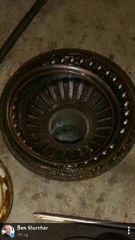

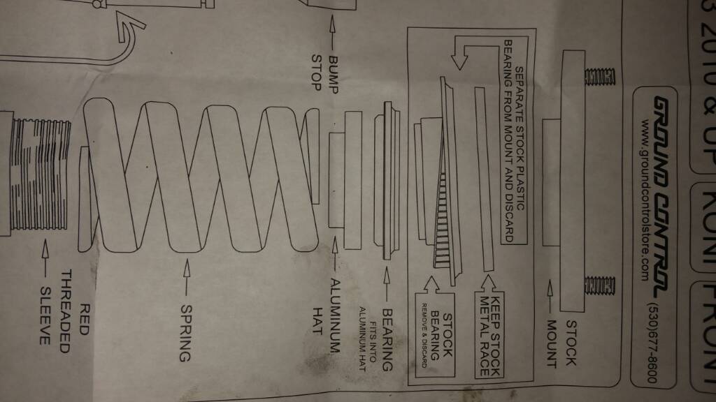

This might be better instructions, this is what came with my set. Its different than yours
http://www.mazdaspeedforum.org/forum/foru...speed-gc_1.png
The Following 2 Users Say Thank You to Mattyhawk1 For This Useful Post:
btstarcher (04-17-2017), MD1032 (04-20-2017)
 Old 04-17-2017, 08:52 AM   #975
btstarcher's Avatar
Rep Power: 1975
Thanks: 6,199
Weird. Nothing about keeping shit except the top hat. Still, since I just purchased mine, I should call just to verify. If I need to remove it, I can probably just jack the car up and cut it with some wire cutters.
 Old 04-17-2017, 10:44 AM   #976
btstarcher's Avatar
Rep Power: 1975
Thanks: 6,199
GC contacted me and apologized for the confusion. That metal piece should have been left out. I lifted the front and used a dremel to cut it and pulled it out with vise grips. Thanks for posting that instruction set.
