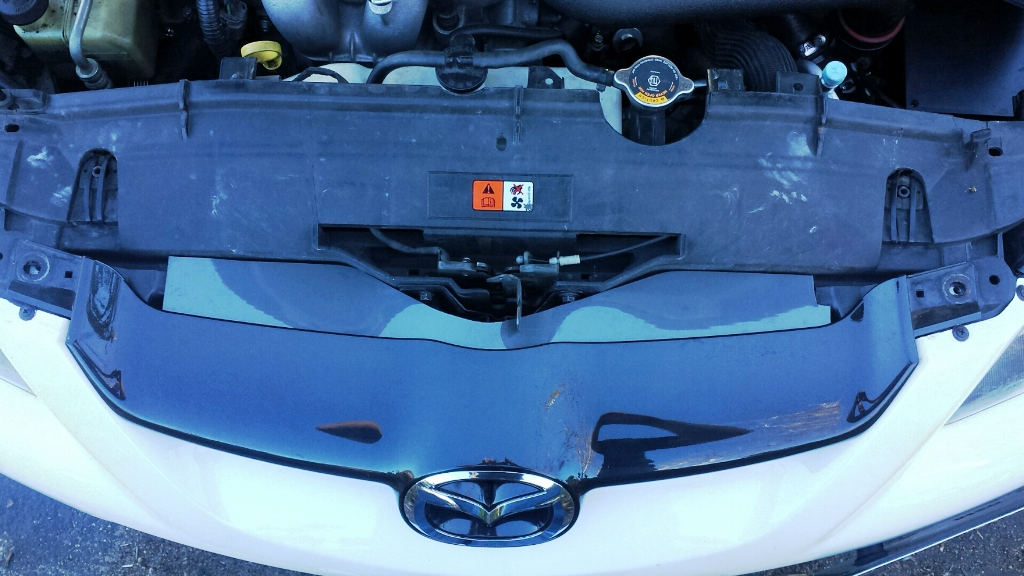

Eric, give me some pointers on cutting crash bar.
What are the chances you can dremel out the empy fog light space and or even cut to angle air into the engine bay via that. Just some brownie logic for weekend lulz.

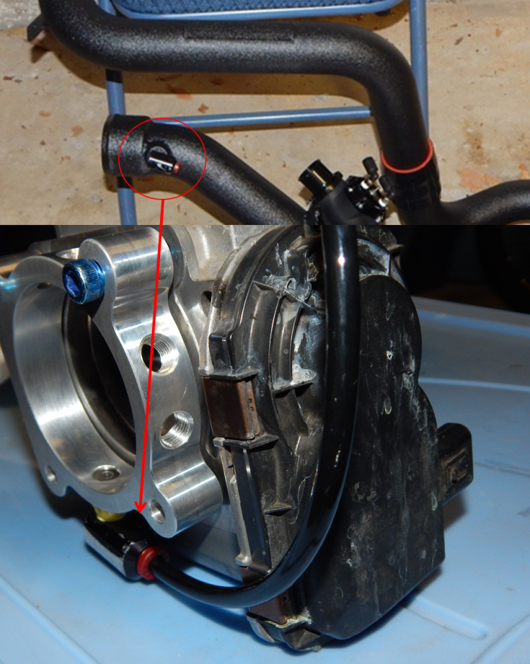

Got a few nits fixed this weekend.
Grinded wmi nozzle bung down a bit so the nozzle sits flush with the ID of the cold pipe. It was recessed in the bung about 3-4mm before.
Changed thermostat because old one was opening too quickly.
Changed out 4mm vacuum hose with 2mm vacuum hose for CMGS method controller boost signal line to see if boost readings don't jump around as much.

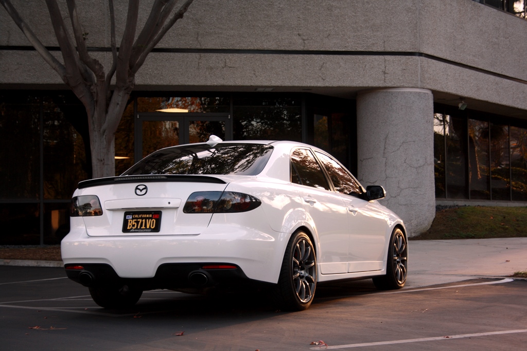

Got a few pics showing off the new limited edition CA vintage black/yellow plates. Kind of looks cool I think.

We get it, your car is prettier than ours...
Diggin the plates

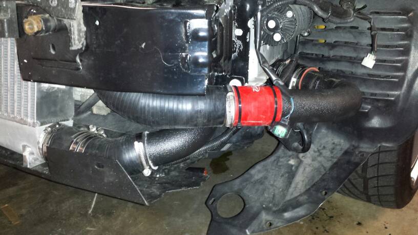

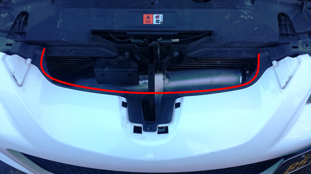

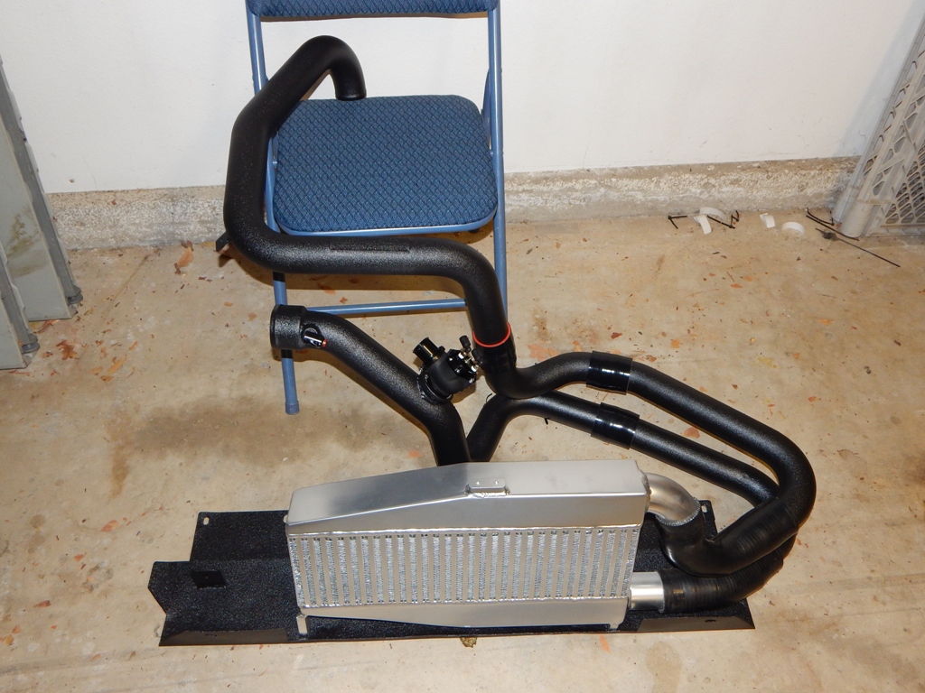

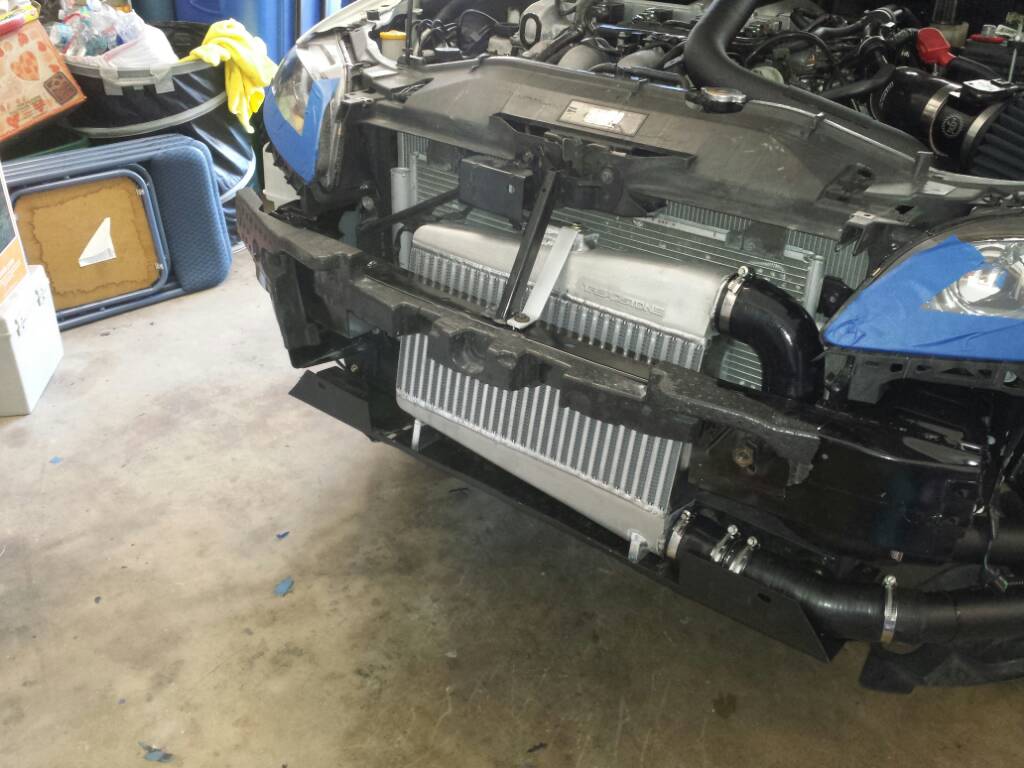

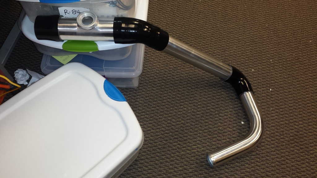

After putting the CP-E FMIC on and getting pretty shitty results from a BAT improvement perspective, I updated the intercooler to a real intercooler, a treadstone TRV1859. I had a welder weld the same mounting locations on the treadstone as were on the CP-E FMIC and it plopped right on. Performance increased significantly as a result, I think I saw a 20whp/20wtq improvement on account of lower BATs and being able to push timing up.
I am now moving onto my next optimization for the CP-E kit. I hate the routing of the CP-E cold side. It's ridiculous. It's long, and it basically contacts the hot side where the bpv is. You can see the cold side here.
The CX Racing and similar FMIC kits have a much smarter routing idea on the cold side. Instead of mirroring the hot side and coming around and up, they just go between the frame and radiator support for almost a straight shot into the throttle body, like this.
Examples from @TiGraySpeed6;
I am also going to open up the cold side a little per what I have read on a few sites (and also what Corksport did on their latest kit). Instead of the 2.25" pipe, I am going to step up to 2.5" and then 3" right before throttle body. Also, I am going to add the DM throttle body spacer and put 2 x D03s behind the throttle body spraying into the plenum instead of a big D07 in front of the throttle body spraying into the 2.25" pipe.
So, that's the next project.
MINI H1 6.0 - CAR LED TAILS
ItsNox (12-07-2015), SpeedRebirth (12-07-2015), TiGraySpeed6 (12-08-2015)
 Old 12-07-2015, 03:56 PM   #661
dale_gribble's Avatar
Posts: 4,720   (View Stats)
Rep Power: 5431
Thanks: 2,552

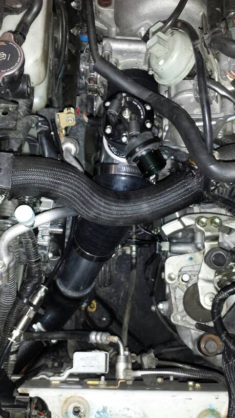

Here's my parts list; you can see how I use the pipe/couplers to step up to 3" before throttle body.
(in order from cold site outlet to throttle body)
CX Racing 2.25" 75 Degree Mandrel Bent Polished Aluminum Pipe, 2.0mm Thick Tube, 18" Length

Wow-
Seriously nice upgrade on the intercooler core!!
Looking forward to what you think once you get the new pipe layout in place- should make a decent improvement to your throttle feel and reduce some lag time.

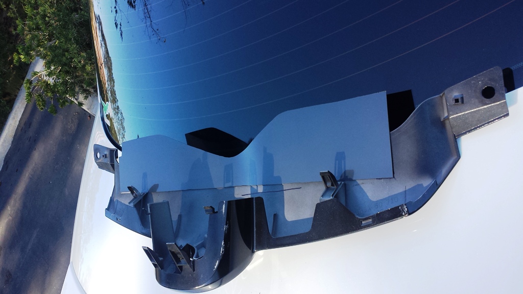

This is a little mod I did to get more air to radiator since there isn't a top mount anymore. First, hack the air guide behind the grille as shown. I did this with the bumper OFF the car and with the air guide OFF the bumper. I wouldn't do this on the car I don't think.
I mocked up an air diverter from cardboard (my favorite prototyping tool), and then cut out from 1/8" plastic using the cardboard template. I double sided taped it to the grille with that really good 3m automotive tape.
reattach grille with diverter and voila. I know it's doing some good, because when the fans are on, I can put my hand in front of the grille there and fill the air sucking past my hand.

New coldside is in (not cut to size yet). You can see size progression from 2.25" to 2.5" to 3" at BPV tube. Silicone intakes size change couplers are great, and the CX racing pipe is nice too. You can see how much cleaner the routing is this way compared to the CP-E cold side in the pic above.
Damond throttle adapter and Devil's own nozzle/holders didn't make it in tho, so I guess next weekend for this project.

Cold side routing ended up being a PITA. Got it done and outcome is good but it is tight everywhere. Bpv hose is right next to coolant hose, coolant hose is close to 3" housing, the cold side barely squeezes by the hot side and radiator support. Whew...
So, next is the Damond wmi nozzle plate.
I also pulled throttle body and was surprised to find the IM it coated in a light mixture of oil and water/meth mixture. I'm running occ that is working well and not burning a lick of oil, so it has to be egr. I put the JBR EGR block kit on.

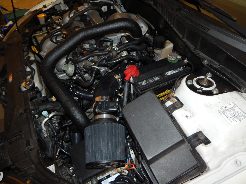

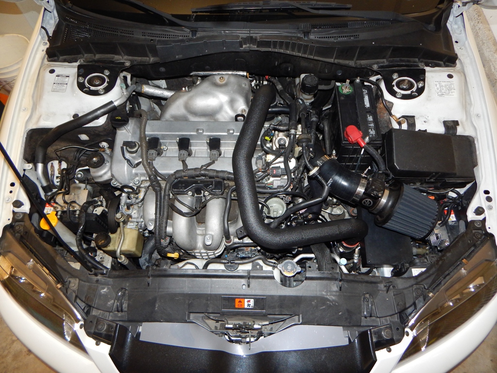

Here's an updated engine bay. Pretty boring for 400+bhp. Not very exciting for everything that's there.

Looks fantastic.

You need turbo Steve's valve cover and fuel pump covers. Considered?

Ya, when he's in production I think I will actually.
On a side note, blew off a coupler on the hot side behind the bumper this AM FML. Monday FTW.

Car gets dirty and beat up, don't worry! I used the silicone couplers between two silicone hoses on the hot side, and I just rushed putting it back together. I took the piping apart last night and put it back together; actually the new cold side came together better when I massaged the install a little bit, so time well spent.
I relocated the meth nozzle from the cold pipe pre TB to the Damond throttle plate post TB. It's not a slide to Damond, because they are all pretty much the same, but I don't see why they even bother tapping multiple holes on multiple sides. There's no clearance on the top due to the IM and there's no clearance on the front because of the TB's drive by wire motor assembly. So, hint, you're only going to get a nozzle on the bottom with these adapter plates.
I did a few runs on the exact same map as before, and now I have KR from 5k-6.5k ranging from 1.5-2.4 on back to back runs. I need to do more homework, but it looks like the engine doesn't like the nozzle post TB; maybe it isn't mixing in with the air as well or distributing to all of the cylinders evenly. BATs are lower now but there is now KR when the runs were consistently clean.

After reading about it, I have a feeling that the first runner or two probably aren't getting an even distribution of WMI + air mixture.

maybe and lower BAT affect the timing curve a bit...is it enough alone for a 2deg of kr, i don't know...
You may compare before and after timing...

Timing curve is the same. Could still be mechanical, I have a little more homework to do. I'll dial tune back and see if kr persists.

I had more in mind: if you got better BAT with this setup, the table ''IGN bat VS ECT A & B'' can affect your final timing a little bit...
