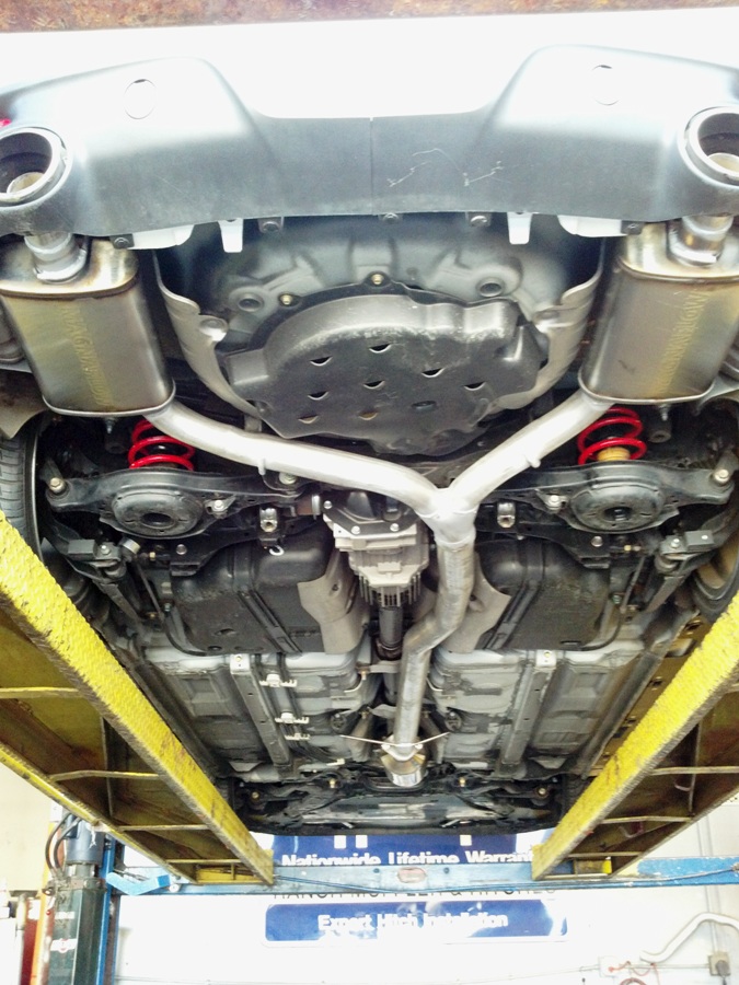

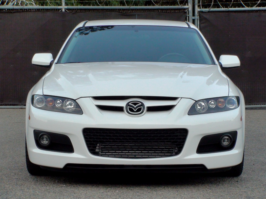

I had FMIC fail install yesterday. I will preface this by saying that I am a decent mechanic. I am usually careful and I have done some involved projects over the 19 years I have been wrenching on cars. I knew that I wasn't really up to doing something as involved as installing a FMIC last night. I was kind of tired and just wanted to take it easy. Instead, I forced myself to start the install (which I usually would otherwise enjoy). Everything was going smooth until I started cutting the radiator shroud on the driver side to clear the FMIC cold side tube. I was drilling a few holes so I could get my saw in there, and I was lazily drilling and not staying focused enough.
So, I drilled right through the shroud and into the radiator's lower plastic tank where I was greeted with green coolant gushing onto the ground. Radiator repairs are 50/50 at best and I am not playing that game, so I need to install a new radiator tonight... So, instead of new rim shots, you get this instead. FYI, getting our radiator out is a PITA!
I collected myself now, I will go at it tonight with the same attention to detail that I always otherwise do.
 Old 07-18-2012, 06:11 PM   #59
Block8head's Avatar
Location: Brockton,Mass
Posts: 4,345   (View Stats)
iTrader: (118)
Block8head is the leader of the worldBlock8head is the leader of the worldBlock8head is the leader of the worldBlock8head is the leader of the worldBlock8head is the leader of the worldBlock8head is the leader of the worldBlock8head is the leader of the worldBlock8head is the leader of the worldBlock8head is the leader of the worldBlock8head is the leader of the worldBlock8head is the leader of the world
Thanks: 3,661
Groans: 206
Looking good broski.
O4 350z "Money pit"
06 MS6 "Gone"
BOSTON STRONG
Block8head is offline   Reply With Quote
The Following User Says Thank You to Block8head For This Useful Post:
dale_gribble (07-19-2012)
 Old 07-19-2012, 04:02 PM   #60
dale_gribble's Avatar
Posts: 4,720   (View Stats)
Rep Power: 5431
Thanks: 2,552
I got the car back together. I will say that this CX Racing FMIC is not just a bolt on. It takes quite a bit of work to get fitted. Just don't do what I did and hit the radiator when you are cutting the shroud on the driver side. Also, the hood's ducting for the stock TMIC cannot stay on; it won't clear the hot side tubing down to the front of the car. The tubing barely clears the headlight; I actually had to massage everything for a good while (when I say massage I mean dremel) to get the RH headlight to fit well again. You have to pretty much decimate the lower bumper air diverter panel.
I broke the damn front bumper guide on the RH side- the little white plastic piece.
I didn't see any loss of boost, I am still around 21psi at wot, so I am not even sure I lost any boost at all. My BATs looked cooler and it seemed like the car cooled down a lot faster after idling at a stop light. I am going to run some logs and see where that takes me.
No way I was going to cut the crash bar like some people do to move the FMIC square in the lower grille opening. When I saw how flimsy that crash bar is to protect the people in a frontal impact, I didn't want to go near it.

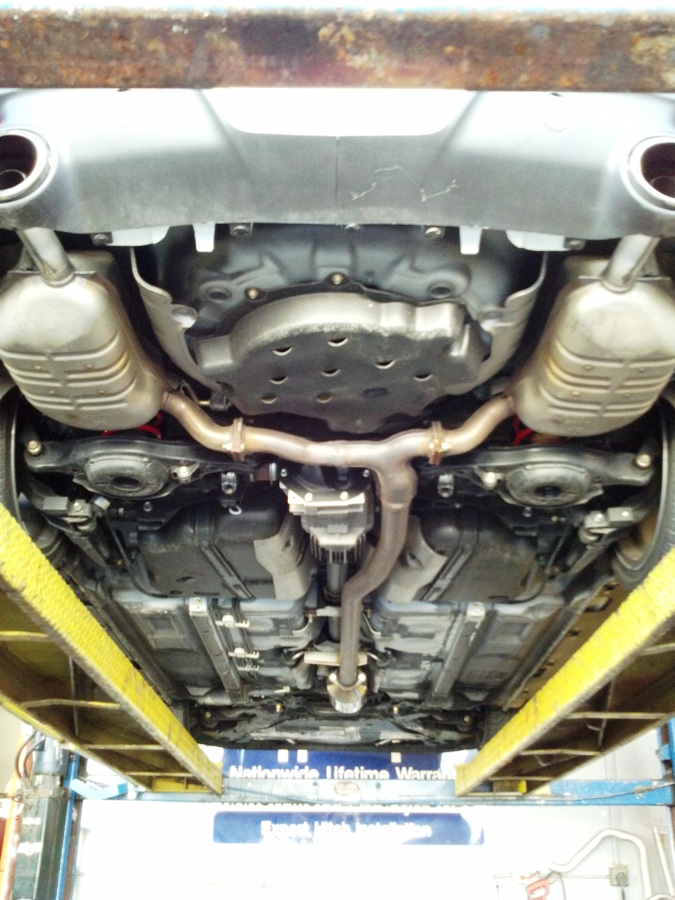

Ran some logs against the virtual dyno. Looks like we are getting progress with the tune at Stratified!
I also ordered the resonated test pipe from corksport. I really want to hit the 300hp mark if I can.
