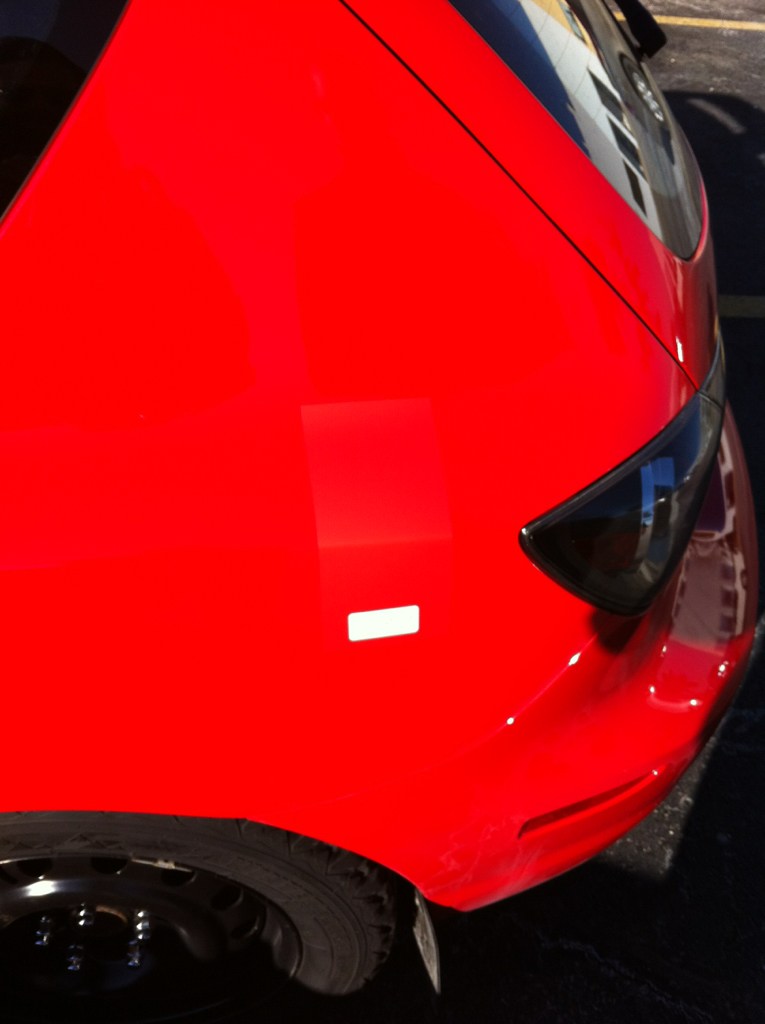

I don't have my car wrapped yet, but this is what I'm going with:
In my garage:
In full sunlight:

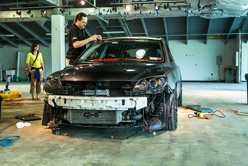

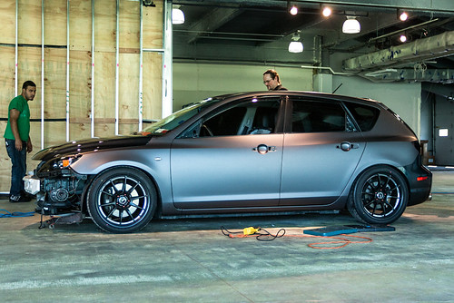

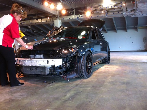

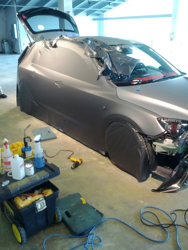

This is my car getting wrapped the second time. Take notice on how the first wrap protected the paint.
First Wrap coming off
New Wrap going on, Old wrap still on the hood
If you want to hunt for more pics. This install was done at the 2012 OCC Mazda meet. Here is the photo page.
