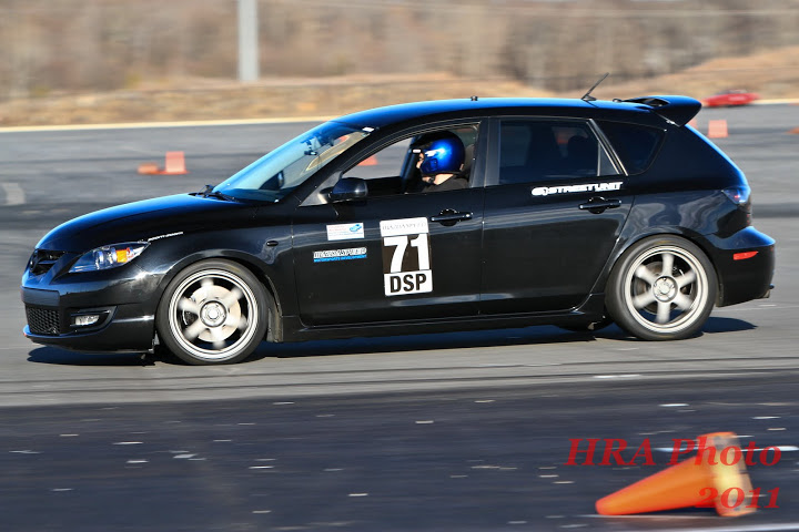

pstx_71_K44A3234 by Sir Turd Ferguson, on Flickr
Updated Photo as of March 2013

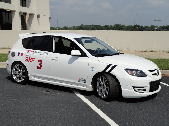

What are the mods that would push u into SMF?? that's what class people are telling ke I'm gonna be in but it seems like you have very similar mods and are running in DSP. See my sig I'm confused how I'm gonna have to run SMF and your still in DSP

Like Saitech said the meth kit and oil conversion kits will probably bump you into SM-F. I'm not too sure on the SMF rules but even something as simple as changing out the dash out (for the dashpods) could change your class per SCCA rules.
My car was already in DSP when I bought it (due to intake and RSB) so I just ran with it for DSP. If you aren't trying to compete on a national level then I wouldn't worry too much about switching out of SM-F. If you do eventually want to run and win National SCCA events then you will probably want to look at changing your car to DSP or DS specs as I have not seen any Mazdaspeed 3's running in SM-F (and the winning cars in SM-F are usually faster than DSP and DS winning cars from what I've seen).

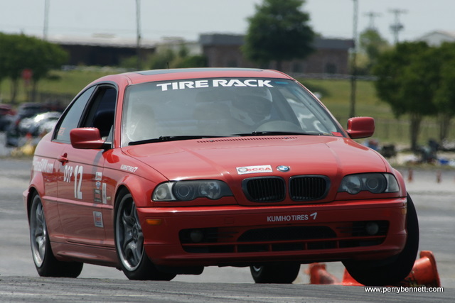

For this event I had my friend Mike (a test driver who gets paid to AutoX for a living) as a co-driver along with his wife Amy running the car in DSPL. I made the trip down on Friday to get the car inspected and registered with the event running on Saturday / Sunday. There ended up being a total of six drivers in DSP for the weekend...
There were 2 drivers from Western PA in a 1993 BMW 325is (one driver finished 11/25 at the 2010 Nationals)

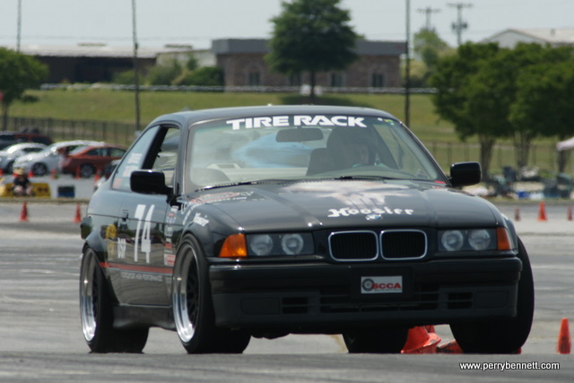

Another BMW (2000 BMW 328ci) with one driver from the Alabama Region
and joining the FWD club was one driver with a 1996 Nissan 200SX Se-R (finished 10th/32 at 2007 Nationals)
With a couple fast cars that have finished in the middle of the pack at Nationals, I was guessing the car would be around 1-2 seconds behind each day, but surprisingly Mike (a really good driver) was able to compete right up there with them while myself (and average driver) was around 0.5-0.7 seconds behind per day. The car handled awesome and probably was the fastest it has been since I started AutoX'ing with it. Set-up wise the car was left alone and no pressures / shocks / etc were changed on either day.
On Day 1 I ended up shaving time on each run to end up with a 40.6 fastest time, while Mike had a 39.7 that would have been good enough for 1st place but ended up clipping a cone. On his last run he made a conservative 40.3 while the BMW 325is drivers ended up with 39.8 and 40.0 respectively. Below are videos from my fastest run along with Mike's 39.7+1...
For Day 2 I had nothing to lose and went too aggressive on my first two runs of 39.9 and 39.5 while flattening a total of 4 cones (making up for my total of 0 from Day 1). My final run was clean and ended up as a 39.7 (video below...)
As for Mike his first run was clean (39.3) to temporarily move him up to 2nd place, while his second run was faster (39.0) but dirty. By the time of his last run we realized that a 38.9 or better was needed to finish in 2nd place and get one of those free Hoosier A6 tires. At the beginning he had issues getting the car from 1st-2nd gear and ended up losing some time, but still ended up with a 39.1 clean. After looking at the data we realized that he ended up losing around 0.4 seconds from that bad shift, but at least it's encouraging to know that we're on pace with some of the better DSP cars around. See photos and results below...

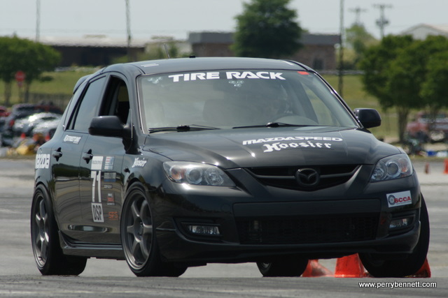

Here are a few pics of all the Mazdaspeed 3's at the event...
My car in the paddock

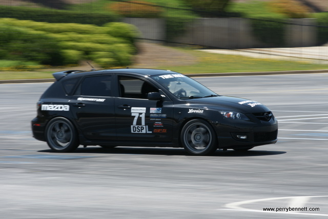

Another DSP 2009 Speed3 GT
SMF 2008 Speed3
