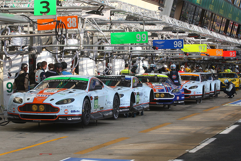

So the MS3 does still exist, but since May it has spent most of the time chilling in the garage on the Battery Tender...meanwhile the majority of my time has been occupied working with the Le Mans / ALMS teams.
Most of June was spent in France helping to support Aston Martin Racing at the 24 Hours of Le Mans. The factory team was running 5 cars in the race this year to celebrate their 100th anniversary and I was assigned to work mainly with the #97 & #99 GTE Pro cars that were driven by Darren Turner/Peter Dumbreck/Stefan Mucke & Fred Mackoweicki/Rob Bell/Bruno Senna.
dl_lm_thursday_19 by whbostic1, on Flickr
J5-JulieSueur_LM2013_qualif1_07 by whbostic1, on Flickr
DSC00629 by whbostic1, on Flickr
This was my first Le Mans race, and it had many ups & downs which included qualifying 1/2 for the GTE Pro class, followed by the fatal crash of Allen Simonsen in our GTE-Am team car on the 2nd lap of the race. The #97 & #99 car lead the majority of the race before the #99 crashed out with 5 hours to go, then with 1.5 hours left the #97 car was a half-second behind the leading Porsche and gaining 2 seconds a lap in the rain before the car had to pit to fix and issue with the failing floorboard mounts. The car finished in 3rd place, behind both of the factory Porsches, and it was easily the most depressing podium finish I have been a part of...in total I was awake for 38 hours straight from Saturday morning warm-up to Sunday evening.

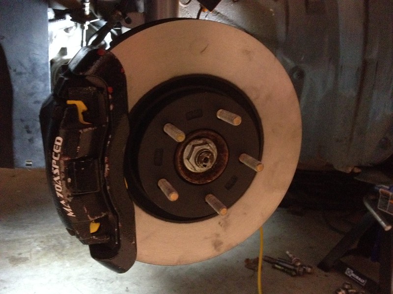

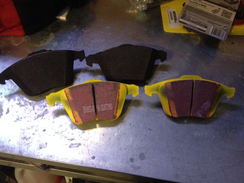

So I've still been chipping away with the MS3 and ran a couple events at the end of 2013 before heading into the off-season. During the winter months the only real upgrades were a new set of stock rotors with some EBC YellowStuff brake pads...
photo 1 by Sir Turd Ferguson, on Flickr
photo 2 by Sir Turd Ferguson, on Flickr
Other than the new brakes the car was unchanged from 2013 with the following suspension set-up heading into the first few events of the 2014 season...
K-Mac Camber Plates
AWR Strut Housing
Koni 8611-1256 Strut Inserts
Koni 8040 Revalved Rear Shocks
Hotchkis Rear Sway Bar (full stiff)
FSB Disconected
800 lb. Hyperco Springs (Front & Rear)
SPC Rear Camber Arms

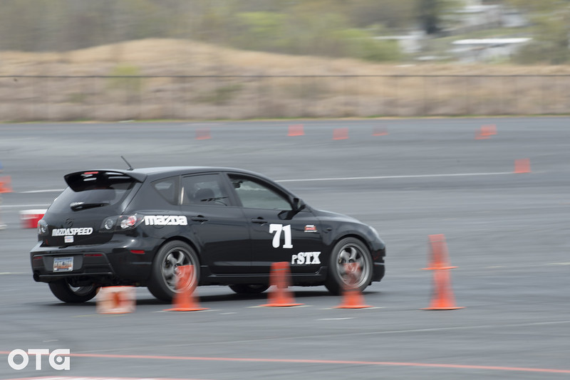

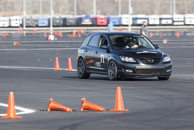

Central Carolinas Region AutoX #1 - ZMax Dragway - March 1st
Over the past few seasons the CCR region has really grown thanks to the benefit of having a nice site like the parking lot beside ZMax Dragway, and as a result we have multiple national champions and drivers who have trophied running on a regular event with the club. The Pro class is always strong at these events and a good chance to see how the car stacks up vs. National-level competition...
pstx_71_K44A3234 by Sir Turd Ferguson, on Flickr
pstx_71_K44A3229 by Sir Turd Ferguson, on Flickr
pstx_71_K44A3006 by Sir Turd Ferguson, on Flickr
The changes to the brakes did help with some improvement in initial bite and braking power...but I wouldn't call it a night-and-day difference since the stock brake pads are pretty good IMO for this car. Overall the car balance felt like I had remembered with a neutral entry and mid-corner that leads to exit U/S while trying to get on the power. This course also featured some tighter sections that worked against the MS3. For tires I'm still running on the first set of BFG Rivals I had purchased with the grip level holding pretty consistent as they wear...after running on R-comps for so many seasons since the beginning I have enjoyed the change to street tires as I can now focus on improving my driving line through the course vs. having to manage the grip level (especially when running the 285 front R1-S tires) at the same time.
CCR AutoX #1 Results
PAX: 30 / 192
PRO: 25 / 40
STX: 3 / 13
Next event would be the CCR region's 2nd AutoX of the year at the same site in April.

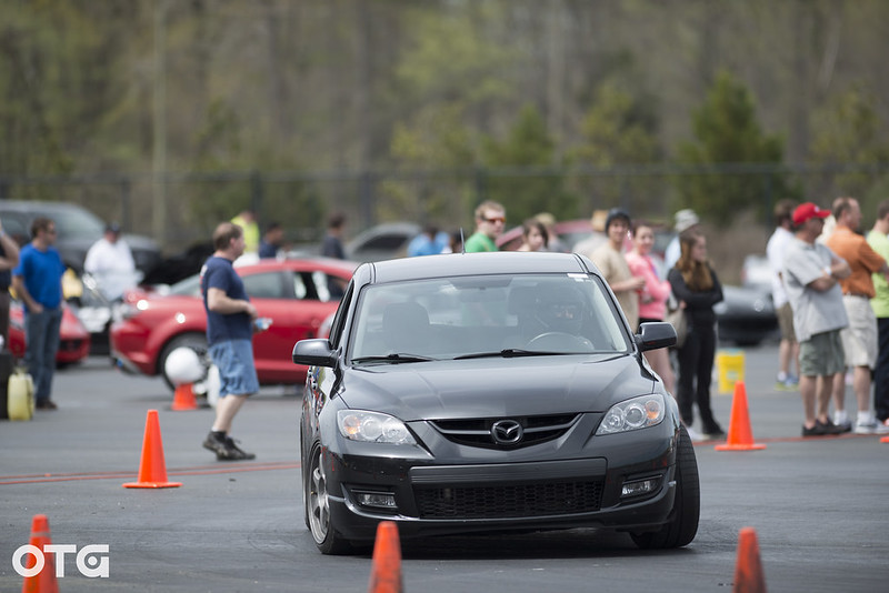

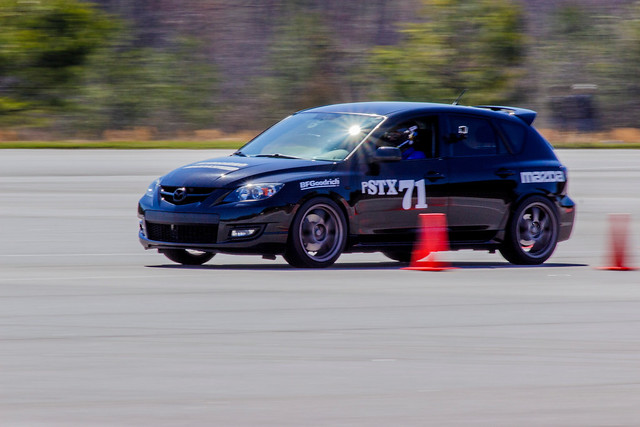

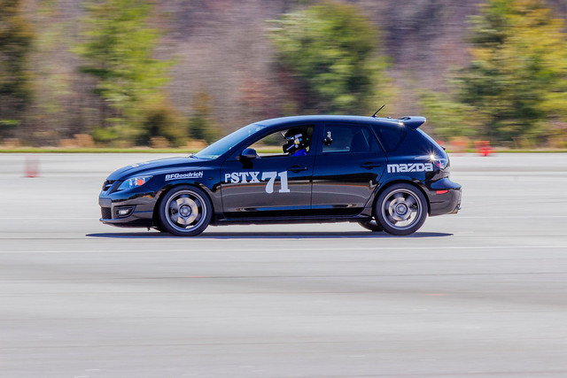

Central Carolinas Region AutoX #2 - ZMax Dragway - April 5th
No changes were made to the car between the first two events of the 2014 season as the biggest goal was to get more seat time to get a good baseline before making any tweaks to the set-up...
CCRAutoX2_3 by Sir Turd Ferguson, on Flickr
CCRAutoX2_2 by Sir Turd Ferguson, on Flickr
CCRAutoX2_1 by Sir Turd Ferguson, on Flickr
So the car felt pretty much the same although the course was a little more favorable to the MS3 platform at this event, and overall I was pretty happy with my driving and think I have a good feel for where the car stands as of right now. For tire pressures I have been sticking with 37-38 psi front (bled back down between runs) and 50-55 psi rear to help generate some rotation...at this event I sprayed the front tires down between runs and this did seem to help a little (or maybe it was just in my head) as you can feel the car gain more U/S from run-to-run when the front tires overheat a little and lose traction. The rear tires also gain a little traction with more runs from the little beat of heat they do generate...so both ends of the car are working to increase the U/S when the run count increases.
CCR AutoX #2 Results
PAX: 25 / 201
PRO: 23 / 36
STX: 2 / 14
As a reference the top STX car at these events is an RX-8 that competed at the Wilmington Match Tour last weekend and placed 2nd out of 18 cars...if I were to keep the same delta from the first two CCR events of the year (1-1.5 seconds on a ~75 second course) and look at Wilmington (~65 second course) this would have placed me around 6-7th out of 18. Not an exact science but a rough estimate for where I think the car would place.
Now that I have a good baseline on the car again the plan is to make a few upgrades over the next months starting with changing out the LCA bushings (still stock). I have had the TopSpeed bushings laying around the garage for a while and ordered a new set of LCA's through the Mazdaspeed motorsports program & plan on burning out the stock bushings and installing the TopSpeed's this weekend. It would be ideal to use the Whiteline bushings that increase the amount of positive caster in the front to help the front grip level (have read good reviews about the results)...but this is illegal for the STX class. I also have some time scheduled at the beginning of May to take the car to a shop in Charlotte & finally have the valves cleaned with a good tune on the engine for STX prep. I'm hoping to have all of this work completed in time for the Atlanta Match Tour event in the middle of May. New springs have also been ordered so I now have the following sets to play with for car balance...

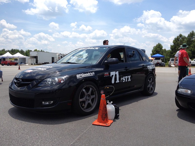

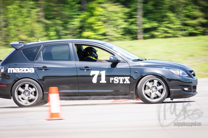

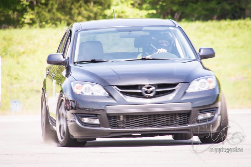

My next event was at the Michelin Proving Grounds with the South Carolina region. Car set-up remained mostly unchanged from the last Z-Max event except for reducing my rear camber from -1 to -0.5 deg on both sides...
South Carolina Region Event #3 - Michelin Proving Grounds
10252087_654129761307051_4039823806970124805_n by Sir Turd Ferguson, on Flickr
10277767_654129797973714_4059315848436761474_n by Sir Turd Ferguson, on Flickr
Overall I liked the car balance better on this surface (smooth high grip asphalt) vs. Z-Max (smooth sealed asphalt) as you could get enough front grip to generate some rotation (plus removing some rear camber probably helped) that could easily be controlled at the limit. The course was pretty fast and free-flowing that really fit the MS3 well and I would like to keep this set-up for future events at this site.
SCR AutoX #3 Results
PAX: 13 / 126
PRO: 10 / 33
STX: 2 / 8

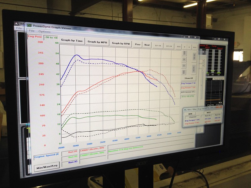

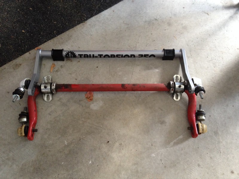

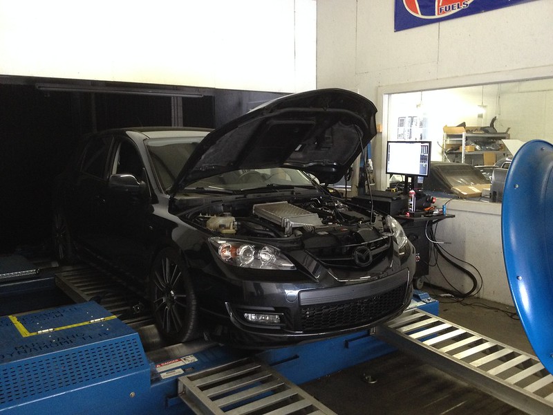

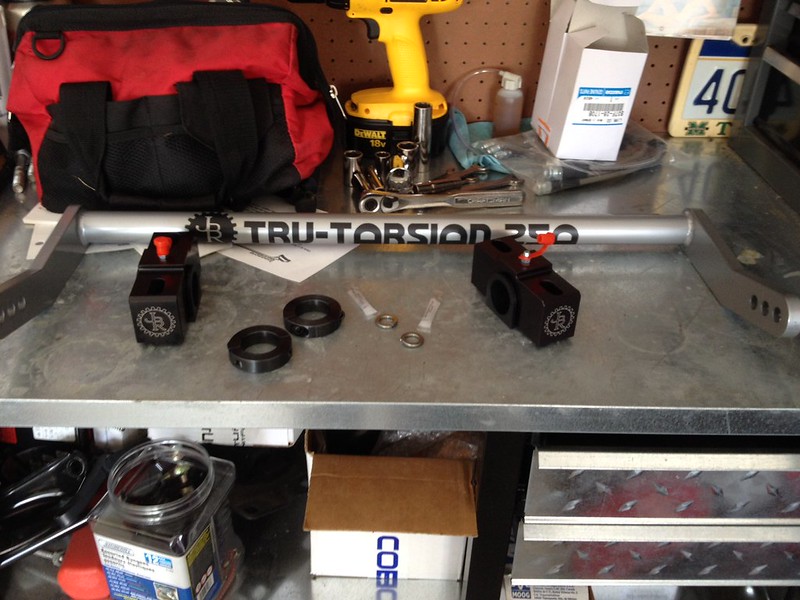

Before running at the upcoming SCCA Match Tour in Atlanta I dropped the car off at 42 Autosports in Concord, NC to have some much needed valve cleaning completed (car is currently at 56k miles and this will be the first cleaning) along with some engine tuning on their Mustang dyno. I was really happy with the work they did and got to hang out in the morning while the tuning was completed to check out the process. This shop works mainly with Subraru's but has tuned some MS3's before using the COBB AP. My final STX-legal map (solid line on first chart) is below along with an updated Stage2 map (second chart) for driving around on the street. The biggest limitation with the STX map is the stock boost limits which resulted in a pretty big drop around 5000rpm...
photo(2) by Sir Turd Ferguson, on Flickr
photo 3 by Sir Turd Ferguson, on Flickr
photo 2(1) by Sir Turd Ferguson, on Flickr
Other than the engine tuning & maintenance I had ordered a new set of control arms and swapped out the stock bushings for the TopSpeed bushings that had been in the garage for a while. The Atlanta Match Tour would be my first chance to check them out.

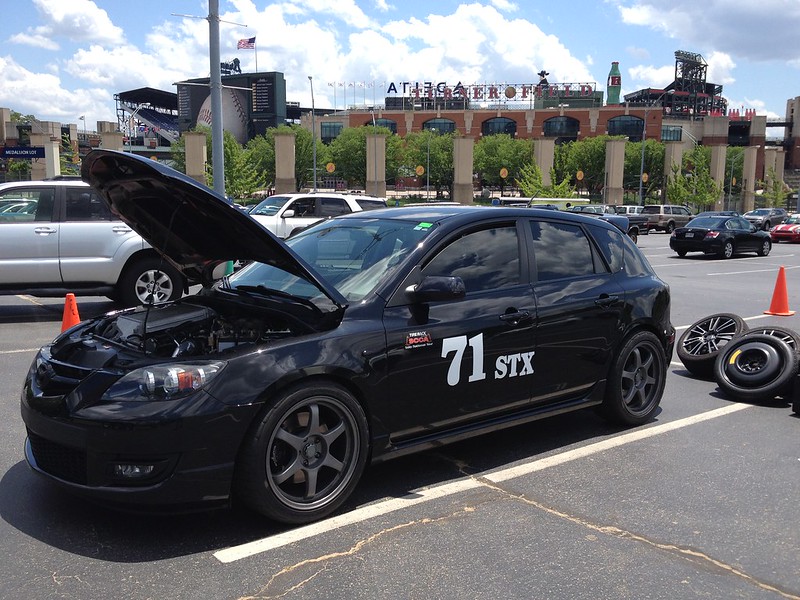

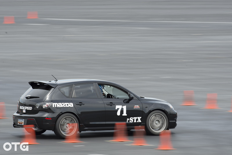

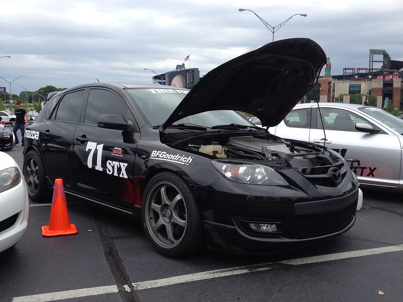

SCCA National Match Tour - Turner Field, Atlanta
This would be my first event at Turner Field where the Atlanta Region runs the majority of their schedule...I have ran with them in the past but always at Atlanta Motor Speedway. I drove down early Friday morning to get some runs on their test & tune course which is a sealed asphalt lot similar to Z-Max in Charlotte.
photo 4 by Sir Turd Ferguson, on Flickr
The car set-up had not been changed since the LPG event with things standing as follows...
Front Camber = ~-2.9
Rear Camber = ~-0.5
Front Toe = 1/8" Out
Rear Toe = 1/16" Out
Spring Rate = 800F / 800R
FSB = Disconnected
RSB = Hotchkis Full Stiff
Tires = BFG Rivals w/ ~10 Events & 50 or so runs
Pressures = 37F / 55R
During the test runs the car was pretty limited by a lack of front grip & flat-sliding through mid-corner to exit. The course surface was sealed and very smooth so it felt like there wasn't any roughness to generate enough front grip plus the lot was pretty bumpy and with the higher spring rates the car was a hand full to drive. There was an RX-8 in STX that has trophied at Nationals before and they were about 0.5 seconds faster on the 35 second course, so overnight I decided to change the 800lb rear springs out for the 900lb in an attempt to get some more rotation through the corners.

Last week the new James Barone Competition RSB arrived and was installed on Saturday before taking part in the Central Carolinas/South Carolina AutoX at the Michelin Proving Grounds on Sunday. The bar has a nice quality of build and I was wanting to try the different design vs. the Hotchkis in an attempt to get a stiffer bar and more rotation. I also ordered some new stock end-links to add onto the install. Compared to the Hotchkis the bar does feel heavier and came with some pretty beefy mounting brackets...
With the new RSB installed I was ready for the next event on Sunday. The rest of the car remained unchanged with the spring rates staying at 800F / 900R and starting cold pressures of 38F / 48R.
SCCA Central Carolinas AutoX #4 - Michelin Proving Grounds
Compared to the Hotchkis the new RSB did feel stiffer and resulted in better rotation and quicker steering reaction (the car felt more "pointy" when driving around on the street). My results were some of the best I've had against this level of competition and I was the fastest STX car (beating the RX-8 that won the Atlanta Match Tour by a tenth). The high speed balance of the car was really good with only some low speed U/S holding the car up on the tighter corners...I think a lot of this could be fixed with an improved LSD so I could get on the throttle earlier in these tight corners with the car continuing to corner instead of pushing out on exit. This will be the big project for this fall/winter.
There were some timing issues at the event and I was the beneficiary of a couple re-runs. This allowed me to land my last run that was ~two-tenths faster than my best time if limited to the standard four runs without the re-runs due to timing errors. I also had a first in my years of autocrossing...the four-point harness got caught up in my seat recline handle on my 2nd run, so as soon as I hit the gas to leave the starting line the seat reclined all the way back and I was just left holding myself up with the steering wheel. That was fun.
The weather was pretty hot on Sunday (low 90's) so I sprayed the front tires & intercooler between each run and continued to bleed the front pressures down to 37-38 psi while allowing the rear pressures to climb. These are the same Rivals I have been using since starting STX more than a year ago and they have held up pretty well after ~15 events.
I also just bought a GoPro camera so I can start recording some runs. This was my first attempt at using it and my best run from the day is below...I'm pretty impressed with the quality of video and how easy/user friendly the camera is for set-up + the wireless capabilities. Wish I had gotten this camera sooner.

Latest and greatest update...the decision has been made to move on to the next AutoX build and I recently purchased a 2004 Mazda RX8 to run in STX.
I was able to run the occasional event last fall and this spring in the MS3 before heading to the Dixie National Tour in March where the car placed 14th/20 in STX (144/290 out of everyone in PAX at the event). Bottom line is the car just wasn't competitive enough to hang with the FRS/BRZ, and even if I had the newer Bridgestone/Rival S tires (vs the older standard Rivals I was running) the car wasn't going to be close, so after this event I started looking around for the next build. While everyone has been jumping on the FRS/BRZ, used RX8's can be found relatively cheap and I was able to get one already prepped for STX out of Savannah GA. Even if I blew the engine today, the total cost of the RX8 would still be half the price of a stock used BRZ/FRS, so I figured it was worth a shot...plus I have never been a fan of the look for driving feel of the twins. With this project I'll at least get to stay with the Mazda brand and be more competitive nationally in STX.
MS3 Pics from this Spring
58837213-heat2scca233 by Sir Turd Ferguson, on Flickr
58837214-heat2scca137 by Sir Turd Ferguson, on Flickr

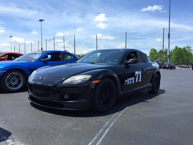

Video from First AutoX with the RX8...still have some tuning to do along with getting used to the different car.
11206007_10101995978794418_6421356669570490063_n by Sir Turd Ferguson, on Flickr
