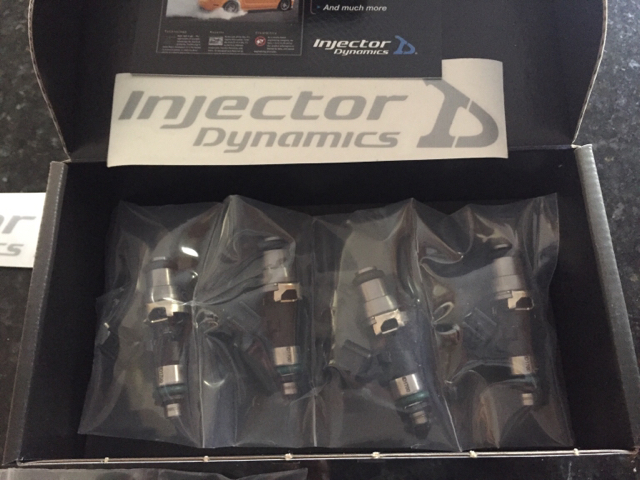

Got my new injectors in yesterday and the rest of my fuel system components ordered so we should be rolling again by the end of the week if time permits

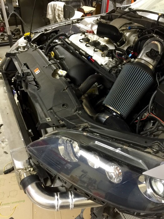

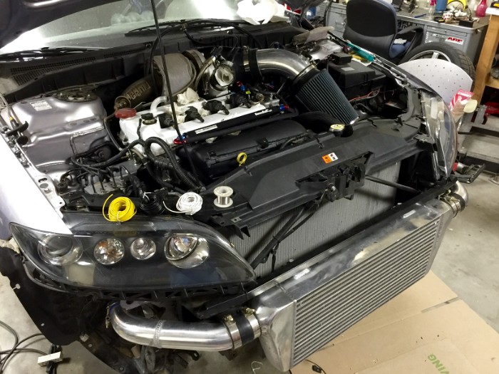

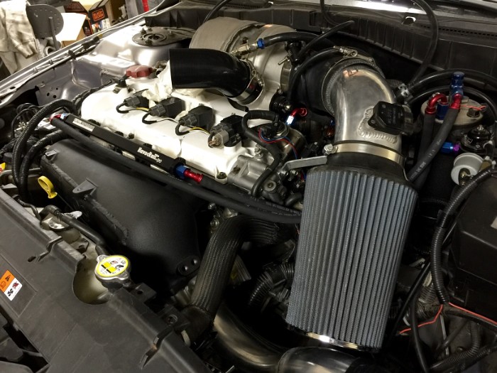

Slow as molasses... but still making progress. I'm wrapping up a few loose ends on the pcv side of things, and still need to order a 4 channel aux fuel controller... but then it should be ready to fire up.
It's been pretty hard to find time for the project lately, haha. And every time i complete one thing, i see three other things i've been putting off. So this time i've just decided to address all the little stuff i've been ignoring for so long. It's coming out pretty nice though, so hopefully it's worth the wait.
I should probably make my own thread.....

@djosnteisn; any further updates
Not much. Literally just waiting for two fittings before i can fire it up. Then i need to wire up the AEM F/IC and figure out how to set it up. Looks quite powerful compared to the split second controller.
I'll make a new thread when i actually have something worth posting.

I'm spoiled on the 6 cause it has an external injector driver module. There's four 5V control signals from the ECU to the injector driver... so at most all i'll have to do is make a simple circuit to invert them and possibly scale them up to 12V. On the speed 3, you'd want to make a different circuit i'd imagine, cause the ~70V signals applied to the injectors are probably pretty ugly with fly back voltages and such. It could certainly be done though.
Like most F/IC installs, i won't be using all the available features... and i agree, the user manual is pretty vague on some stuff. My initial approach will be to use the MAF voltage as the load variable for the fueling maps, and set them up for a nearly fixed percentage of the OEM IPW. That way I can just use a fixed scalar on the maf in ATR to dial back the stock IPW. It will most likely require some fine tuning, but that's to be expected. I really like the idea of using the oem IPW to derive the aux IPW though, cause it essentially gives my aux injectors access to all the same resources that the ecu uses to calculate fueling.
Beyond that, i'll use the generic 12V output to drive a solenoid to turn my surge tank fuel pump on/off at a given boost point. And i want to at least investigate the ignition driver signals out the f/ic. If i remember right, the mazda runs ~6ms dwell time on the ignition coils... but i have no clue if that fully saturates them. If i run into ignition issues at higher power (I don't think i will based off the people making 700+whp on stock ignition.. but "if")... it might be possible to get more dwell out of the AEM. I have no clue though, and that's very low on my priority list.
And I do believe you can set the system up for batch, but i intend on using the sequential fire, just because i can, haha.
