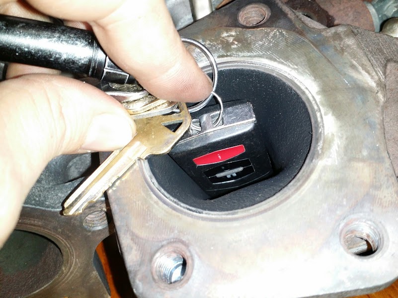

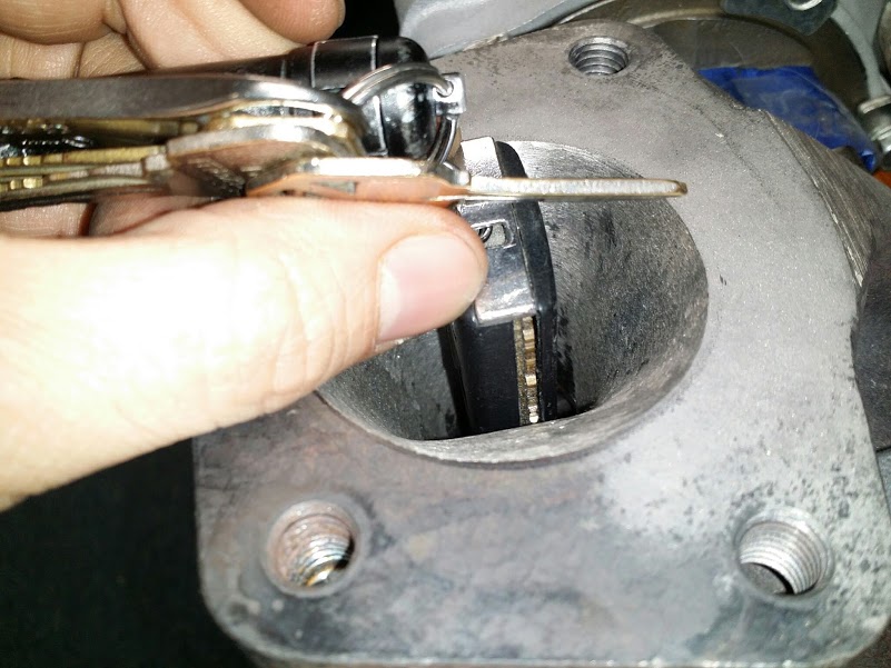

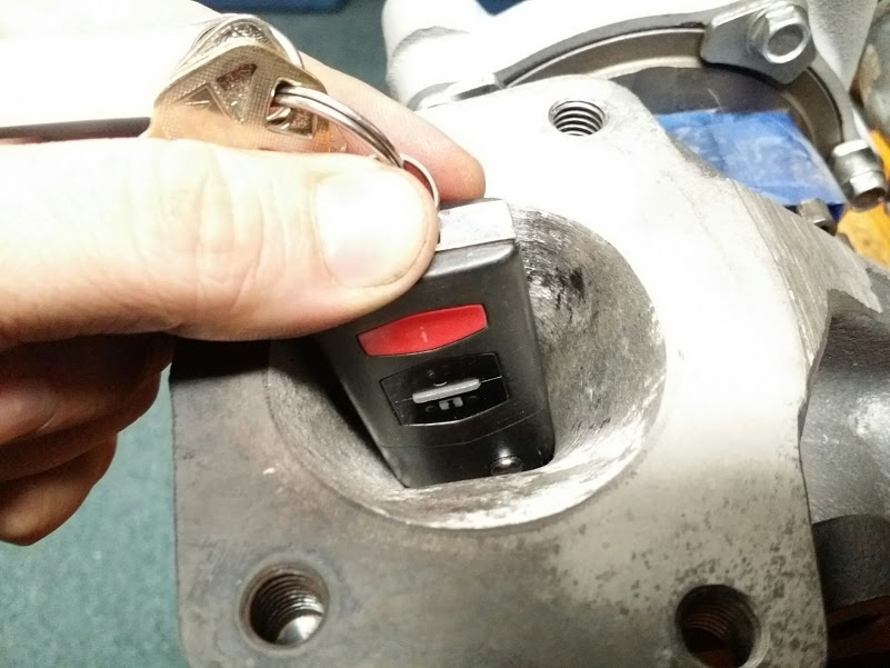

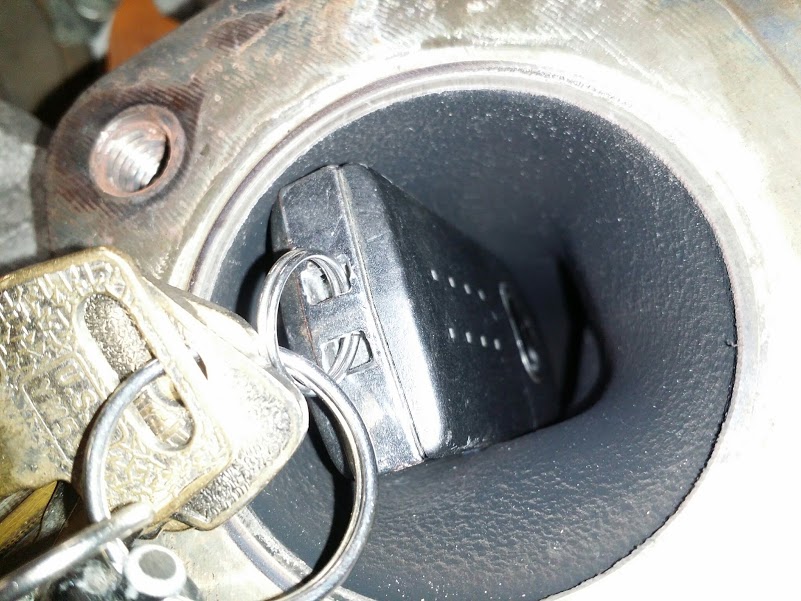

As a quick aside - Reconfirming all of the above 582 vs. 882 size difference statements: Turbolabs sent me the 582 exhaust housing which they "ported" to approximate what they thought an 882 housing would be like. They thought the difference between them was just a smaller inducer opening. This is wrong, as Clint stated above.
Very unscientifically, I put a Mazda keyfob into their ported 582 ex. housing and my stock 882 ex. housing. The difference was visually staggering - 882 had about a quarter inch larger inducer opening, and a good 2-3mm larger A/R. This is compared to the PORTED 582 ex. housing. I had to re-use my old housing, which means the core charges should have been less.
When I was ordering the hybrid turbo from them, they assured me that a 582 was negligibly different from an 882 and they fixed those differences. Buyer beware and double check all your specs. They are no longer on FB, but I have all messages saved on my end (annoying that their responses cannot be seen even after they leave fb). They can be found here, though: http://turbolabofamerica.com/
582: sideways radius - the keyfob fit maybe 2/3 of its length down
882: sideways radius - keyfob sinks all the way down and is covered by the inlet opening by about 4mm:
582: lengthwise radius - keyfob stick out by 4-5mm:
882:lengthwise radius - keyfob sinks fully covered by about 2mm of the inlet opening:
