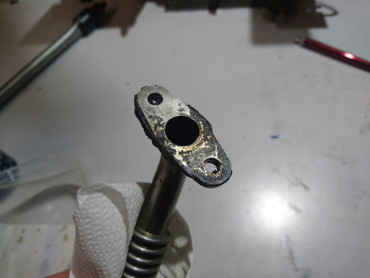

Removed my return line and found a hairline crack in the flange weld on the turbo end.
May or may not be the cause so I'm just going to replace it.

Cracks in the flange weld seems to be a common issue too.
I'm glad my return line is try now, I wish you all the best and hope replacing helps you too.

Well. My return line is leaking again. I fucking give up. I guess I'm going to throw money at a kozmic line as I have tried everything else I can to make the stock line work.
Damn ... mine too. Shorter studs did not work for me so I bought some special turbo / exhaust gasket sealant and it was dry for the next 6 or 8 weeks.
I checked it again last weekend and wouldn't believe what I've seen.
Its leaking not that much than before, but still a bit. I think my oil return line might be broken. I'm replacing this shit in fall ... does the Kozmic Oil Return Line fit? They still quote on their homepage:
We will be making an option for the stock turbo soon.

Hi guys,
I'm still leaking a decent amout of oil underneath the turbo and I still don't know where it's coming from. It smells like s*it everytime the car is warm and I'm standing still :-/.
I'm replacing the gasket sealant again with the oem gasket and checking the oil feed line washers.
If it isn't the oil feed or the oil return line, what else can it be? The turbo itself? Does an oil restrictor bolt help?

I ended up putting another return line on and it didn't help. Looked really close and saw traces of oil between both coolant banjos and the center housing ( where the washer is ).
Since those are both higher than the oil return I assumed the oil wasn't defying gravity and leaking upwards so I checked the oil feed line and apparently missed putting the copper washer between feed banjo and the center housing. Did the one between the bolt and the banjo but forgot the other one somehow.
Replaced it about 200 miles ago and plan to get under the car tomorrow. If it isn't because of that fuck up on my part and it's still leaking it would have to be the seals in the turbo right?
I don't know where else it could come from and just appear on the turbo and nowhere else.
No. If those were leaking, you would have oil coming out of the actual inlet or exhaust housings and into the engine/exhaust. Your leak is either the feed or return from the CHRA.

Turns out, my special "turbo gasket sealant" is not meant to be used directly at the turbo
I now used the gasket that came with the BNR S1 itself...although it leaked with the oem gasket too about a year ago

Have you tried just using a little bit of permatex black? Messy to clean up and reapply, but might be the only solution for you at this point.
Also be aware silicon will be high in your oil reports for a couple OCI's as it washes out.

Was going to be one of my solutions. Also the shorter bolt suggestion. I have never seen crush washers used for that area also... Also if all else fails maybe you have too much pressure in the oil return line that is pushing the oil out. So maybe you might want to go to a larger line that will cut down on the pressure. Also if this pressure is great enough it might back up and do damage to your turbo seals in the long run. Also insted of cutting your bolt you could have gotten a washer to put in between the bolt head and the oil return plate.. Same affect just no cutting.. Also you might want to also try using some thread locker because your bolts might be backing out.. doubt that being your problem but it wont hurt..
I've talked about the crush washers on the oil feed line ;-). Changed mine today.
With the new gasket on the return line that came with the BNR S1, its still leaking.
I'm going to install a new oil return line and a new oem gasket underneath. After that I'm trying the permatex black. Althouth I'm still not 100% sure that it's the return line itself that is leaking...

permatex orange, Meant for the higher heat areas. i Know black is the oil but the temps here get damn hot. red is good to 650 f

I'm still not 100% sure if its the oil return line or the turbo itself that leaks somewhere :-/.
I'll try another oil return line today and see if that helps. If not, I'll try the permatex red.

The oil return line from my MS6 did not help, it's still leaking. Also, when in idle for a few minutes, the car starts to smoke white which makes me think my turbo seals are blown.
I'm now throwing out the S1 and trying to find a turbo specialist in Germany who is able to repair it

The BNR is out. I brought it to a local turbo specialist. After a few minutes of disassembling, he told me that the turbo (and the seals) are looking fine.
Now I'm here and I don't know what to do. I have absolutely no idea where the oil is coming from ...
