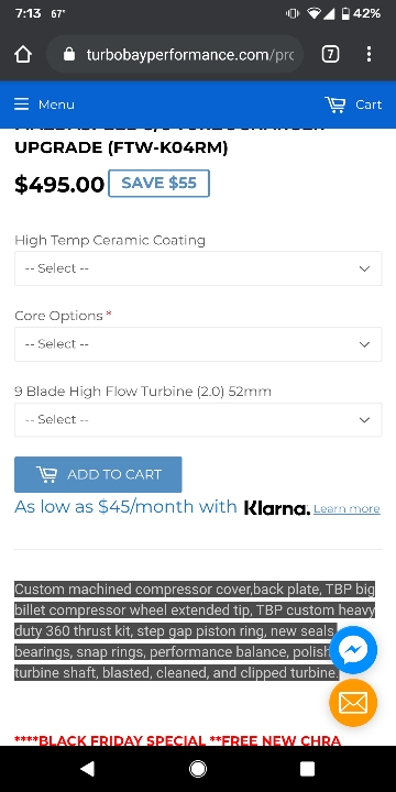

Not sure exactly what my goal is and I've looked at a few "tried and true" options so far just looking around and weighing my options cause I'm upgrading in the next few months. This is the only thing it says on their page

I saw that. It says nothing about the internal parts used, whose CHRA is in there, whether they modified the journals to prevent OEM K04 bearing seal failure or whether it is comparable with OEM tune or requires aftermarket tuning to keep your engine from blowing up.

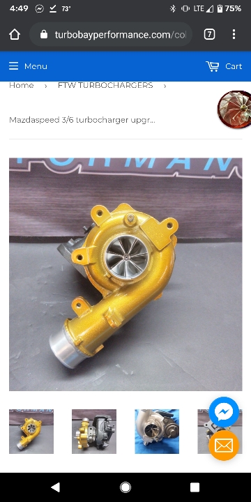

Looks like an upgraded/ported K04 similar to the one Kinugawa has. I wouldn't surprised if they sourced the compressor wheel from them.
I see they clipped turbine for better flow. It doesn't look bad... It's kinda nice if you want the sleeper look but longevity is uncertain.
