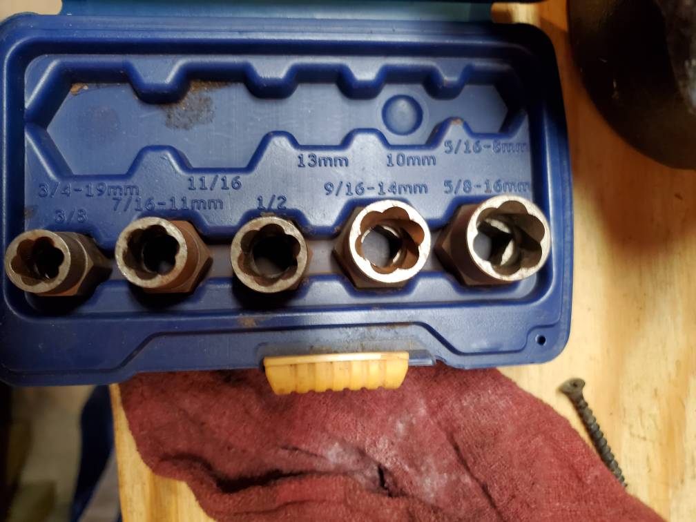

Reverse flute ez out sockets

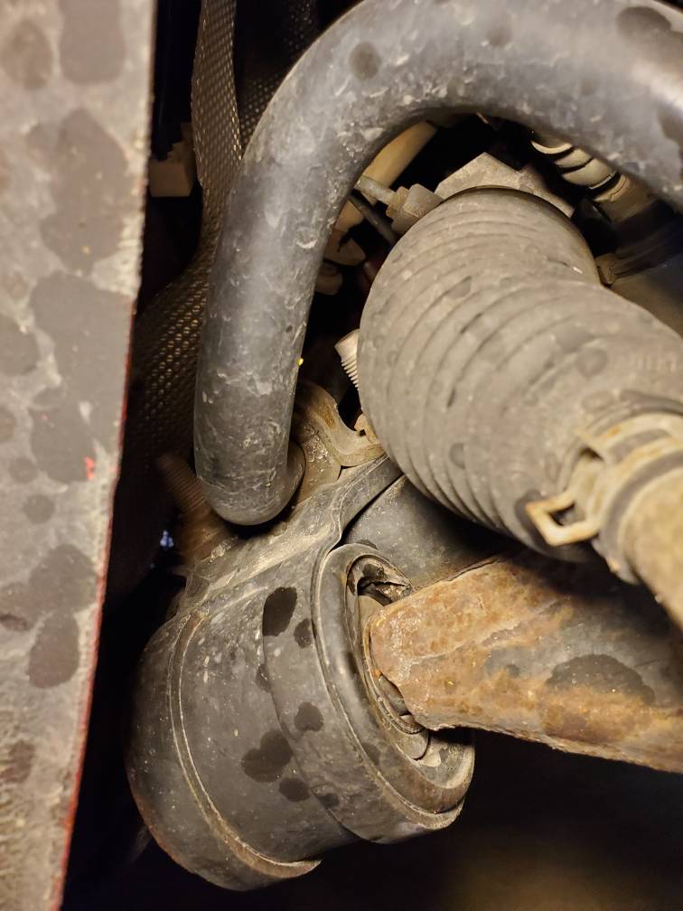

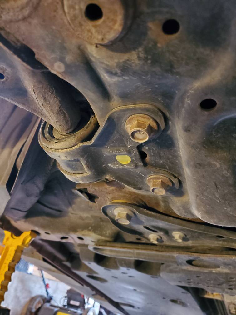

After the endlinks are removed, you are ready to get the old bushings out. Get under the vehicle and locate the 2 rear bolts on the lower control arm. Remove them using a 17mm socket.
Once the two bolts are removed, you can pop the bracket off and then slide the old bushing out. I cleaned up the brackets well and then put some lithium grease on them where they touch the brackets. Not sure if this is necessary but I figured it might keep them from squeaking.

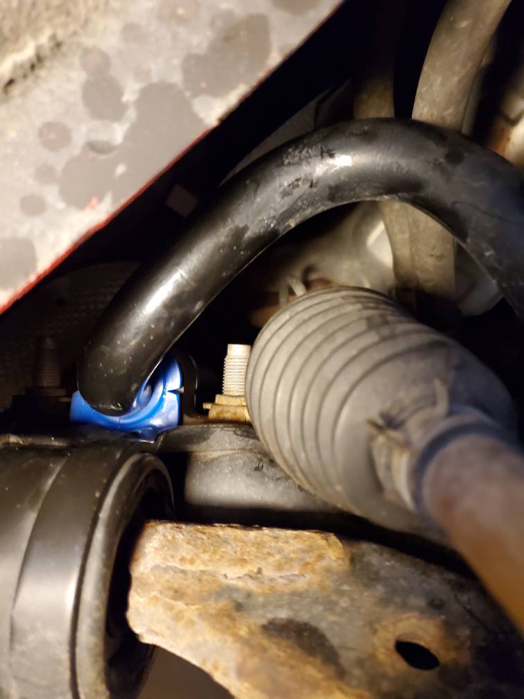

Attach the new bushing to the bar and then slide it into place.
Pop the bracket on and then put the bolts back in. Torque spec I found was 72.5 ft/lbs.

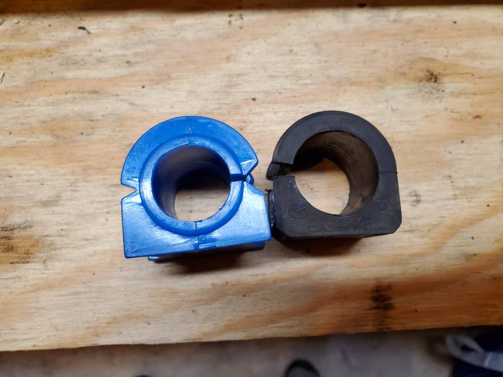

I got the bushings for 12 bucks at Rockauto. Endlinks were 21 each. The new bushings seemed to be much stiffer than the rubber ones that I removed. I think they are poly, not rubber. You can see the difference between the two. I also included a pic of the reverse thread sockets that I used to loosen one of the endlink nuts.
