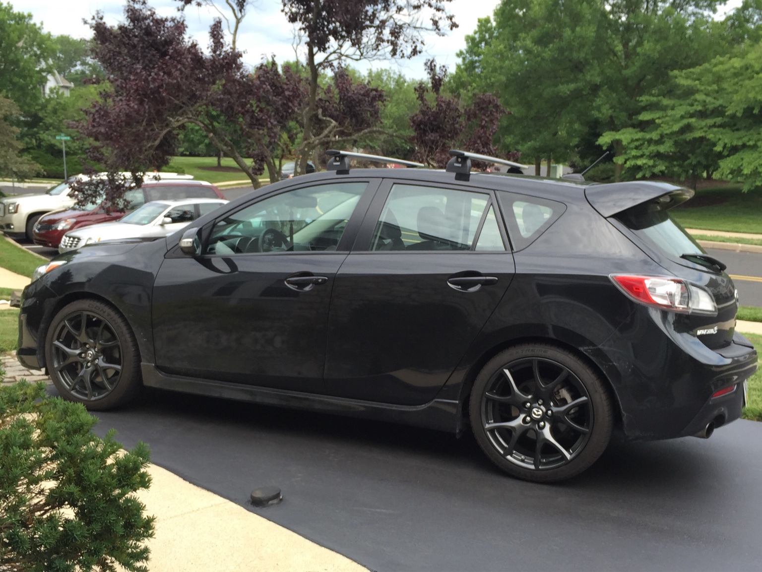

I put Swift springs on my car last fall with the OEM struts/dampers and it was a decent ride, but at times too bouncy for my taste. About a month ago I had my driver side rear damper leaking oil, it was shot. I replaced my OEMs with Koni Yellows adjusted to mid stiffness and the bounce is gone and the car feels very firm and responsive. I may even make an adjustment to stiffer. The only complaint I have about the koni yellows is that they have to be adjusted off of the car, but otherwise they are great. I would highly recommend the Swift springs for sure, a nice drop and definite improvement in handling. Of note, I needed adjustable camber arms to have a proper alignment on the car as well. Just my $0.02

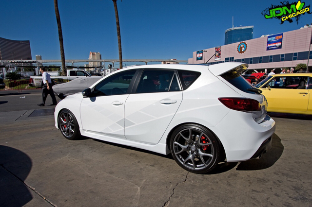

This is alllll awesome info guys. Takin the day off to install me some SWIFT springs tomorrow on stock s/s!!
Excited when THIS!
Turns to THIS!
Will keep u guys updated!
simplycmplex is offline   Reply With Quote
Excited when THIS!
Turns to THIS!
Dam that ride looks good! Let me know if you feel its bouncy and please post pictures of your ride once finished.
Excited when THIS!
Turns to THIS!
What color are those wheels on the white one? Look good
Sent from my SM-N920P using Tapatalk
I think they're the gunmetal grey that came with the RX8 R3...
I bought them with that color too but was a little too light for my tastes so i got them painted darker
Noooo! That set up looked amazing
It's not THAT bad... Will look even better when SWIFT install is done... Will keep you guys updated

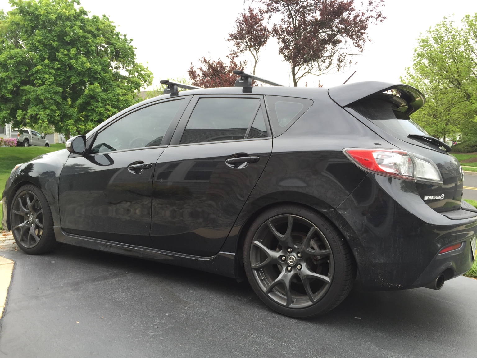

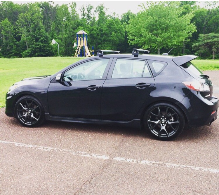

Default Swift or Eibach Pro kit?
BEFORE
AFTER
Just got done with her.... Down to a 1 finger gap from three ish...
Really tossing around the idea of spacers at this point... Im not quite set on it being a little tucked...
Havent done too much driving on it yet.... More feedback to come...
