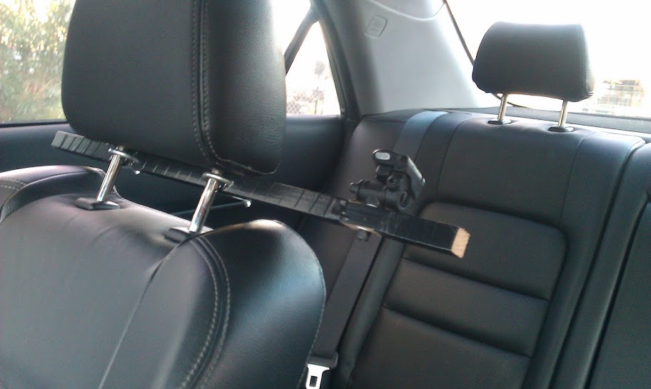

Did something similar but I felt the PVC was a bit flimsy.
Went to Lowe's, Ace and Best Buy for the following:
Tripod mount (BB)
3/4" square tubing, trimmed to 2' long (Lowes)
Two (2) 3/4" square plastic plugs (Lowes)
Two (2) 1/2" U-bolts (getting some wing nuts later on) (Lowes)
One (1) 1/4" x 20 UNC x 1 1/4" long (Ace)
Three (3) 1/4" metal washers (Ace)
Two (2) 1/4" rubber washers (Ace)
Z
Tripod mount (BB)
Z

I made a different version to mount my Sony NEX-5N. Slight vibes with this set-up and pretty cheap. Head rest poles fit through the grommets and the camer attaches to a $10 adjustable ball joint mount from Amazon. I can post up more details if people are interested.
