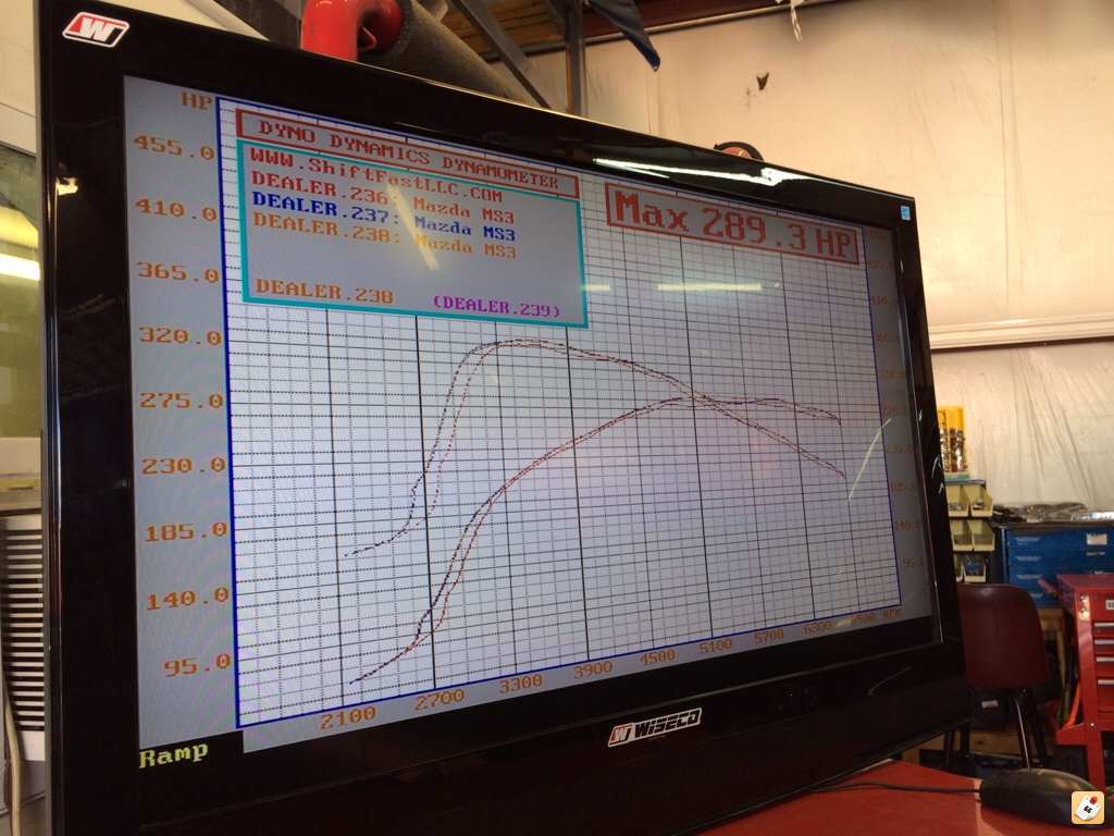

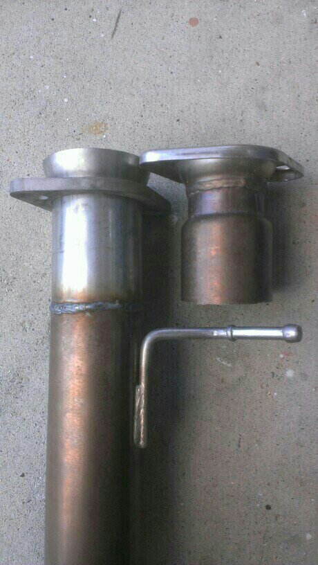

Many of you who own a Magnaflow know that the design has one big flaw. The flex pipe flange that connects the catback to the racepipe has an opening that is only 2.4 inches wide. This is smaller than the stock exhaust and causes an exhaust flow restriction on a pretty nice aftermarket exhaust that purrs like no other. Some maybe turned off by this since it's not a true 3" exhaust but I have discovered a piece that will fix this issue while remaining under $600 shipped.
This issue has become quite annoying to me so I took action and looked for a part that would fit the stock racepipe and an aftermarket pipe like my Ultimate Racing. My searches led me to this item in the link below. It's a 3" flange that welds perfectly to this magnaflow. It costs $38 shipped and includes a male flange that you really don't need but could be useful to some. This is the lowest priced high quality flange I could find. Magnaflow sells their own but it costs $119 for the same thing. For those who want more info the Manufacturer: Flangex and part: FX8054
3" ExhaustConnector
This is a picture of the new flange directly on top of the old flange. The red outline shows where the old flange opening begins.
Now for some of you like myself who don't have tools to cut and weld a pipe, shop around and find a good quality shop the labor should be cheap and easy. My guy did it for $30 dollars and it only took 10 mins. Here's the finished peice.
Here's pictures looking through the pipe at the openings at the other end (old vs new). The new one as you can see is straight through without restriction.
I was not expecting much of a difference between the two but I was wrong. I took some logs and can clearly see my cars is running better without that restrictive piece. The old piece appears to have been causing my car to miss its boost targets. I'm not running a downpipe so any back pressure relief helps a lot. Before this was installed I was hitting 17 max psi trickling down to 16, now I'm hitting 19 psi trickling down to 17. My VD is showing an increase in HP and torque. FYI, this is my absolute best VD out of 15 logs for my old Mangaflow vs my second run out of 2 on my new one, all logs show the same trend (so I'm not crazy). ALL WERE DONE ON THE SAME MAP, SAME ROAD, ETC. Also, for those that are curious about sound it is a small bit louder which is welcome from a relatively quiet exhaust.
Overall, now, I'm pretty happy with my Magnaflow. It was purchased brand new for $500 shipped. The flange and weld cost $68 for a total of $568 for a great sounding, solid exhaust. For those who are not sure if this is worth the work I tell you the flange change added more power than the exhaust when I first installed it.

Thanks for the thread @rustysurfsa; I didn't like the restriction either, I went about it a little differently. I went to a muffler shop and they heated the restricted spot of the pipe, and then threw it in a hydraulic pipe expander looked completely open after he was done, no cutting required, the shop owner didn't even charge me - he was like it was fun and it wasn't a big deal - Price = $0
Granted most people won't have access to a awesome shop like the one I went to but maybe this will help someone.

Didn't know that was possible. Any pics of the finished product?
No sorry I don't - I had some pics on my old phone, it had problems so I lost the pics :-(
I do have a dyno pic though after it was done and tuned though.
Tapatyped
Pretty awesome we have about the same power results with the same mods basically

Already posted this pic in another thread but it better fits here.
Flange came free with my purchase of the used exhaust, I bought a generic 3in donut gasket from fastwrx.com for about $20 shipped and cost another $20 to cut and weld new piece on.

So everyone on here has a ball and socket downpipe.... I have a CNT downpipe with a flat 3" flange. I want to cut the exhaust flange and put a flat 3" flange but cannot find one with slotted holes and the holes are not wide enough on the ones I do find. If you look at picture you will see what i mean. Putting the Flat gasket on top of the flange i ordered, holes will not line up. HELLLPPPPP!!!!!!!!!! I currently just stuck a flat gasket on but it will not last long without leaking like that. I am in big time need of a flat 3" flange with the correct bolt distance. Does anyone know the factory bolt distance? that maybe help in finding the right flange.

I ran into this issue when buying new gaskets.
Simple solution, ream or grind out the bolt holes into slots.
It's been a while since I found the right gaskets, so I can't recall numbers off the top of my head. I'll try to look through old invoices and see if I can find the supplier I found them at and a part number for reference and dimensions.

I will have to figure out how much room the slots in the down pipe have left or right. You may have a good point if I have room on the downpipe slots to move the bolts closer.
