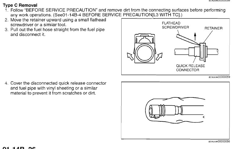

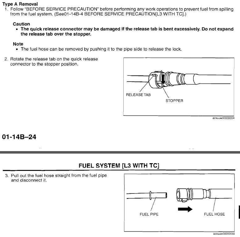

Got my Autotechs, read the instructions and watched the video. In most how tos that steel fuel line on the bottom is to be undone while the fitting on the pump is to not move. According to the video and instructions you remove the fitting anyway.
Also, is it really necessary to do all of that? Or can I just do the internals?

Yes, the pump must be removed completely to swap out the internals (meaning that removing all of the fuel lines from the pump is indeed necessary).

Default Blue and Yellow connector
Is this the instruction for removal of the blue connector?
and this for the yellow?
2010 MPS (European Mazdaspeed 3) Pearl White
sveli is offline   Reply With Quote
The Following User Says Thank You to sveli For This Useful Post:
rghispanic88 (03-02-2012)
 Old 03-02-2012, 06:16 PM   #264
DingoDave's Avatar
Location: Jarrell, Tx
Posts: 764   (View Stats)
Rep Power: 418
DingoDave is the leader of the worldDingoDave is the leader of the worldDingoDave is the leader of the worldDingoDave is the leader of the worldDingoDave is the leader of the worldDingoDave is the leader of the worldDingoDave is the leader of the worldDingoDave is the leader of the worldDingoDave is the leader of the worldDingoDave is the leader of the worldDingoDave is the leader of the world
Thanks: 4,812
Thanked 585 Times in 276 Posts
Groans: 43
Groaned at 8 Times in 4 Posts
Looks right to me

Ya just be careful with the yellow clip and dont let it fall off into no mans land. The blue clip does not have to come off completely. It can be halfway off.
