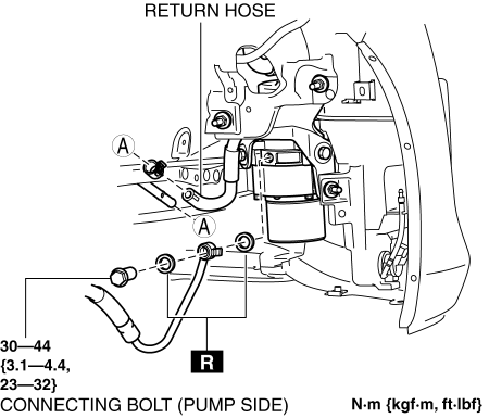

  4. Place your catch container under the two PS fluid lines on the lower tray (ref pic #2 where the drop light is)
  5. Disconnect the upper hose (low pressure return line) and let the fluid in the pump reservoir drain into the container. (ref pic #2)

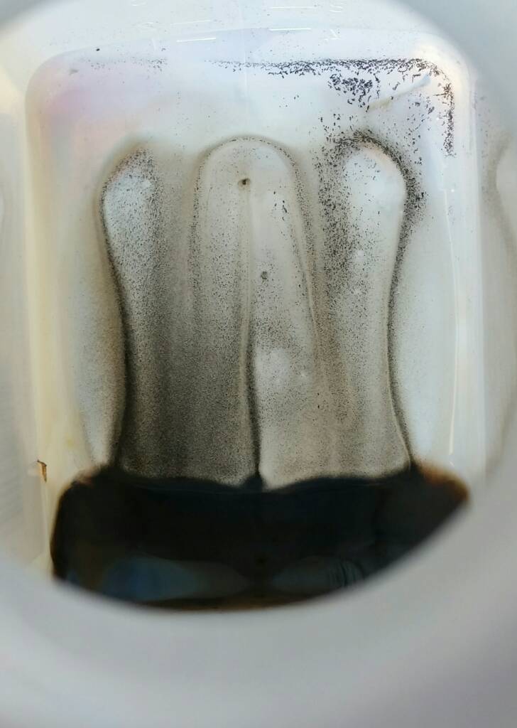

Have a look at the crap in the fluid and difference in color from new fluid. I did notice a slight difference in the sound of the PS pump unit, it's probably happy to have fresh fluid versus the dirty shit. Take note the metal container was an acetone jug and had no crap in it before starting. It gives you a good idea of the particles in the system.

Now that the old fluid has sat for some time the particles have fallen out of suspension. I'm not cutting open the container but the junk circulating through the system shown in the picture is yet another reason to change the fluid periodically.

Wow i'm surprised to see all that gunk in the reservoir before adding new fluid. I guess it might be worth it to flush it once through. Power steering is interesting though. My wife's car in the driveway that is going strong at 202k miles and the power steering fluid is the same as it's been on day one. Having said that I'd rather be safe then sorry. With regards to her car at this point if it ain't broke don't fix it. My car 2012 gen 2 is the road warrior, hers she just goes back and forth to work which is local. I just passed 60k miles, I think i'll put this on the schedule for around 75k. I have a bunch of work to do for the 60k mile service. Spark plugs, ignition coils, brake fluid, trans fluid and I have a broken shock.
For sure, don't mess with something over 200k, you might induce a problem.
Just to clarify the junk in the picture is in the bottle I drained he used fluid into. I'm sure that gunk was sitting in suspension and circulating through the system.
