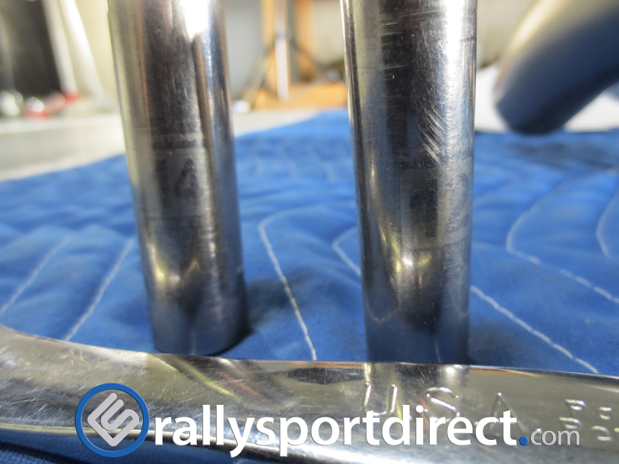

To remove the factory catback you'll basically only need a 12mm and 14mm socket and ratcheting wrench.

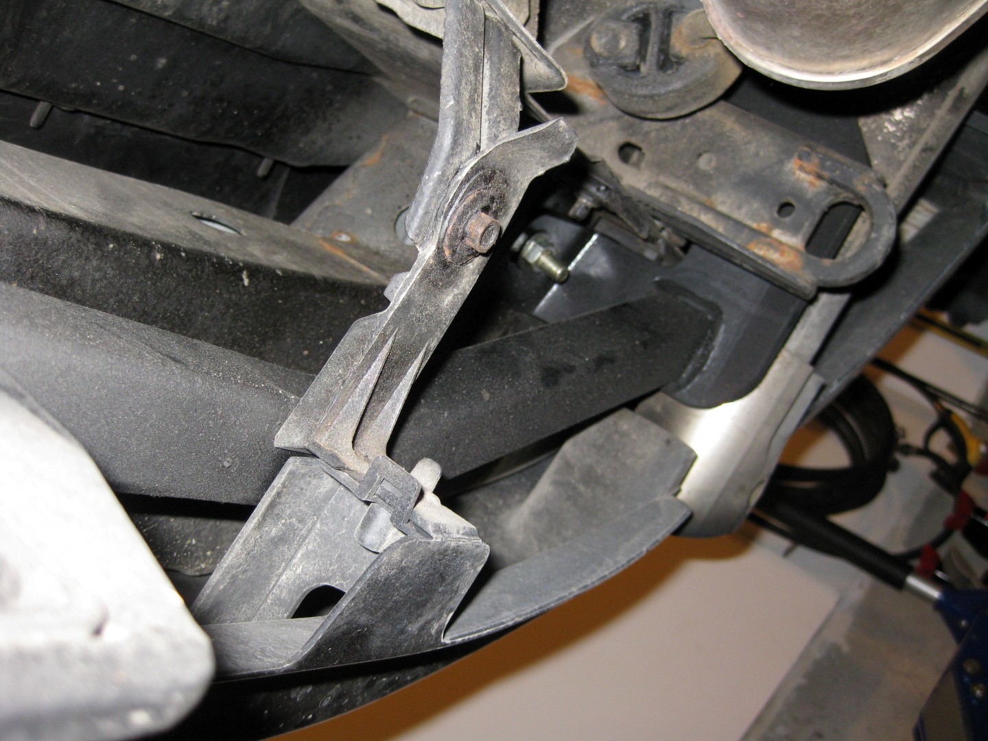

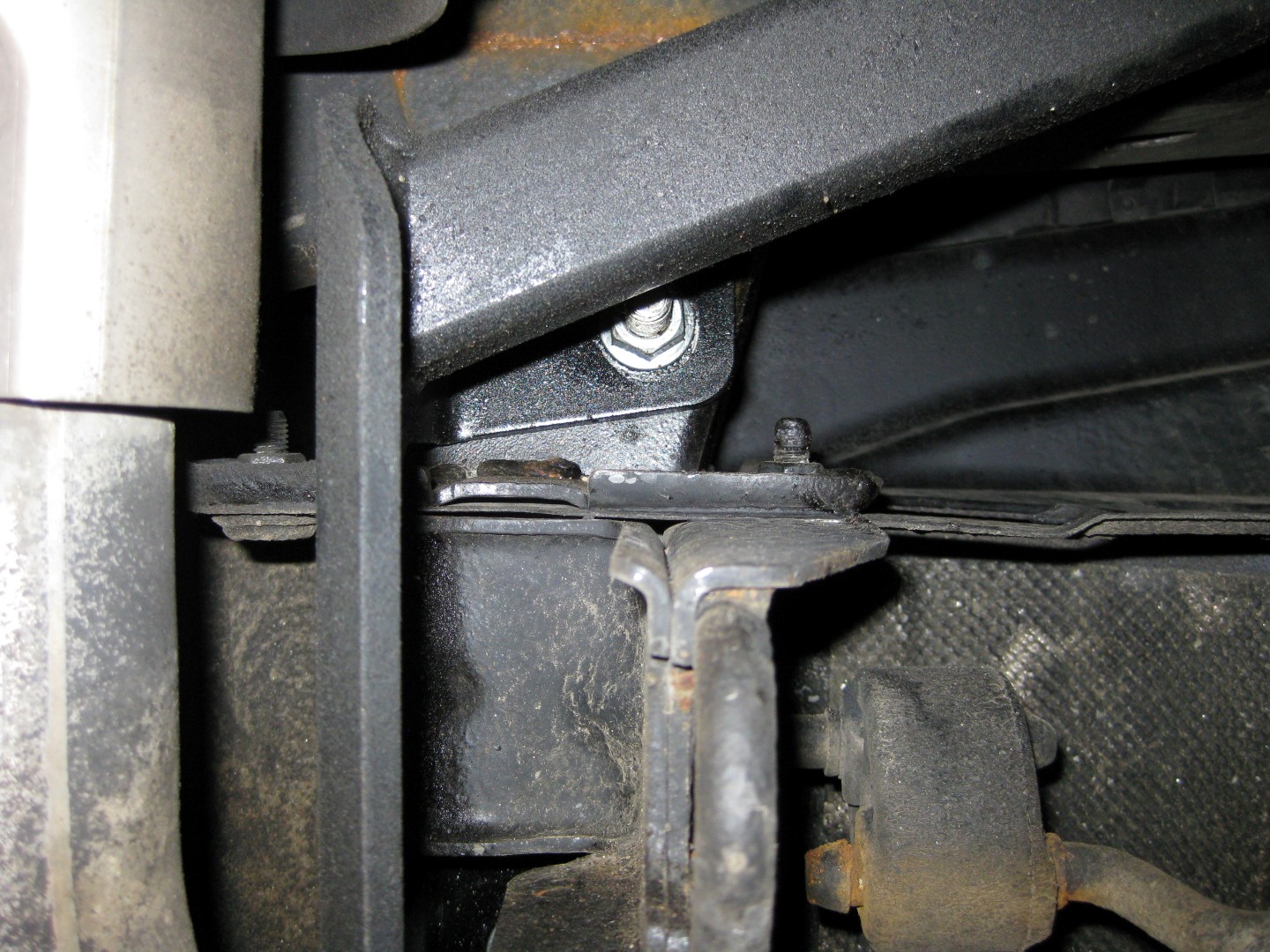

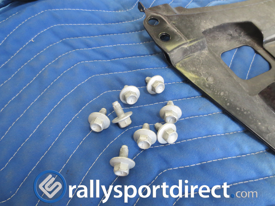

Start off by removing the mid chassis brace by removing the 8 12mm bolts. The brace has some hooks on it so you'll have to slide it back before it will drop down and off the car.

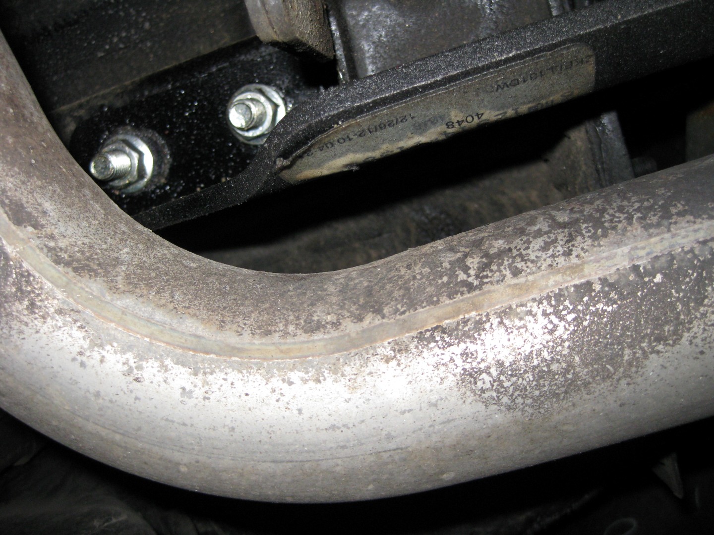

Use your 14mm to remove the nuts from both axleback and midpipe.
http://rallysportdirect.smugmug.com/...O/IMG_1264.jpg
http://rallysportdirect.smugmug.com/...O/IMG_1267.jpg
http://rallysportdirect.smugmug.com/...O/IMG_1270.jpg
http://rallysportdirect.smugmug.com/...O/IMG_1271.jpg
http://rallysportdirect.smugmug.com/...O/IMG_1272.jpg

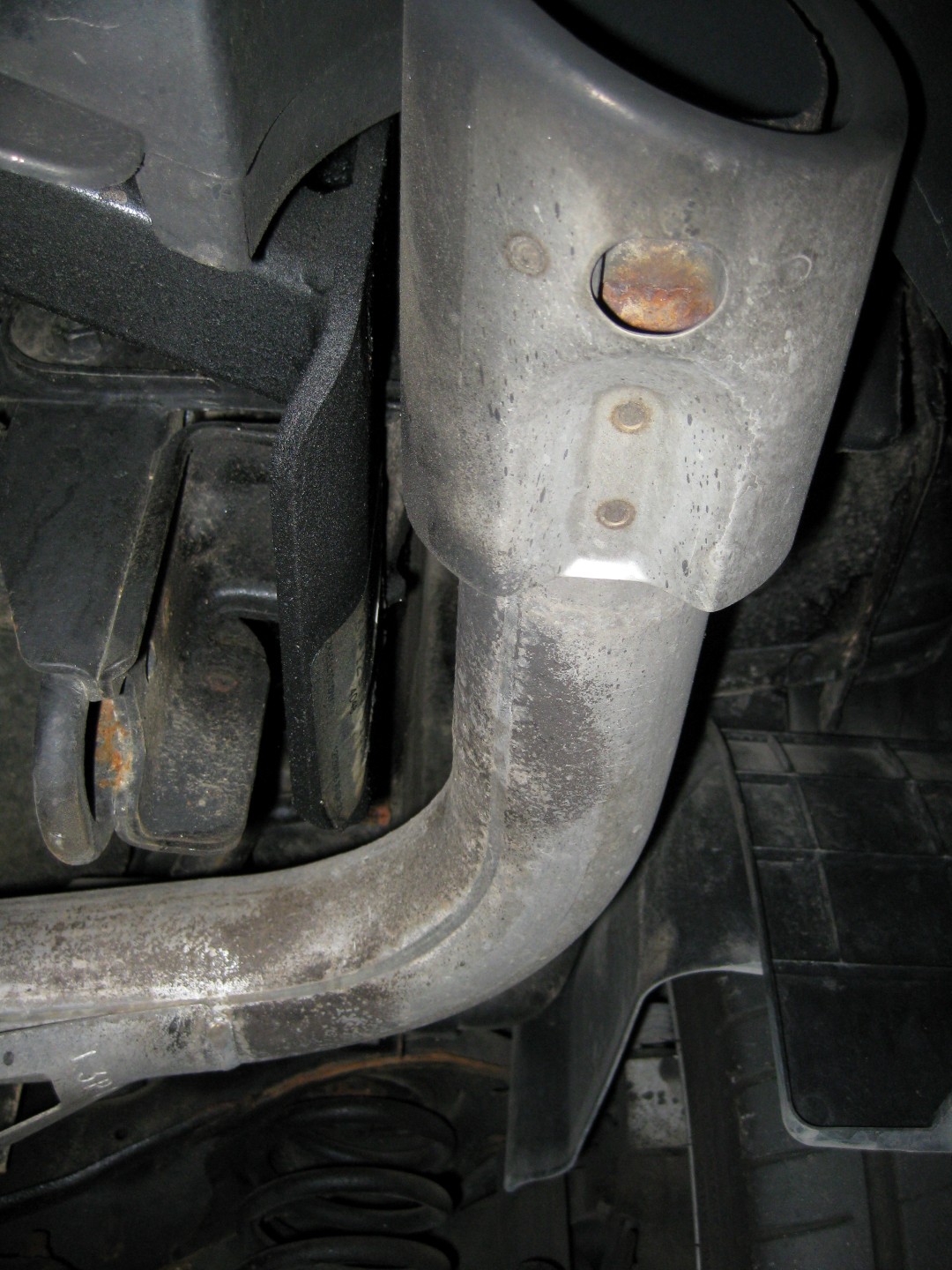

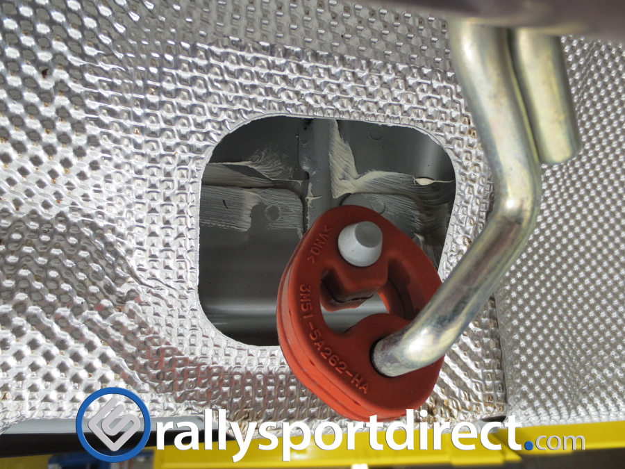

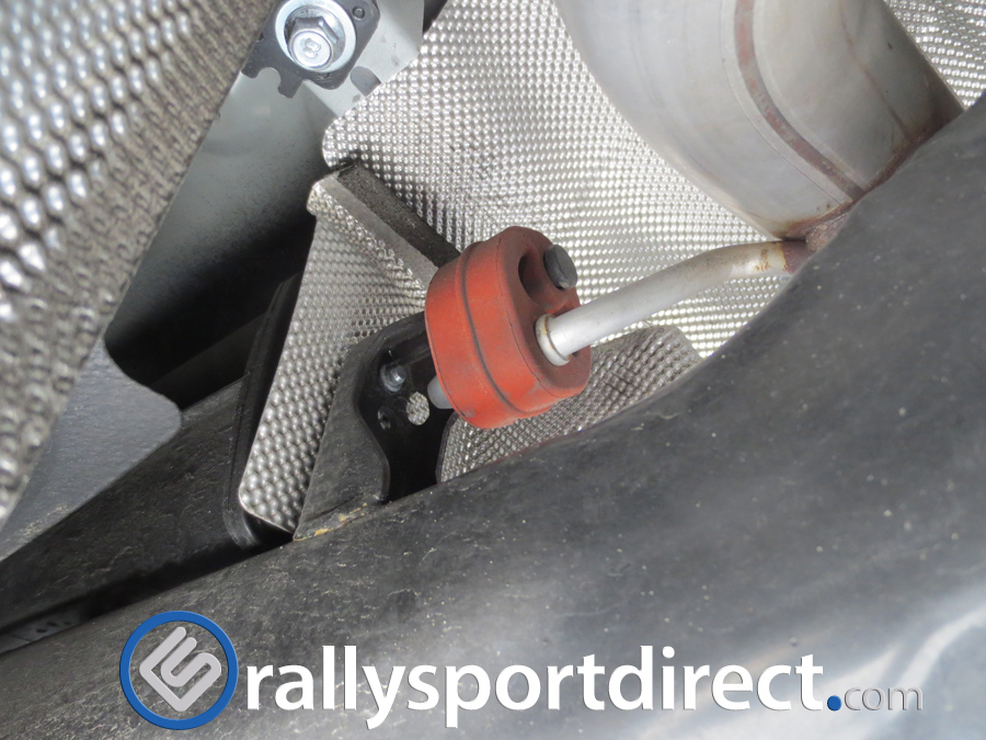

Next you'll disconnect the exhaust hangers and drop the factory system out of the way.
http://rallysportdirect.smugmug.com/...O/IMG_1273.jpg
http://rallysportdirect.smugmug.com/...O/IMG_1274.jpg
http://rallysportdirect.smugmug.com/...O/IMG_1278.jpg
http://rallysportdirect.smugmug.com/...O/IMG_1279.jpg
http://rallysportdirect.smugmug.com/...O/IMG_1282.jpg
http://rallysportdirect.smugmug.com/...O/IMG_1283.jpg

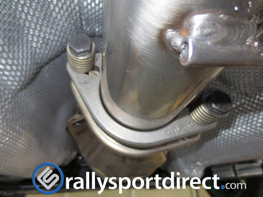

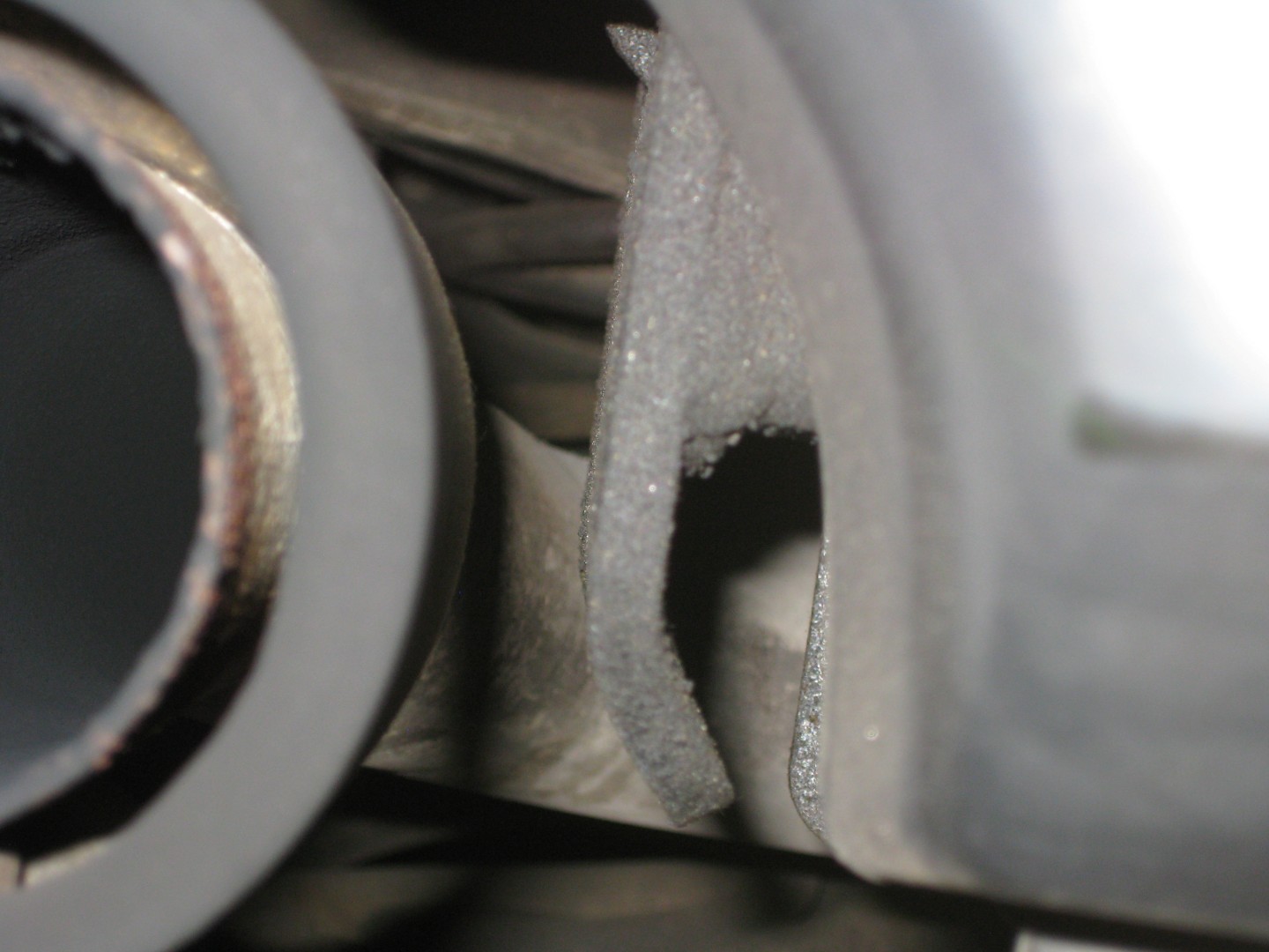

To install the midpipe, when connecting it to a factory downpipe or factory style you'll need to remove the stock studs and connect using the supplied bolts and washers and reuse the factory springs.

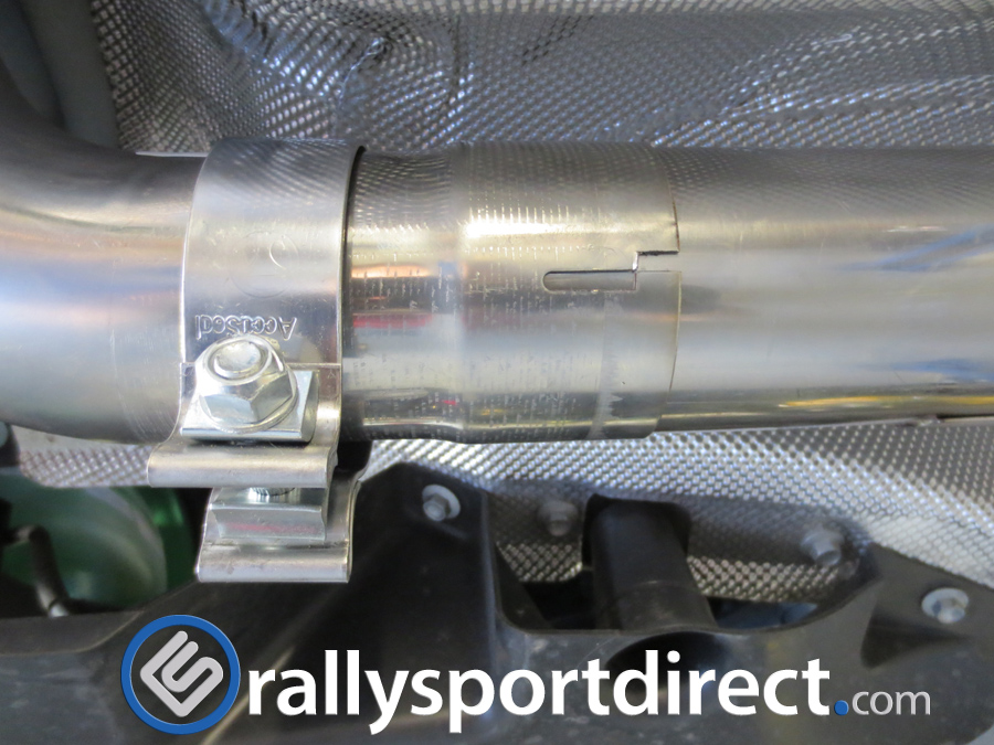

To connect the axle-back and midpipe you'll need to install the 3rd pipe in the kit that are slip fit connections with clamps.
http://rallysportdirect.smugmug.com/...O/IMG_1288.jpg
http://rallysportdirect.smugmug.com/...O/IMG_1290.jpg

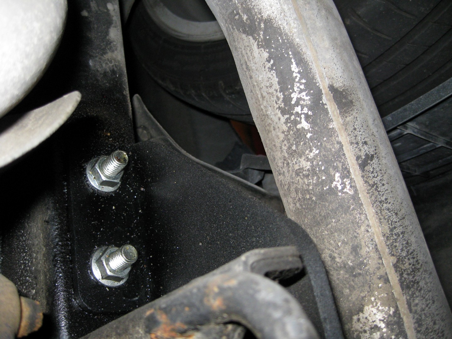

After you've connected all the pipes reinstall the chassis brace while ensuring you don't overtorque these bolts.

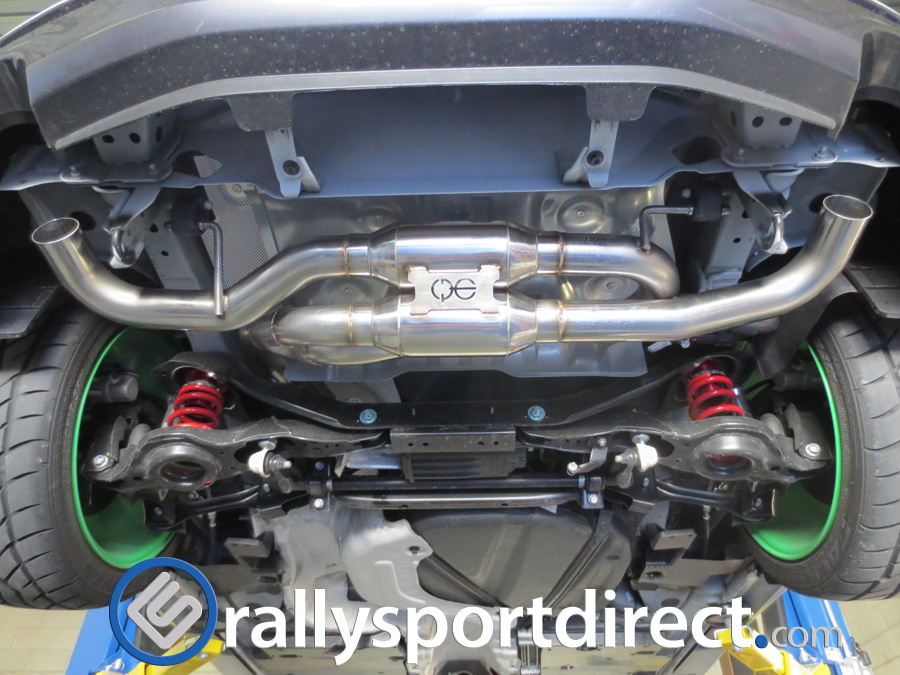

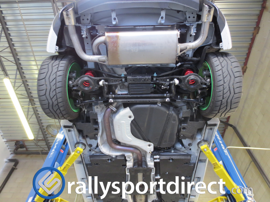

Here is the finished product.
http://rallysportdirect.smugmug.com/...O/DSC_2245.jpg

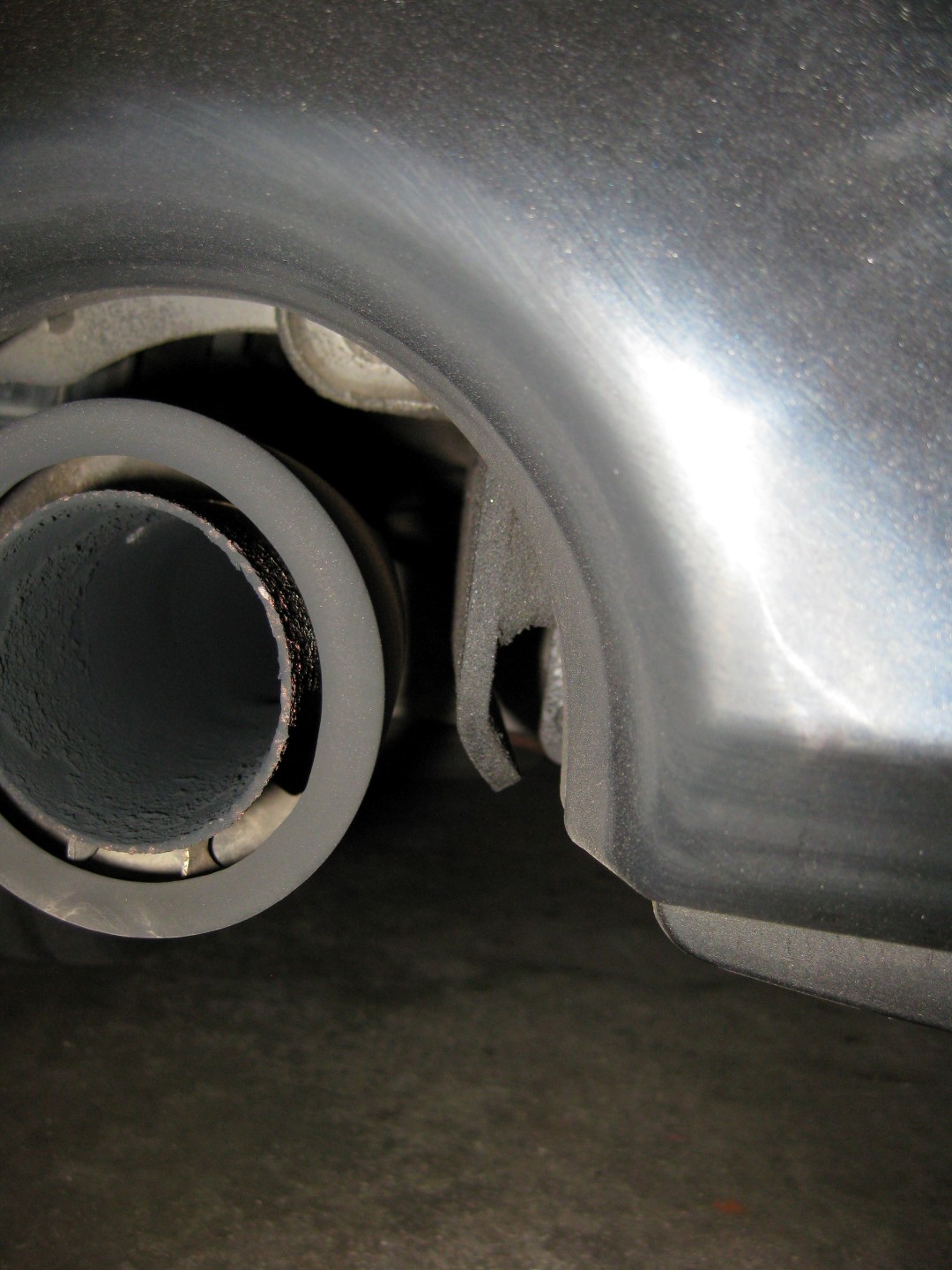

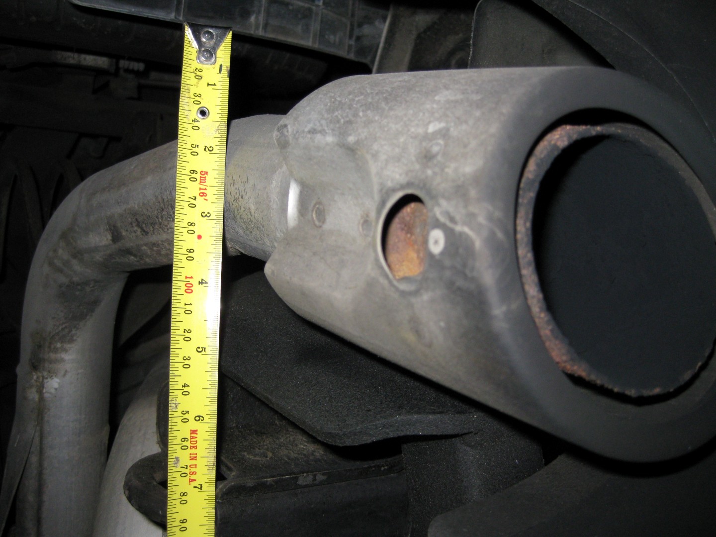

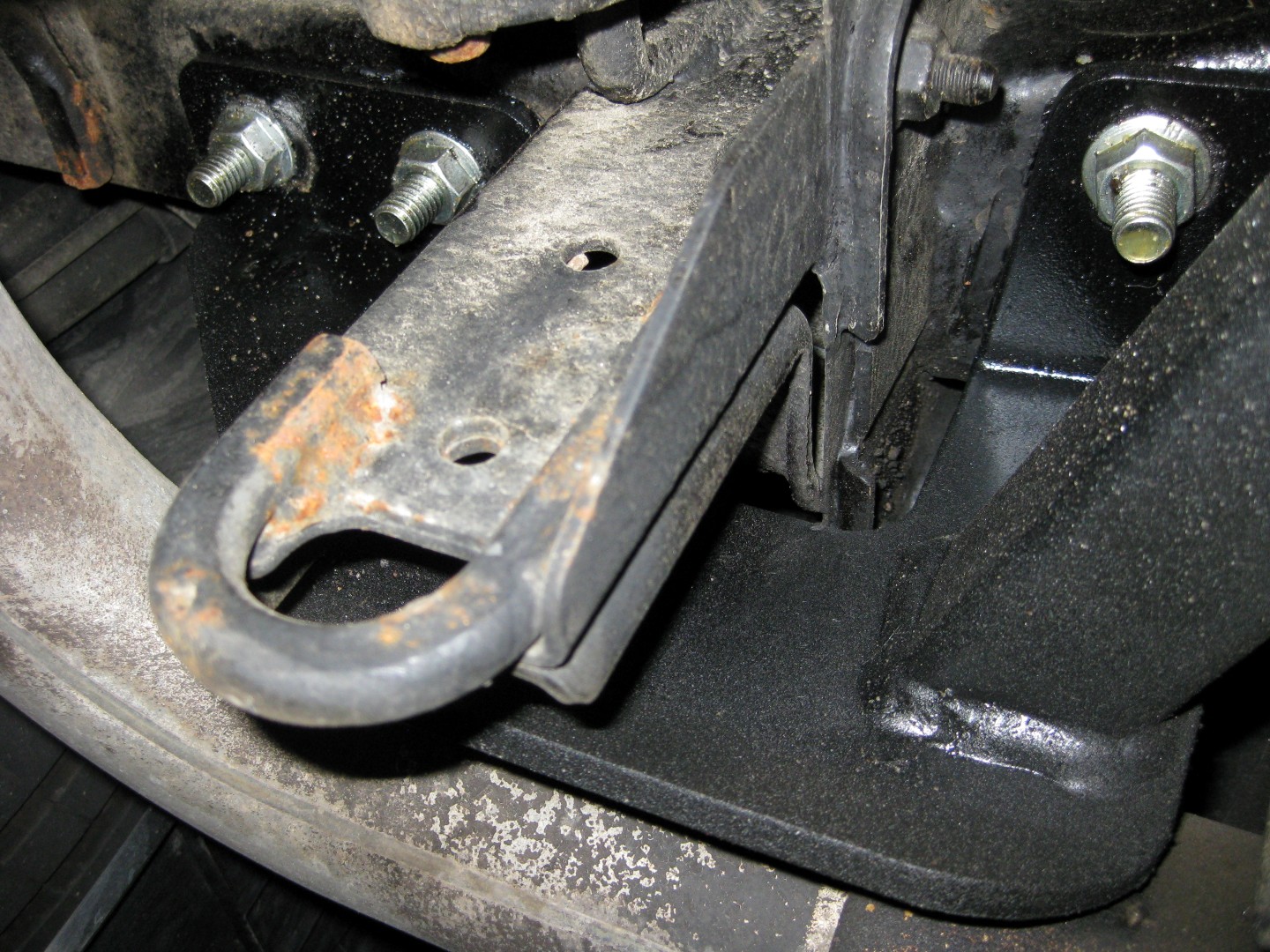

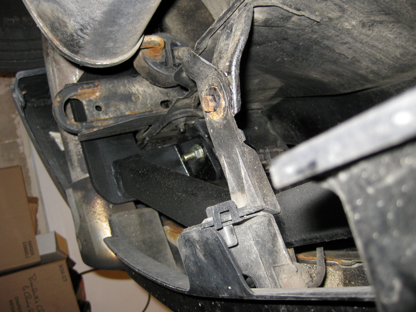

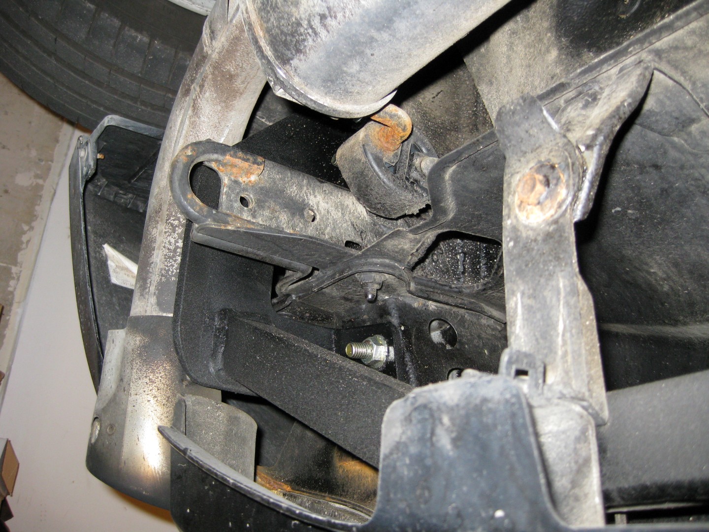

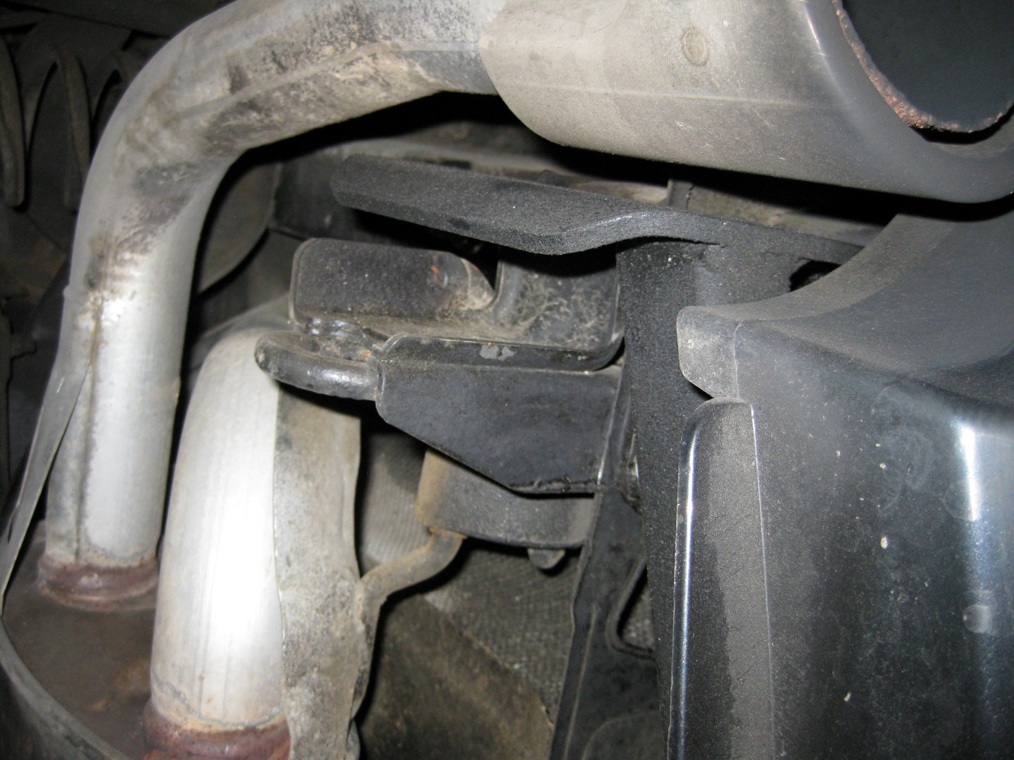

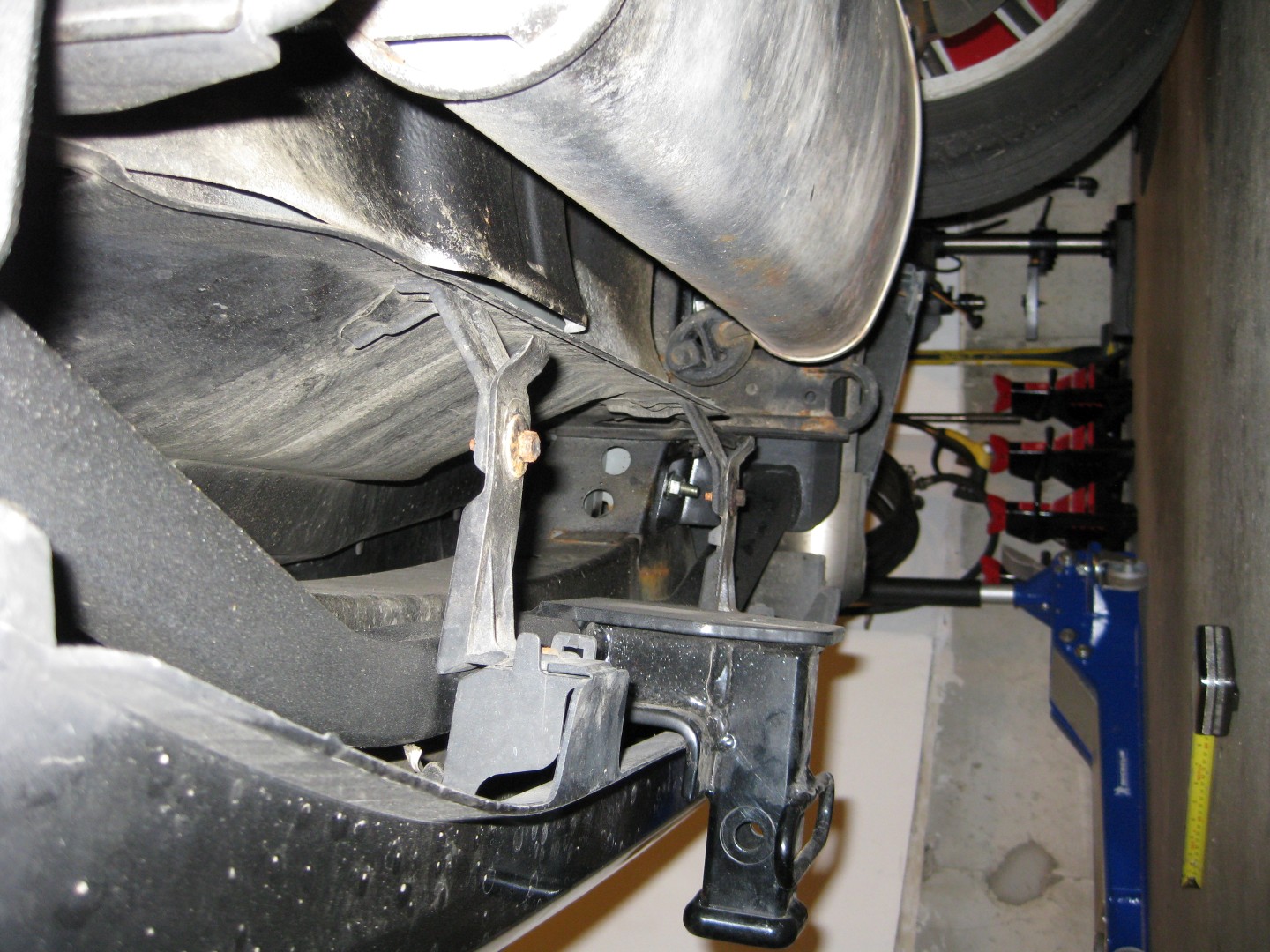

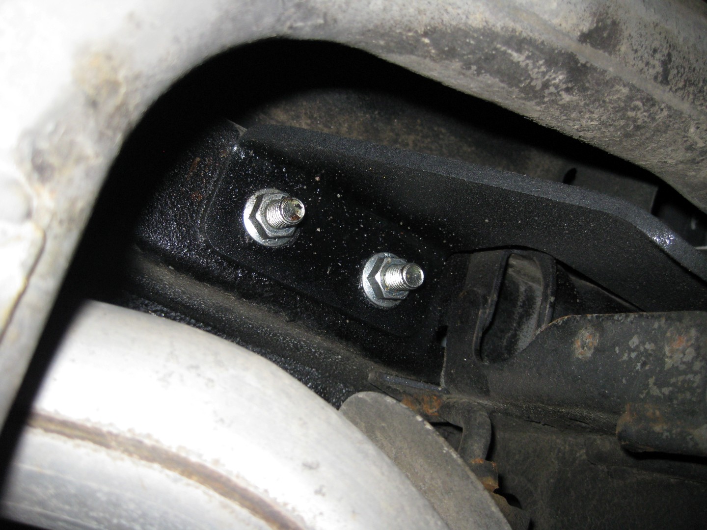

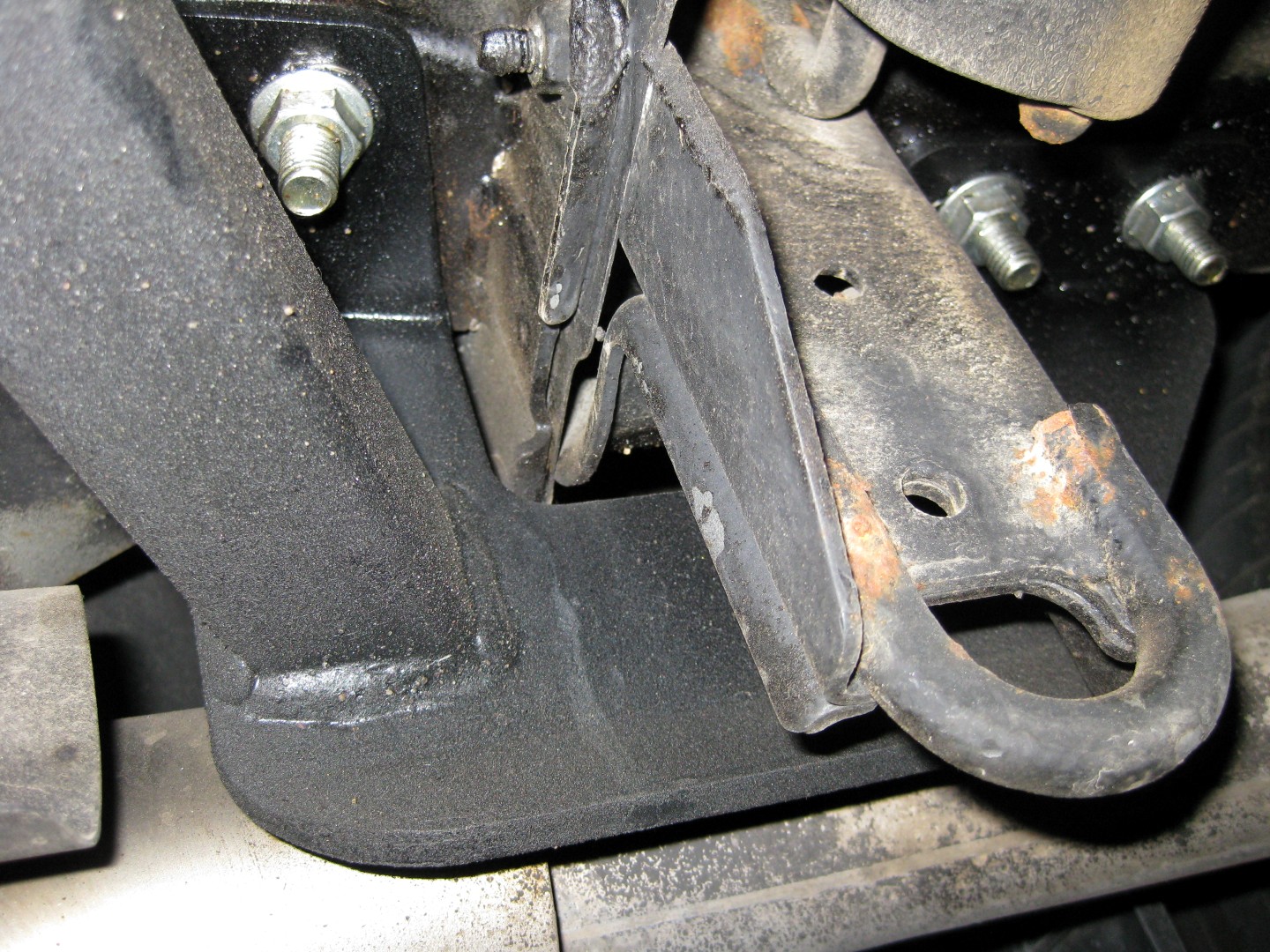

Bonus points if you can confirm fitment of this exhaust with a Curt 11383 hitch installed :) I'm on the hunt for a catback that will fit with my hitch.

RallySportDirect 10-11-2013 06:25 PM
Quote:
I did some digging around and was unable to come up with a solid answer. I basically was only able to get confirmation from Josh @ CP-E that their system is alot smaller than the factory exhaust so there should be more room to fit a tow hitch if that kit you have works with the factory system. I am sorry I don't have a guaranteed answer on this for you :(.

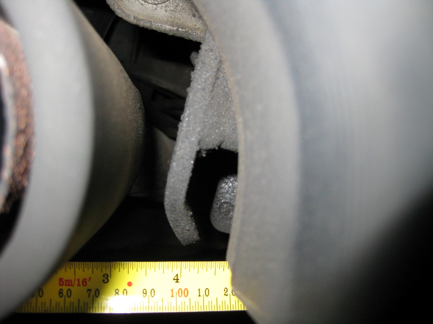

someguy 10-11-2013 07:46 PM
Quote:
Tanner
Tanner,
I was checking out the pictures and luckily yes the majority of it is smaller. I think the problem would be the tips though. I wonder since the cp-e tips are removal, if it would be possible to get ones that weren't so big? Here's some pics I had taken of clearance to the stock exhaust, the hitch metal is 1/4"

RallySportDirect 10-12-2013 08:27 PM

Quote:
Originally Posted by someguy (Post 2293808)
Tanner,
http://someforum.net/2013/hitch/1.jpg
http://someforum.net/2013/hitch/2.jpg
http://someforum.net/2013/hitch/3.jpg
http://someforum.net/2013/hitch/4.jpg
http://someforum.net/2013/hitch/5.jpg
http://someforum.net/2013/hitch/6.jpg
http://someforum.net/2013/hitch/7.pg
http://someforum.net/2013/hitch/8.jpg
http://someforum.net/2013/hitch/9.jpg
http://someforum.net/2013/hitch/10.jpg
http://someforum.net/2013/hitch/11.jpg
http://someforum.net/2013/hitch/12.jpg
http://someforum.net/2013/hitch/13.jpg
http://someforum.net/2013/hitch/14.jpg
http://someforum.net/2013/hitch/15.jpg
http://someforum.net/2013/hitch/16.jpg
http://someforum.net/2013/hitch/17.jpg
http://someforum.net/2013/hitch/18.jpg
http://someforum.net/2013/hitch/19.jpg
http://someforum.net/2013/hitch/20.jpg
Let me get some measurements off of mine this week and maybe that will help with the comparison for clearance.

I just sent you over a PM with a bunch of images, hopefully we can figure out the fitment for you :).
