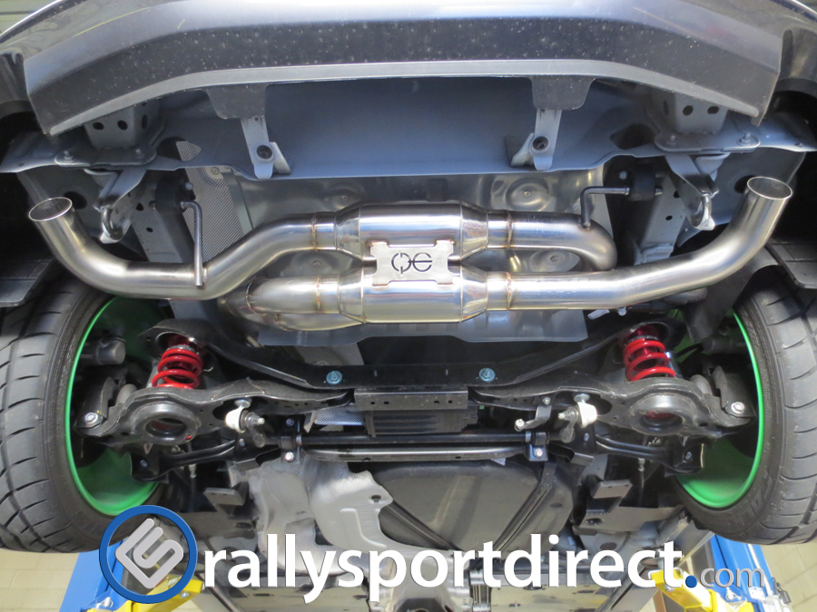

Looking for a little more out of your 2010+ MazdaSPEED3 exhaust?
Introducing the cp-e™ Triton™ 3" cat back exhaust for the 2nd Generation MazdaSPEED3's.
Featuring a full 3" Stainless Steel mid pipe, two cp-e™ designed resonators, and dual 4" polished exhaust tips; this cat back exhaust will not only improve the breathing of your 2nd gen MazdaSPEED3, it will also give you that aggressive exhaust note you've been looking for!
The cp-e™ Triton cat back exhaust for the 2nd gen MazdaSPEED3 has a very controlled exhaust note. No drone at cruising speeds, yet pronounced and aggressive at wide open throttle.
For those of you who have replaced the extremely restrictive factory downpipe, this 3" cat back will remove the last bottleneck in the exhaust stream; increasing the engines breathing capacity and smoothing out the turbo spool.
All cp-e™ exhausts are made from Super Polished Stainless Steel. The 18g heavy duty stainless piping is mandrel bent and cut on their in-house CNC Bender and CNC Mills. The systems feature custom cast Stainless Flanges, reliable hangers, custom made Stainless Mufflers and polished stainless tips. Everything is TIG welded by hand to get beautiful color and durability in the welds. Designed fully in a CAD environment to guarantee a factory-like fit every-time with great performance gains.

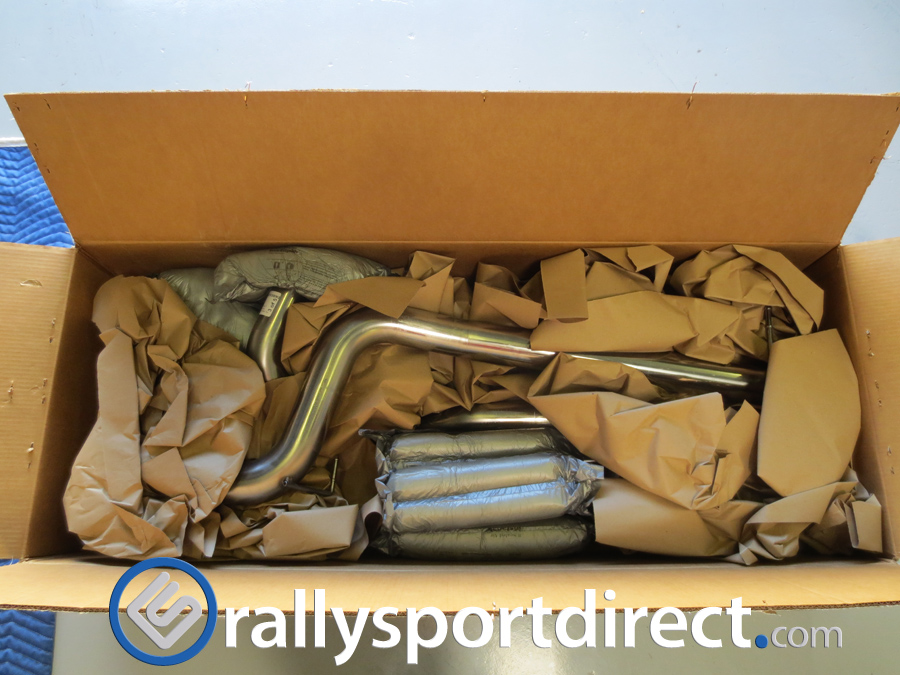

As always great packaging and presentation by CP-E.

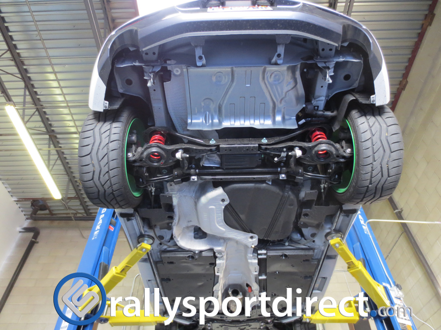

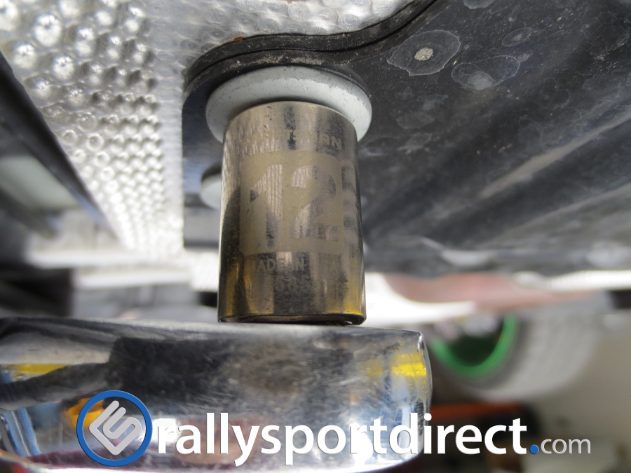

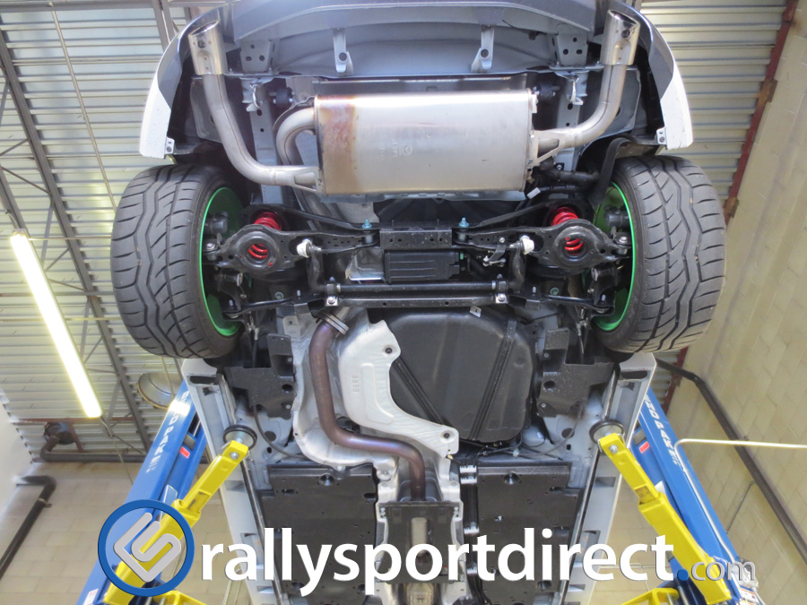

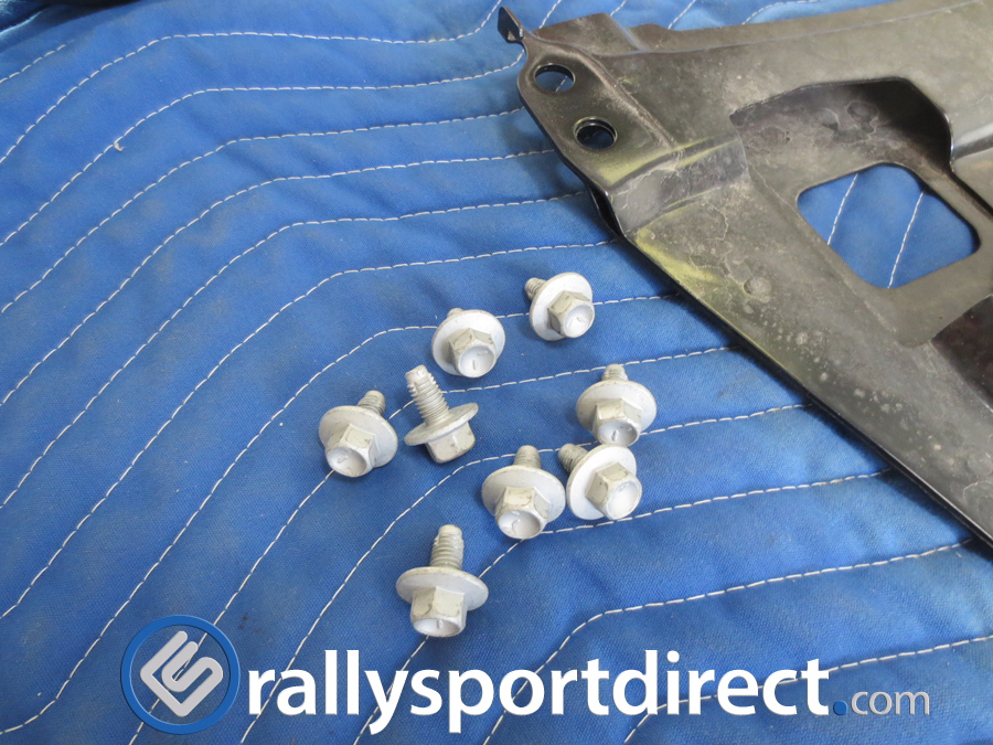

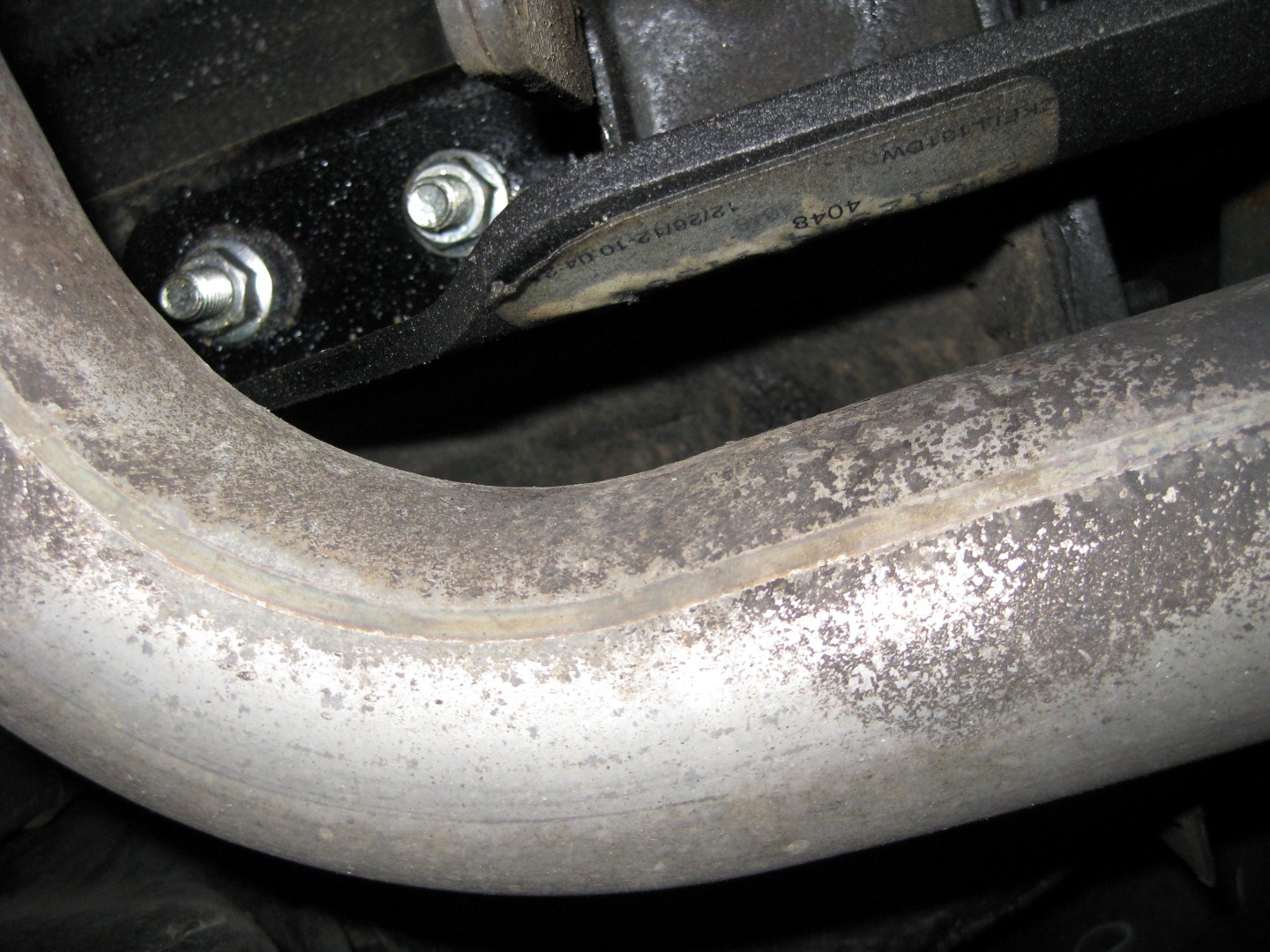

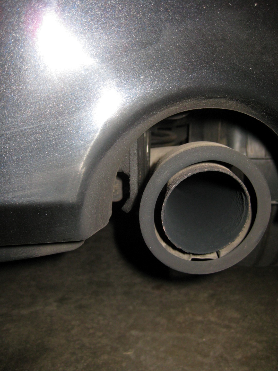

You can either do this installation on a lift or with jack stands. Luckily we have a lift here at work which always makes working on cars easier so I opted to take advantage of it for this install.

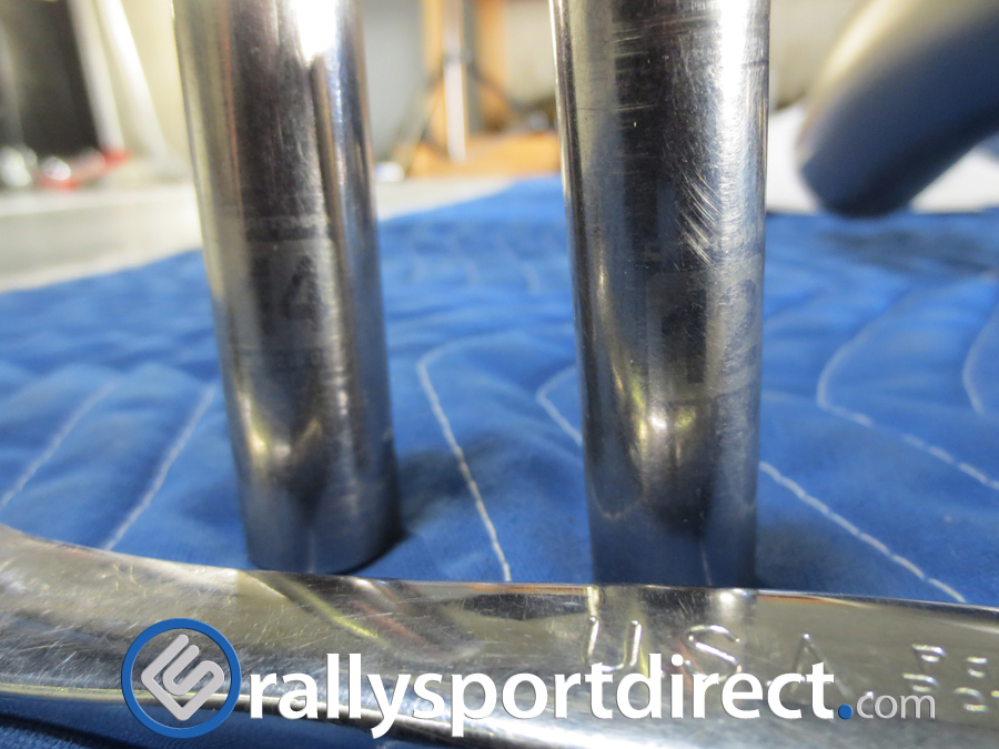

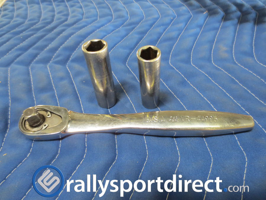

To remove the factory catback you'll basically only need a 12mm and 14mm socket and ratcheting wrench.

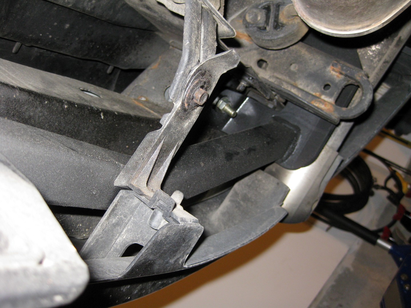

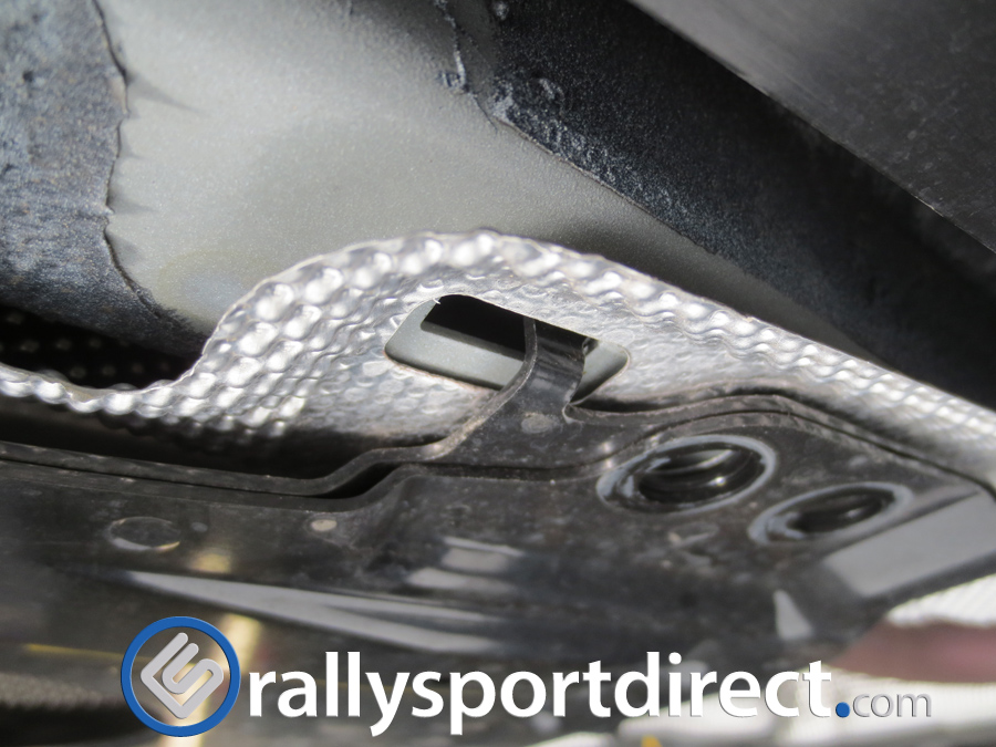

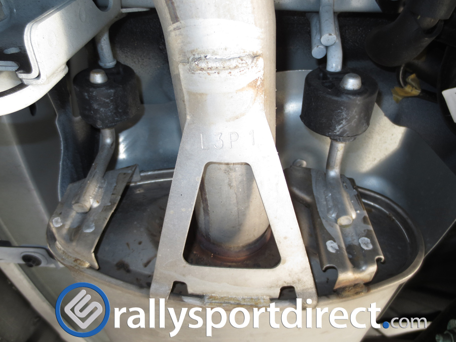

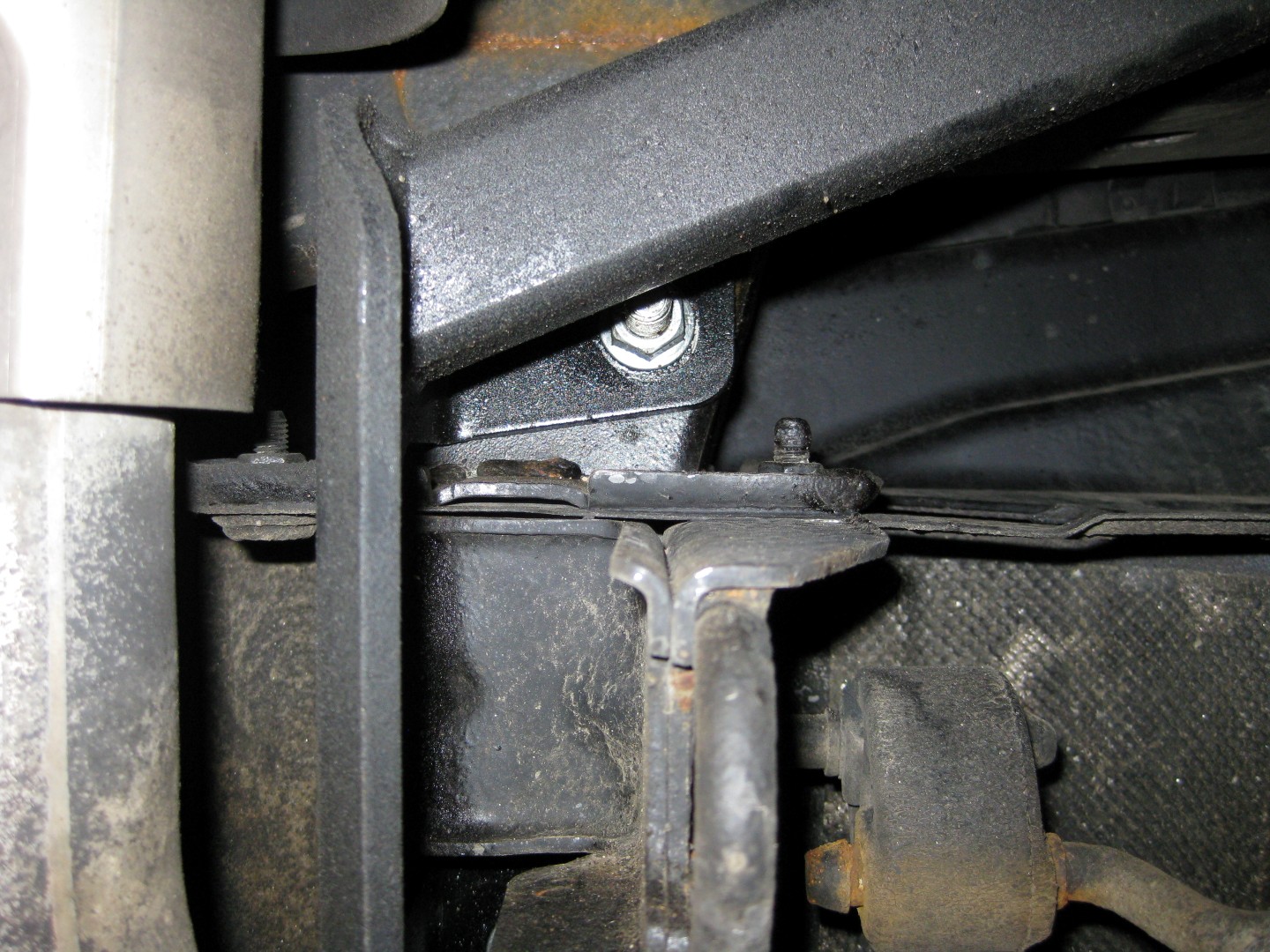

Start off by removing the mid chassis brace by removing the 8 12mm bolts. The brace has some hooks on it so you'll have to slide it back before it will drop down and off the car.

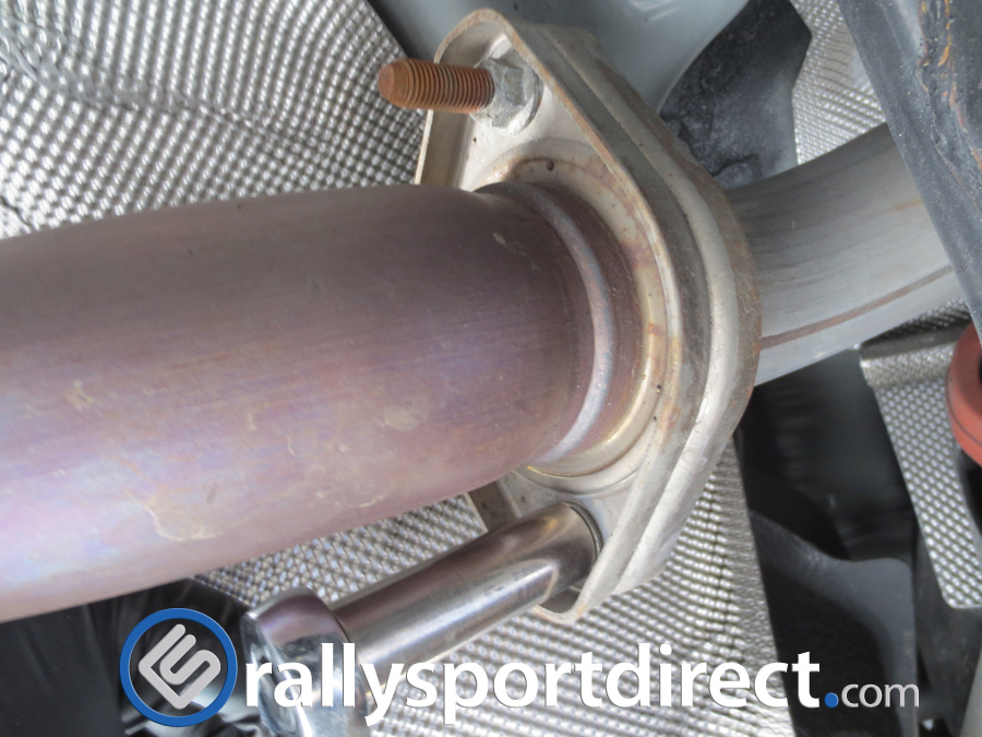

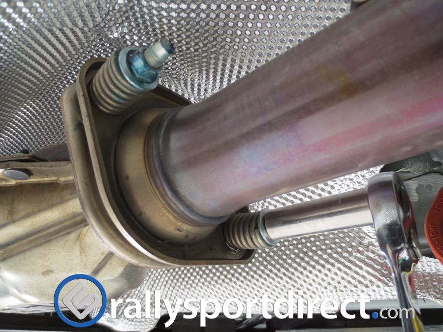

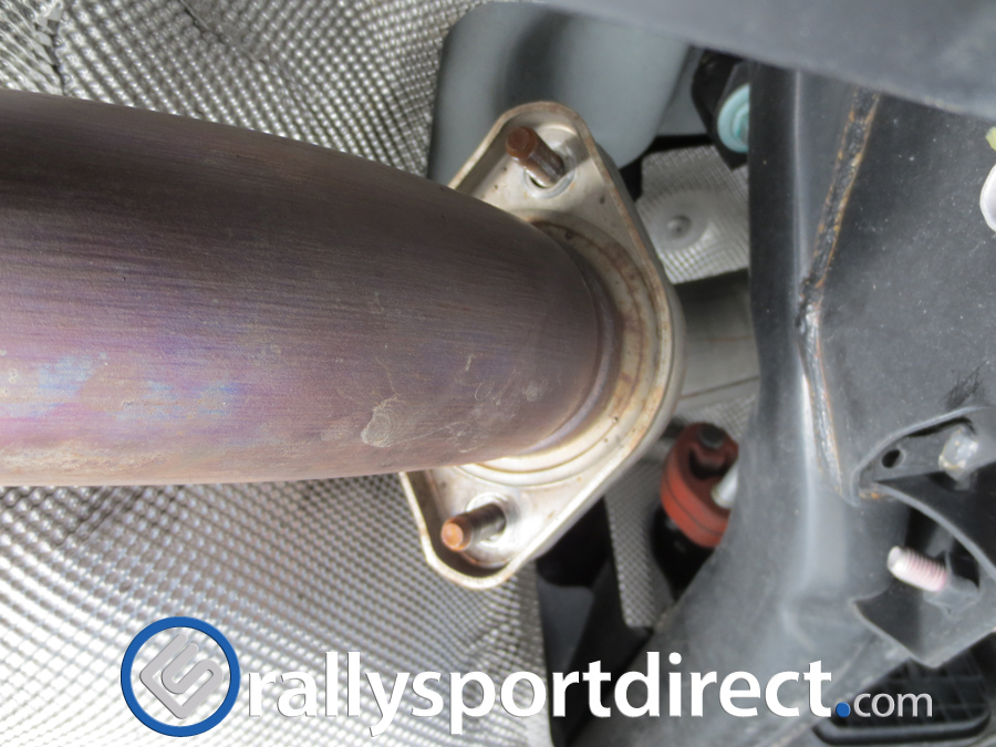

Use your 14mm to remove the nuts from both axleback and midpipe.

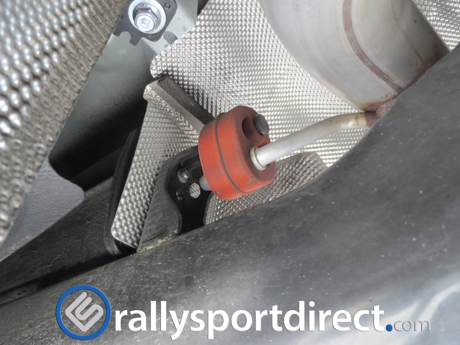

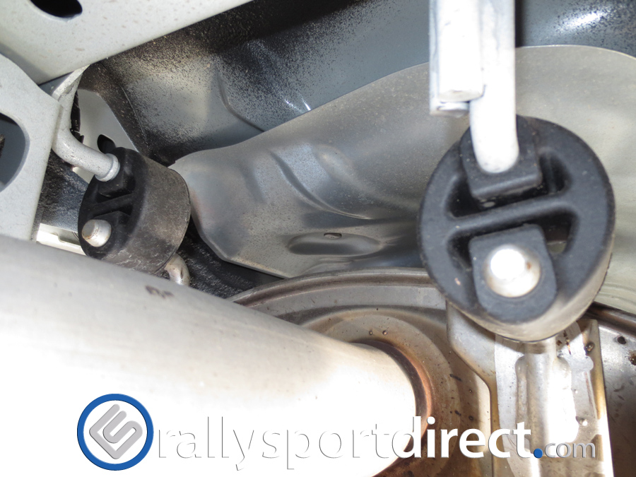

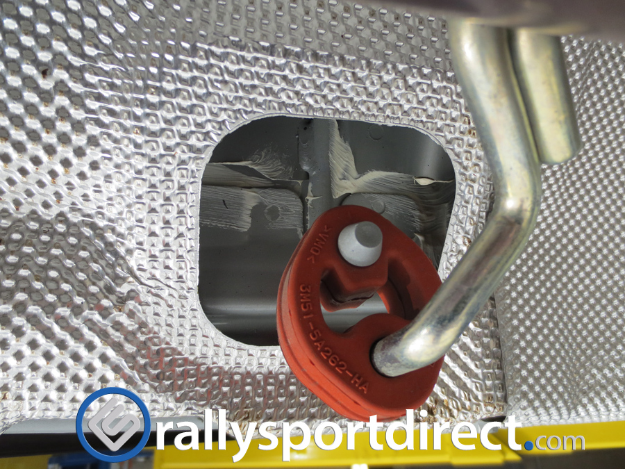

Next you'll disconnect the exhaust hangers and drop the factory system out of the way.
Here is the car with the factory catback uninstalled.

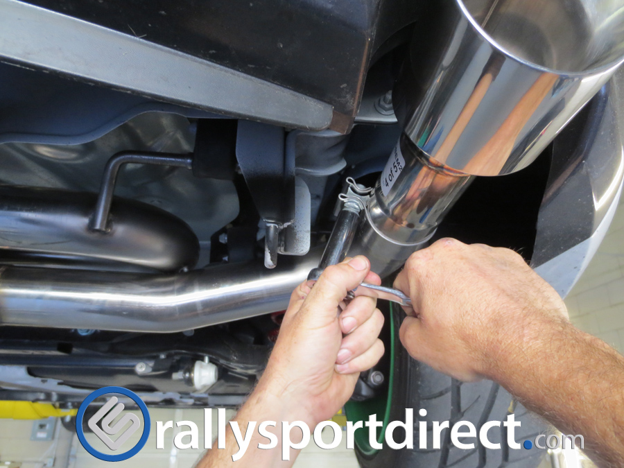

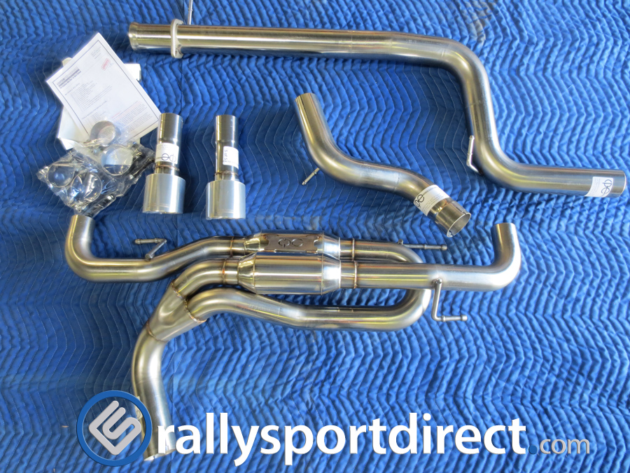

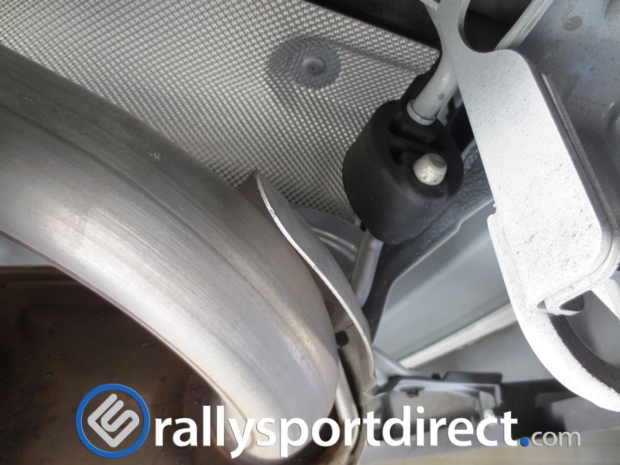

Mount up the pretty CP-E axle-back section.

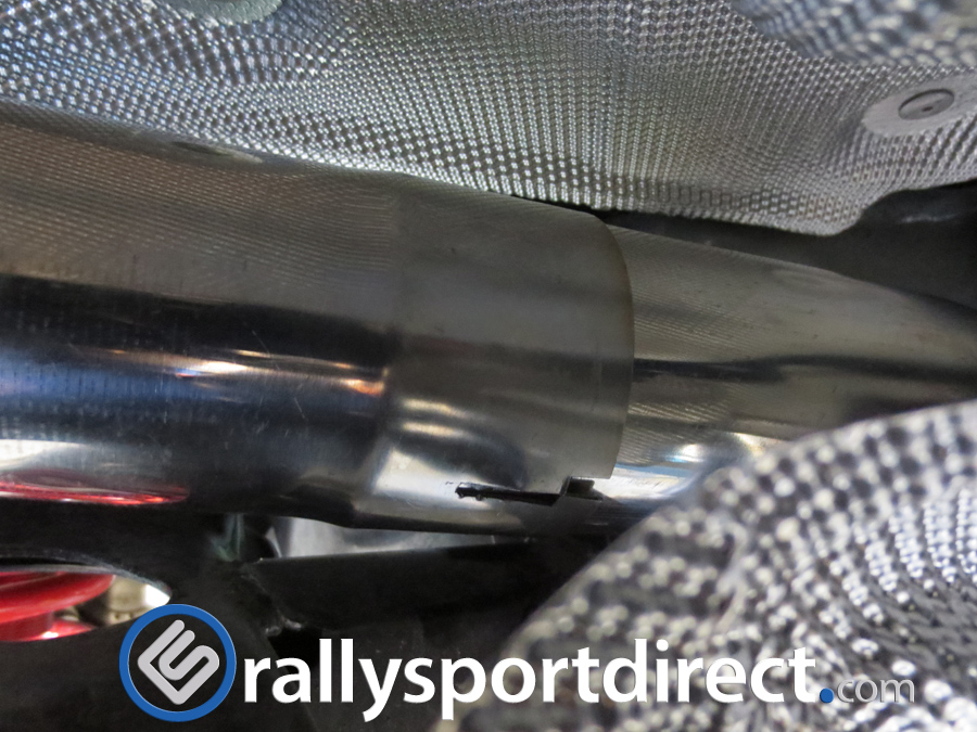

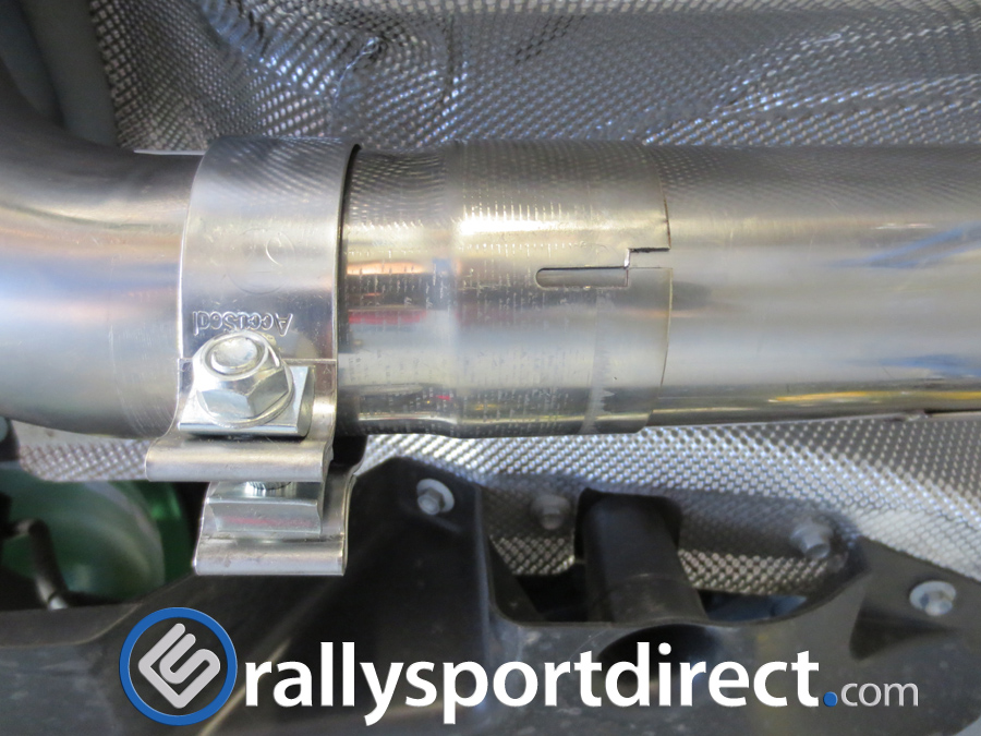

To install the midpipe, when connecting it to a factory downpipe or factory style you'll need to remove the stock studs and connect using the supplied bolts and washers and reuse the factory springs.
To connect the axle-back and midpipe you'll need to install the 3rd pipe in the kit that are slip fit connections with clamps.
After you've connected all the pipes reinstall the chassis brace while ensuring you don't overtorque these bolts.
Install the tips as the last part. There is a fair amount of adjustment on the tips so that you can either install them flush with the bumper, out further or have them sit tucked under the bumper, really whatever you feel you like best.

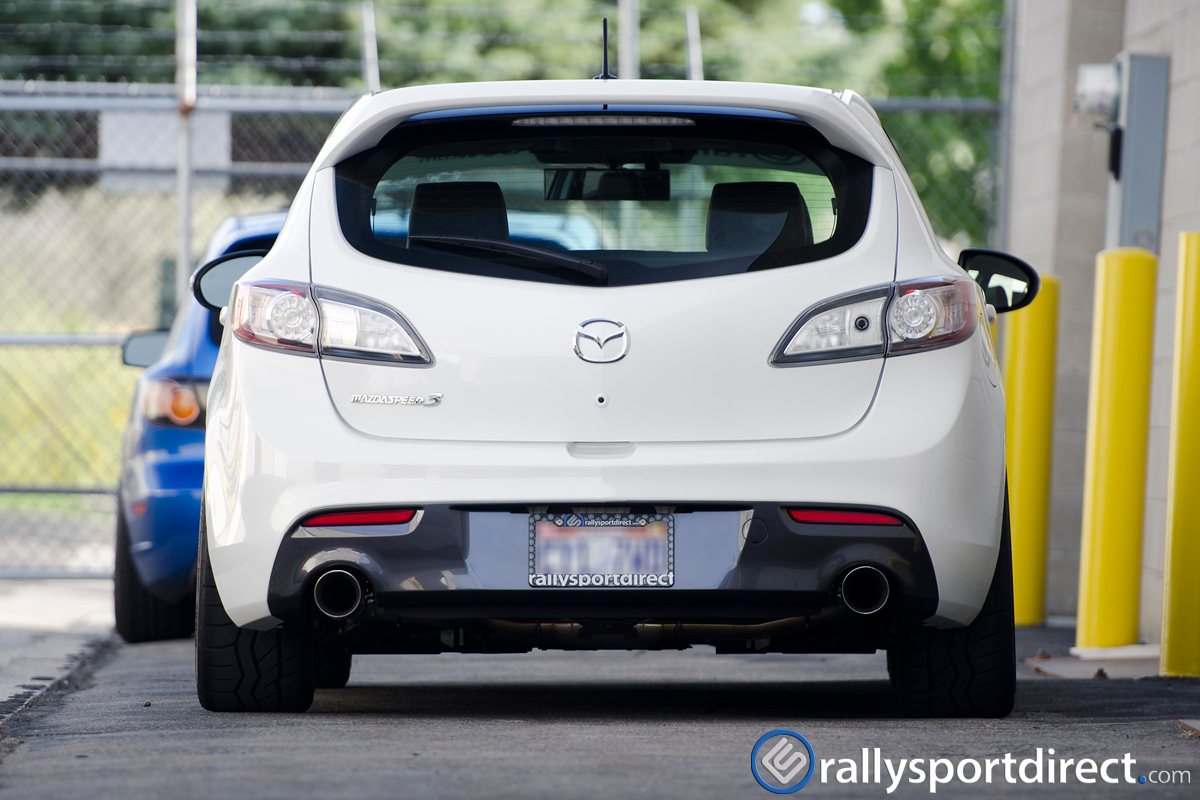

Here is the finished product.

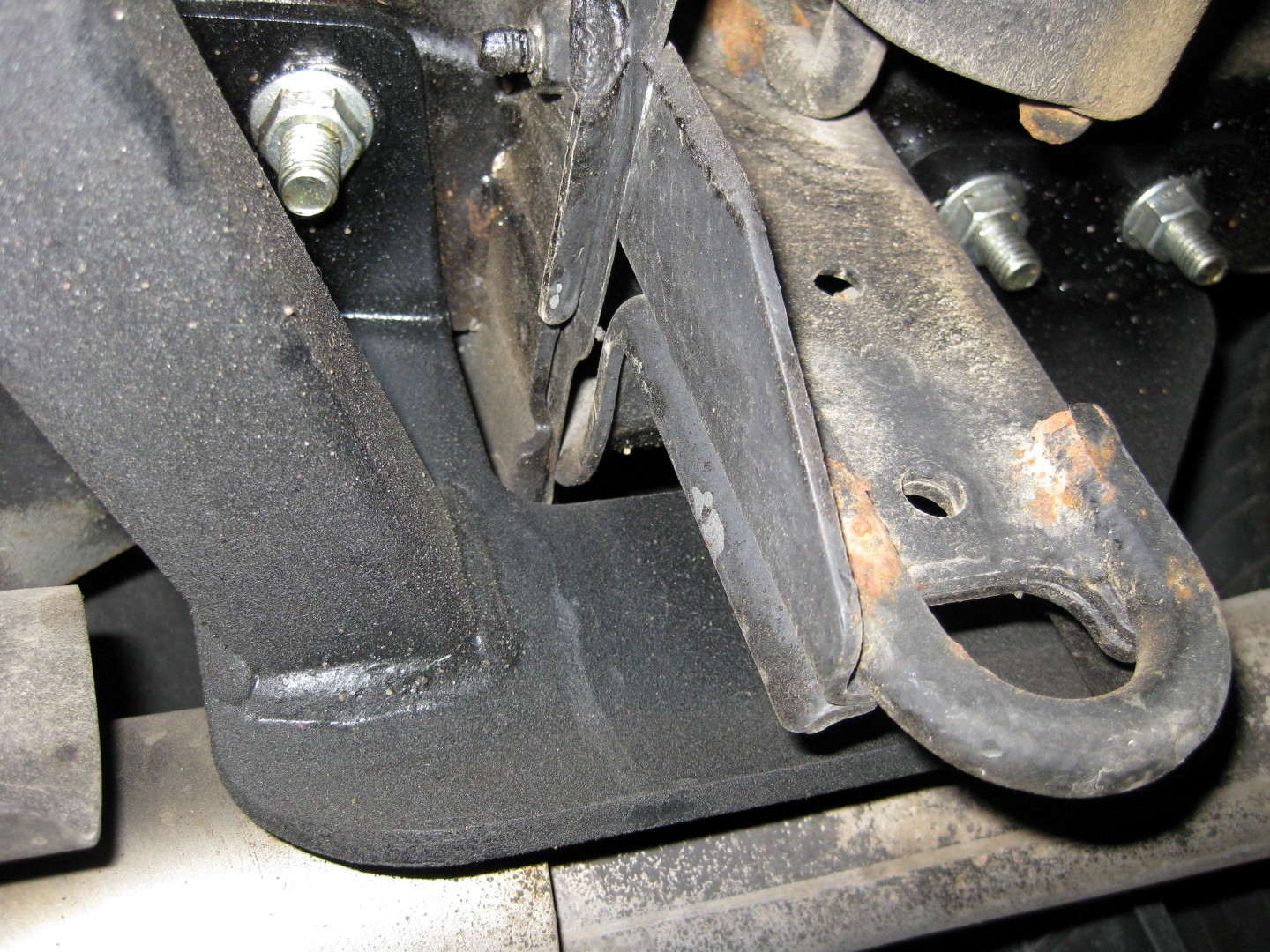

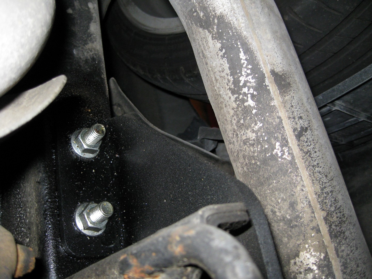

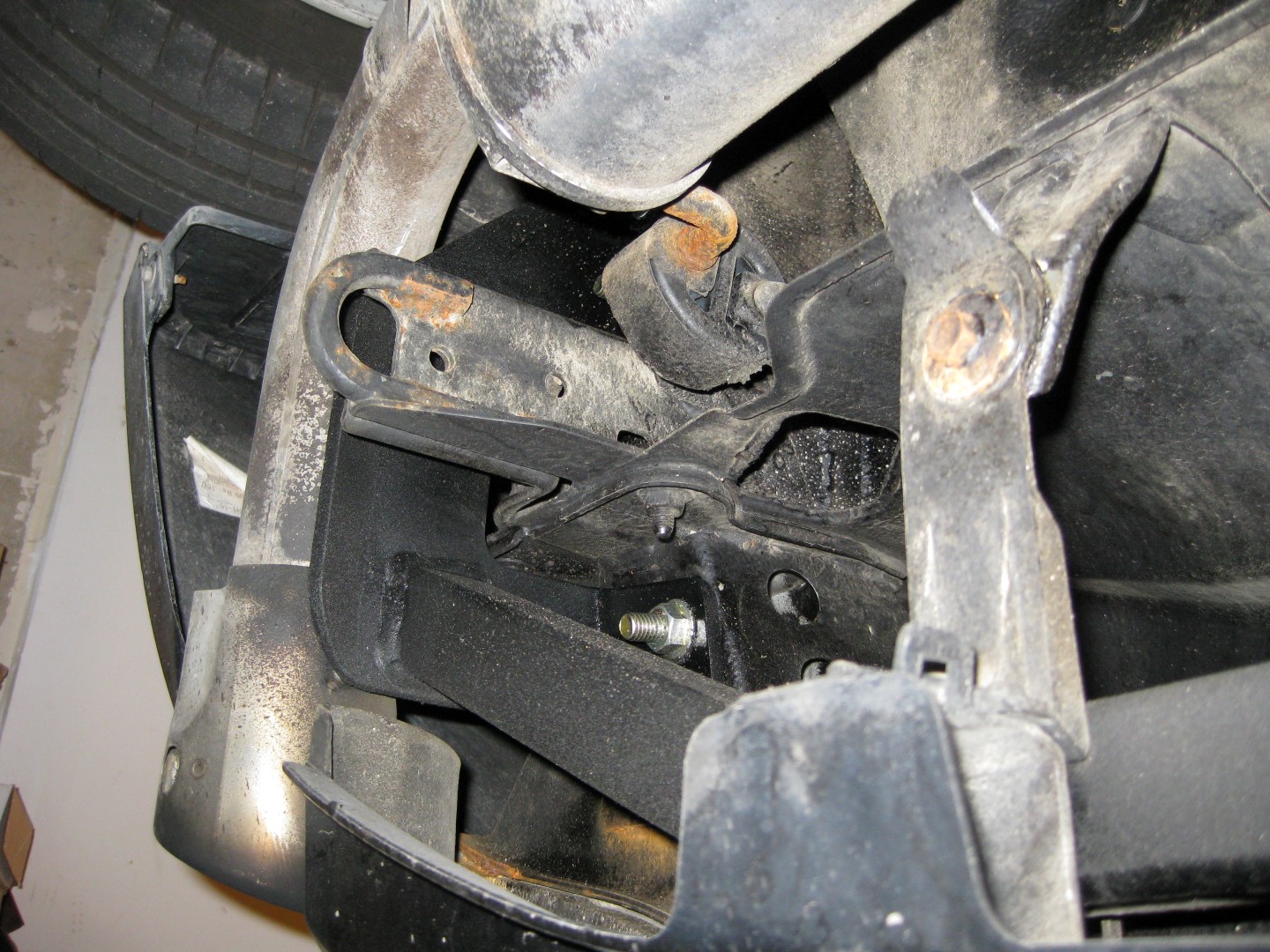

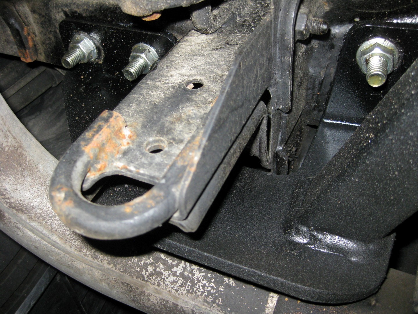

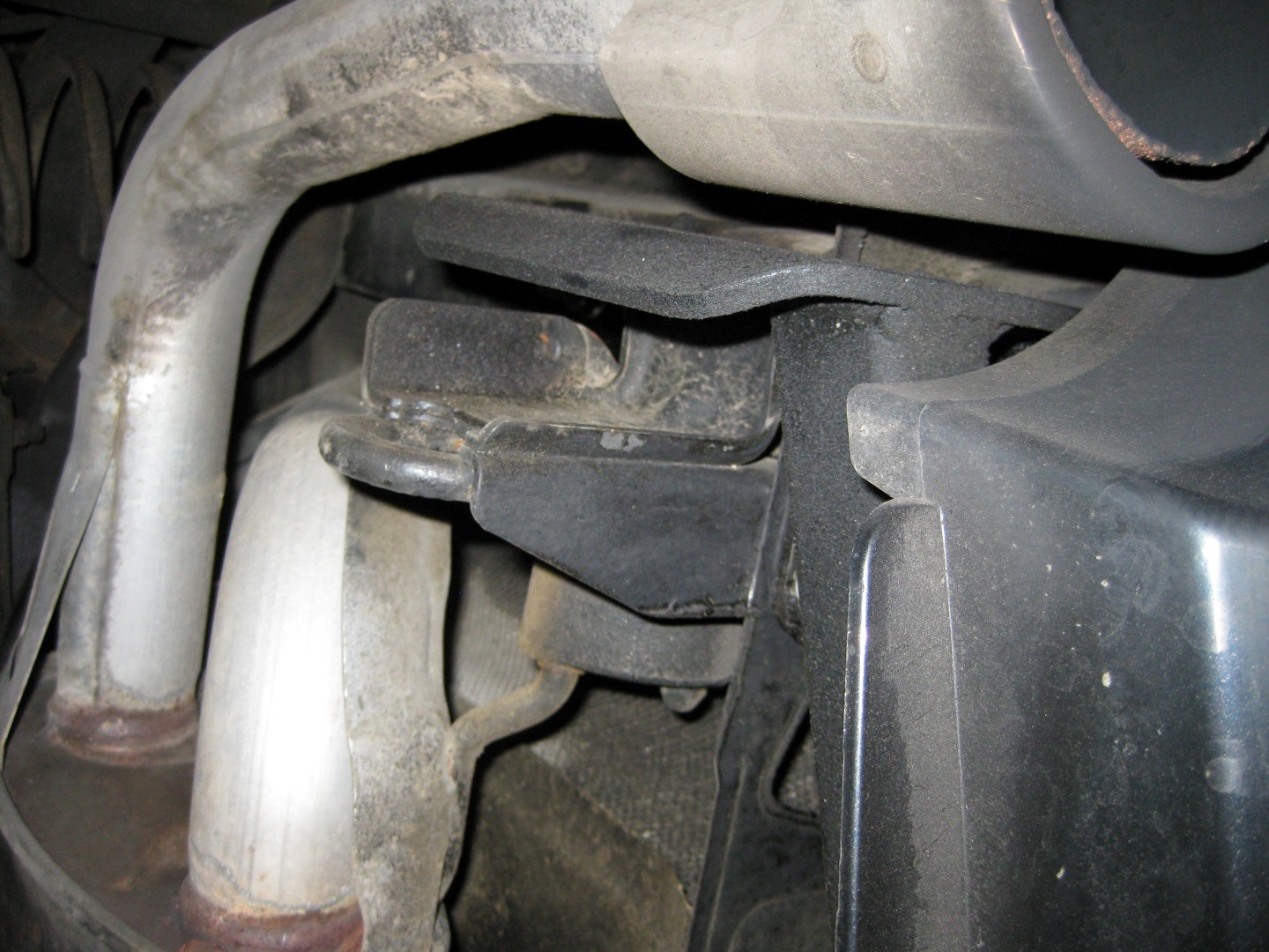

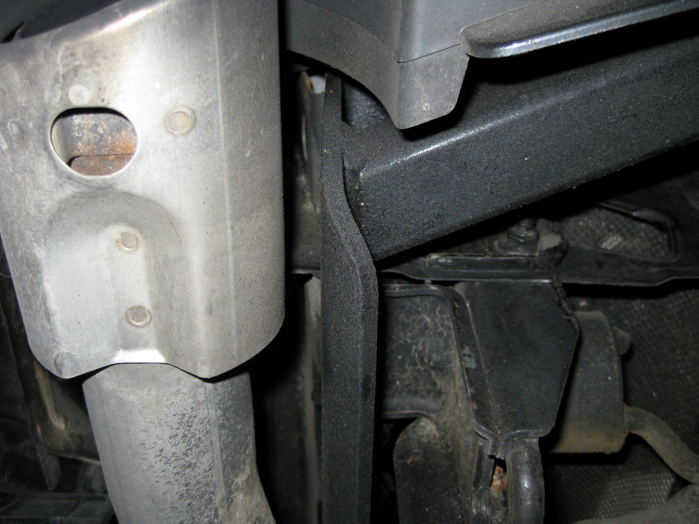

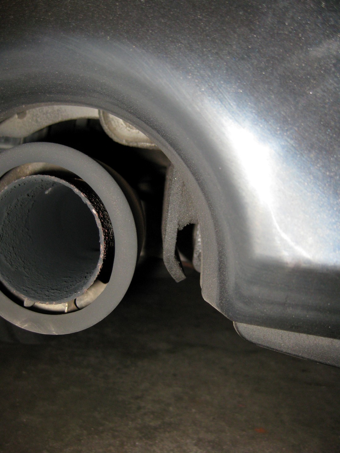

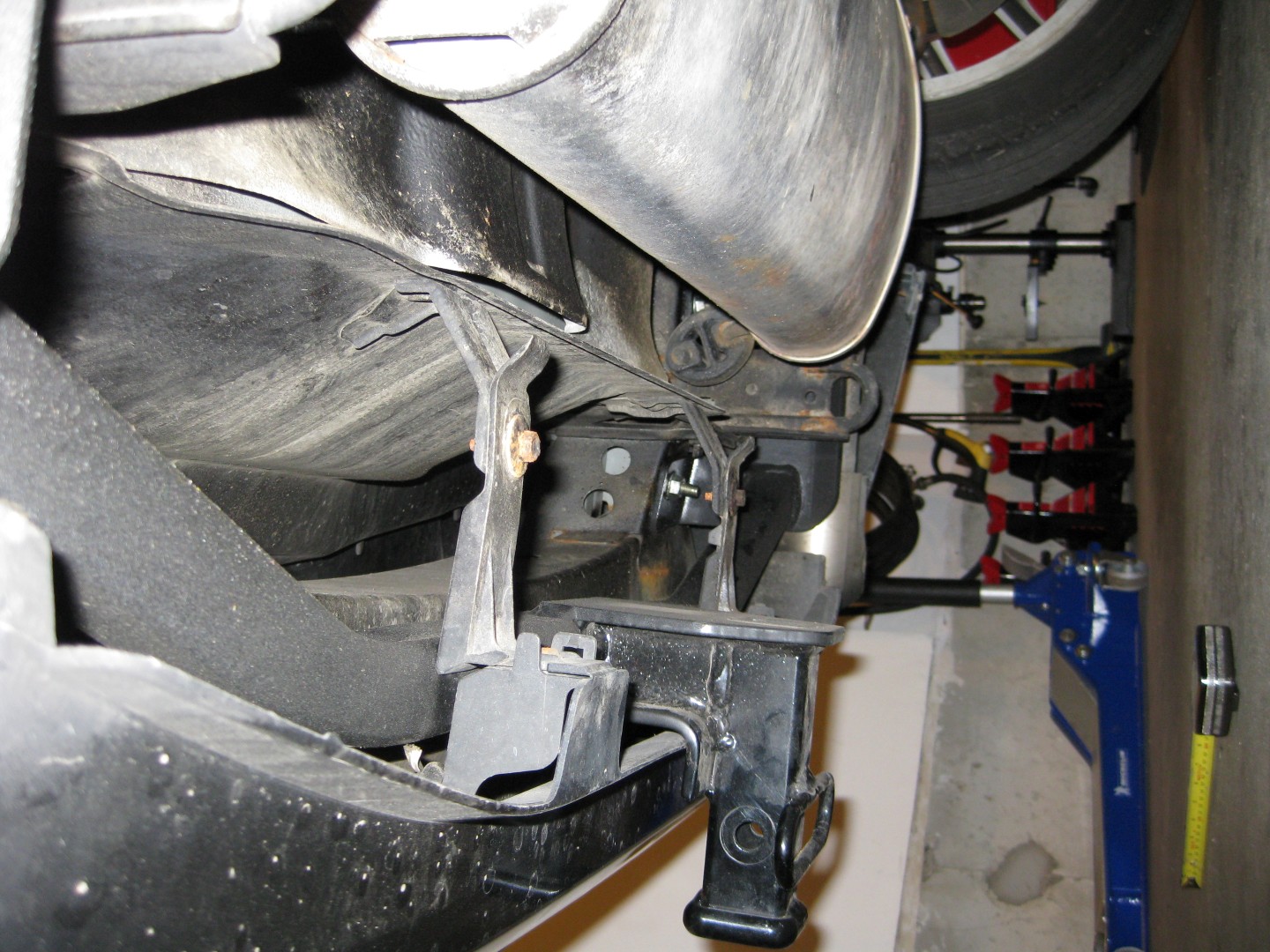

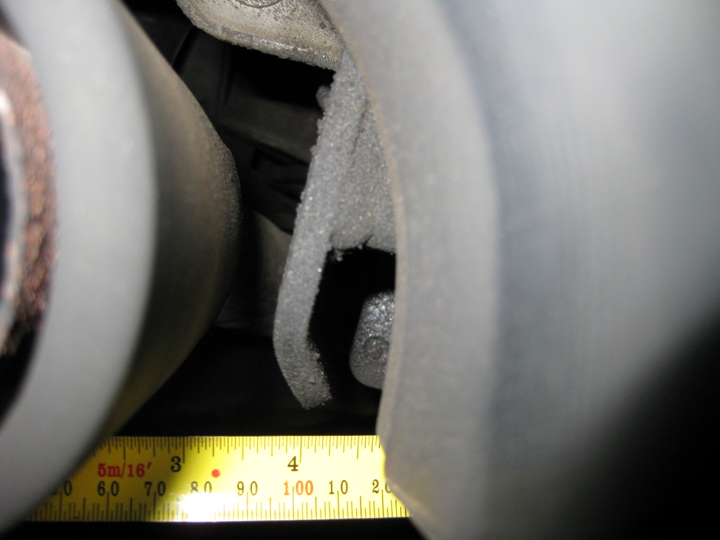

Bonus points if you can confirm fitment of this exhaust with a Curt 11383 hitch installed I'm on the hunt for a catback that will fit with my hitch.

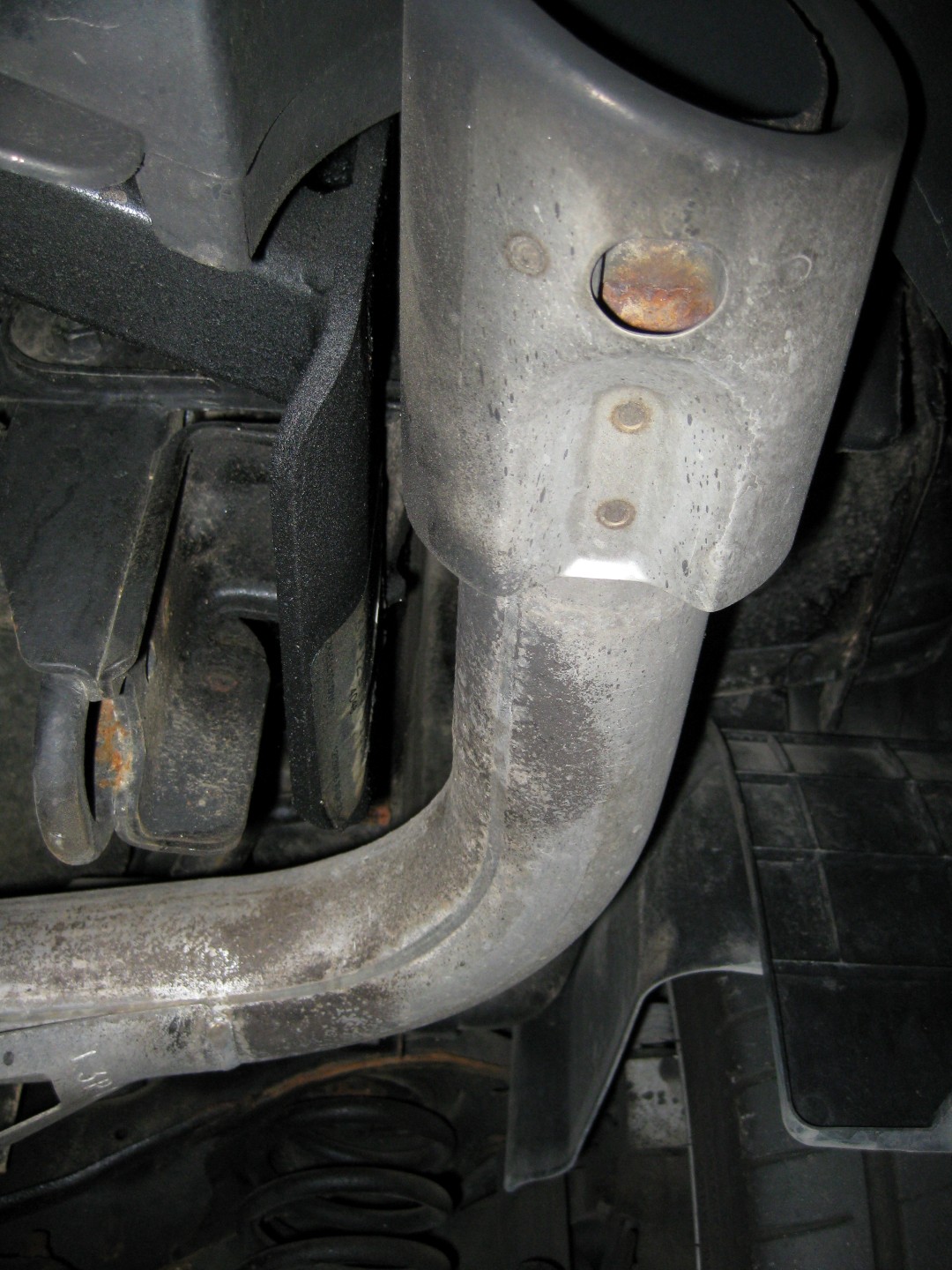

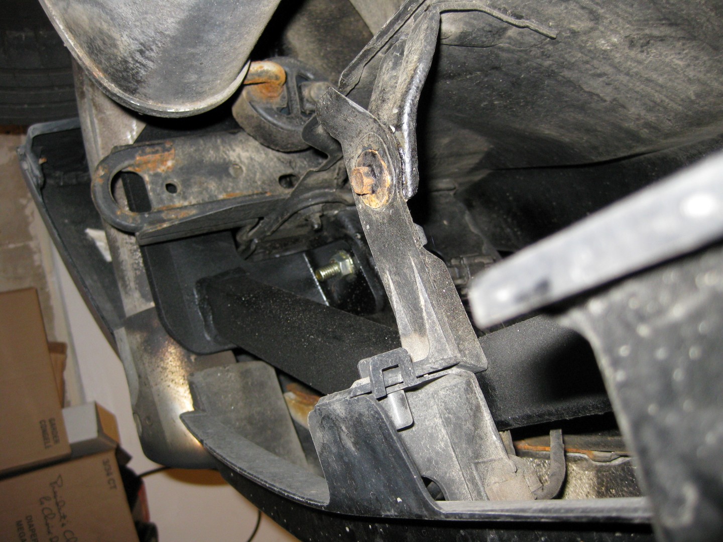

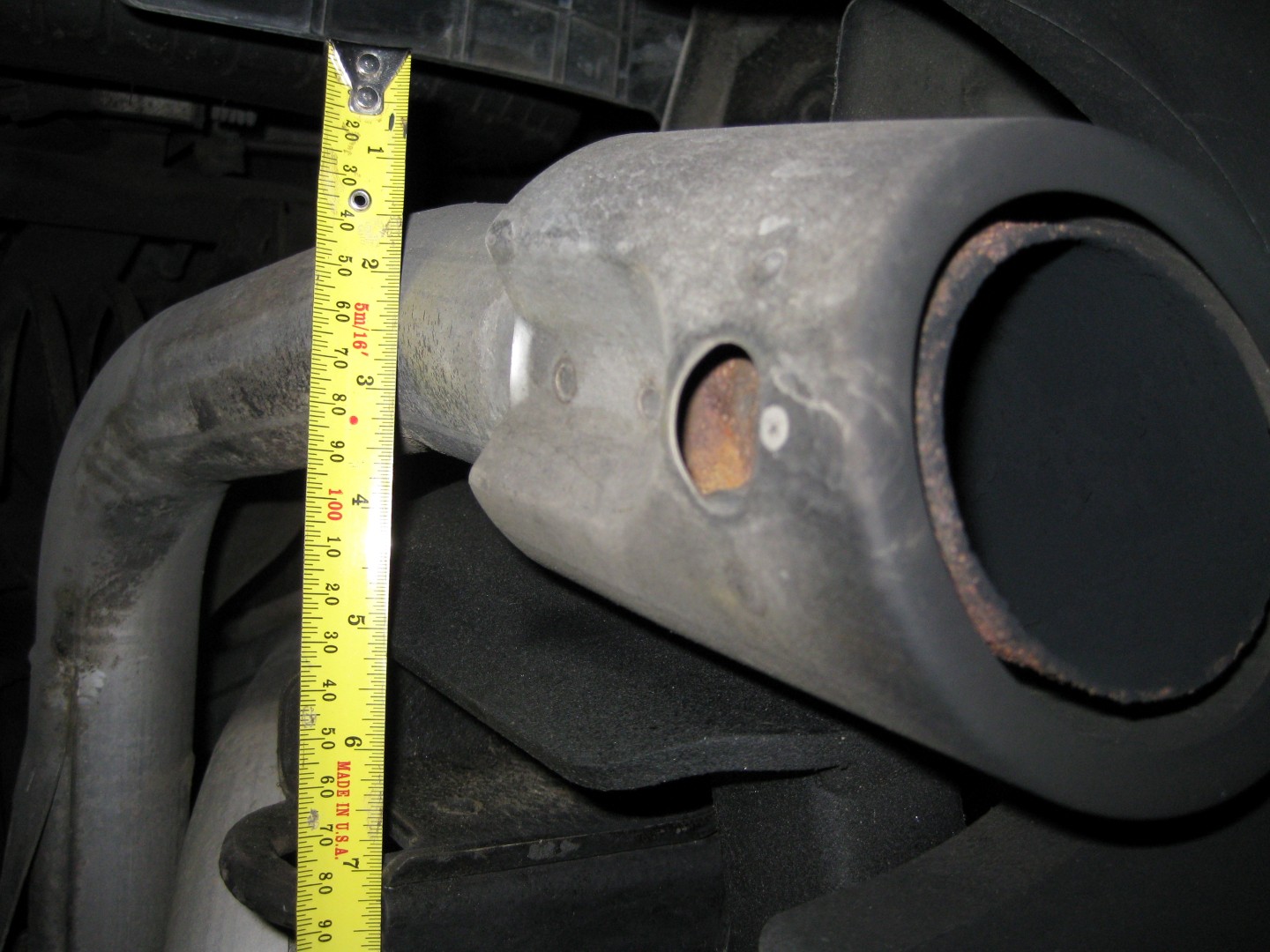

I did some digging around and was unable to come up with a solid answer. I basically was only able to get confirmation from Josh @ CP-E that their system is alot smaller than the factory exhaust so there should be more room to fit a tow hitch if that kit you have works with the factory system. I am sorry I don't have a guaranteed answer on this for you .
Tanner
Tanner
Tanner,
I was checking out the pictures and luckily yes the majority of it is smaller. I think the problem would be the tips though. I wonder since the cp-e tips are removal, if it would be possible to get ones that weren't so big? Here's some pics I had taken of clearance to the stock exhaust, the hitch metal is 1/4"

The one we sell on our site does include the added mufflers
Tanner,
Let me get some measurements off of mine this week and maybe that will help with the comparison for clearance.

Cool thanks.
I just sent you over a PM with a bunch of images, hopefully we can figure out the fitment for you .

Does anyone have any tips for getting the studs out of the stock cat ?
Choke me, I like it.
frivolous_rob is offline   Reply With Quote

Posts: 536   (View Stats)
Thanks: 550
Groans: 105
Heat it up!

Originally Posted by Db09ms3 View Post
Heat it up!
I’ll give it a try and just double nut it yeh? I believe the nut on the back of the flange is welded ?

Thanks: 161
double nut is the way to save thread yes or vise grip when it is a throw away stud
Db09ms3 likes this.
It is throw away but just wouldn’t budge with vice grips
Update: in case this happens to anyone else, it took all of 10 min to remove the cat from the down pipe and heat up the studs with a propane torch. Studs came out clean and easy that way.

you weren't able to heat them in place ?
A propane torch and if you need a little extra heat, the yellow can (Map-pro) saved me few times from the needs of a full torch set.
Db09ms3 likes this.

I used a propane torch but was on jack stands so didn’t want to lay under there upside with a torch
