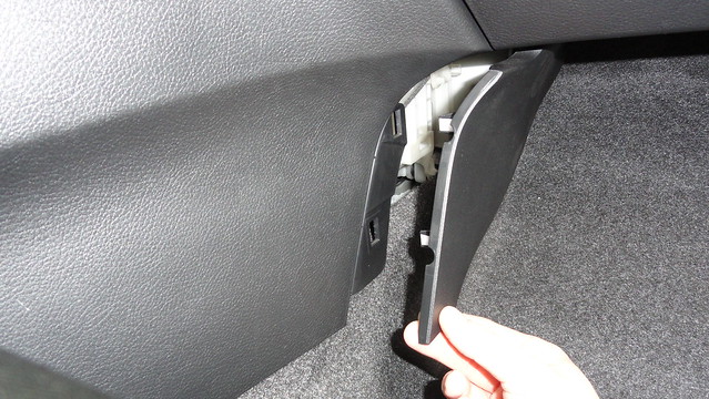

pop out this panel on the passenger side. pull outward to release the two clips, then pull the panel out towards the back of the car.

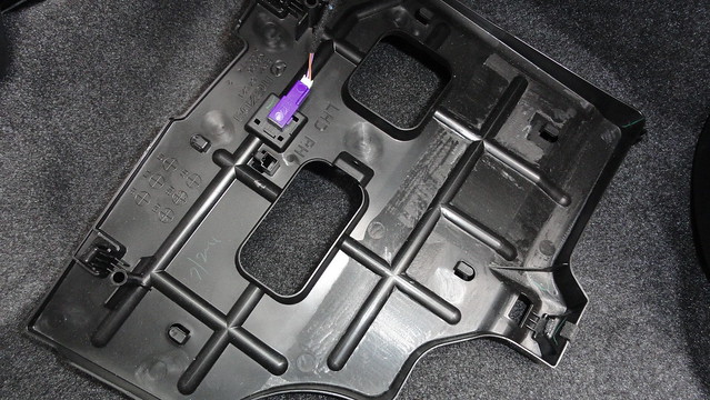

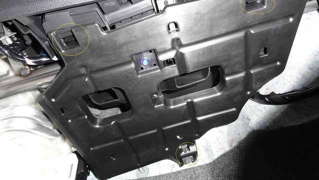

this tray under the glove box has to come down. push the two clips in towards the firewall to release them, then pull the tray off the bolt in the back.
once loose, you'll have to remove the led light to get the tray out of your way. push in the wire harness clip to free it, then you can disconnect the wire plug from the led unit, or rotate the led unit and pop it out.

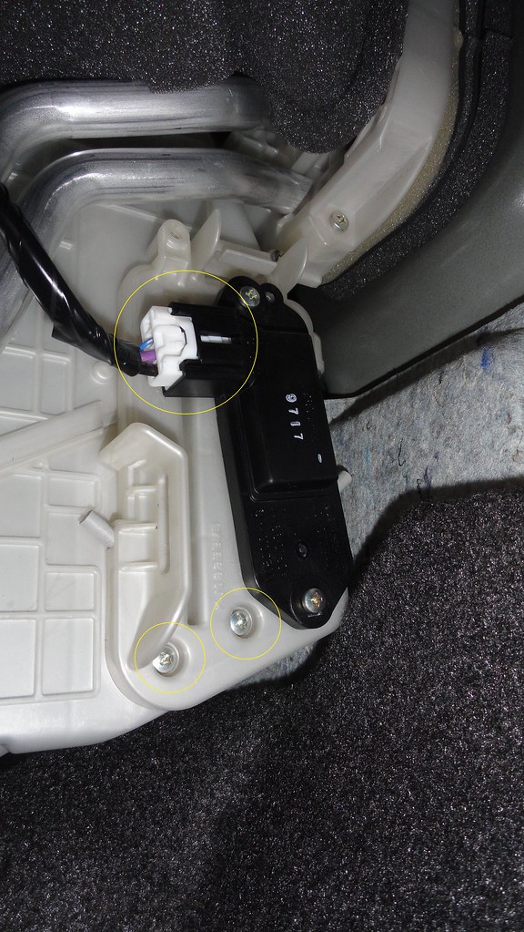

now you'll see this. disconnect the plug from whatever sensor that is, and unscrew the two screws circled (not the ones for the sensor). lift the tab at the top of the panel and it comes off.

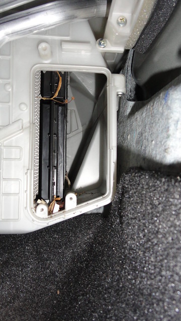

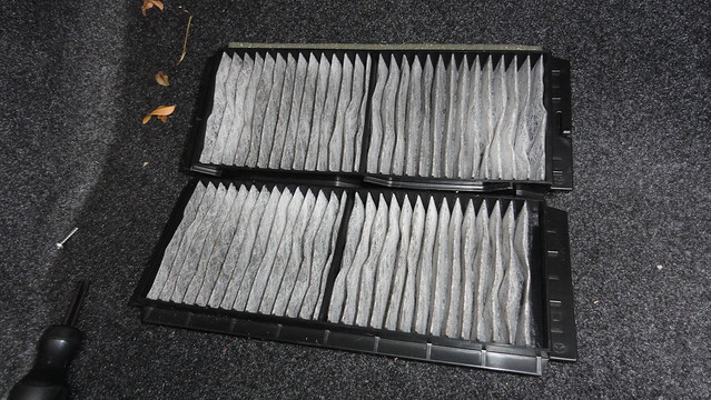

this is what is in there. the two filter panels are stacked on top of each other pressed up against the console side (opposite firewall). slide out the lower one, pull the upper one down, and slide that one out.
lay them on the floor in the same orientation as you removed them so you see how the new ones go back in.

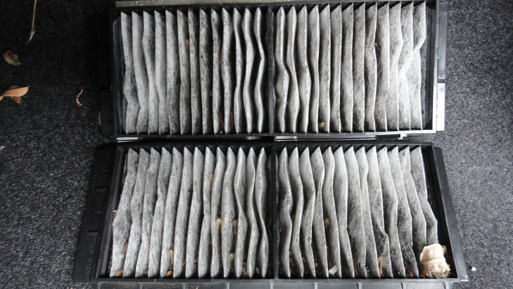

flip them over and see all the crap your air is passing through before you breathe it. allergies anyone?

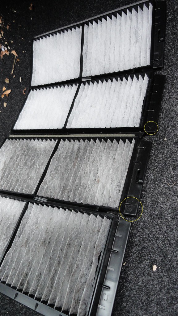

line up the new ones the same way the old ones came out. the panels are not the same, there is a top and bottom. notice the mazda logos? they should face you, or the back of the car (should NOT face the firewall) when you slide them back in. slide the top one in first, push it up and it should softly snap into place and hold it self there, then slide the bottom one in. they slide snugly and flat up against the non-sidewall side. if not, you're doing it wrong.

Change it this weekend... Looks clean to me
tapafuck
