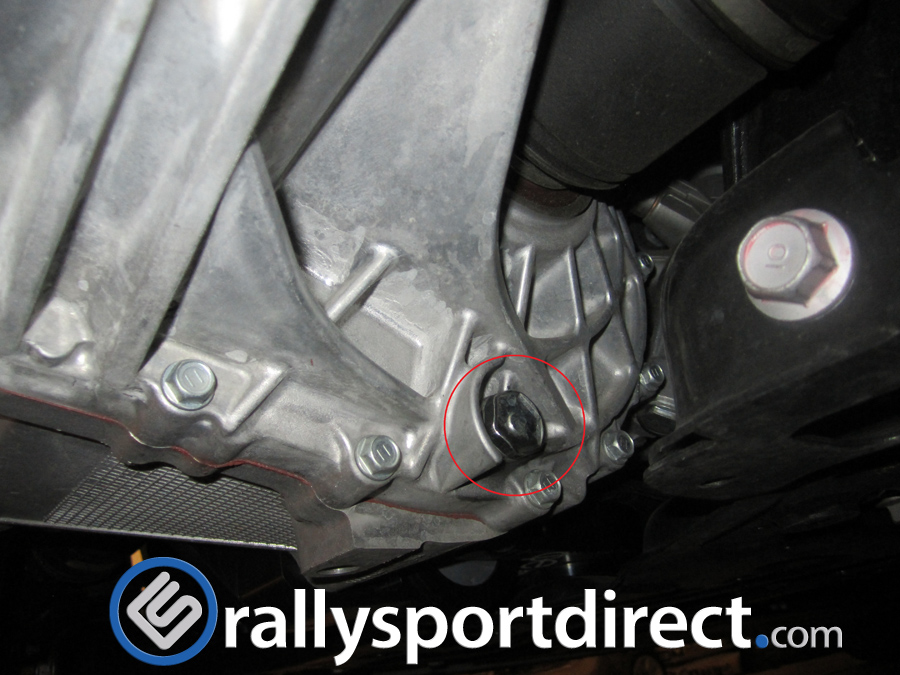

There have been alot of questions about the drain plug size for the MS3 but I've never found an answer so I figured now would be a good time to get some high performance fluid and toss in a Dimple Magnetic drain plug.

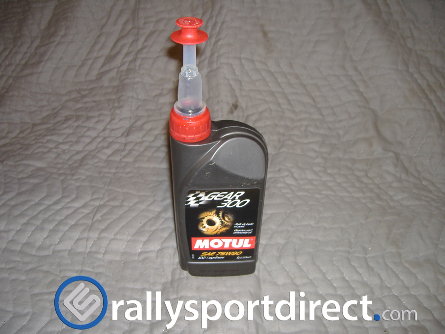

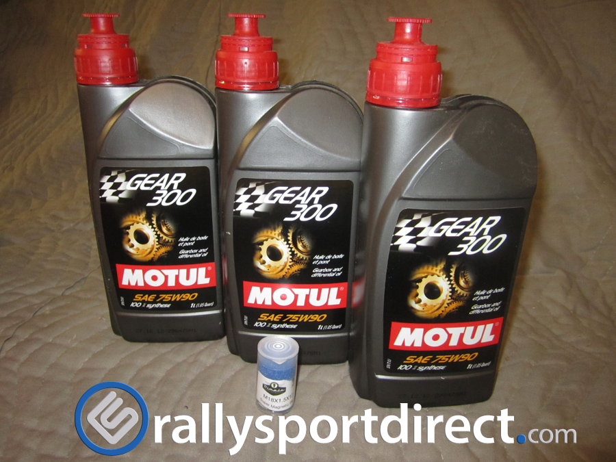

I tossed in Motul Gear 300 oil since Motul is known for making some of the best oils on the market and we've had awesome results especially with this gear fluid.

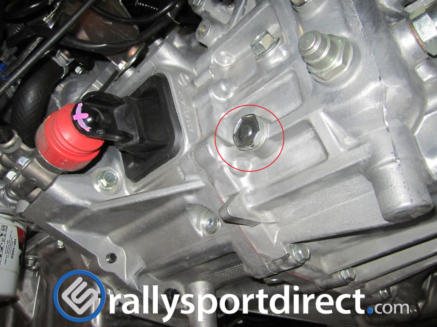

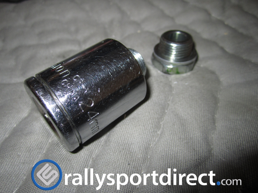

Here is the drain plug once you get the under panel removed from your car. You'll need a 24mm sock and wrench to get this out. You'll also need the 24mm to remove the fill plug.
Drain plug:
Fill Plug:

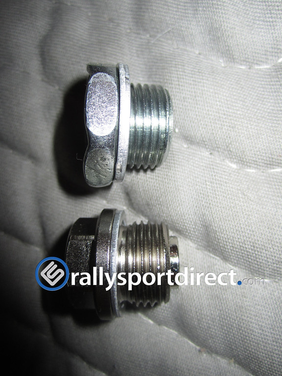

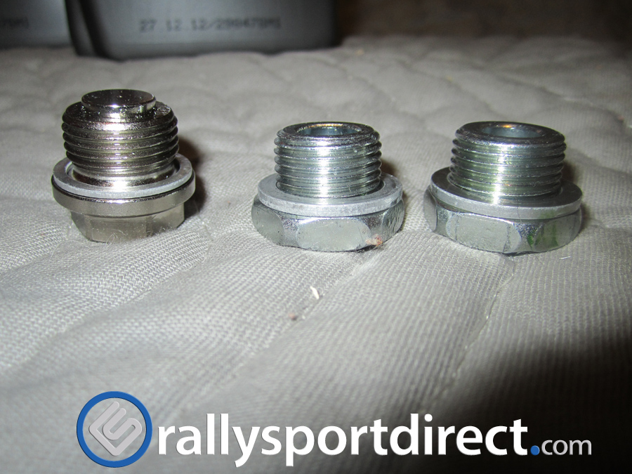

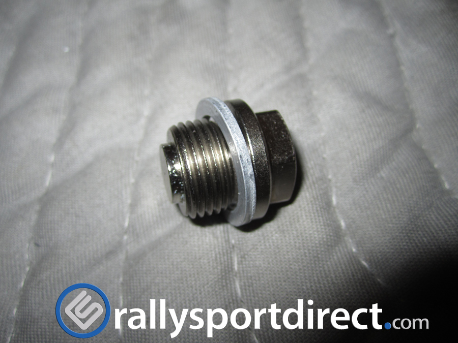

Here is the Dimple M18x1.5x12 on the left and the stock fill and drain plugs on the right and middle.
I opted to reuse the factory drain plug washer in place of the one that Dimple includes since it is much beefier.
Once the fluid is drained install the Dimple drain plug ensure you torque it down properly.
Dimple Drain Plug Socket Size is 17mm

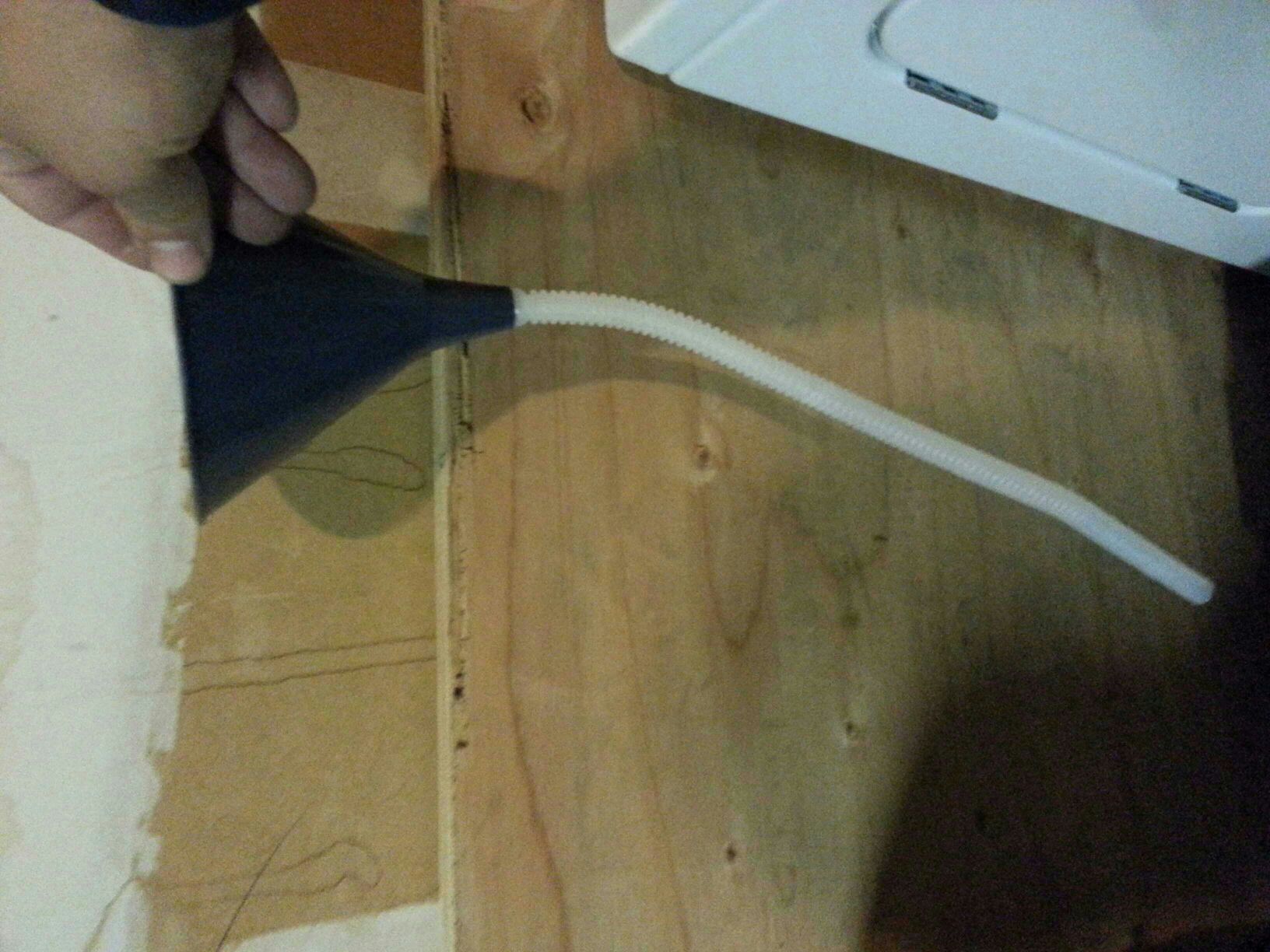

I bought one of those funnels above, very handy. From the top of the engine bay I was able to feed the tube into the fill hole. It helps that I have the CS SRI installed. I don't think you'd be able to do it with the stock air box. I still had the car jacked up with a drain pan under the fill hole.
I was able to rest the funnel between the air filter and battery box and the tube stayed in the fill hole well. So that funnel was now hands free. To make it easier to pour the fluid, I used a second funnel to feed the tubed funnel. It was an extension, if you will. It worked flawlessly.
When the tranny was full I could see and hear it dripping onto the drain pan. So I stopped and then put in the Dimple magnetic plug.
By the way, for those not familiar with how to remove the under body panel, it's easy. I think it's 7 bolts and 5 screws. There is a pain in the ass plastic push connector up front in the middle. I have no idea how to get that thing out properly, so I just broke it off and replaced it with a zip tie. Much easier that way.
