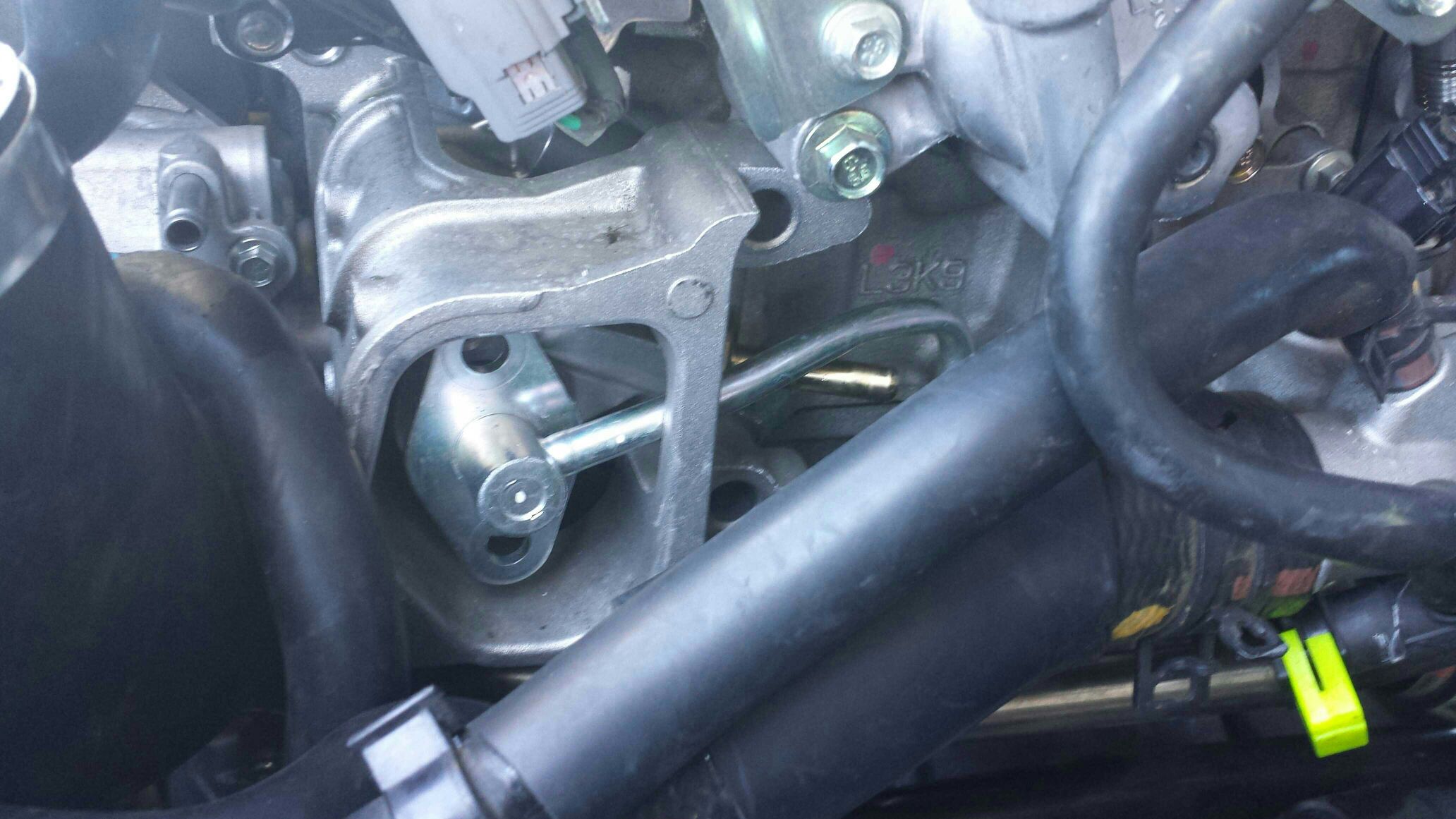

OK. Let's say that instead of that little guard thing being attached to the fuel rail by a few bolts, it were to be part of the fuel rail... How the fuck do I get this thing out?[IMG]
Sergeant_M is offline   Reply With Quote
 Old 10-08-2014, 12:02 PM   #45
frothy's Avatar
Location: Maryland
Posts: 1,067   (View Stats)
Thanks: 848
Edit: In all seriousness, the line you're removing is trash, correct? Why not just clip it?
 Old 10-08-2014, 12:35 PM   #46
Sergeant_M's Avatar
Location: Vallejo, CA
Posts: 504   (View Stats)
Sergeant_M is the leader of the worldSergeant_M is the leader of the worldSergeant_M is the leader of the worldSergeant_M is the leader of the worldSergeant_M is the leader of the worldSergeant_M is the leader of the worldSergeant_M is the leader of the worldSergeant_M is the leader of the worldSergeant_M is the leader of the worldSergeant_M is the leader of the worldSergeant_M is the leader of the world
Thanks: 252
Thanked 263 Times in 127 Posts
Still have to get the new one in. I just sawed the little bracket thing off. It has no real purpose but to make my life more difficult.

No its not.... its pretty much impossible that it's joined with the hardline.
Did you get the very bottom bolt out near the EGR connection at the IM?

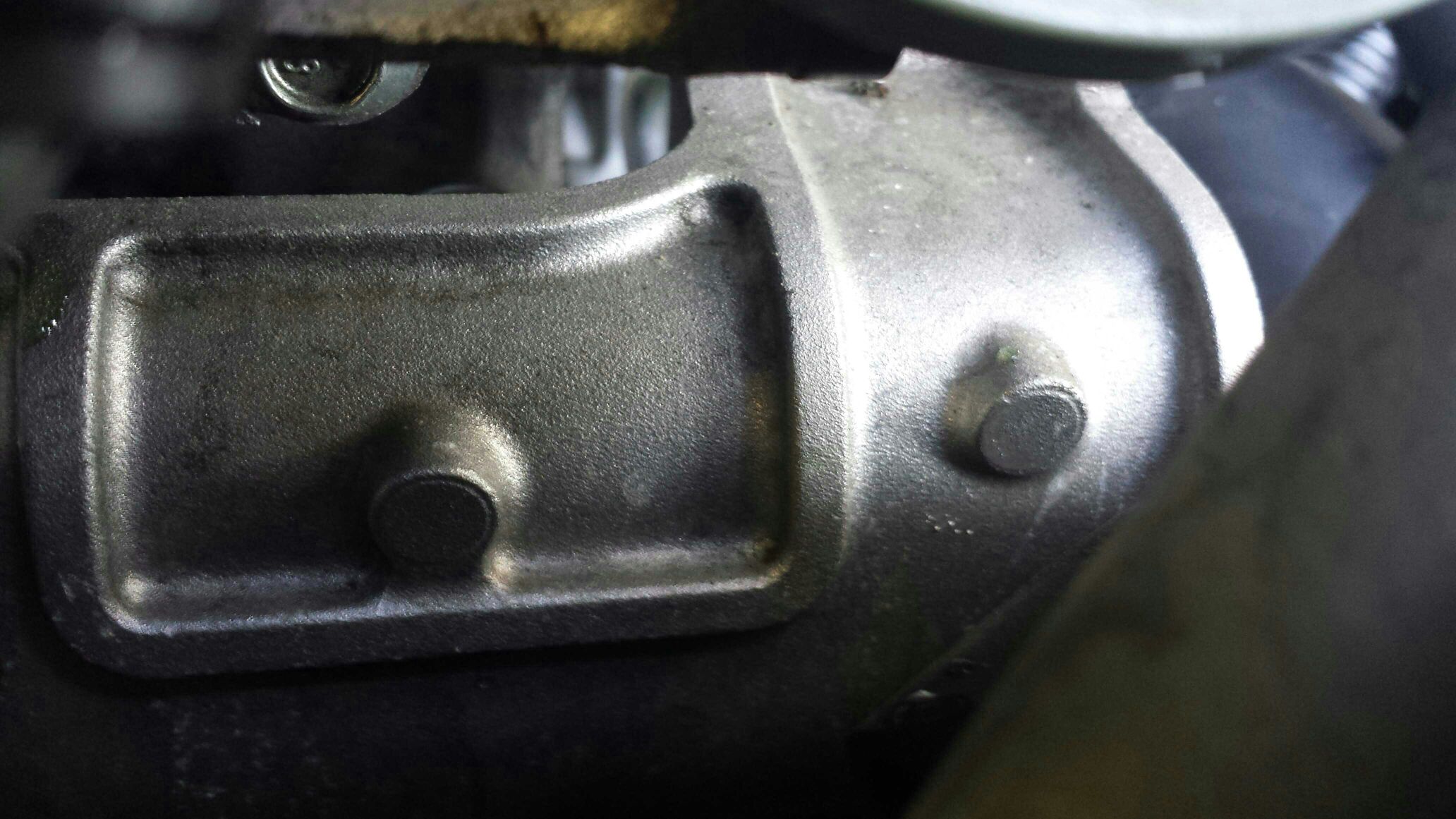

 Old 10-08-2014, 05:03 PM   #50
naoandlater's Avatar
Location: IL
Posts: 655   (View Stats)
naoandlater is the leader of the worldnaoandlater is the leader of the worldnaoandlater is the leader of the worldnaoandlater is the leader of the worldnaoandlater is the leader of the worldnaoandlater is the leader of the worldnaoandlater is the leader of the worldnaoandlater is the leader of the worldnaoandlater is the leader of the worldnaoandlater is the leader of the worldnaoandlater is the leader of the world
Thanks: 960
Thanked 600 Times in 283 Posts
There are two bolts on the block and it needs to be loosened on the hpfp. Pic shows where bolts go.
I pulled 3 bolts from it. Didn't see one by the egr. I will try to find it and take a couple more pics before I bolt everything back together tomorrow. If I did miss that bolt then I guess cutting it isn't that big of a deal as I can just bolt a new one in at a later date. Need this car on the road as it is my daily.

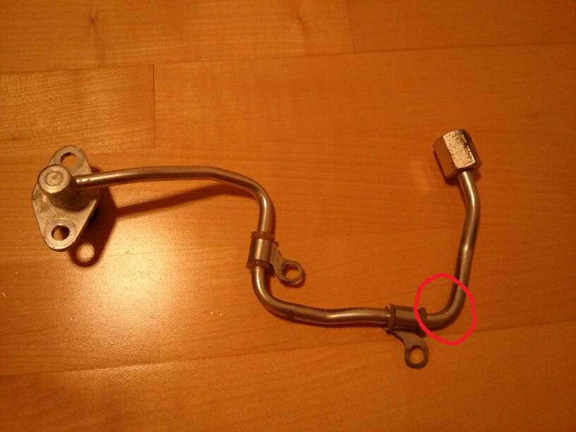

Reviving the thread as this happened to me this weekend. Faint smell of fuel over the HPFP, ripped the engine bay apart, found nothing wet. Reinstalled everything and read this thread while investigating. Mine was spraying a fine mist of fuel at the same bend in the line and took me a while to find/recognize. I only saw it as the light of the flashlight made a prism effect and the colors caught my eye, else I would never have seen the fuel coming out of the crack. No static leak at all and the fuel mist never collected or pooled.
Took the car to Mazda here and it is replaced under my extended warranty. Was kicking myself for 6 years after buying an extended warranty, and now it has more than paid for itself as this is the second time I've used it.
From what I can see of the crack, it's material failure in nature, and by the molecular-like jagged fault line it appears to be from hoop stress during normal heat cycles.
Hope this helps the next person that smells a faint fuel odor, especially during engine start.

Sounds like a fatigue failure. I do the fatigue calculations for DI components, including the high pressure line. Fatigue failures will follow the path of the weakest part of the metallic structure.

Well my fuel line decided to shit the bed again this morning (same exact spot). Corksport has a new one that they are offering in 6 days, but I need one now. I am almost tempted to borrow a car for a week so I can install something that won't need replacing again.
