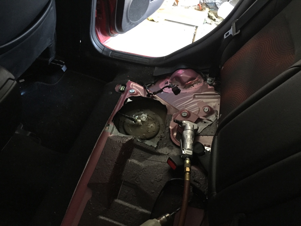

Btw my hole looks exactly like yours lol soo much quicker but now I've gotta make a plate. Mazda shit on us with the maintenance for this car
