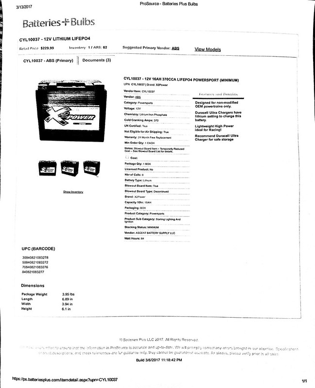

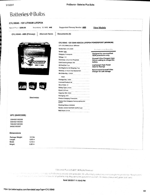

Thanked 17 Times in 7 Posts
Looks like it is an optional item for different franchise groups so I suggest you call a local store or two and ask if the store carries this part number "CYL10040" or "CYL10037" I'll post a spec sheet for each battery. the CYL10040 is a larger battery with better CCA's. Will update tonight
201703131013211000 by zach palmer, on Flickr
201703131012591000 by zach palmer, on Flickr
